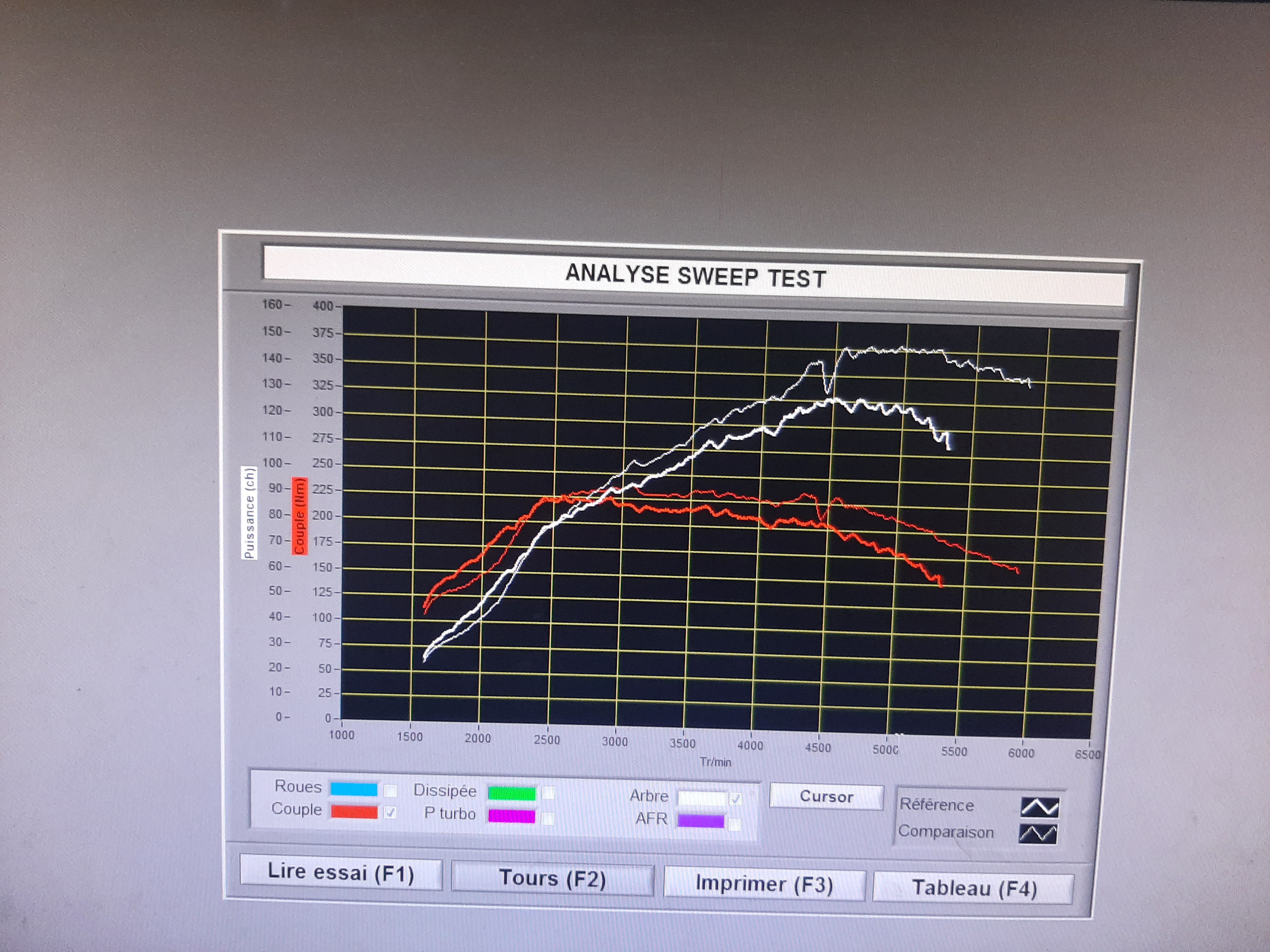

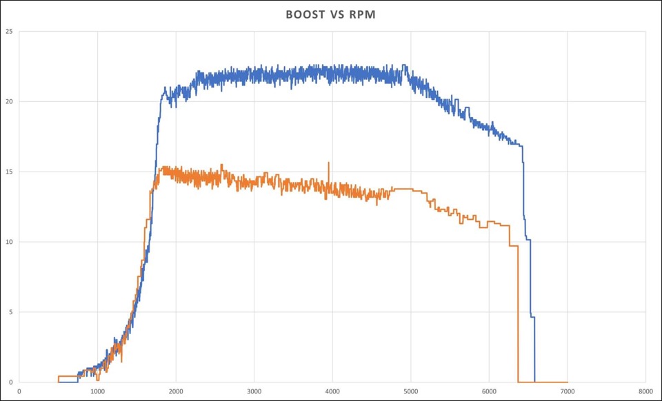

I've got a friend running stage 2 on a completely standard 1.2 engine with a decat exhaust, his is running about 145bhp, we compared the boost vs rpm of both, the hybrid just holds onto it forever (i'm on stock exhaust btw, hence the drop-off after 5k)
Blue is JBS Hybrid with standard exhaust, Orange is Stage 2 with decat.

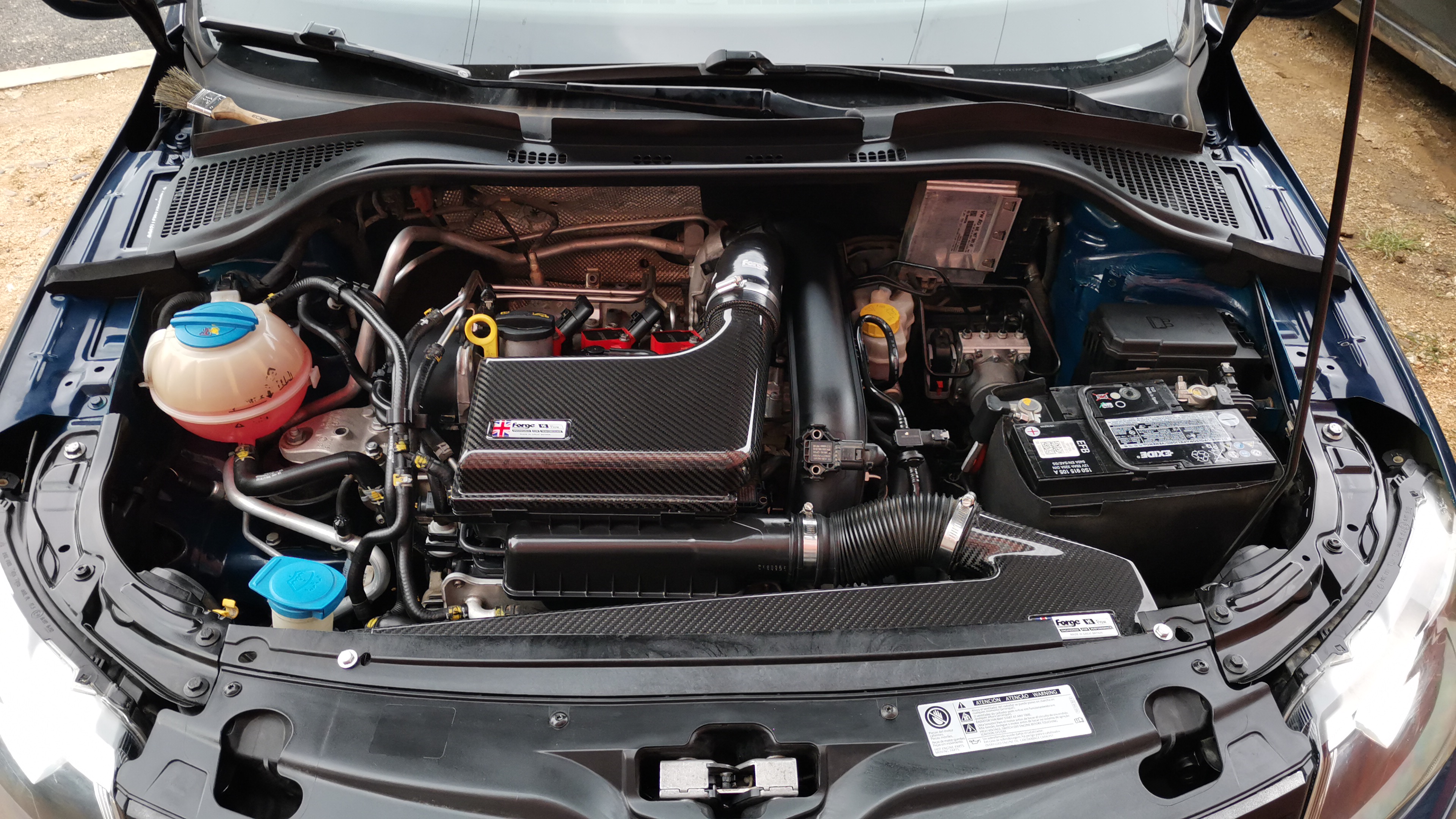

    Little update with my build, I folded and ordered an rtmg turbo and carbon intake. I fitted the turbo last week and tomorrow I'm taking a trip back to my tuner to get a cuatom map for it. Was at 183bh
  • Everything working perfect, your post on how to do it helped massive amounts. Had a little coolant leak after I fitted it but soon fixed that. Topped it up with water going to get some coolant in the
Wow 26k so thats proving pretty reliable, thats great news!
1800 rpm doesnt sound too bad, it almost sounds like it drives like the old turbos from the 90s with plenty of lag but then full boost strong!
Its nice to see the difference of the hybrid vs a stage 2 - and boy is that a big difference!

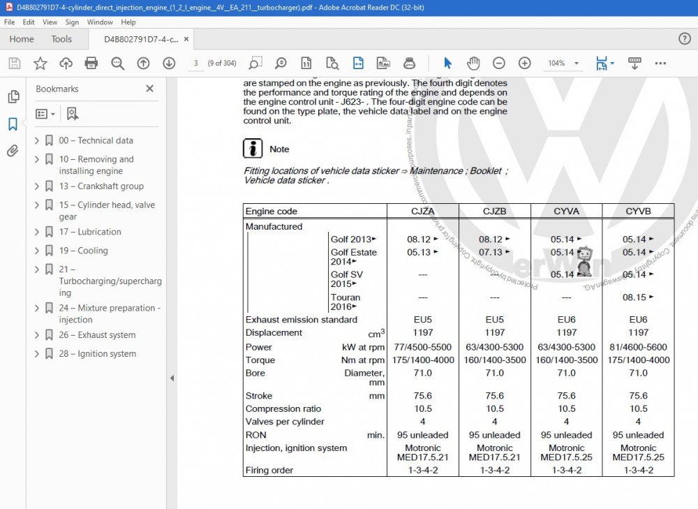

I really ought to write up all the info I have collected on tuning the EA211 engines since 2014...as I was looking at getting my 1.4lt 140PS mapped from brand new back in 2014.

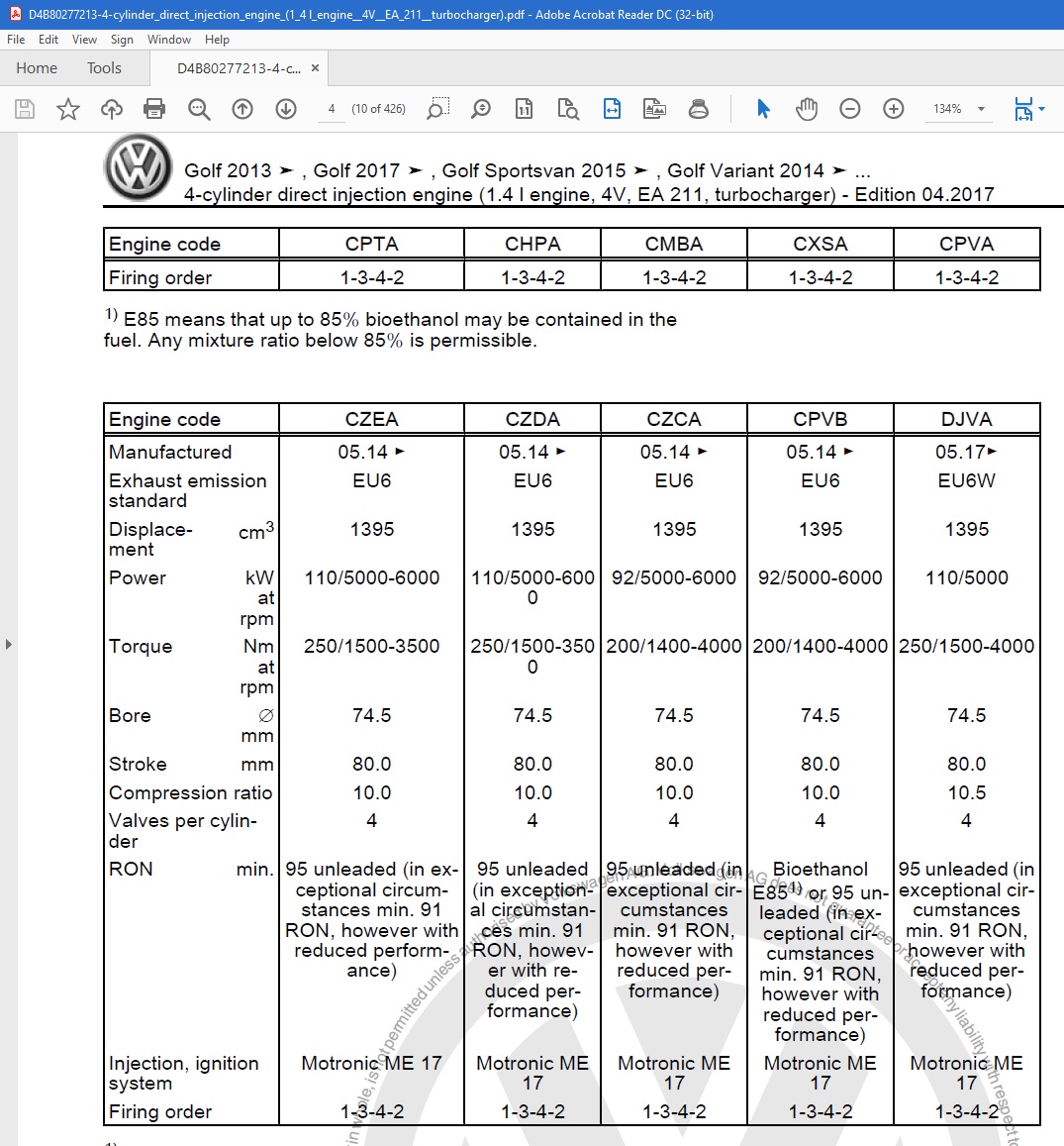

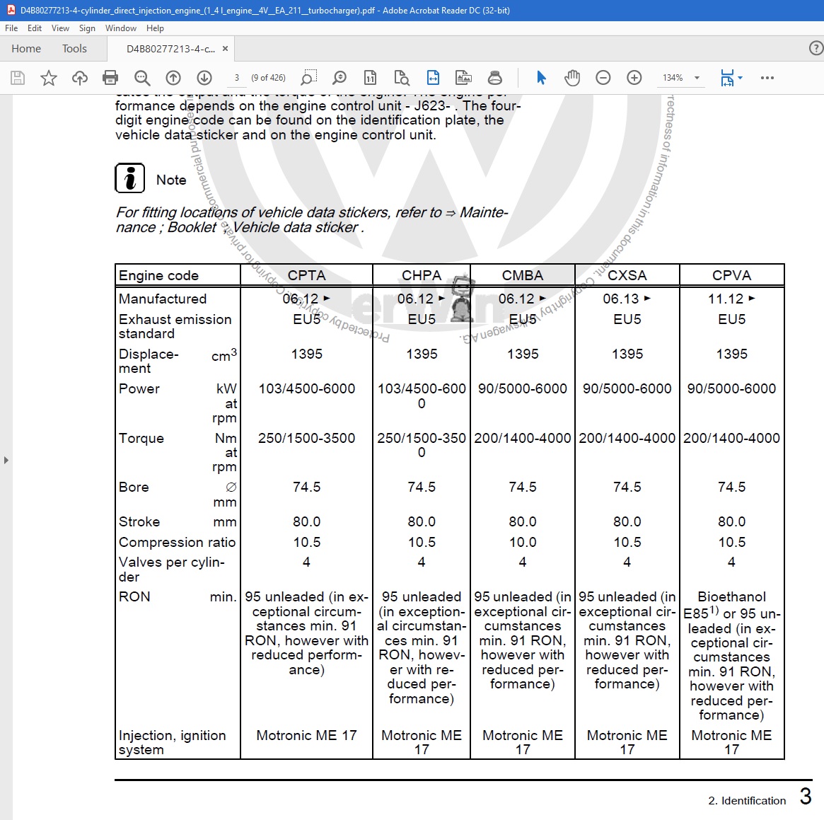

Having read the thread I want to put some correct info:-
The EA211 1.4lts are all mapped for 95RON, & will accept 91RON in an emergency...which means the fuelling is NOT ideal for the UK as I've never seen 91RON over here. This is why even a simple stage one 95RON remap (which alters timing) makes such a difference..
682087489_FuelqualityEA211pg2.thumb.jpg.5bfcc5f1d4f4ca83de3ef2d563e25bff.jpg58421692_FuelqualityEA211pg1.thumb.jpg.10a75eeaaa7fec6378048720d9725d81.jpg
However all the EA211 engines 1.2lts are mapped only for 95RON:-

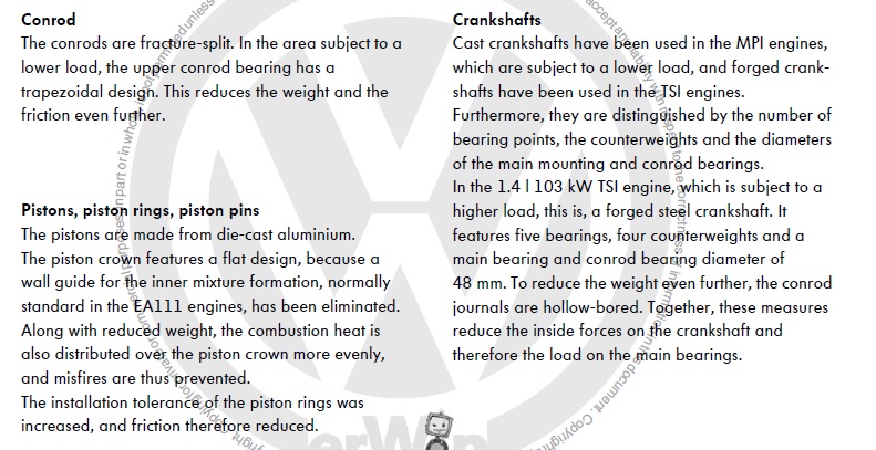

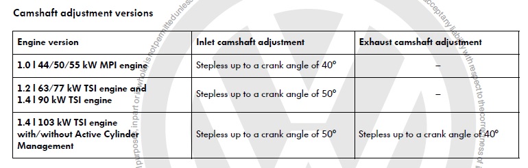

Somebody posted up the section from the ERWIM self study guide on the differences between the turbos used on the EA211 engines.
Here are some of the other relevant differences:-
The 1.4lt 140PS & 150PS have forged crankshafts

Carbon fiber forge intake is an extension from the turbo to the oem box and you feel the change.
Sadly the cold air inlet part of it doesn't fit non-MQB platform cars, we have the PQ26 platform and our inlet is different.
I am looking to make something better (and cheaper) than the forge intake too.
