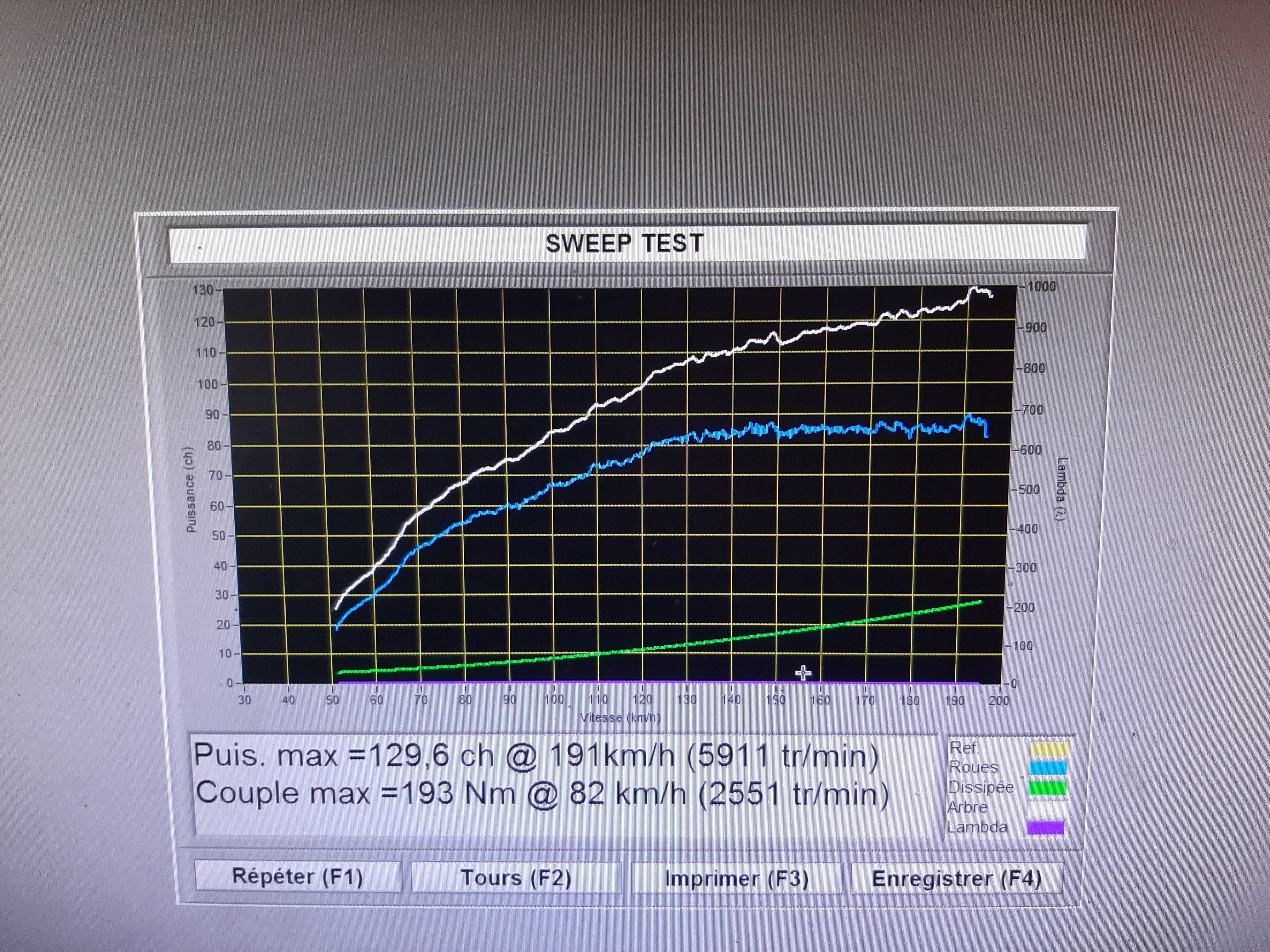

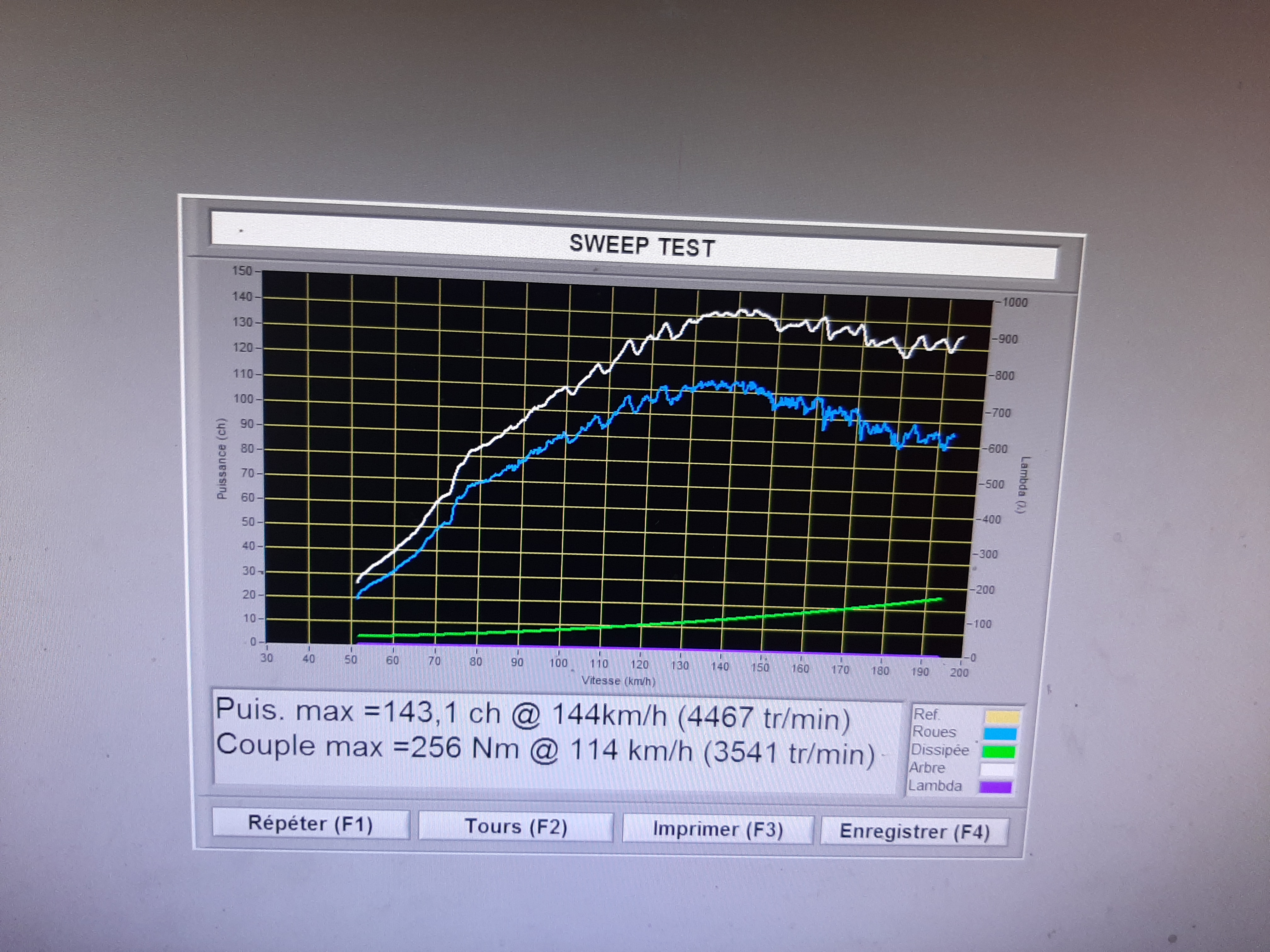

Got the 1.4 turbo fitted today (04E 145 721 B) . Noticed a big loss in torque compared to my stage 1 with 1.2 turbo. Going to remap it tomorrow, finger crossed.

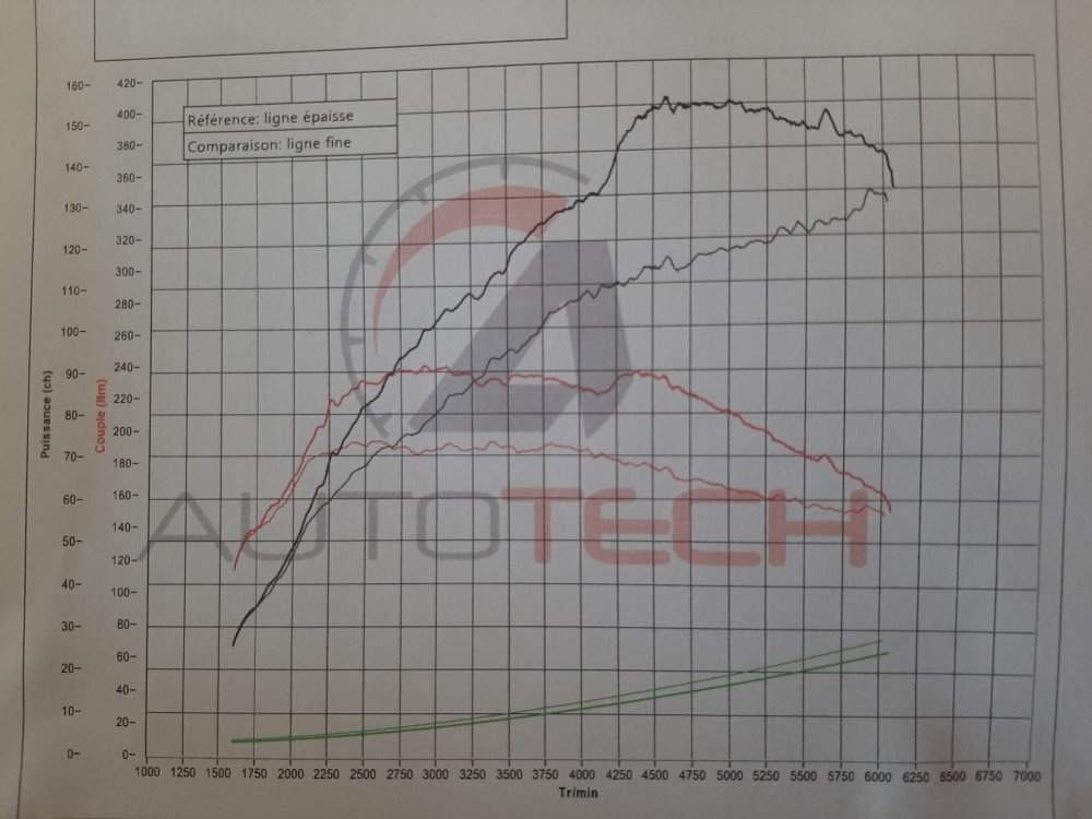

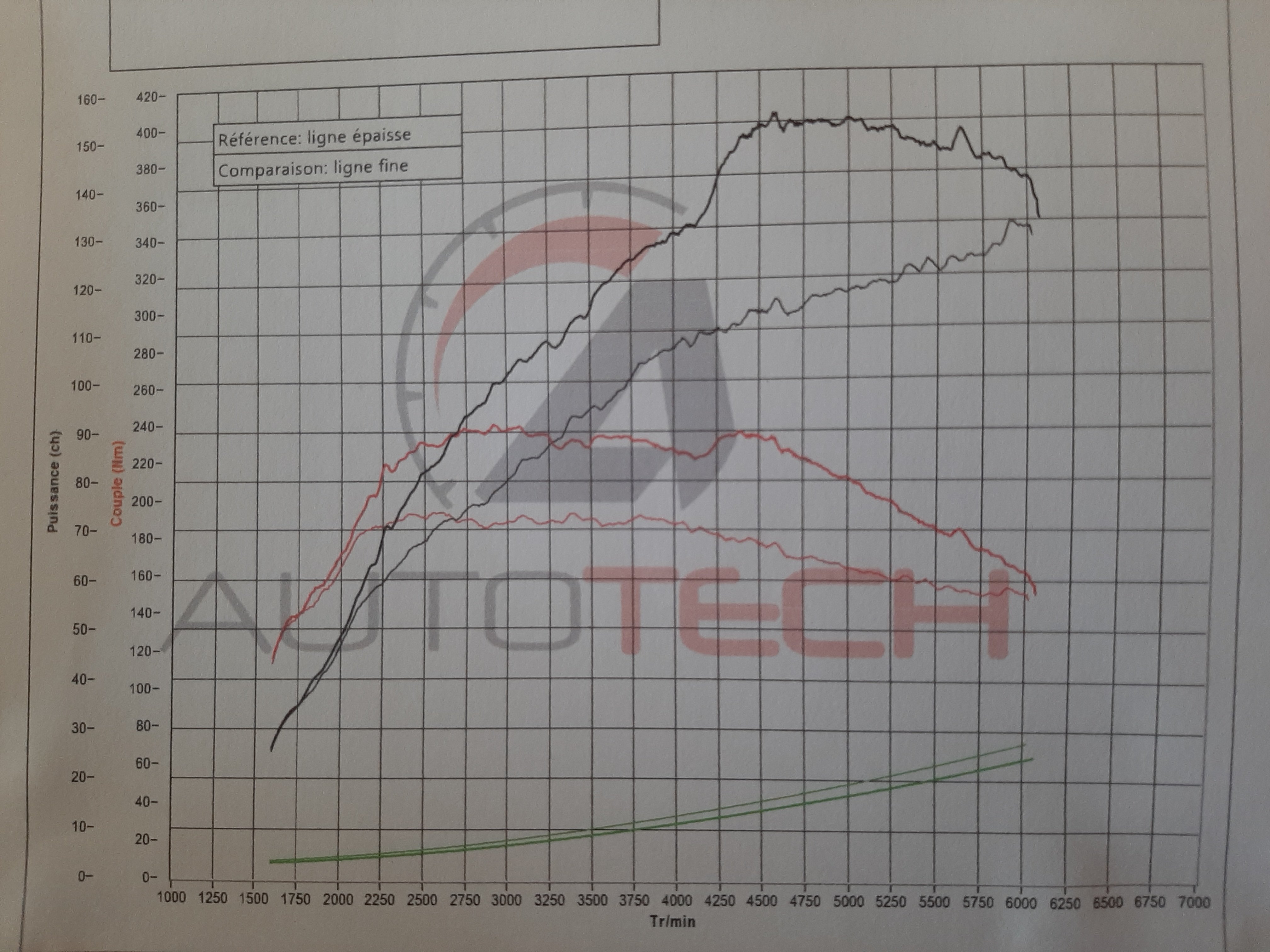

Dyno results : first with 1.4 turbo and unknown stage 1 map:143 hp and 256 Nm. Then reverted back to stock map: 129 hp and 193Nm. Took a long time for the tuners to make a custom map, so I'll come back tomorrow and test it, hope it will make some good power.
PS: you can see in the first chart lots of fluctuations, my tuner said it was the HPFP, and showed me its chart ,which shows the same fluctuations. Not a major problem though.
