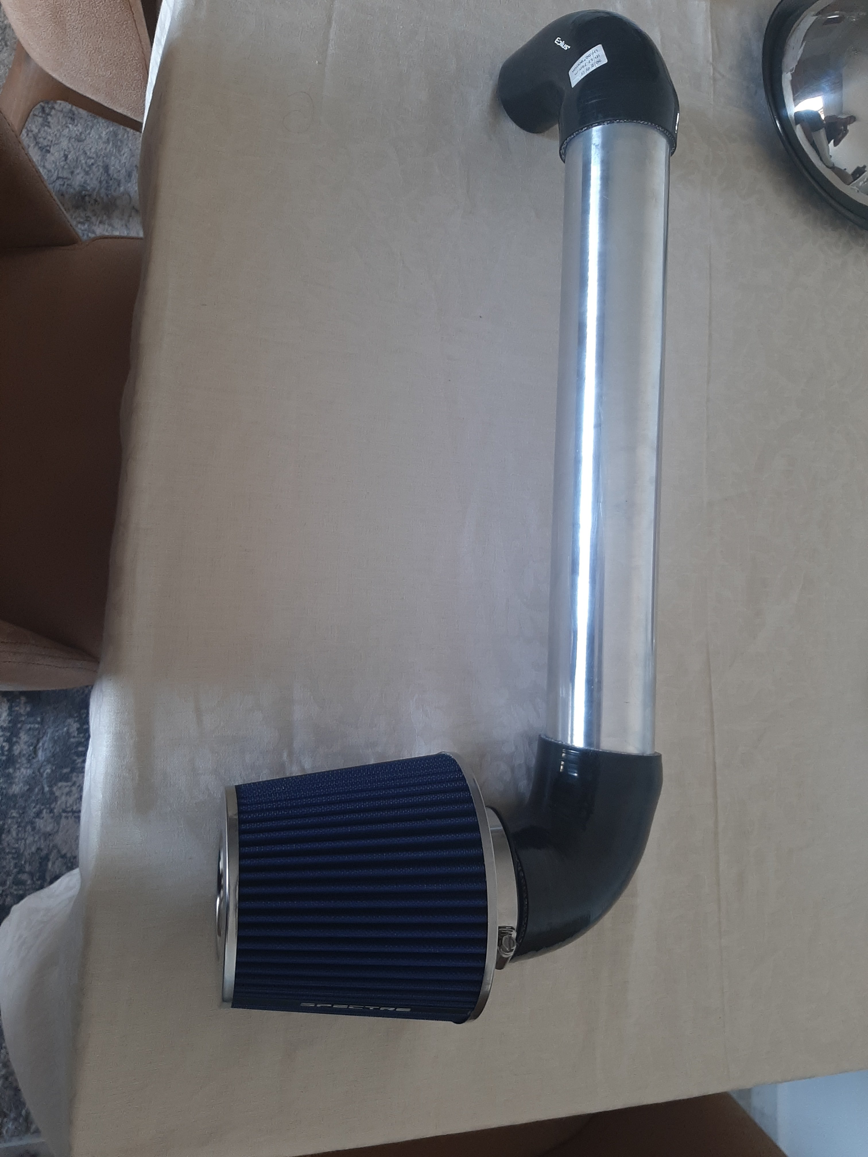

Hi guys , waiting for this bad boy to be fitted with a custom airbox ( mst style) :)
Anyways, do you guys know of any compatible turbo blanket ? The only ones i found were compatible with golf gti ,R , S3,Cupra.
(Why turbo blanket? :giggle: Well hotter hot side=quicker spool, and colder cold side=cooler air)

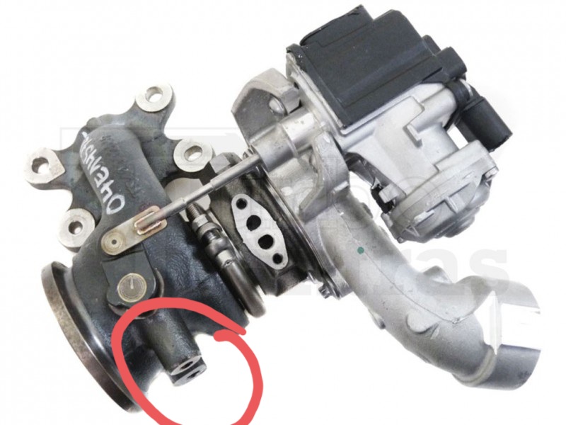

1.4 TSI Small Turbos - Avoid - Same size as the 1.2 TSI but with different shaped exhaust housing, you won't see any gains with these.
04E 145 721 E
04E 145 721 R
04E 145 713 N
04E 145 704 F
04E 145 704 R
1.4 TSI Large Turbos - Avoid - Has an additional sensor on the exhaust housing, stay away unless someone confirms it's removable and fits.
04E 145 721 C
04E 145 721 G
1.4 TSI Large Turbos - Avoid - These have a different type of Wastegate actuator, stay away unless someone confirms it works.
04E 145 722 G
04E 145 721 P
04E 145 715 B
04E 145 715 D
04E 145 715 E
04E 145 715 F
1.4 TSI Large Turbos - Best Choice - Matching Wastegate and confirmed working by myself and others.
