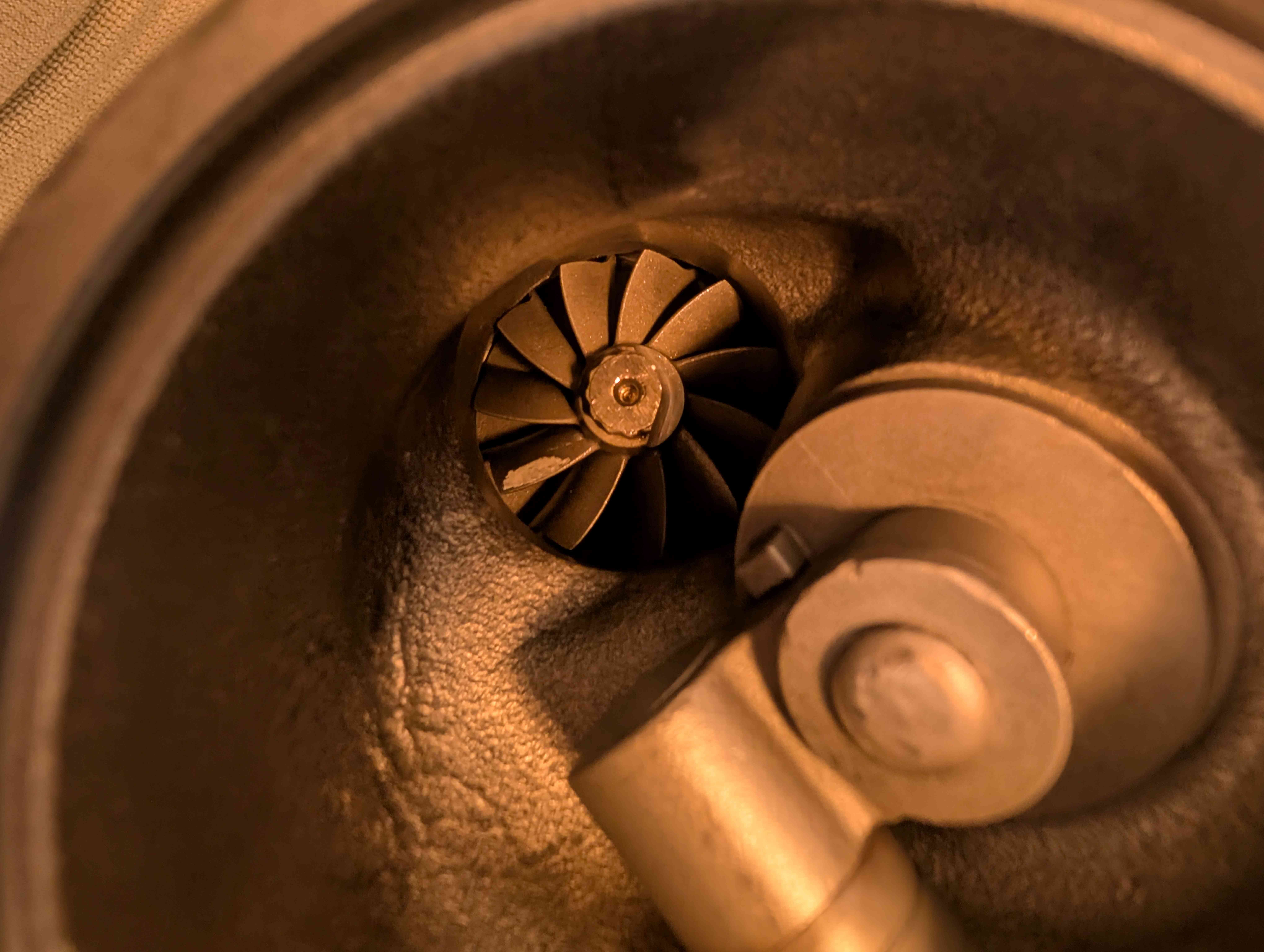

    Little update with my build, I folded and ordered an rtmg turbo and carbon intake. I fitted the turbo last week and tomorrow I'm taking a trip back to my tuner to get a cuatom map for it. Was at 183bh
  • Everything working perfect, your post on how to do it helped massive amounts. Had a little coolant leak after I fitted it but soon fixed that. Topped it up with water going to get some coolant in the

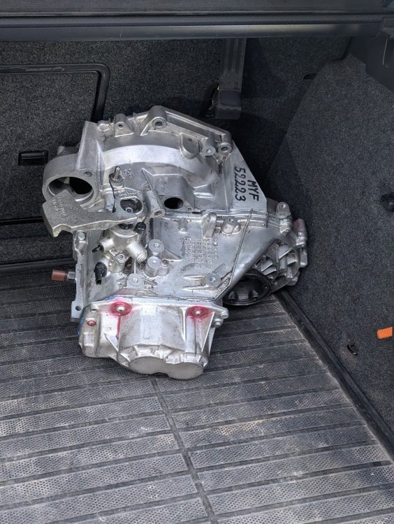

If you use the 140/150PS engine you will need to fit the MQ250 gearbox as its what they come with from the factory..or fit a much stronger MQ350...

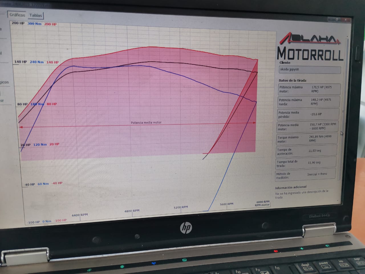

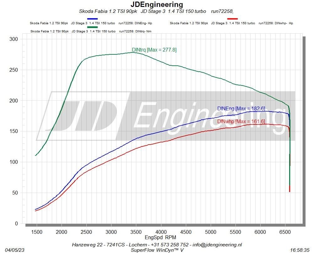

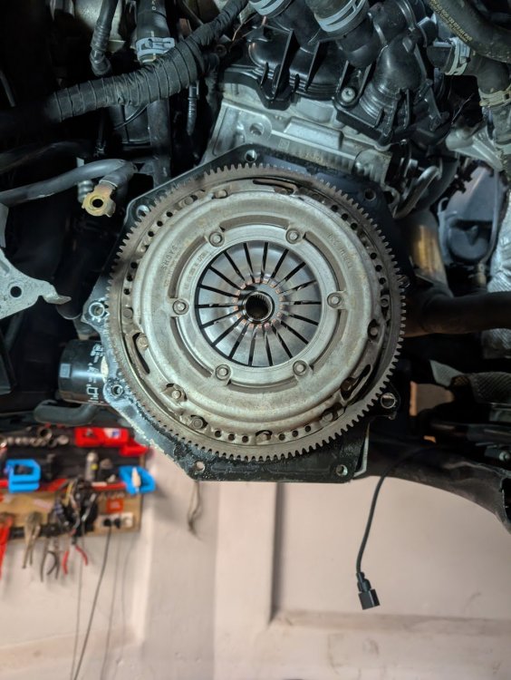

Hello, I have a 1.2tsi spaceback to which I put a 1.4tsi 150hp turbo, apr coils, downpipe, revo stage 1 reprogramming, intake forge motorsport and I have another car compared to the same stock.
That's nice and encouraging. Care to share more details?
What engine did you have? Which engine did you install? Where did you get it? How much did it cost?
Did you change the transmission too?
What issues did you have to overcome?
Edited by m1kemex
Can a moderator please delete my last post? I misread it. I thought Pedro had swapped te entire engine...
On 15/02/2023 at 01:01, m1kemex said:
A variable geometry turbo would probably solve this issue, and the first idea that comes to mind is to transplant the turbo from the new 1.5 TSI. However, there i still a mismatch of displacement (a larger one, in fact) and proper operation is not warranted. However, there is an alternative. The standard turbo design is modular and it seems like there is no necessity to alter either the turbine cartridge or the exhaust side of the casing. It should suffice, at least in theory, to built a custom intake casing with the variable flaps. Since this doesn't spin like the turbine, it doesn't require the same amount of accuracy, and it doesn't use exotic materials such as inconel. Therefore, it should be possible to build such a thing in a standard mechanical shop.
Just to give you guys an idea of what I'm talking about:

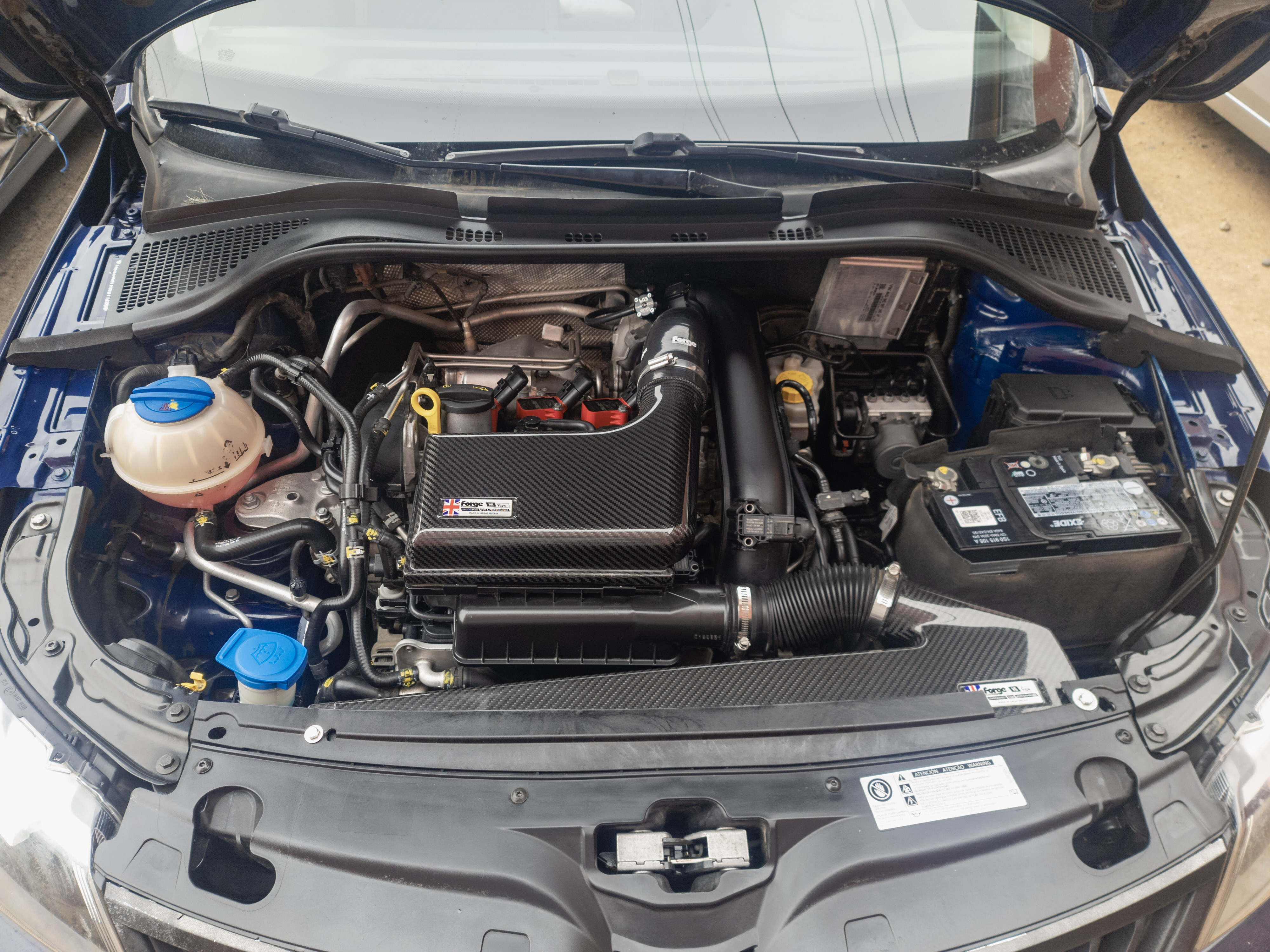

That is a nice intake! I thought they didn’t actually make this for the Fabia…as far as the bolts you used I guess that is right😂… How doe the APR coils feel ?

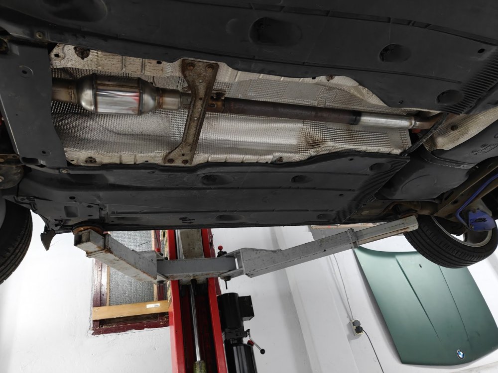

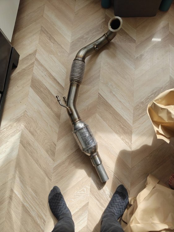

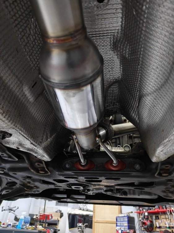

I finally got my car taken care off, I got the downpipe with a 200cell Cat the Forge intake and the bigger 1.4turbo..which resulted in just over 182hp and 277Nm. I am so happy with this, it just has become this fun sleeper car with just enough power to put a smile on your face. Although I wished there was a intercooler kit to keep it from heatsoaking in this hot conditions…but ah well can’t complain for that small engine. Ohw also I wished someone would have warned me that it would turn into Darth Vader with that intake😂 that will turn the heads of most people…

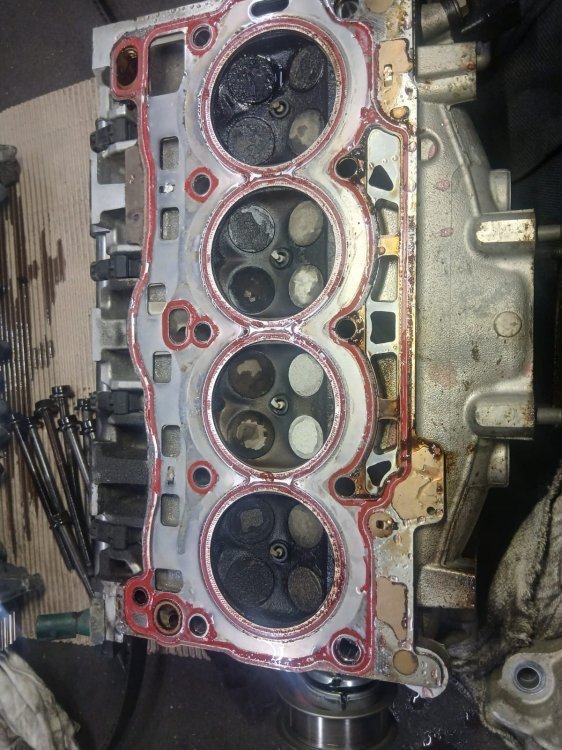

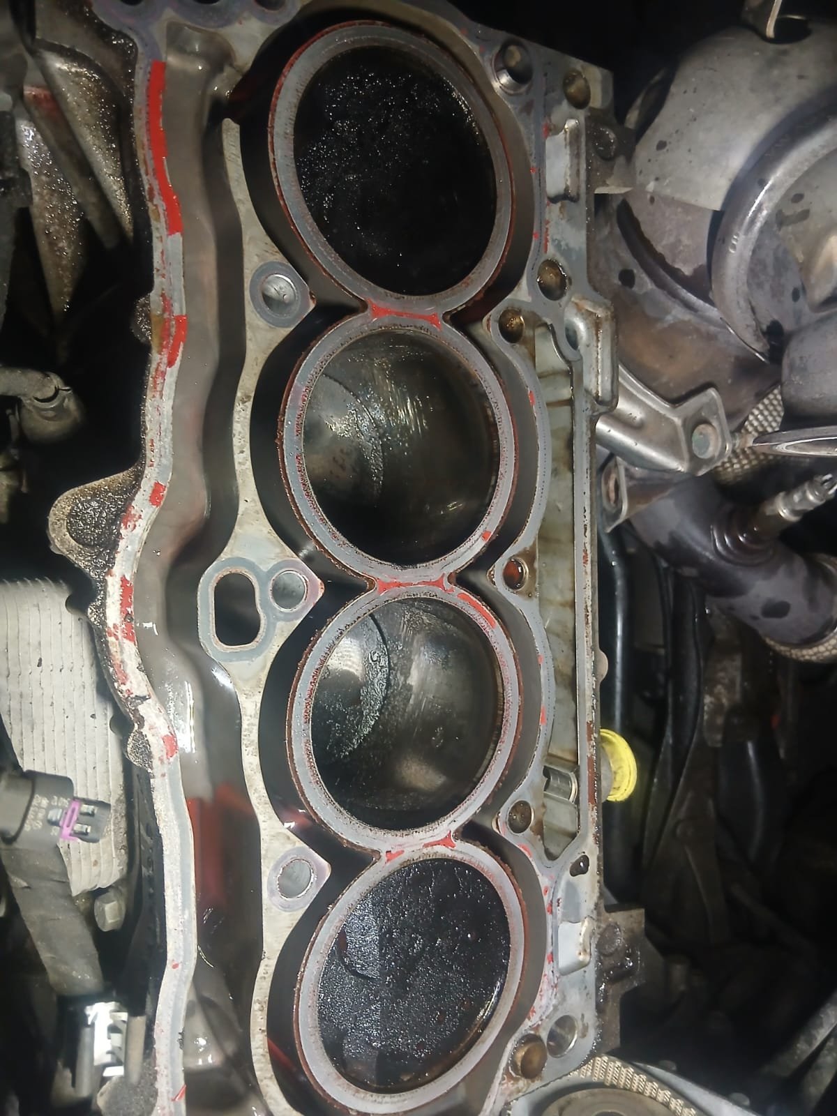

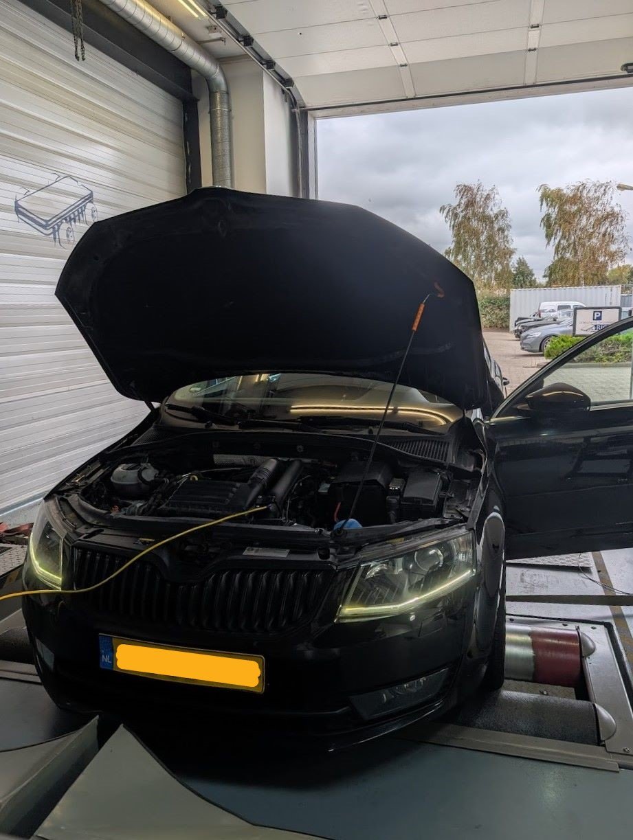

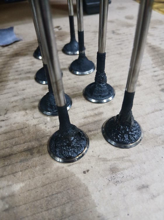

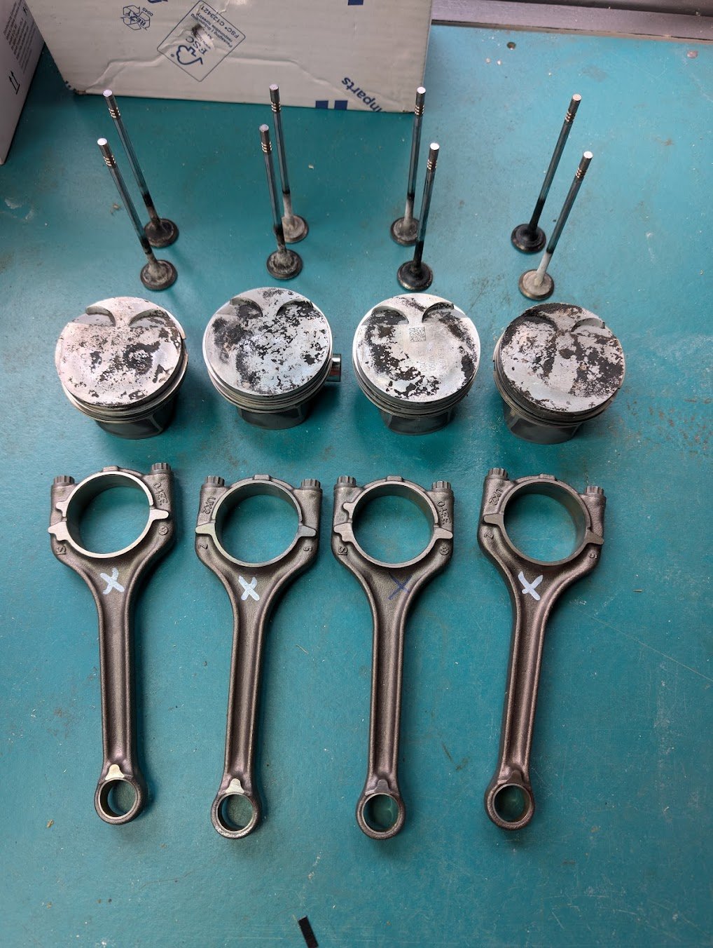

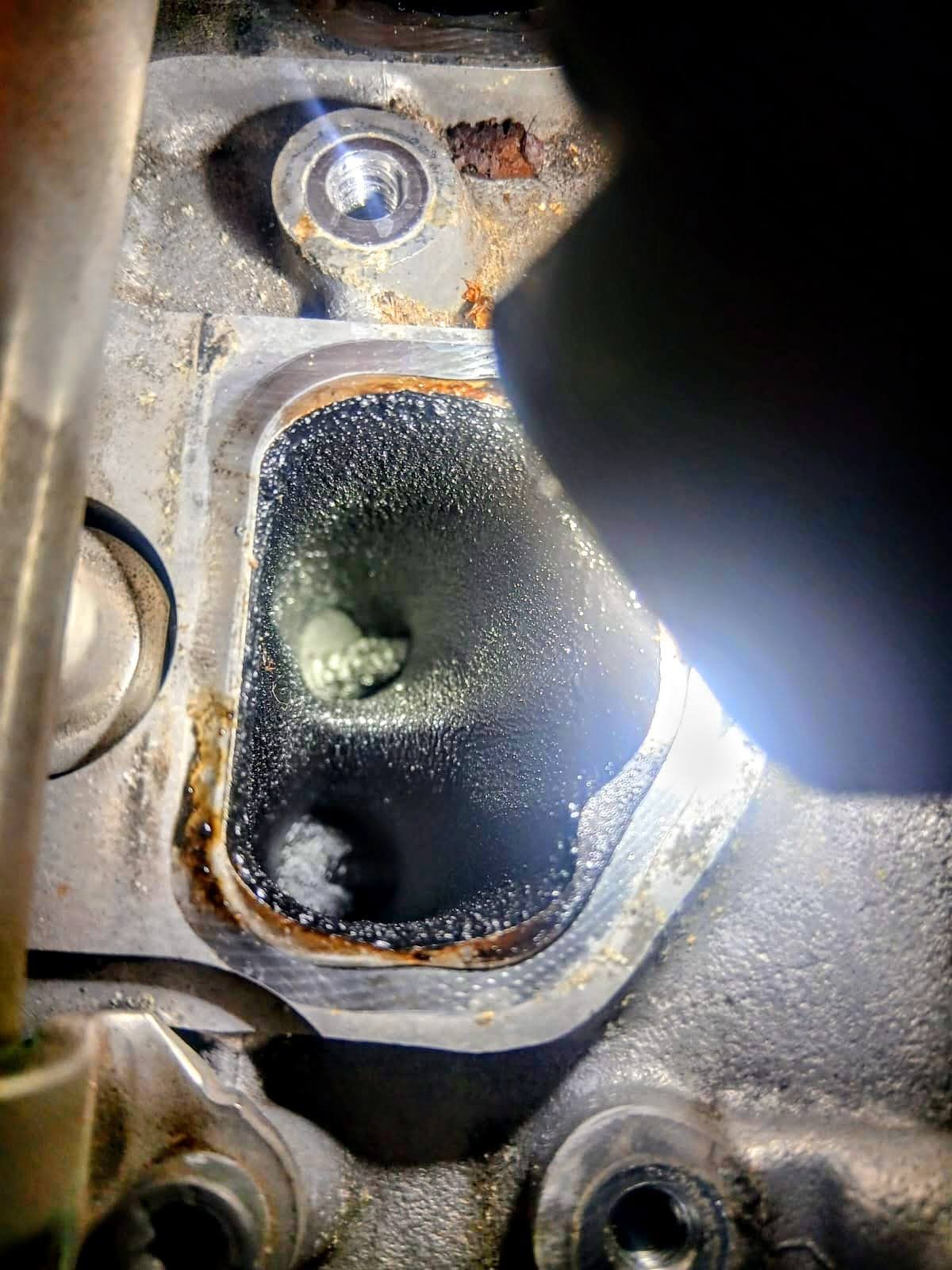

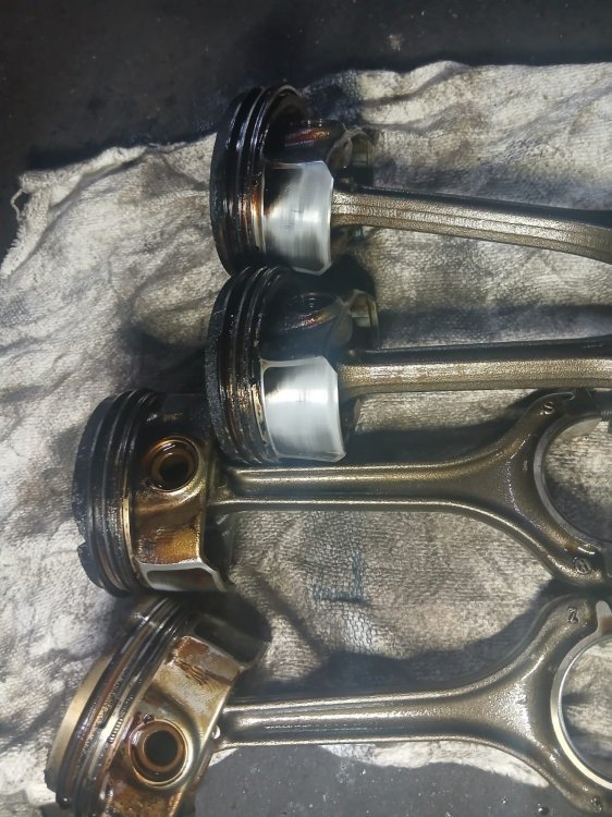

Bought an Octavia 3 1.2 TSI with 190.000km on the odo and oil consumption of 1L every 4.000km. I had it tuned to stage one, but this barely improved the power. Furthermore, there was a lot of detonation. My tuner changed the stage one map to fix these issues but the power never came. His conclusion was that the intake tract was completely gunked up. The oil consumption got worse over time untill it hit 1L every 1200km this summer.

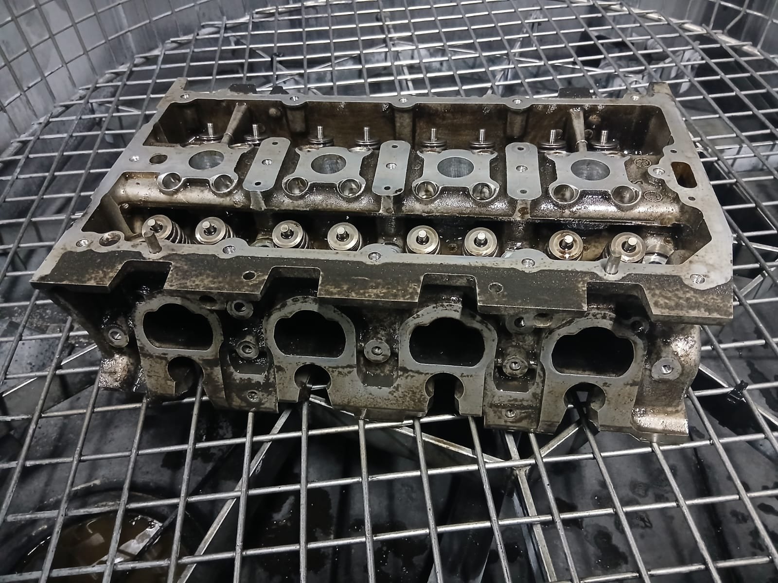

I contacted Biggelaar Motorservice in Nuenen (The Netherlands) to fix my oil consumption (https://www.biggelaar-service.nl/). He also installed a new hybrid turbocharger which I bought through my tuner, Rica Engineering Wateringen (https://rica.nl/nl/). When Biggelaar opened up the motor the damage was obvious. A completely gunked up intake tract, 8 burned up exhaust valves, 3 bent connecting rods and a lot of carbon deposits.
IMG-20250923-WA0008.jpgIMG-20250923-WA0014.thumb.jpg.d4ac90d194e362b0b83d5fb30703a7ee.jpgIMG-20250923-WA0011.thumb.jpg.8267185057091cee7a21ab05f1a1b5c2.jpg.01bae1e8bcc841cc1760efc366c19899.jpgIMG-20250923-WA0015.jpgIMG-20250923-WA0005.thumb.jpg.2afb7bbf8e8768559ed80961d96cc9dc.jpg.c13d514f9381465969616e0cac0b0dae.jpgIMG-20250923-WA0004-EDIT.jpgoverzicht.jpg

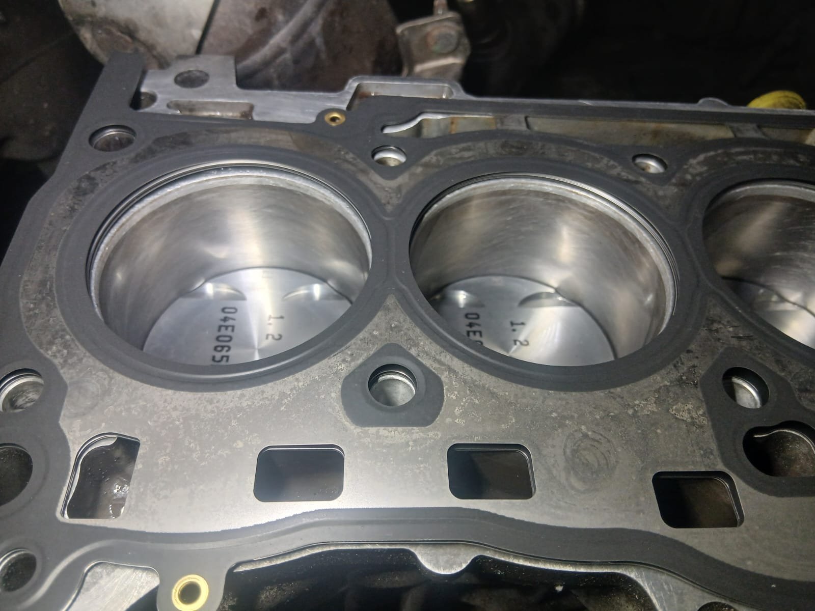

Biggelaar replaced the exhaust valves for 8 new ones, installed 4 new and modified pistons with upgraded oil scrape rings and replaced the bent connecting rods for new ones. Unfortunately we couldn't find any upgraded connecting rods for the 1.2 TSI.

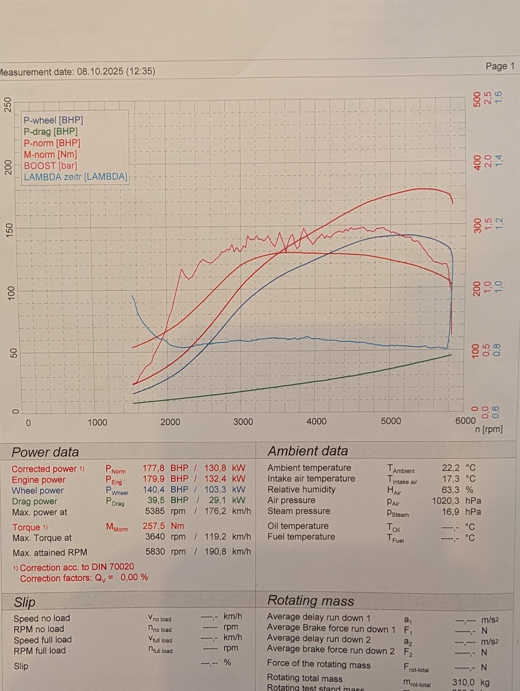

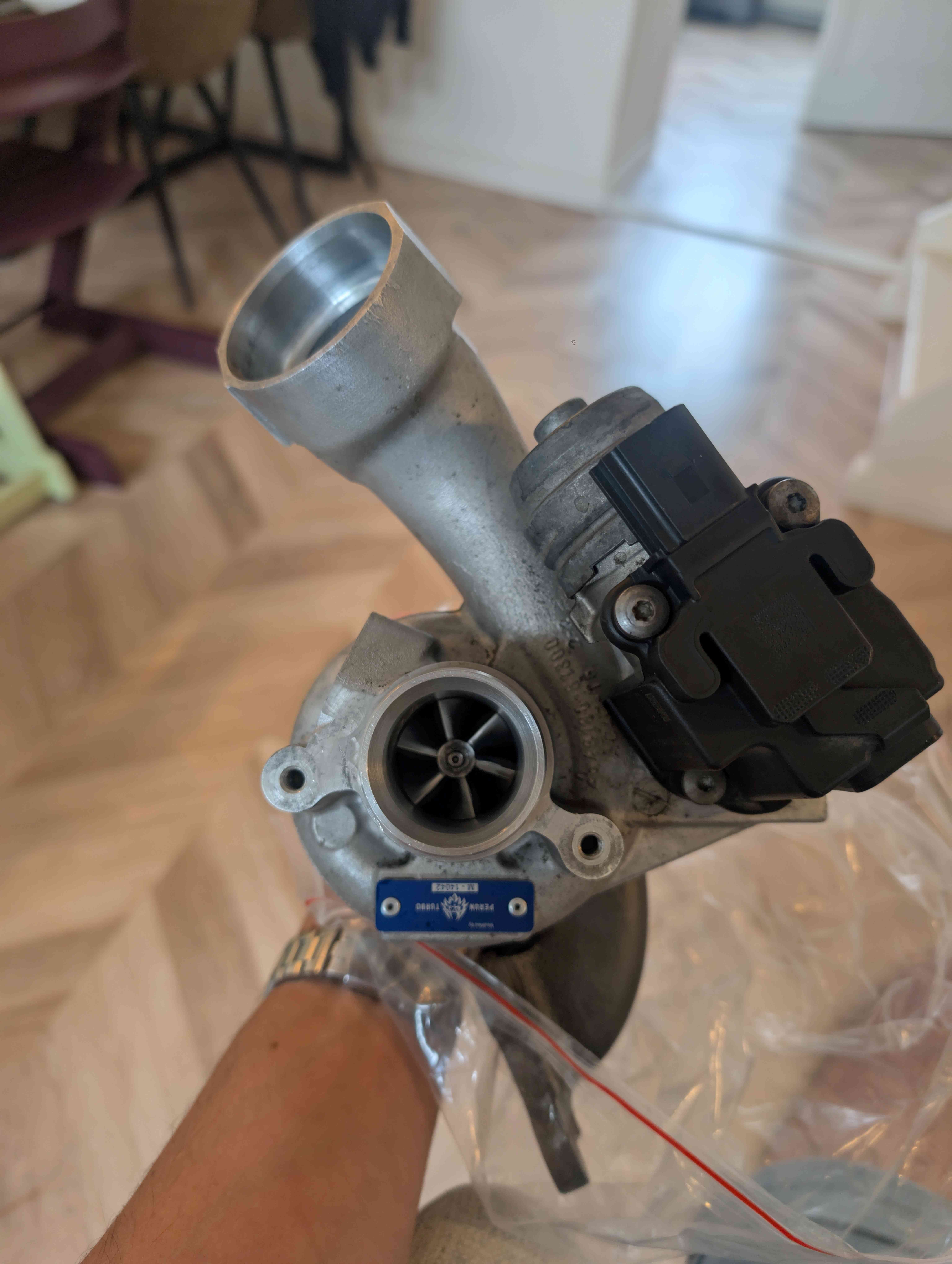

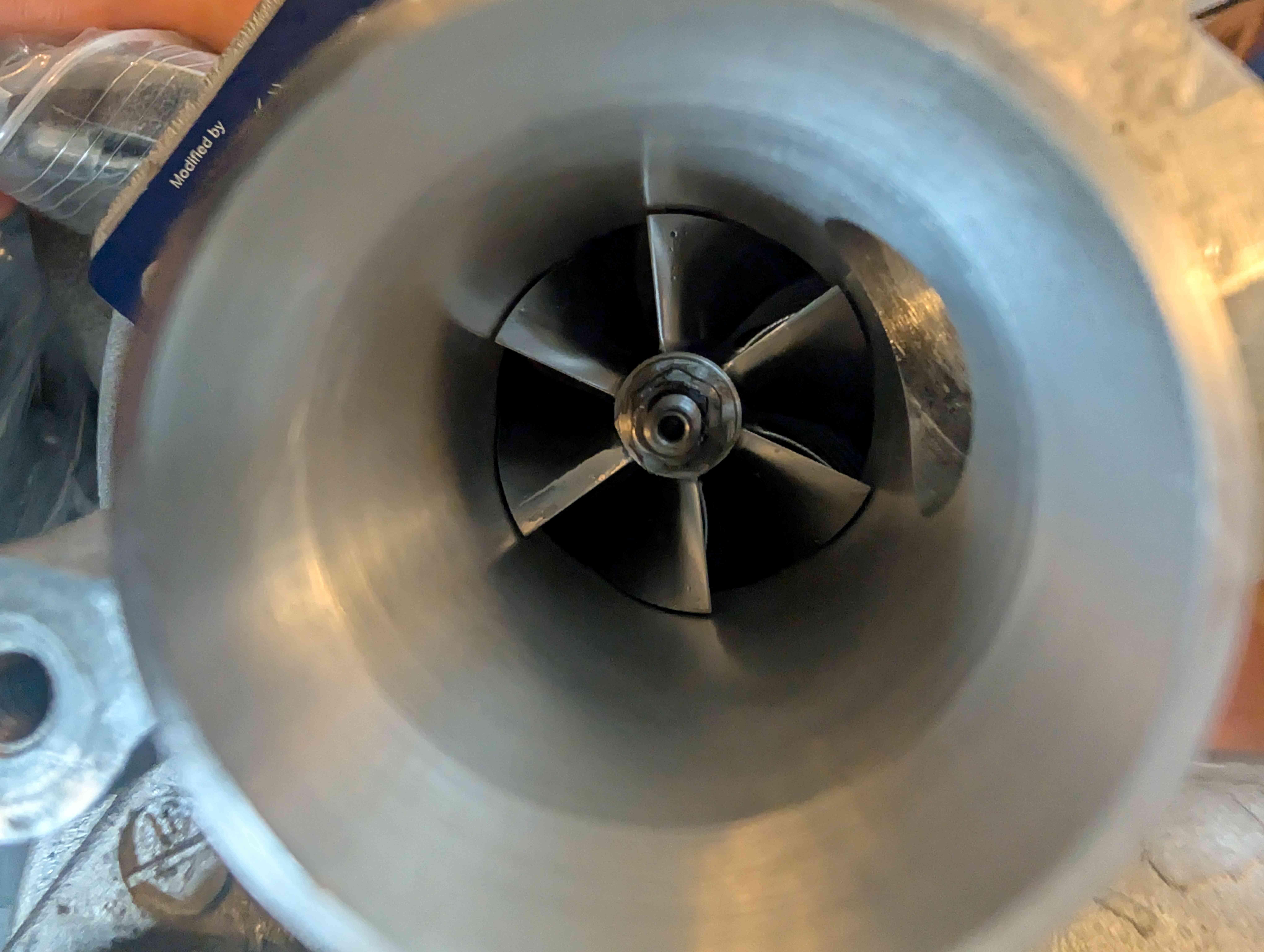

He also installed a hybrid turbocharger which I brought along. This turbocharger was purchased through my tuner Rica Engineering.
PXL_20250920_145247137.jpgPXL_20250920_145250984~2.jpgPXL_20250920_144155729.jpgPXL_20250920_144142536.jpg

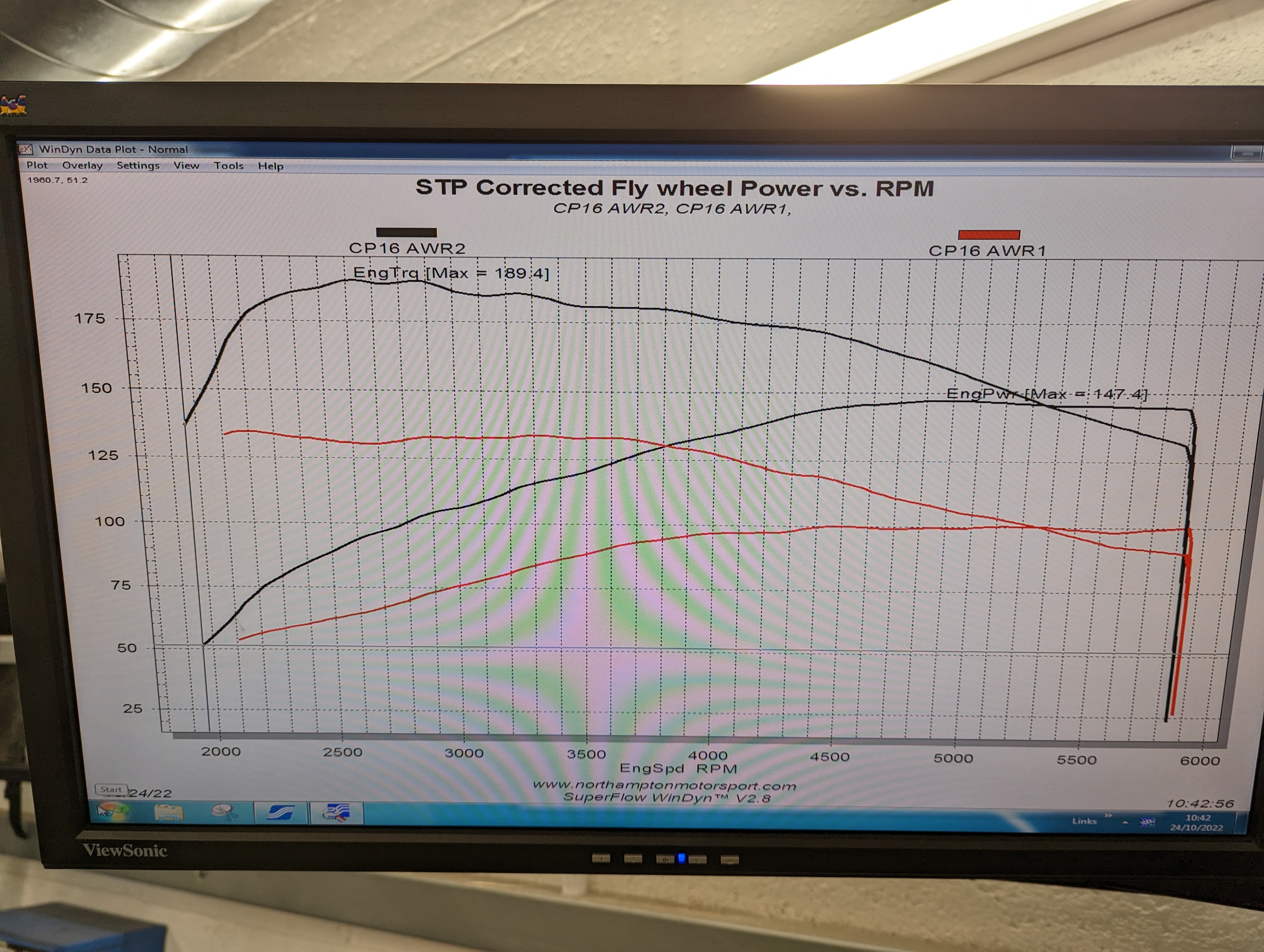

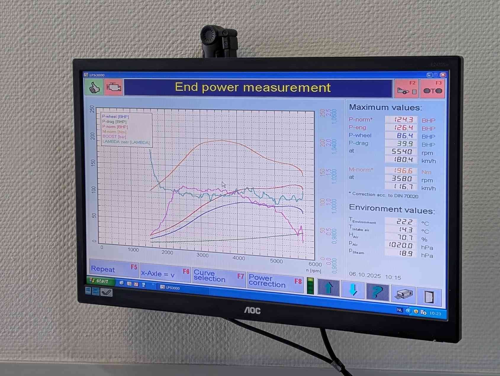

After doing a good 1000km (easy going, letting the new rings settle etc. etc.) I went back to the tuner to get the hybrid turbo mapped. The first run showed that the stage 1 map with the hybrid turbo only delivered 124hp. This is due to the changes that my tuner made to the stage 1 map when we found out that my car was detonating.
After a lot of back and forth the tuner finally got the lambda values where he wanted them. He then started feeding in the power. As you can see on the dynograph below (the final result) the turbo shoots up to 1.1 / 1.15 bar as quickly as possible at 2200 rpm. After that, the turbo pressure build-up is slowed, to reach a maximum of +/- 1.4/1.5 bar at 3200 rpm. This slower pressure build-up (hopefully) prevents the connecting rods from bending again. 'The internet' says these connecting rods can handle 280nm, my tuner indicated that he could achieve that if we let the torque hit full force at 2200-2400 rpm. Because of my previous experience with these 1.2 connecting rods I didn't want to push it, so my tuner kept max torque below 260nm and spread the torque out over a greater area.
That doesn't take away from the fact that the car now drives really nicely, these power figures work very well for this 1150kg car.

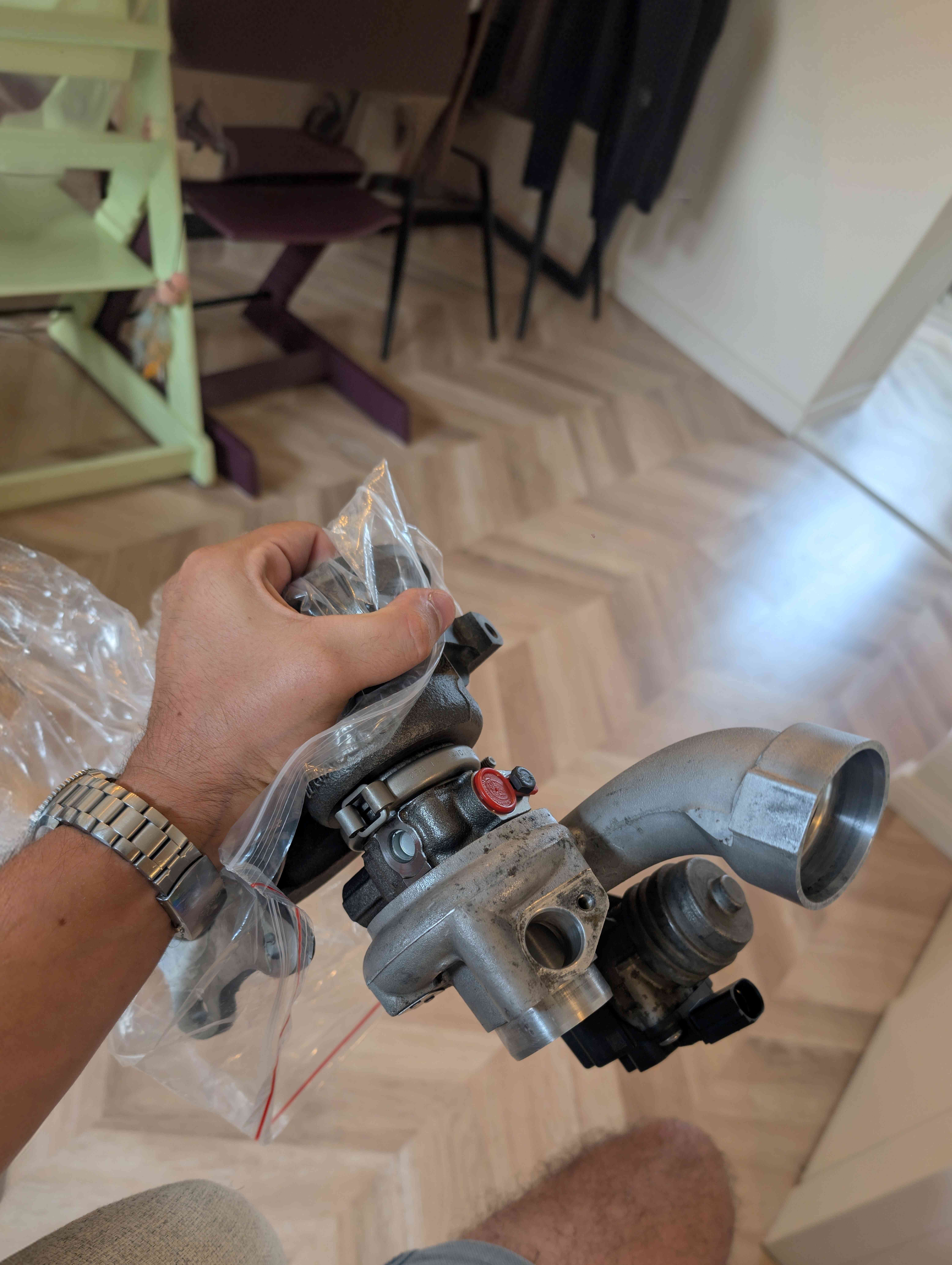

Good evening, I am new to your group and new to improvements. I read your articles and I am really happy to have become a member of such a group!! I have a seat ibiza cjzd 1.2 110hp 2017. I have made a downpipe by removing the pre-catalyst. I have upgraded with a ramair intake and as for the engine cooling, I have installed an avt. I am looking to upgrade the turbo. I read about the options
04E 145 721 B
04E 145 721 F
04E 145 704 C
04E 145 704 P
I have found 04E 145 704 P in very good condition but I also read that a member installed 04E 145 722 G no problem. what are your opinions?

I am now running a hybrid turbo on my new engine build which is using the same actuator style as the 722G model. It works without issue, and if anything, boost control is actually smoother with less overshoot but that may be due to the much larger turbo.
My engine also gained an extra 300cc since i last posted 👀
Thank you for your answer.I finally decided to pull the trigger on an 04E 145 704 P unit as I found one in mint condition and managed to get a great deal on it.I opted for this model to have peace of mind regarding 100% compatibility with my ECU and actuator.
I hope I made the right call and won't regret not going for the 04E 145 722 G (150hp version). Given my current setup (AVT radiator, downpipe pre cat delete) do you think the 704P is the most balanced choice for a reliable Stage 3 or did I leave too much power on the table?
