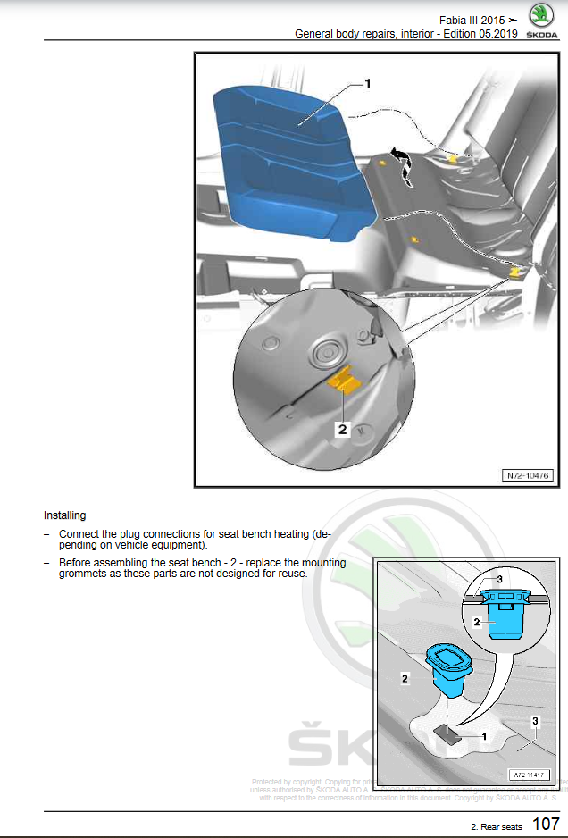

Word of warning. If you remove the bottom seats. You will need a full set of new clips. They brake/snap when you remove the seat.

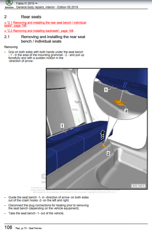

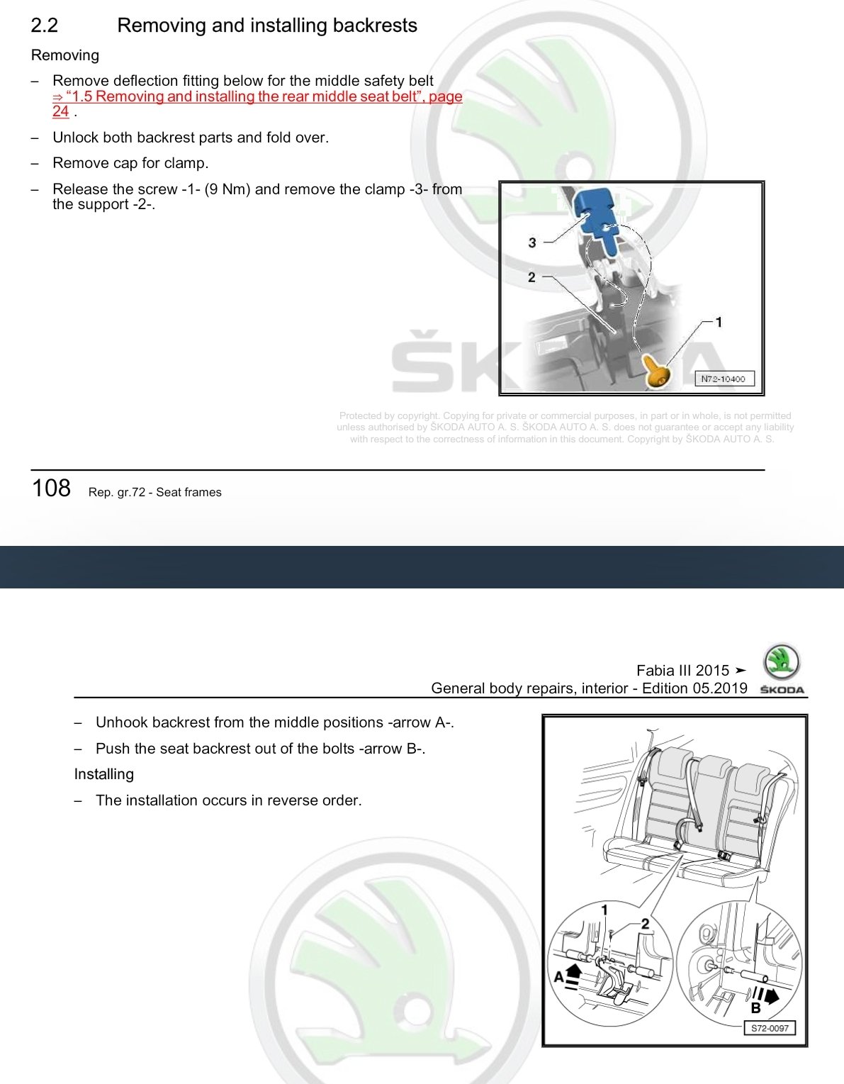

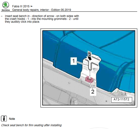

For removing the backrest for the rear bench seats, see the workshop manual section below:
