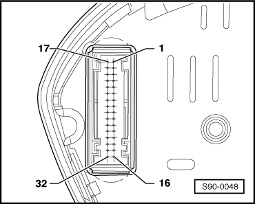

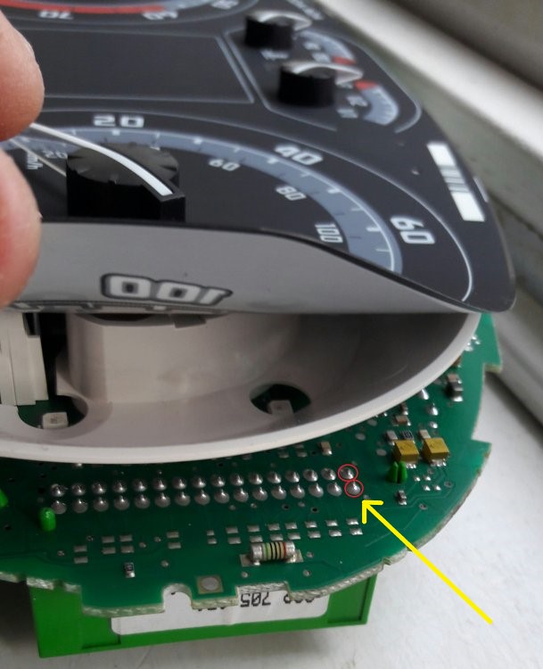

Does the immobiliser light flash? If so, it could be cracked solder joints on the instrument cluster circuit board, which is not uncommon. They can make intermittent contact and be affected by ambient temperature. Take the cluster out and open it up to check for cracked joints which you can reflow with a soldering iron.
Instructions for removing and opening the cluster can be found in this thread (scroll down on the page)...
https://www.briskoda.net/forums/topic/381391-service-reset/page/2/
Pins 1 &17 are the immobiliser joints....
Spray instrument cluster pins and plugs with contact cleaner on refitting.
