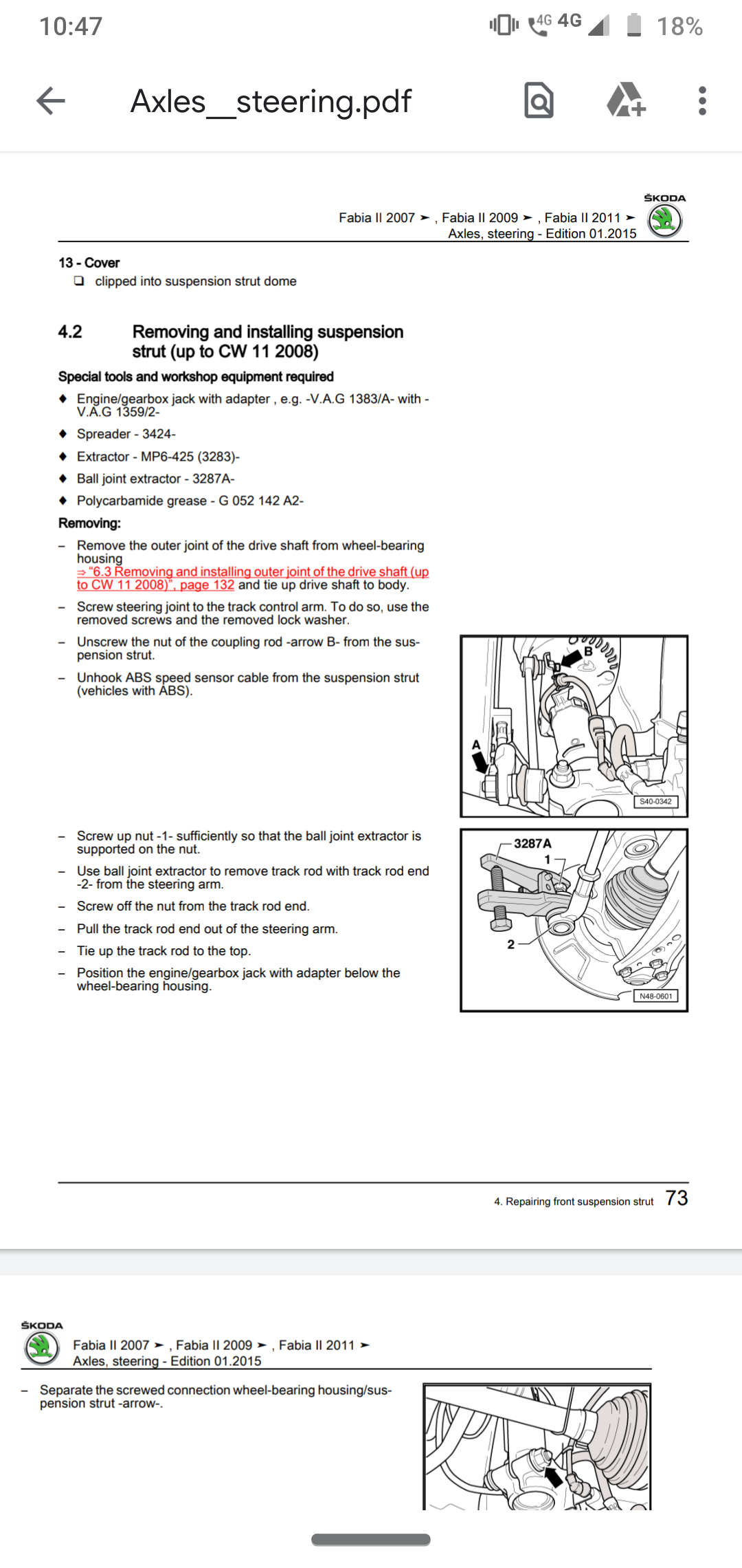

Looking at my manual it's showing that you have to separate the drive shaft to get the strut out.
I've ordered 2 new hub nuts from eBay.
I was hoping I wouldn't of had too but then again it might be easier to strip the steering knuckle apart from the strut and then undo the 3 bolts at the top and take it out attached to the knuckle.

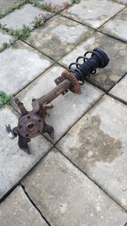

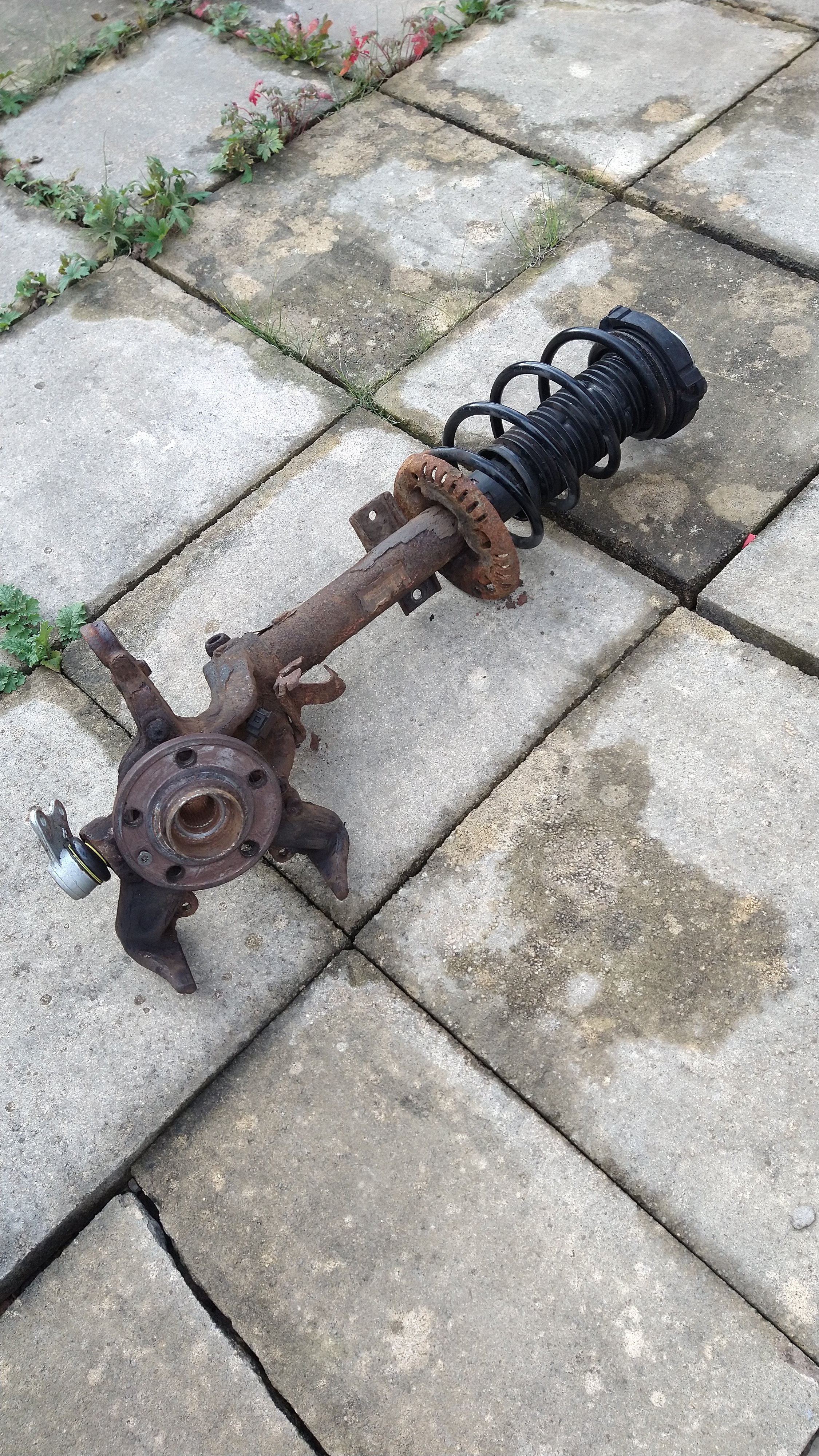

When I got the car last year it had brand new springs on so I only replaced the shock and mount and moved the spring over, I put it on the same way as I took it off the old shock, I checked the ends and they was still coated in paint so there was no broken ends. It did look abit odd shaped when I put them and the same when I was taking them off. I noticed the flattest end of the spring was at the top so I was assuming it was the right way up. It's either upside down or the wrong spring for the car, I guess I'll live and learn. This it what it looked like on the old shock
And it was the same spring on the new shock. It definitely looks odd. I thought it might have balanced itself when when it's got weight on it but nope.
Yes, the spring looks canted over in both pictures, I've forgotten what the underside of the top bearing looks like on that version of strut, ie how it centralises the top coil of the spring wrt the damper axis.

Yeah it's definitely off centre. I've seen photos on eBay of the full struts from the scrap yards and the spring looks to be sat a lot more comfy than this one.

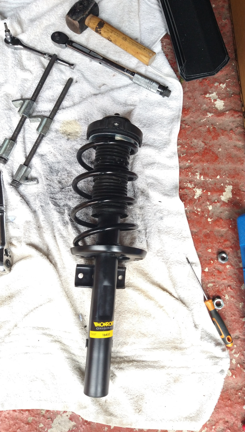

I've just seen some Monroe springs for £29 each hopefully luckily it will be sorted then.
Good, it will be interesting to see what these Monroe springs look like when compared to what you have fitted.
Yeah hopefully they will be sat well :)
