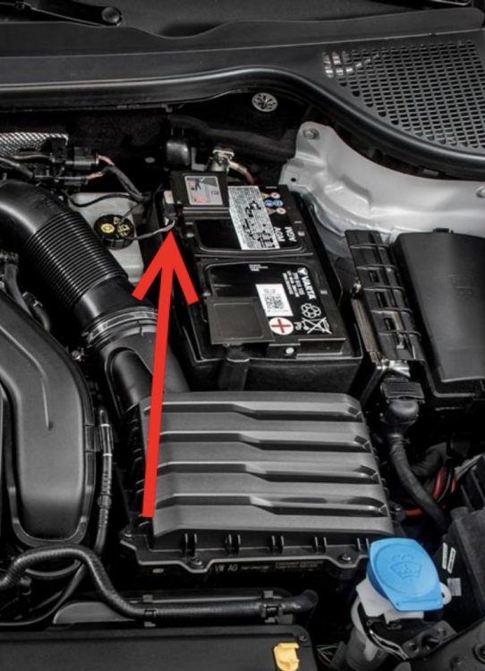

If the connector arrowed below is loose or not fitted into the battery clamp, it will affect S/S operation.

The connector is tight
