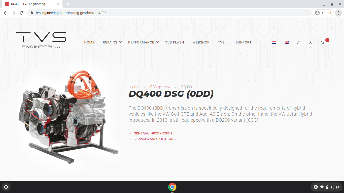

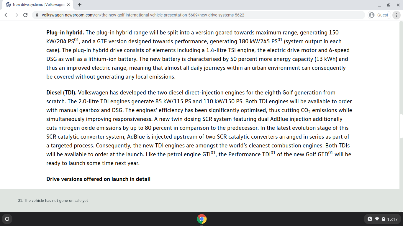

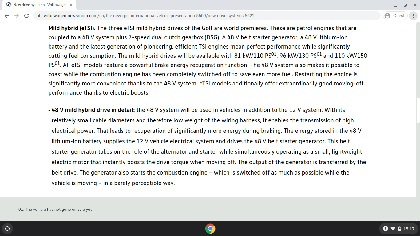

All you can assume is that they have the DSG that starts with e- before the code.  e-DQ200, e-DQ400 etc.
To suit the 1.0 & 1.5 TSI Mild hybrids then the ones to suit the Plug in Hybrids.
