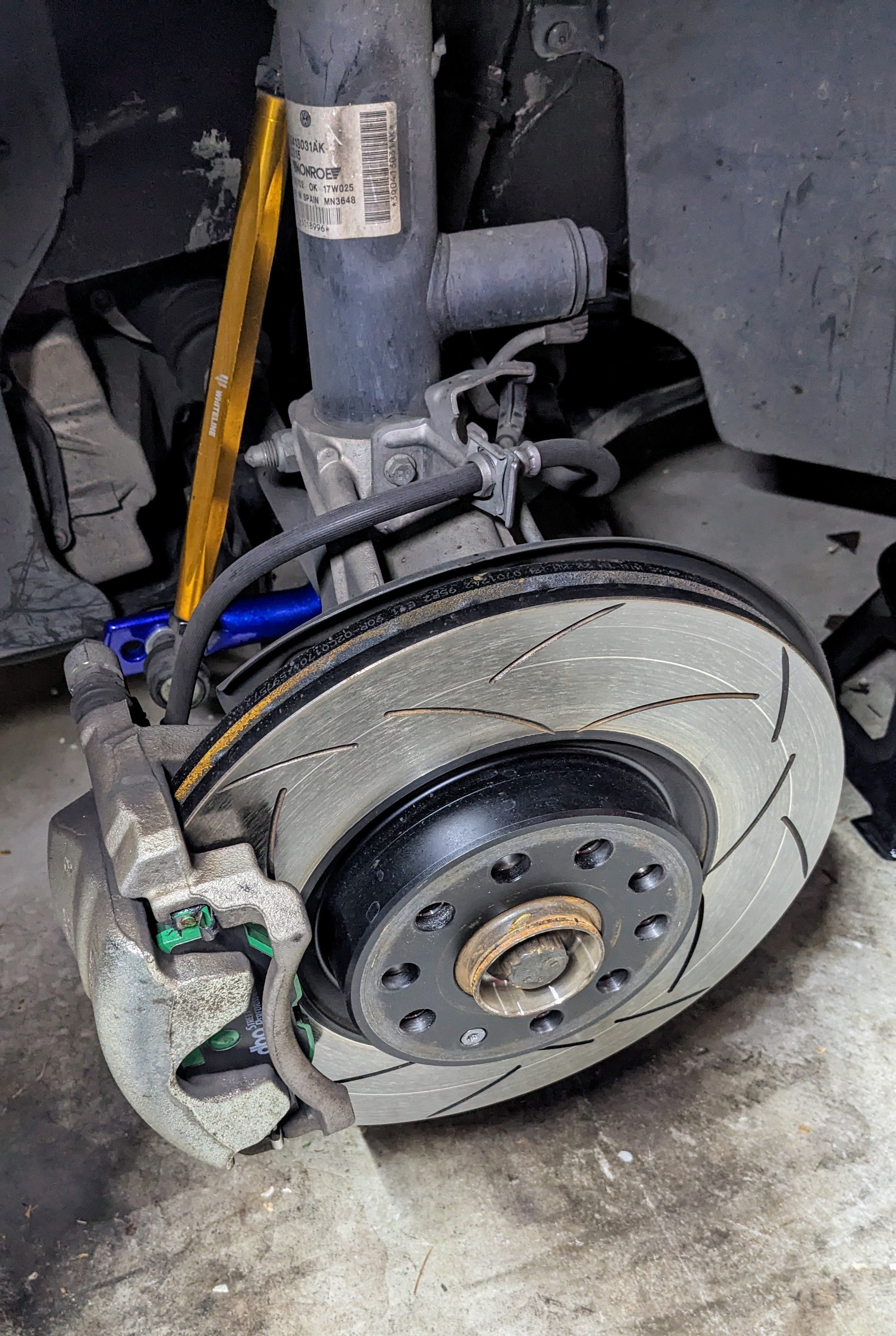

90k kms later, Gandalf's factory brakes were starting to run low, so I decided to change all 4 corners for DBA Rotors and Pads.
Front - DBA2806S slotted rotors + DB2384SP Performance pads.
Rear - DBA2837E plain rotors + DB2384SS pads.

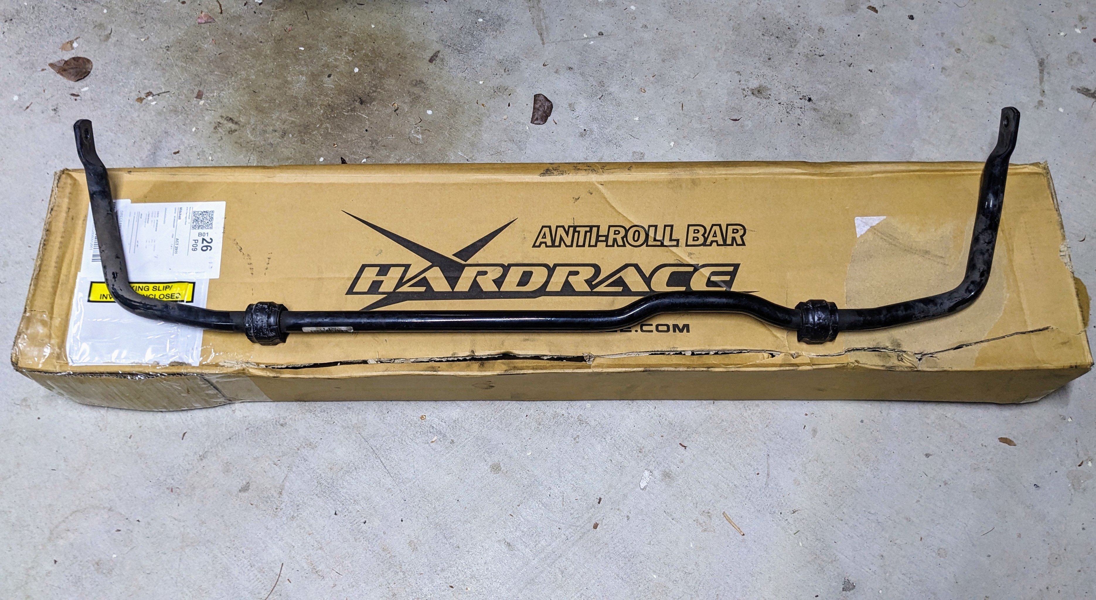

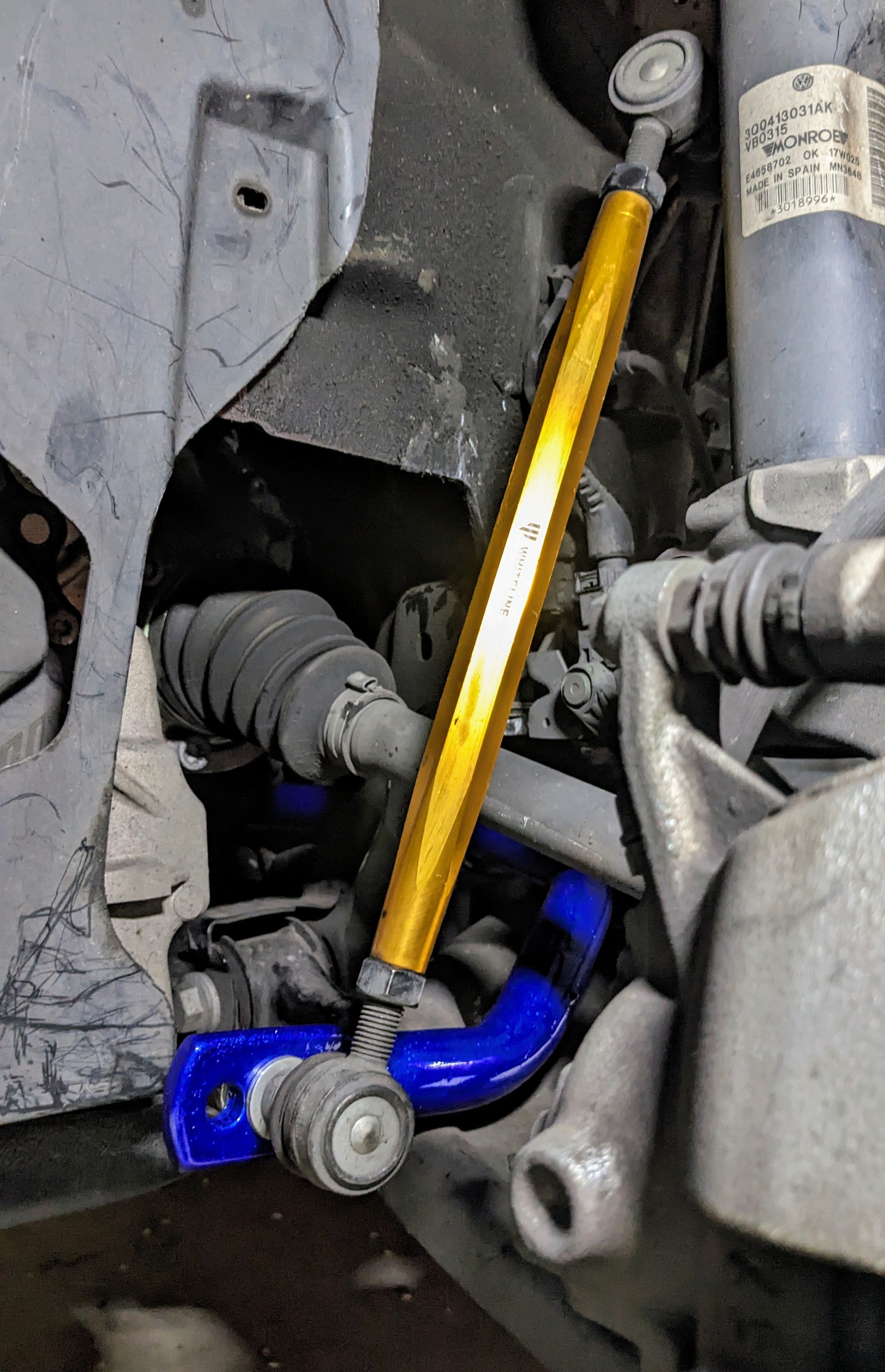

The Hardrace front swaybar (7758) is in. 28mm.
Car feels a lot more tighter, making corners flat n easy 😁
Did a wheel alignment as well as they had dropped the sub-frame.
All good.
It nicely compliments the existing Hardrace rear swaybar (7759) and front strut tower brace (8949).
The original factory one.....
Edited by JR RS

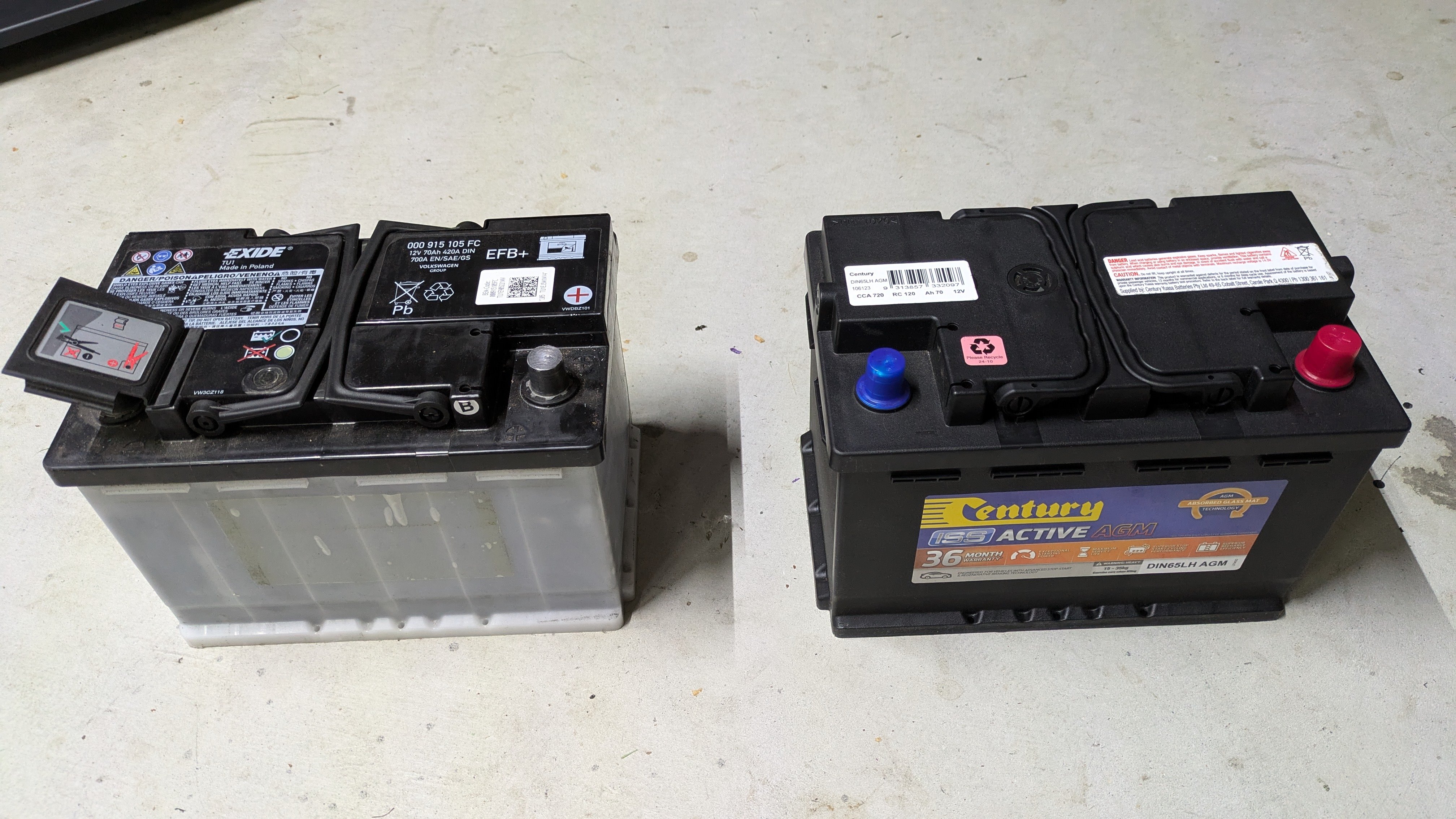

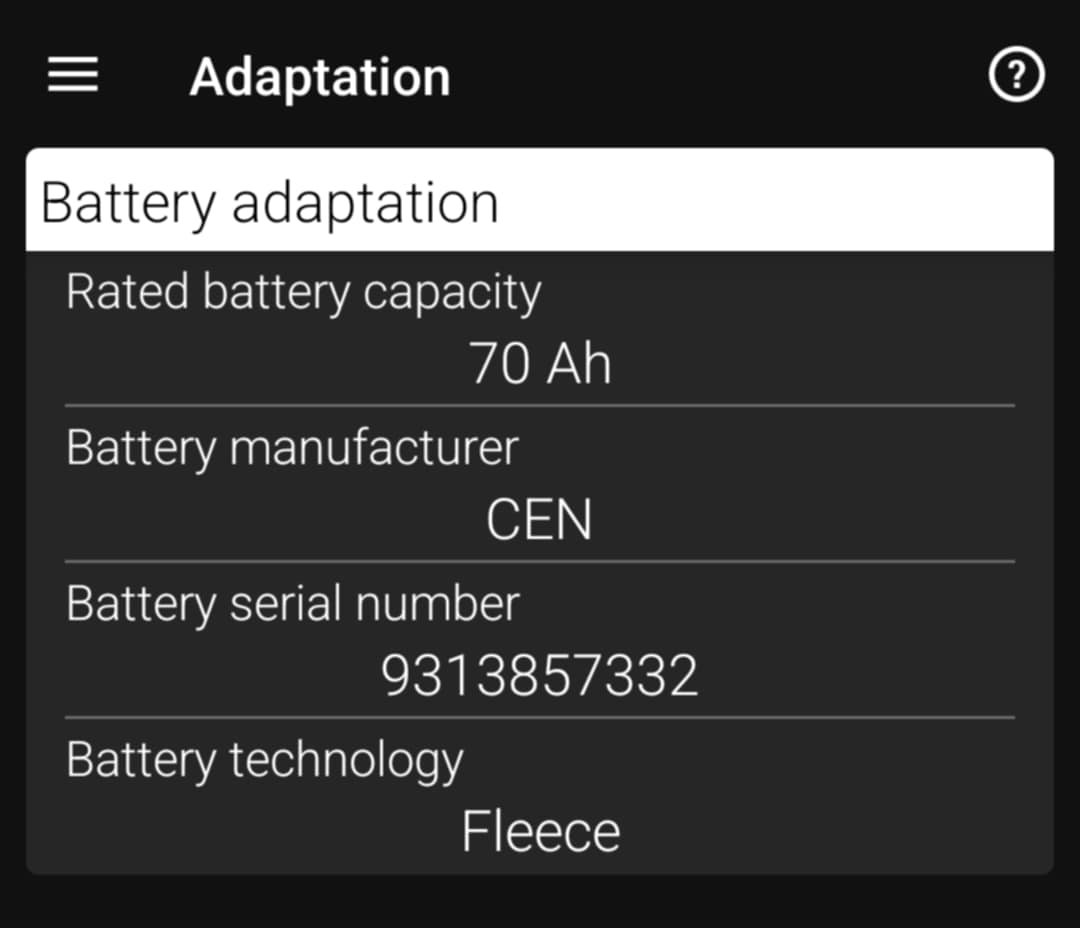

After almost 4.5 yrs, Gandalf's battery was showing signs of weakness when cracking the engine.
So I replaced the Exide EFB+ battery with a Century ISS Active AGM battery.
Old: 12v 70ah 700CCA EFB+
New: 12v 70ah 720CCA AGM
Did the Battery Adaptation too, changing it to Fleece.

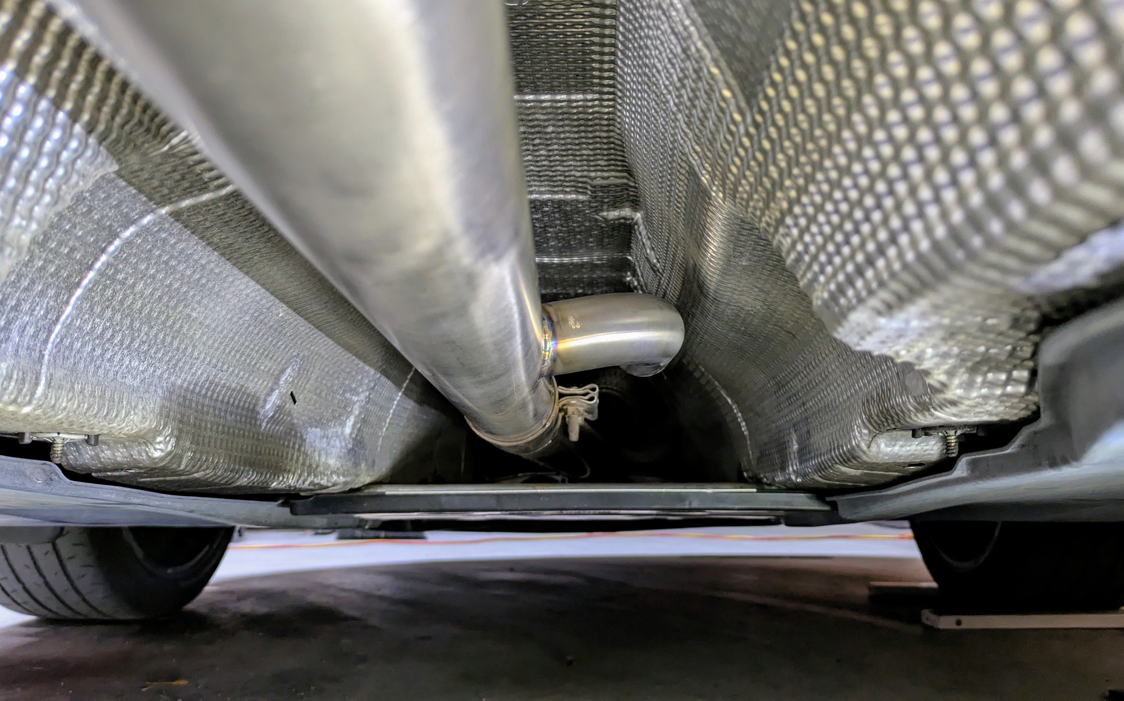

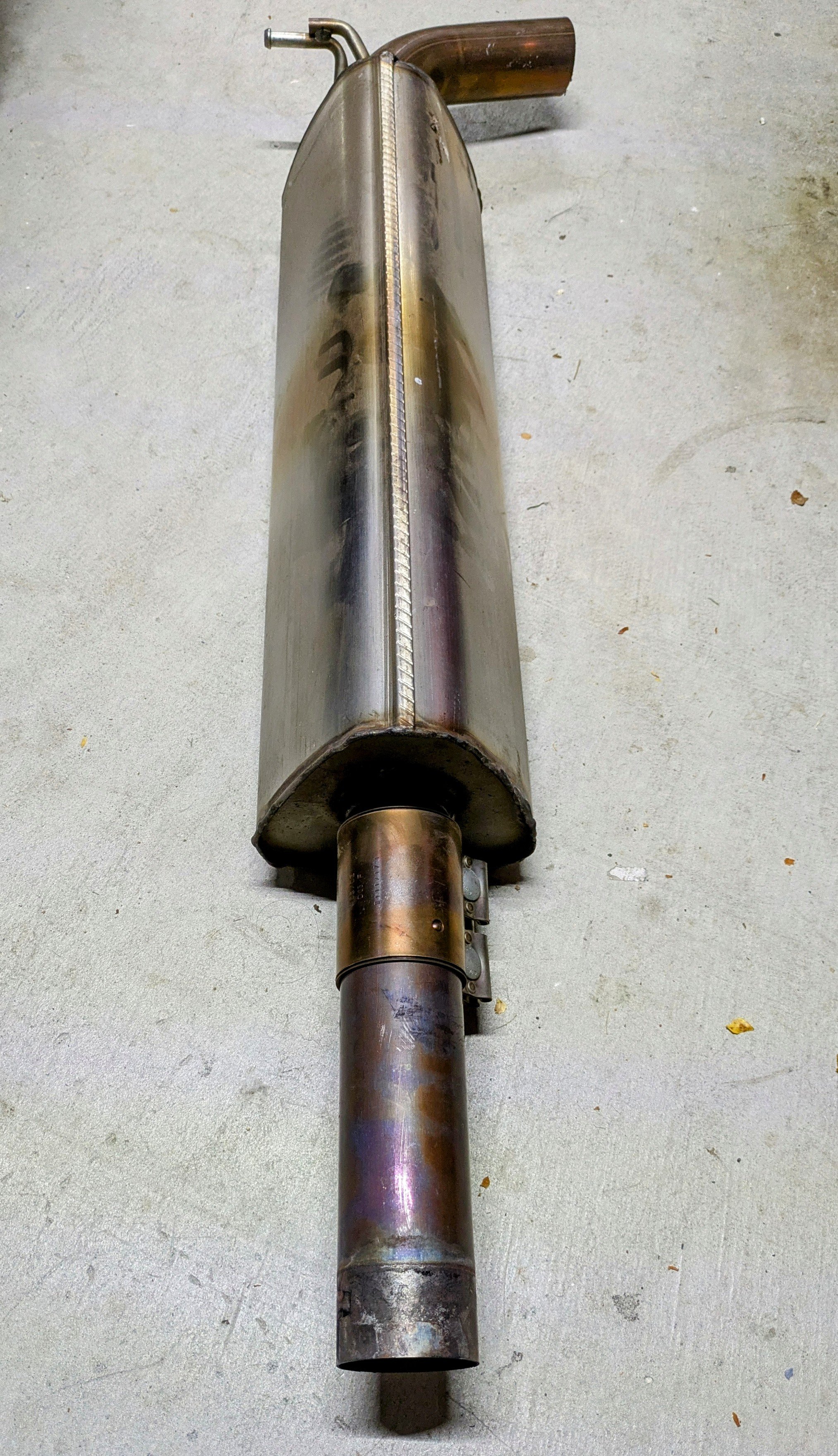

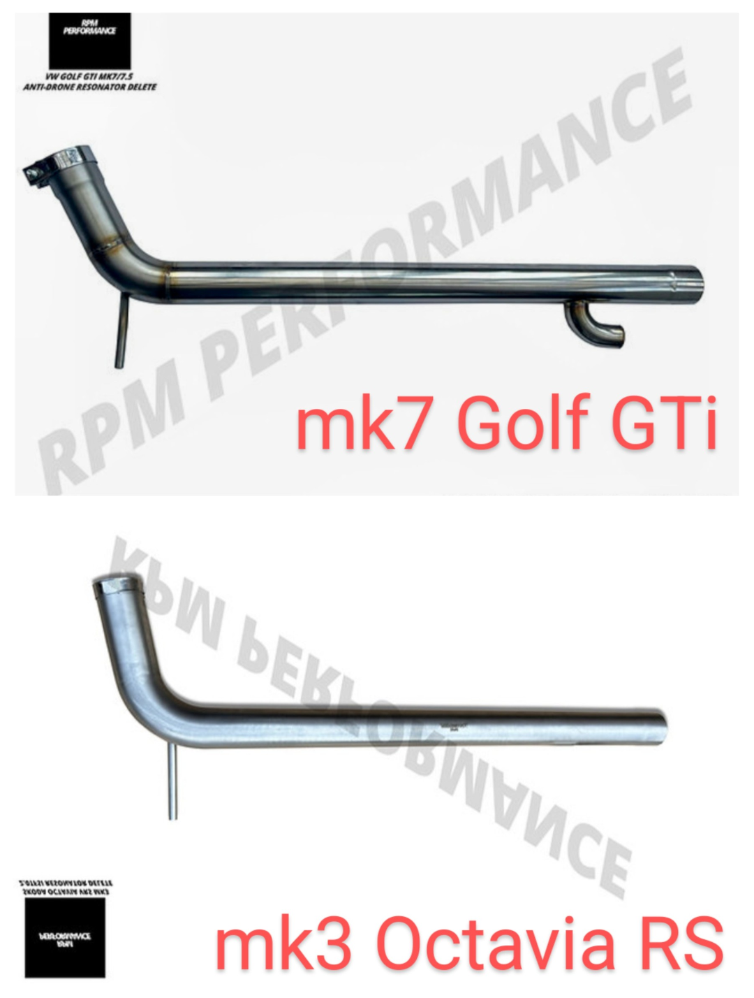

So after an initial failed attempt 6 months ago, thinking the mk7 Golf GTi resonator delete pipe will fit on the mk3 Superb (FWD), which it doesn't cause wrong length and bend angles - I ended up getting the version designed for the mk3 Octavia RS.
It's the RPM Performance Anti-drone (Helmholtz) Resonator Delete Pipe, which I had fitted on Gandalf earlier this week.
There is a nice subtle increase in exhaust note, no drama. My biggest relief is that there is absolutely no drone, at any speeds.
No farts or crackles, but I wasn't expecting that.
Fitment wasn't 100%. The factory downpipe end was easy, with the slip on clamp. However the rear end had to be welded on as the catback pipe end was the same thickness as the resonator delete pipe - hence couldn't use the slip on clamp.
Overall happy with the Anti-drone Resonator Delete Pipe.
Comparison.....
The delete pipe...
Fitted...
Factory resonator removed..
Video of the resonator delete pipe fitted...

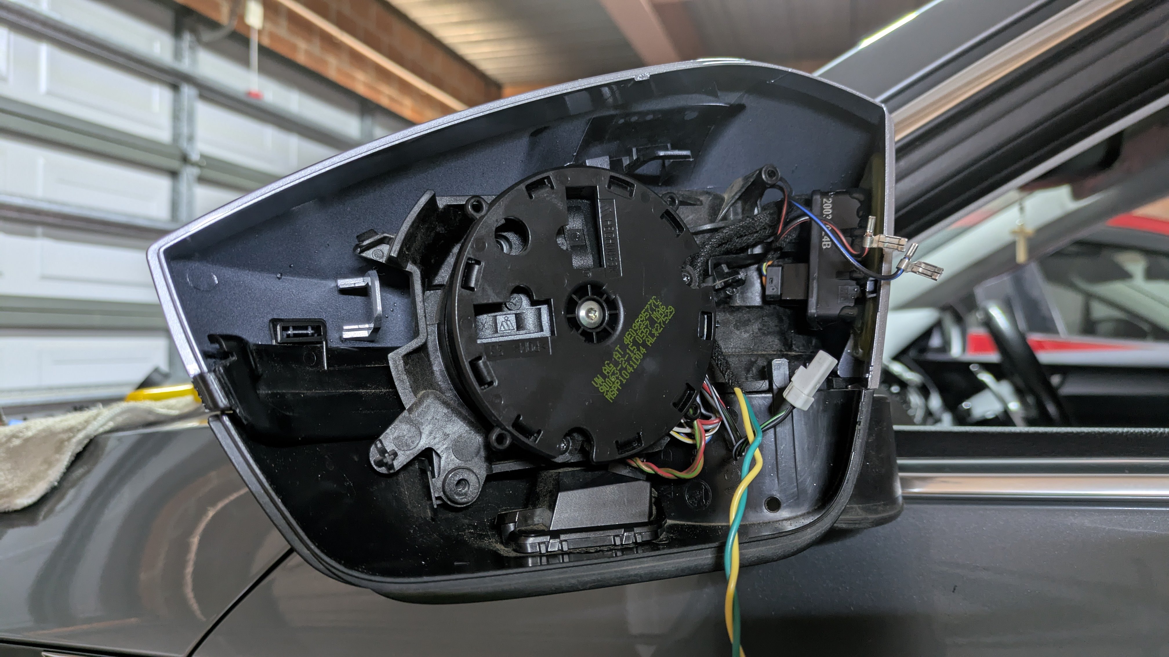

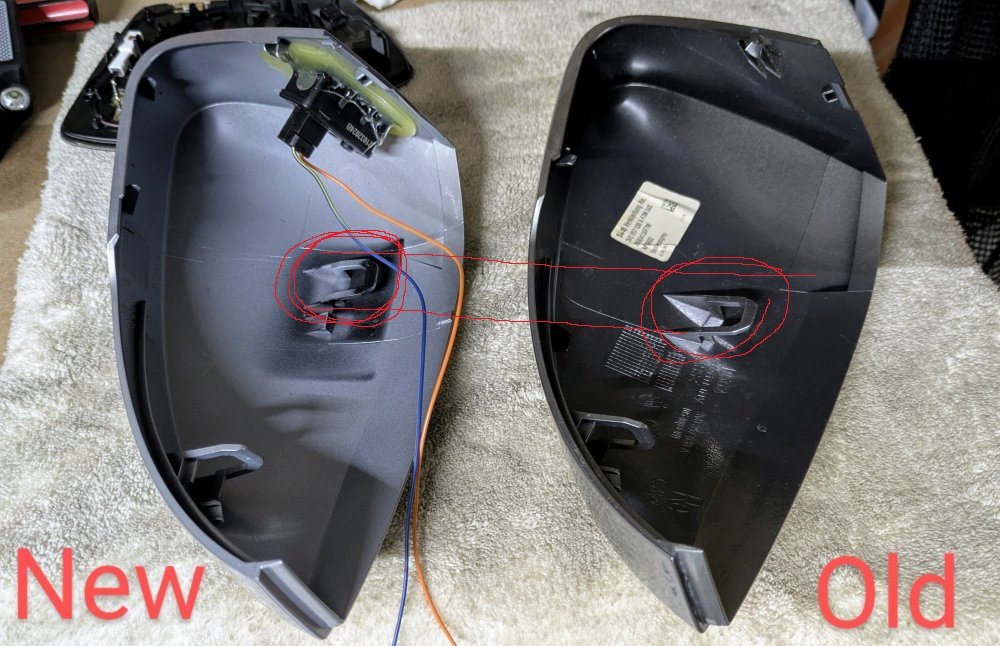

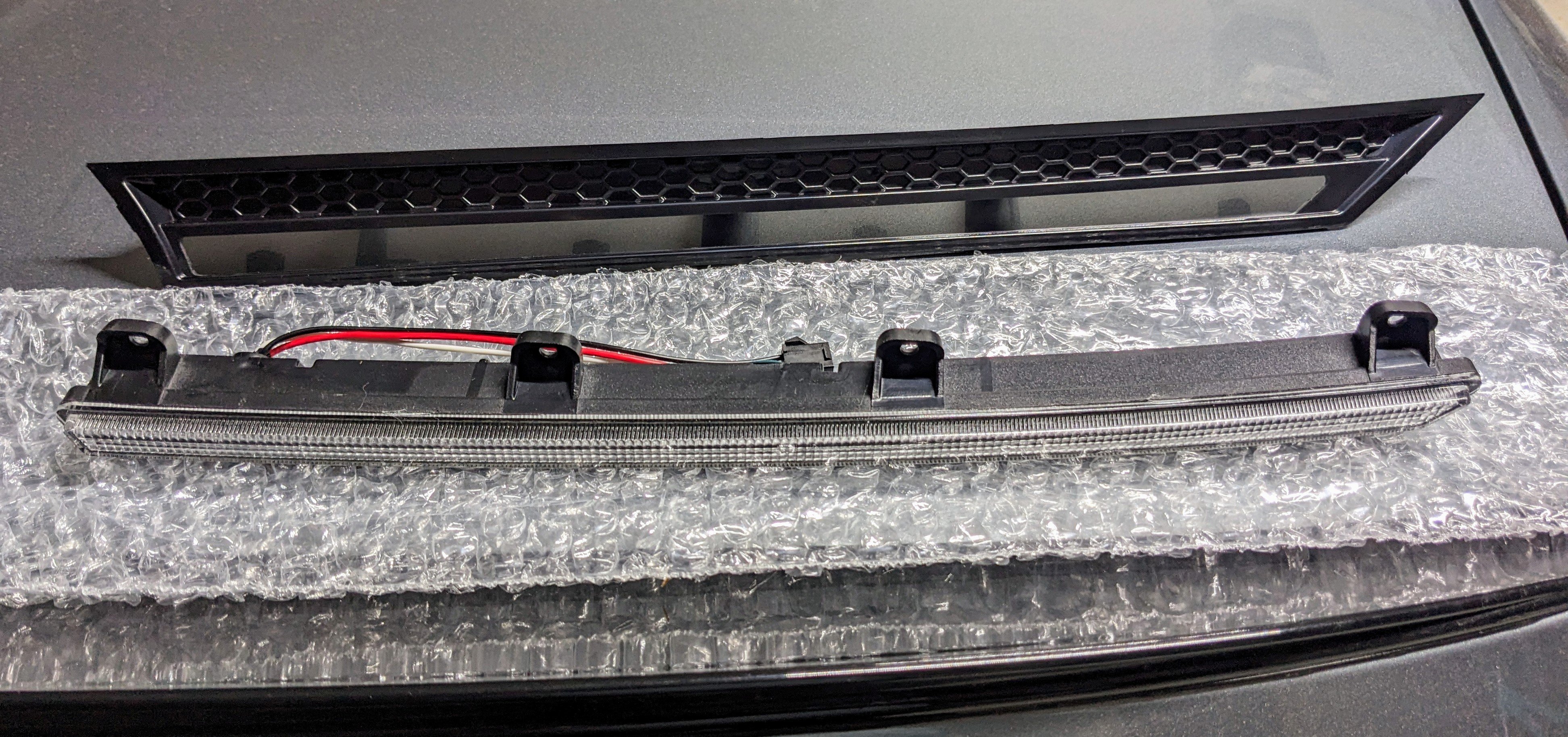

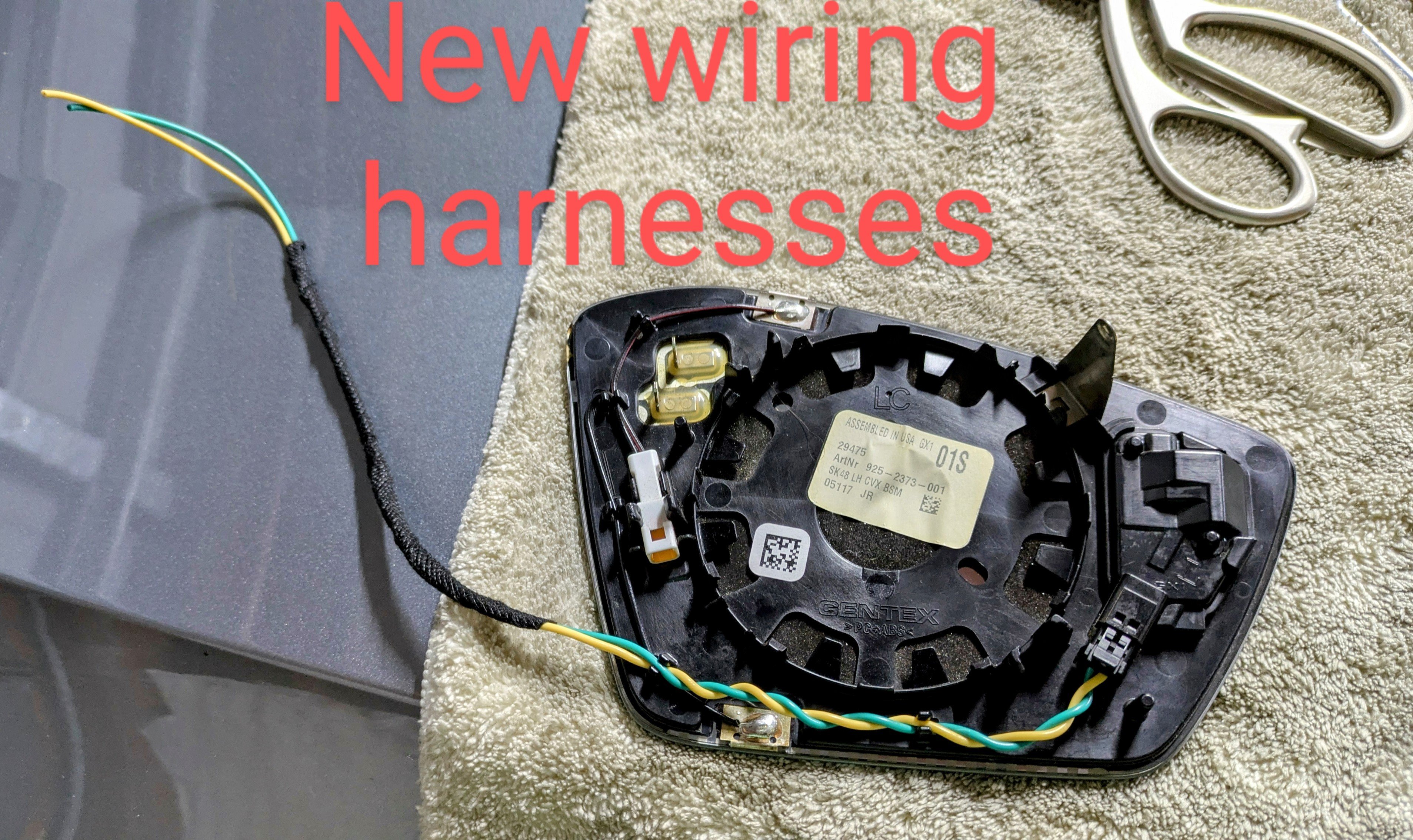

Second attempt was finally successful at giving Gandalf's wing mirror covers a "facelift".... literally.
I swapped the wing mirror covers for ones that have the blind spot detection light on the side of the cover.
Normally the BSD light is on the outer edge of the wing mirror.
On the facelift Superb, the BSD in on inside edge of the wing mirror cover.

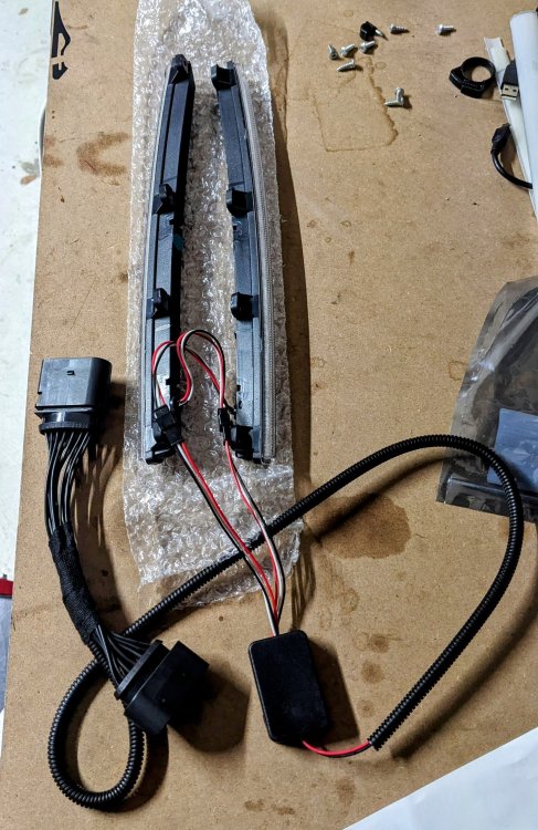

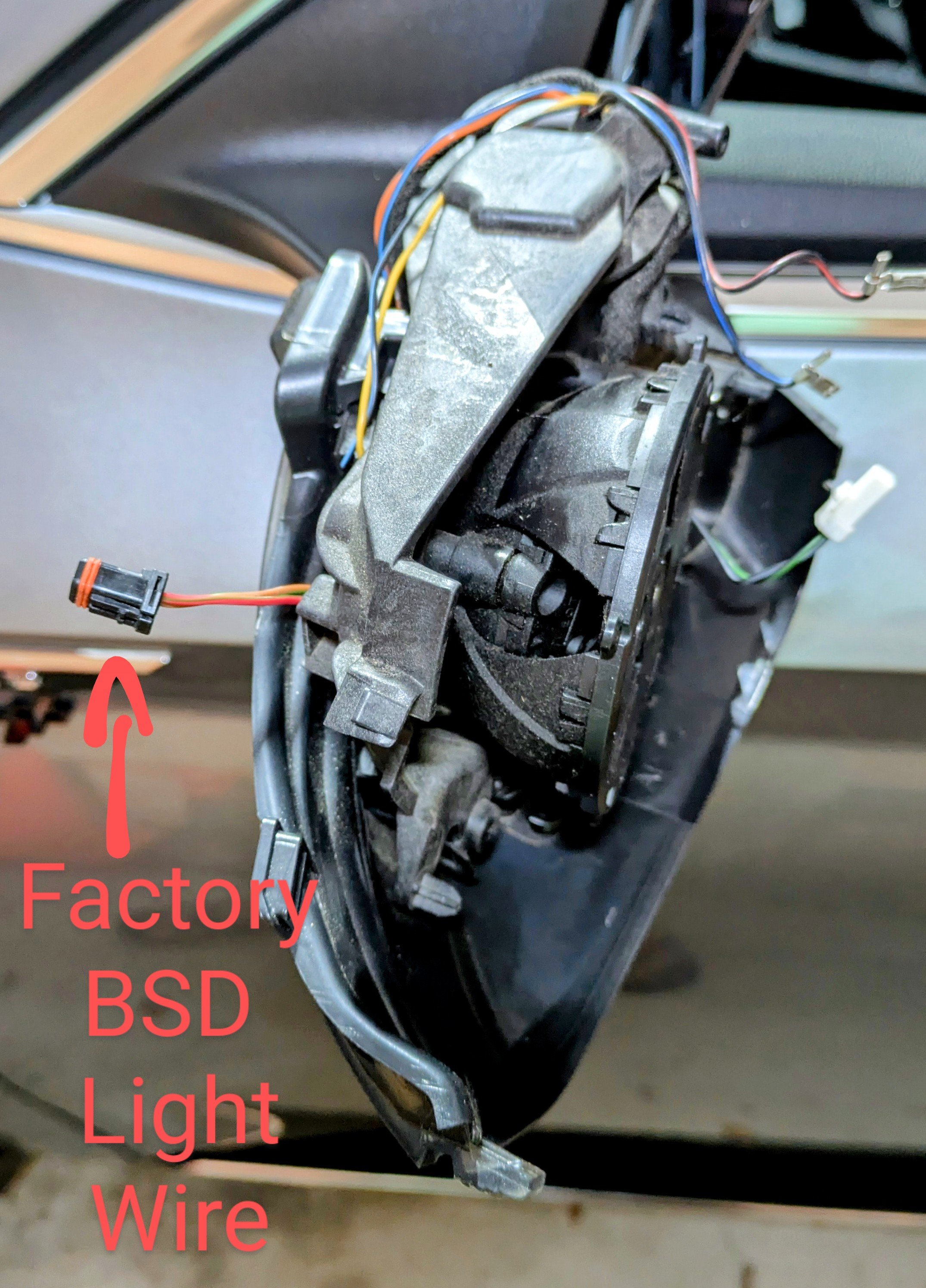

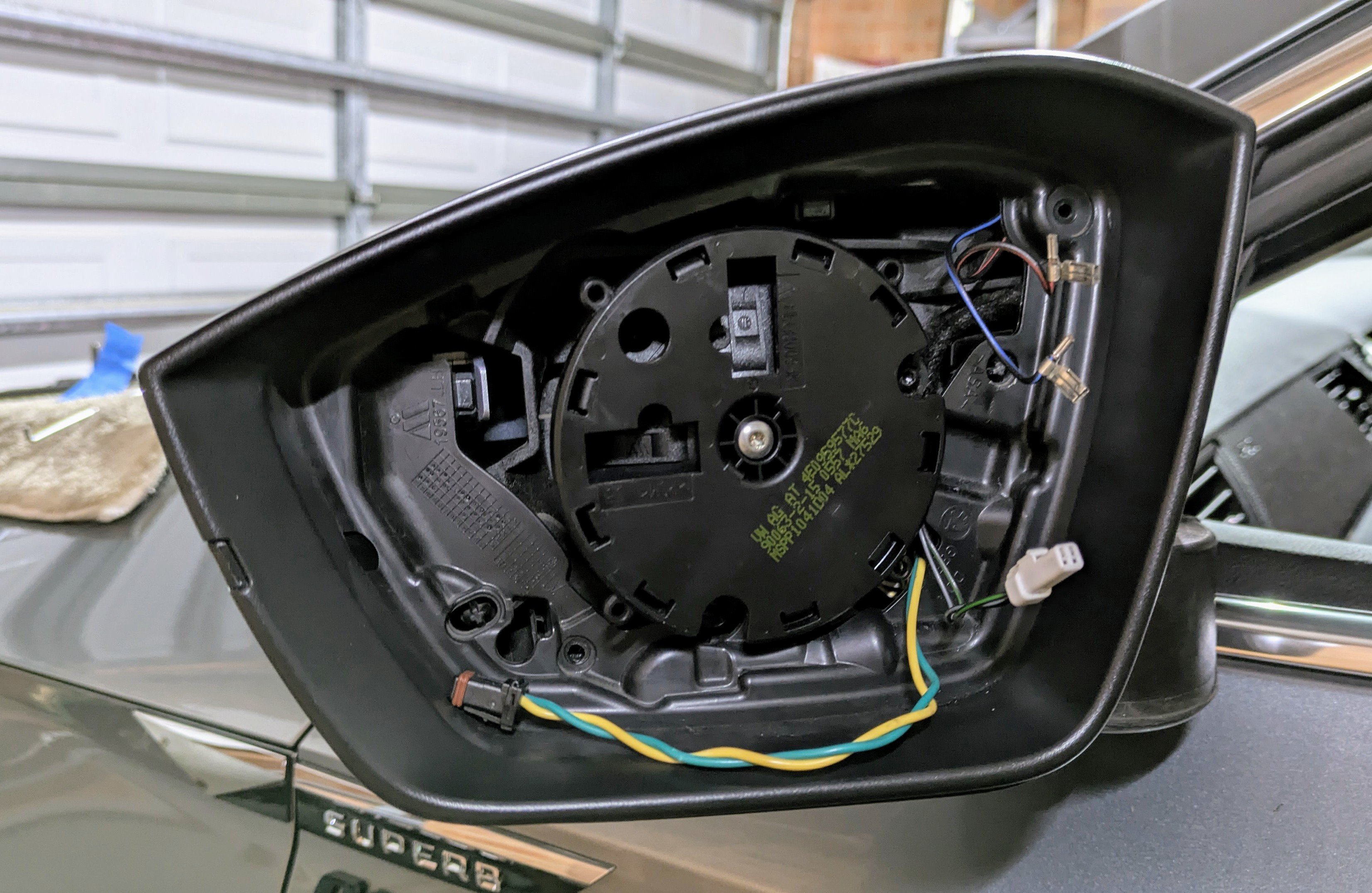

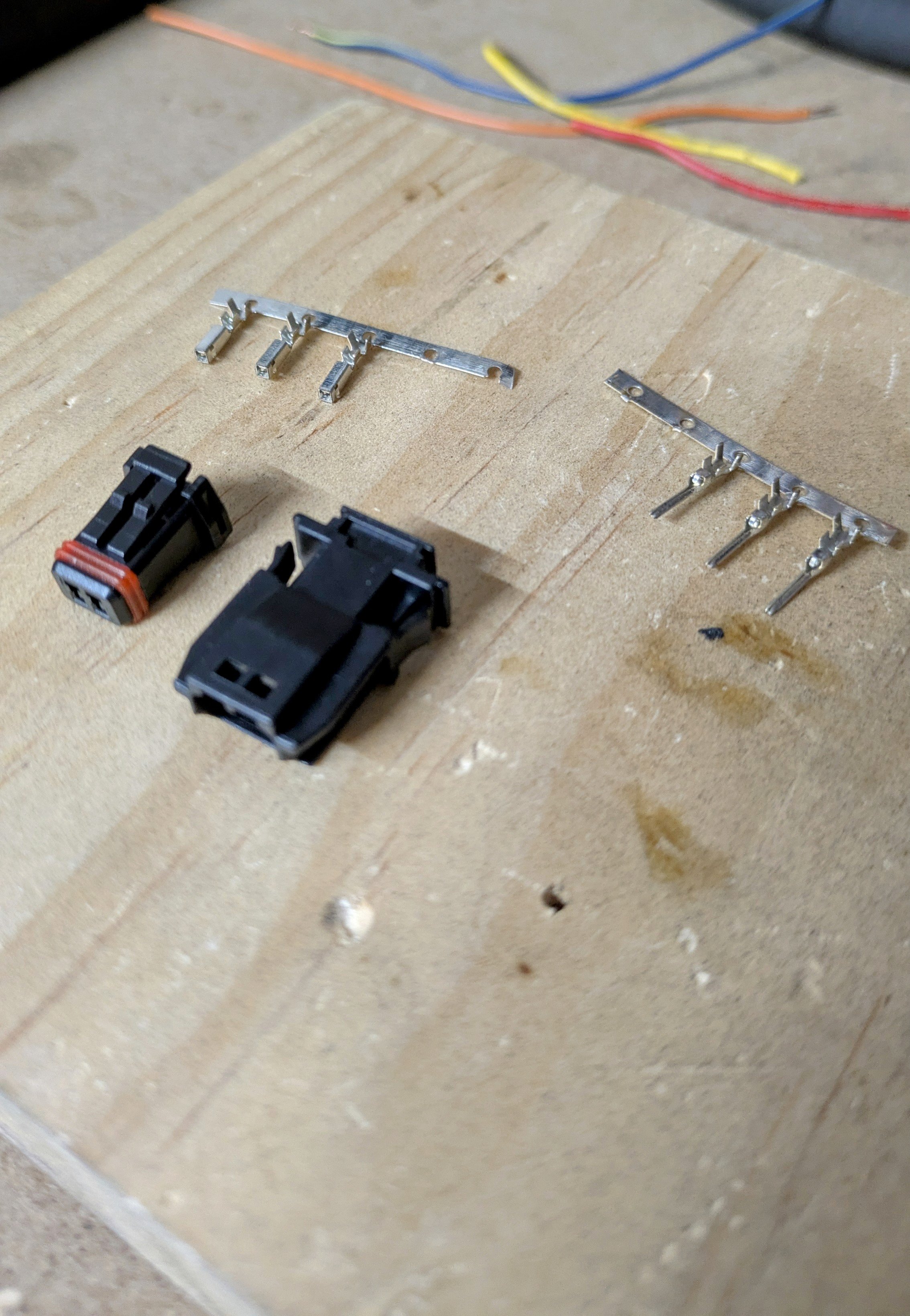

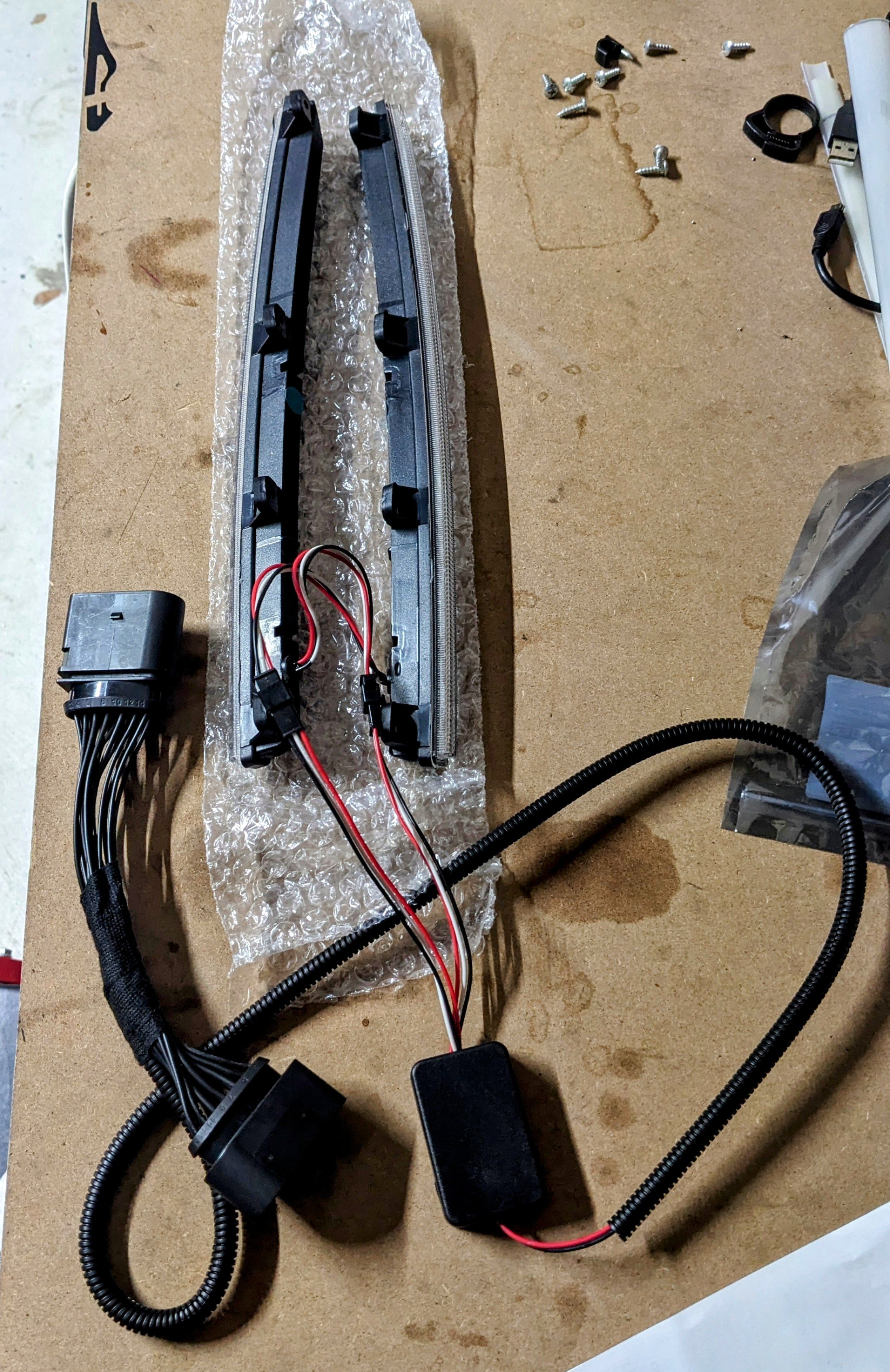

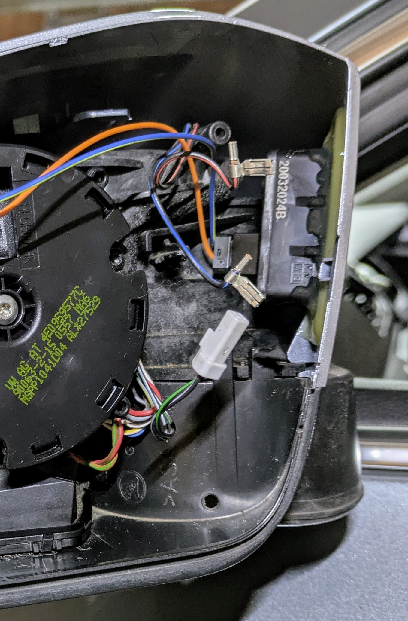

The wiring harness had to b made as it wasn't plug n play.
The new wiring harness takes the power from original factory loom, and splits it two ways - one for the mirror BSD light the other for the cover BSD light.
Happy with the end result.  Wasn't difficult, but i had to do things nice n slow, n careful so as to not break anything.
Wing Mirror covers with BSD light was from AliExpress.  Link here.
The grey colour is not an exact match.  I'll getting this either painted in gloss black or wrapped in black vinyl, soon.
The first version I bought last year, from China, was the wrong size.  Turns out the Chinese mk3 Superb uses a different wing mirror design altogether!!  That was promptly returned.
This one fits good and is good quality.
Wiring plug/connectors were also from AliExpress.  Link here.
Some pics of the progress....
The covers side by side
New wiring plug connectors, same as the factory connectors.
I moved the factory BSD wiring loom from the front to the back of the frame.
New wiring harnesses for the wing mirror BSD light...
New wing mirror cover in place. There is just enough room for it to clear the frame.
New wiring harness - taking power from the existing factory plug, and splitting it for the wing mirror cover BSD and the wing mirror BSD.
Setup complete...
A short video of it in action....

I've had this project open for a long time, and I've connected it the same way before, but I always get an error. But I took the original Facelift BlindSpot LEDs, they only have 5V and not 12V. So you have other LEDs for the mirror caps. But it's nice when it works. Then maybe I'll have to try this set too.
Am 18.01.2025 um 06:27 Uhr sagte JR RS:
Die Bezüge nebeneinander
Did the retaining lugs fit like they originally did? The caps from China are not exactly the same.
PXL_20250117_0620525493.thumb.jpg.5467c7ef6f64dfe454fe85dcc553b96f.jpg.6e9102ebf729ef4b74b7b04fcef42447.jpg

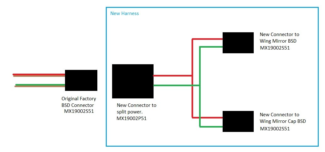

@Lutz_91 - i assumed the BSD indicators to be 12V, as per usual.  Hence wiring in the Wing Mirror Cover BSD indicator caused no issues.
no errors, or issues working.
the original wing mirror BSD indicator is just as bright as it was before i added the additional wing mirror cap BSD indicator.
the wiring is simple & straightforward.  see pic below of how i connected it up.
as for the wing mirror cap mounting clips - yes, that one in the middle is in a different location, hence the black trim piece, behind the mirror glass itself, doesn't clip onto it.
however it doesn't matter as the the wing mirror cap is securely fastened on either sides, and around the back.
there is no way the mirror cap is coming off, unless of course it gets smashed up in an accident.
Vor 14 Stunden sagte JR RS:
Die Verkabelung ist einfach und unkompliziert.
Yes, I know the wiring. But on the original Facelift Superb the LEDs are 5V and not 12V like on the vFL.
You have LEDs from the Passat and the adapted mirror cap.

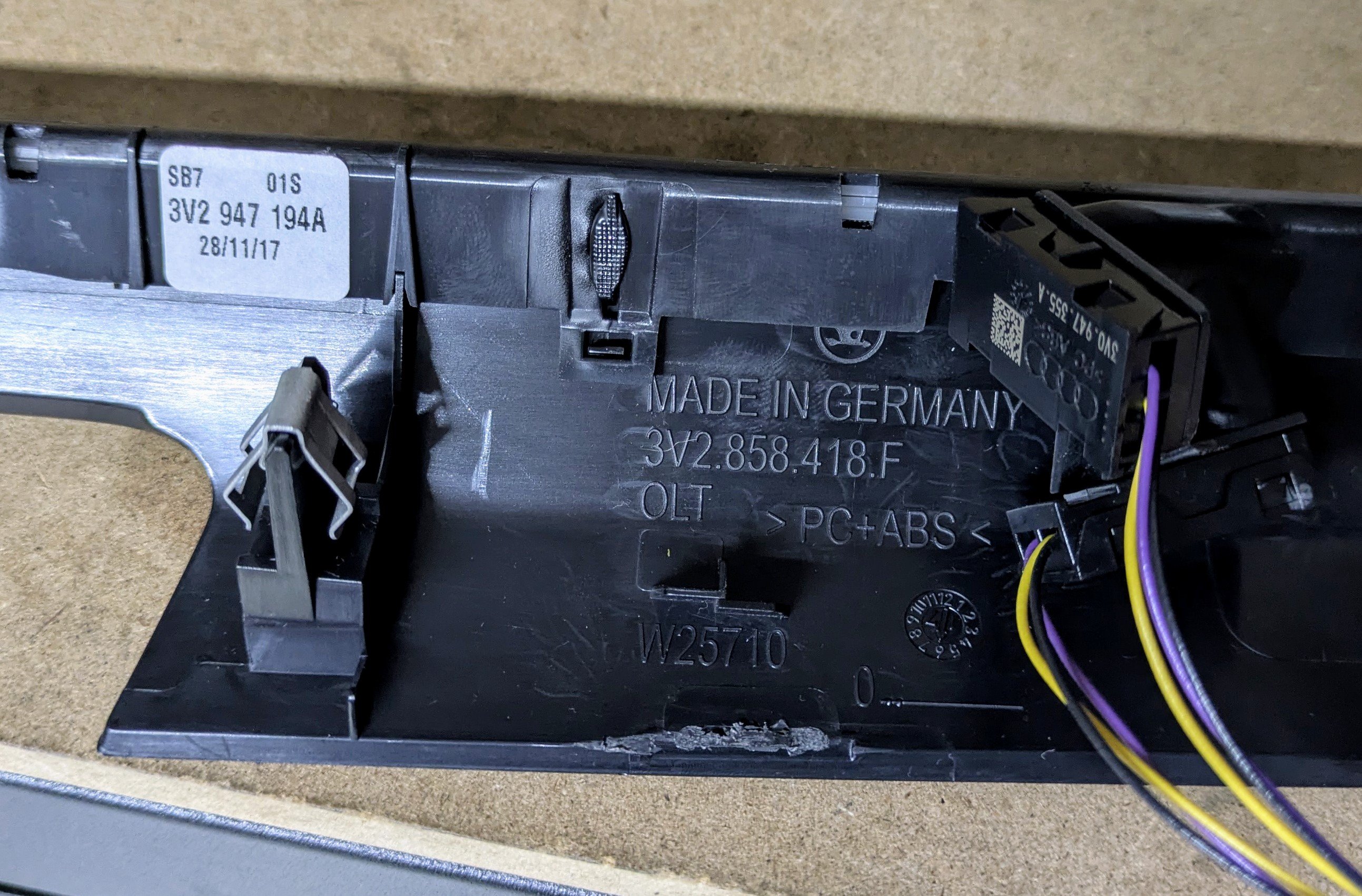

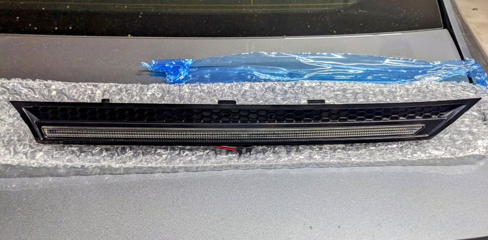

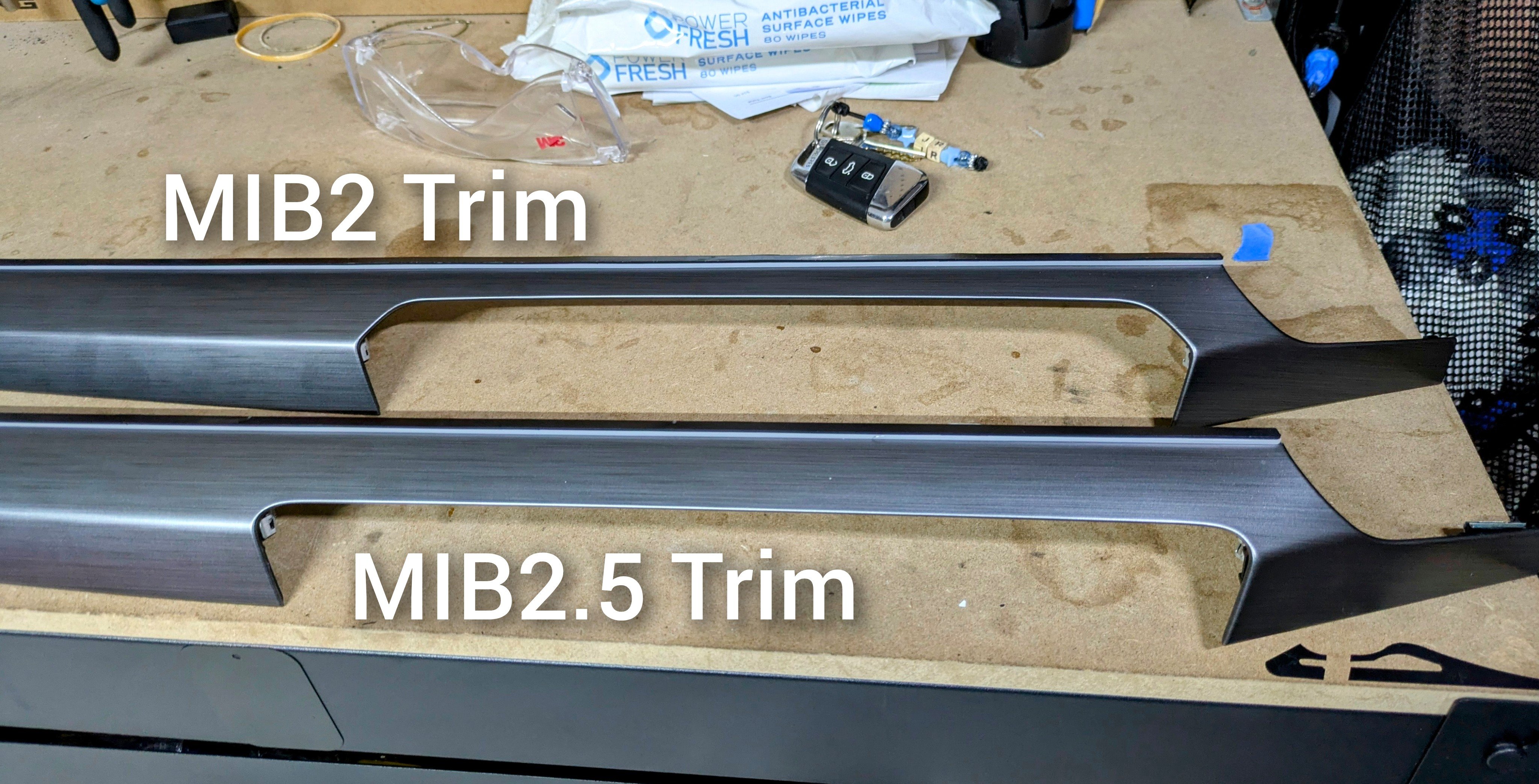

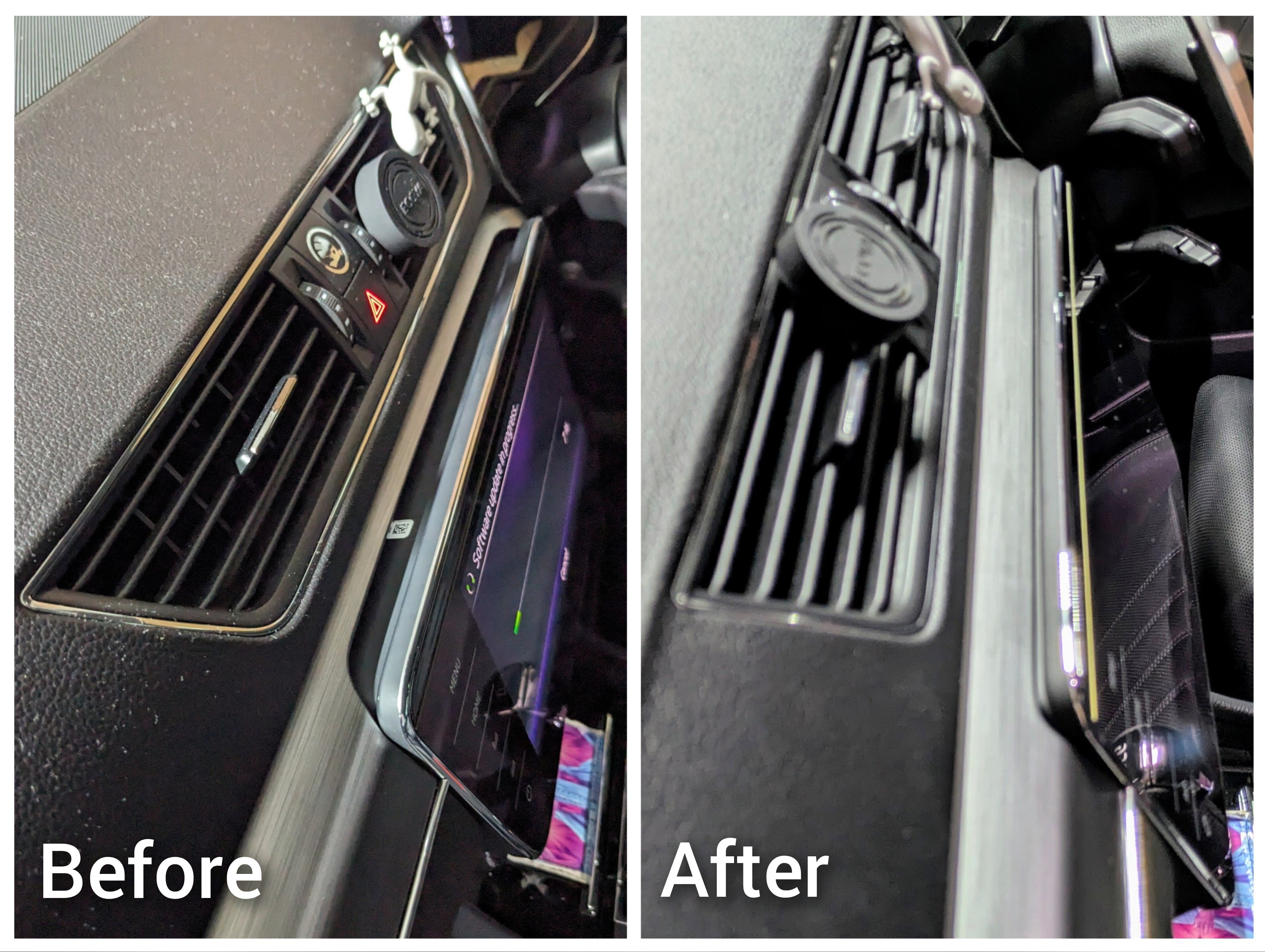

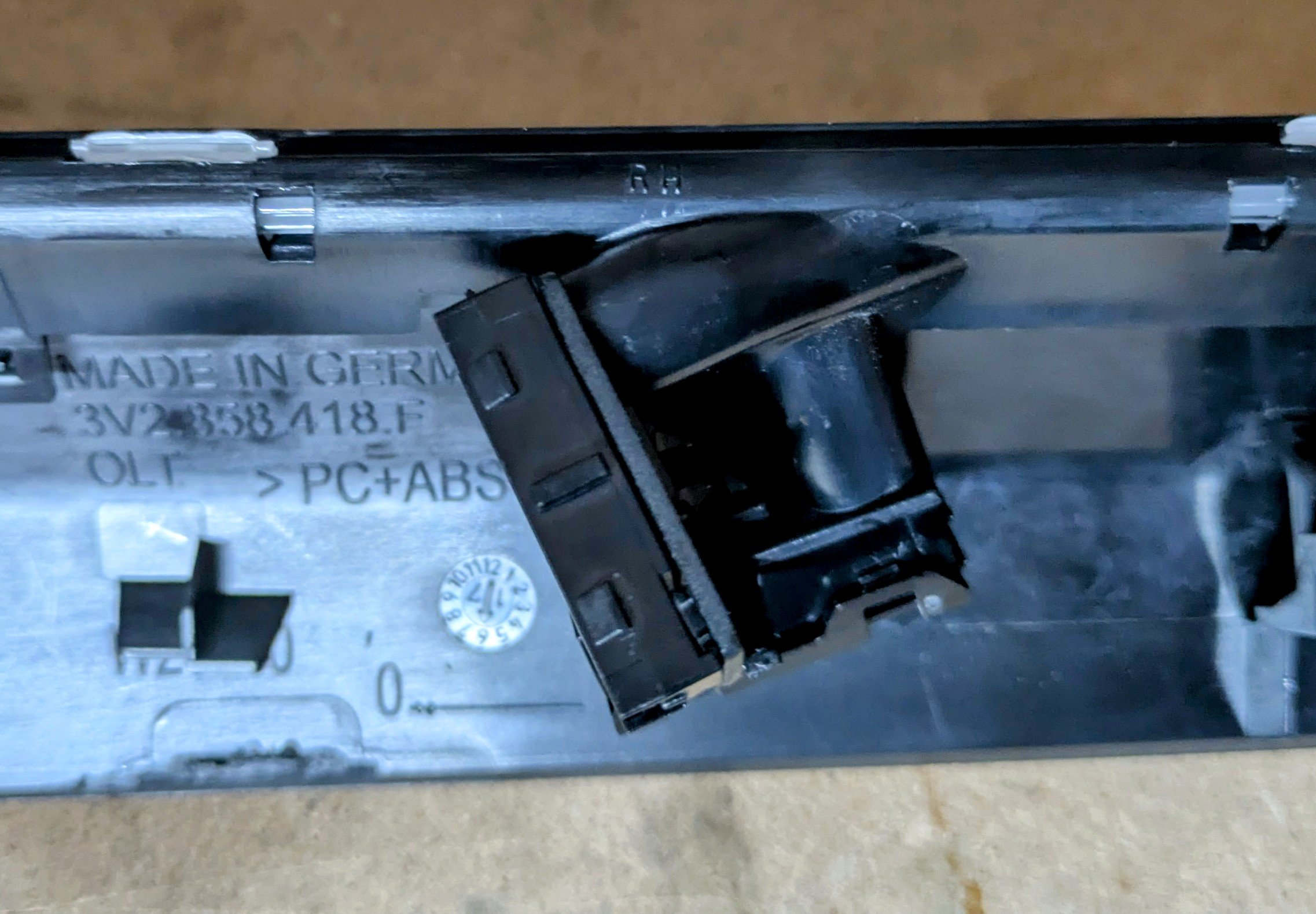

So 6 months later after converting my MIB2 unit to a MIB2.5 unit, I finally managed to get my hands on the centre dash trim suited for the 9.2" Columbus screen.
Got it from an MY18 Superb being wrecked.  Good price too.
Was difficult to find a match with mine as most of the Superbs being wrecked were Sportline models, hence carbon or black finish trims.  That's assuming the trim piece was available and not damaged to start with!!

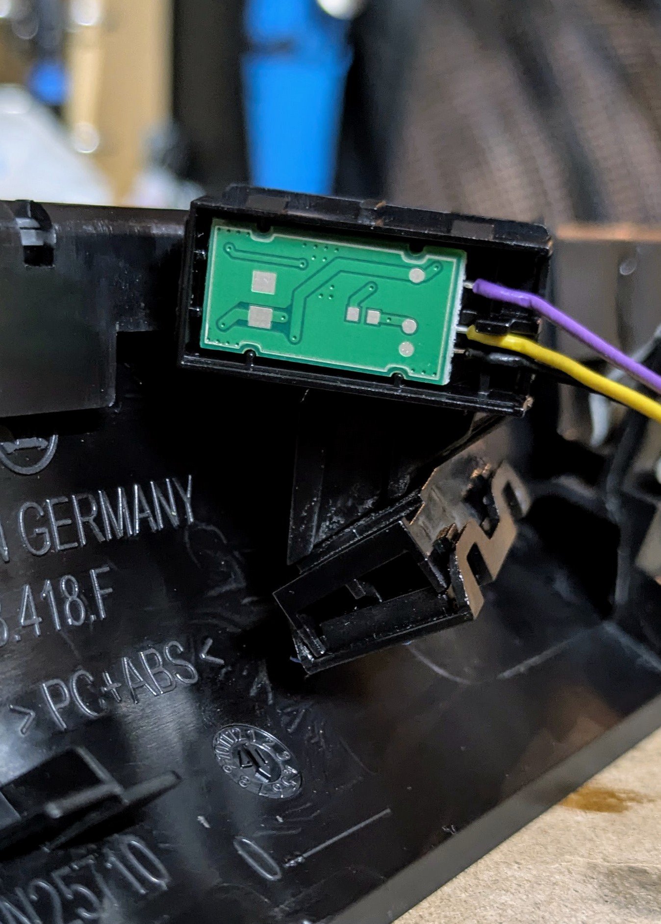

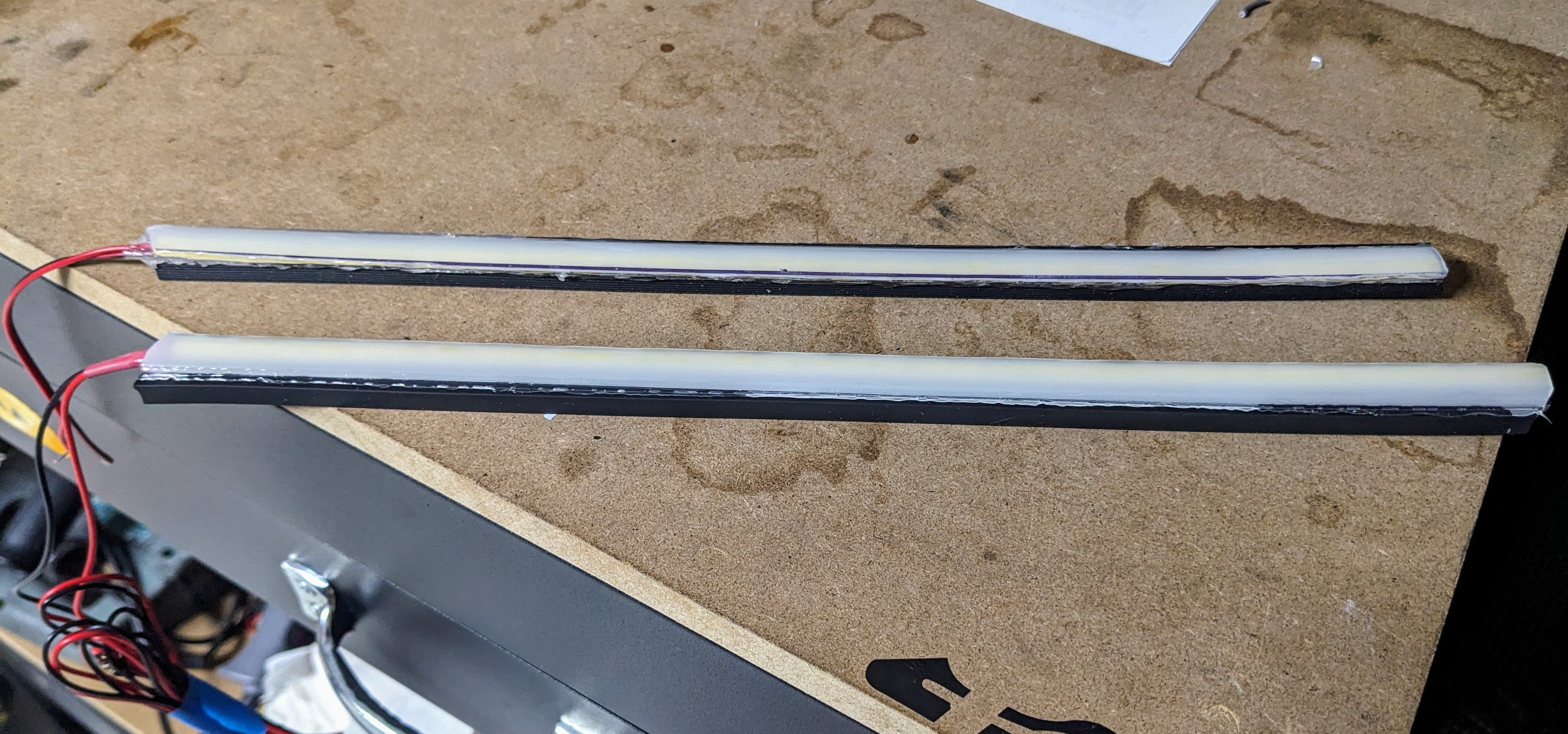

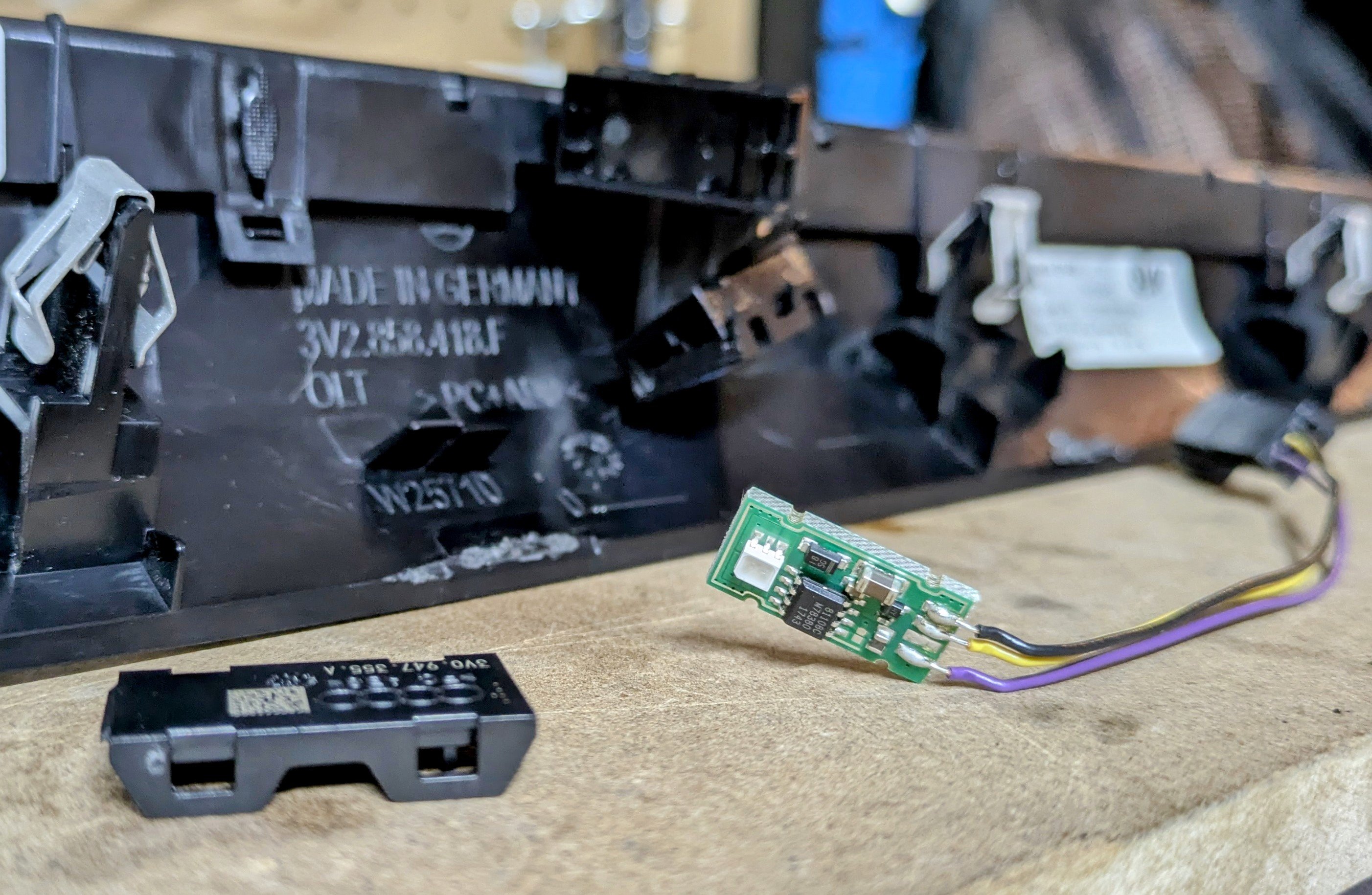

The swap out process was relatively easily.  Removed the screen first, then unclipped the old trim piece.
I was unable to disconnect the ambient lighting strip connector as it was deep inside the dash trim and there was no way of getting to it!!
So I unclipped the actual LED board and clipped it on to the replacement trim piece.
Job done.
There is two of them.  One shoots light from inside to left, and the other from inside to right.
MIB2 trim piece - 3V2.858.418.A
MIB2.5 trim piece - 3V2.858.418.F
Comparing the two trim pieces...
Seperating the LED from the 2x ambient light holders...
Cover removed...
LED board removed...
Without the LEDs
All done...
