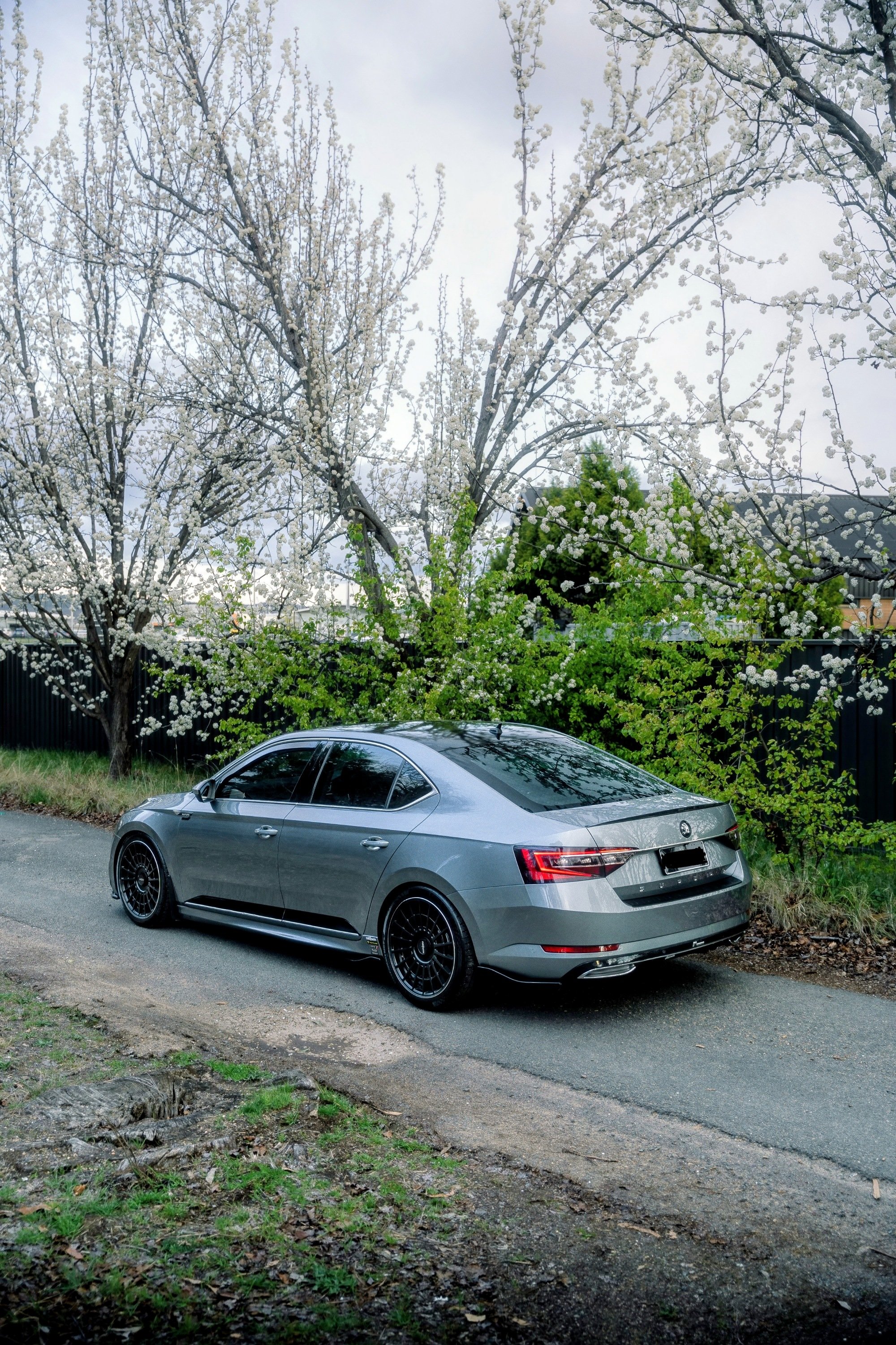

Spring has arrived, so it was a good reason to wash Gandalf, after a long overdue 5 month draught, and take some updated pics afterwards.
Some rolling shots...

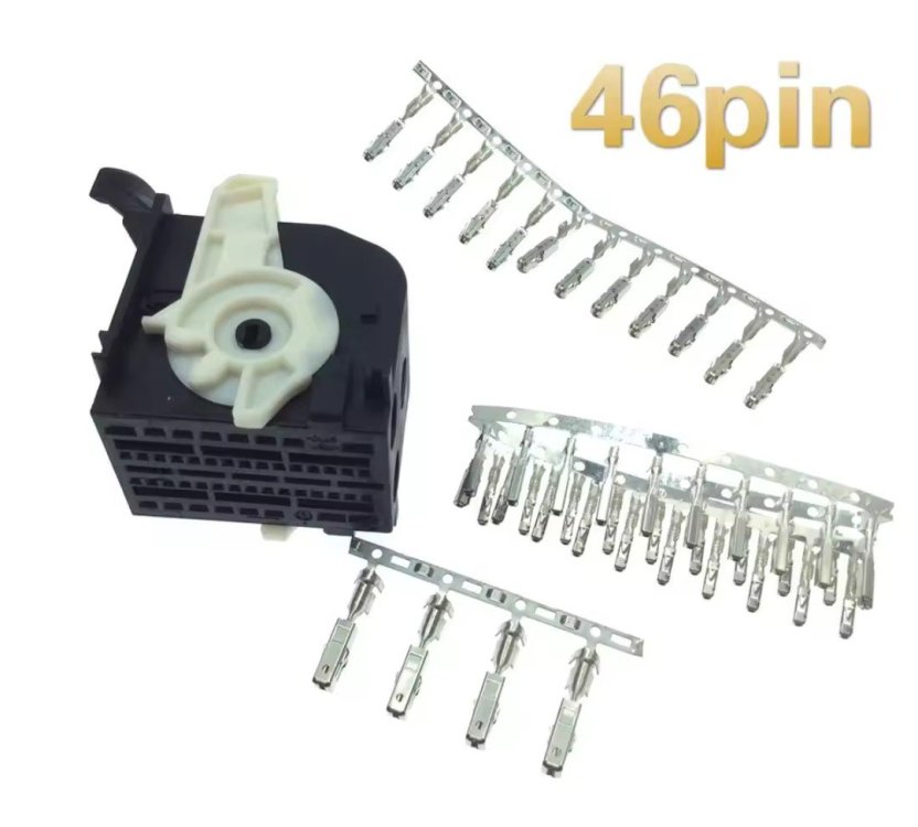

Regarding the BCM pins i understood i need to order the pin with a small lead of wire and then extend it with a tail piece to get this done, i found 2 codes for possible options, but like you mentioned on the other post that you ordered the wrong kinds of pins first time round, would one of these part n. work for the BCM:
1.https://www.skoda-parts.com/spare-part/000979009e-cable-line-european-union-43850.html
000 979 009 E
000 979 009
N  907 647 01
OR
https://www.skoda-parts.com/spare-part/000979009ea-cable-line-skoda-29570.html
  • 000 979 009 EA
  • 000 979 009 A
  • N  907 647 03

@Sane420 - with the BCM pin, I ended up buying the B-Connector which came with the pins. This way there was no trial n error. Wasn't expensive.
AliExpress link.

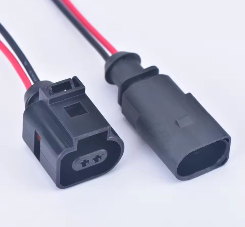

With the connectors in the bumper, these r the connectors I used.
AliExpress link.

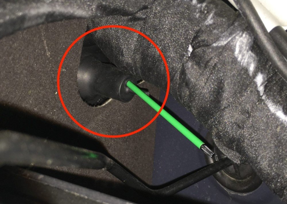

With the wiring from the BCM modules to the engine bay - that was a pain to do!!
Essentially there is a rubber conduit behind the glovebox (RHD cars) that comes out on the engine firewall, behind the battery, right at the back. Battery needs to come out to reach back there. U'll also need a coat metal hanger that u can straighten up to poke the wire through the conduit.
I'll c if I can find the pics for it.
AliExpress link.
AliExpress link.

Ordering the whole bcm connectror was smart, like u said no errors in connectors. All items are on order now, hopefully they will arrive next week so i can get to work on this project.
Regarding the cable passthrough to the engine bay i assume as i have a LHD car that the grommet will probably be on the drivers-side somwhere, as the battery is also located on the drivers-side.

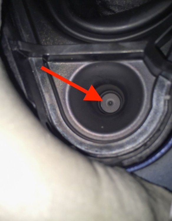

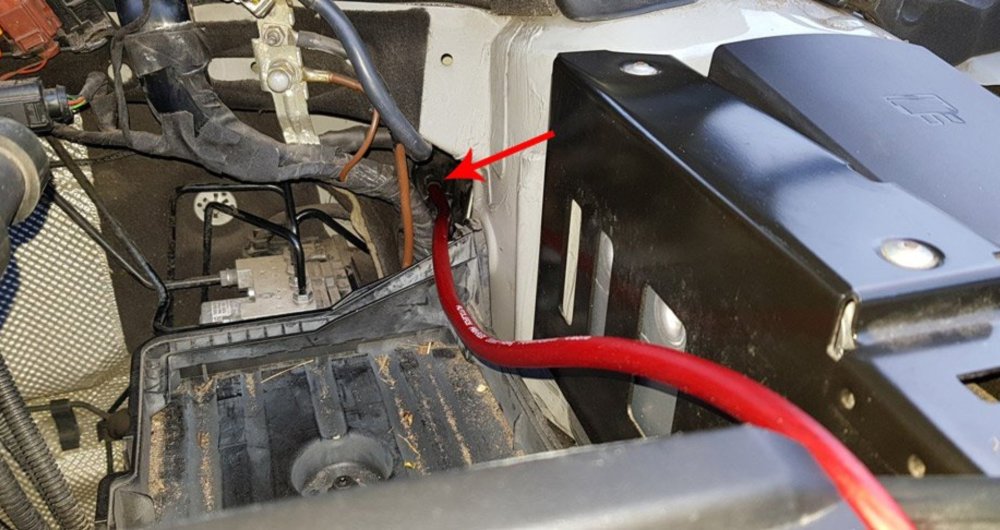

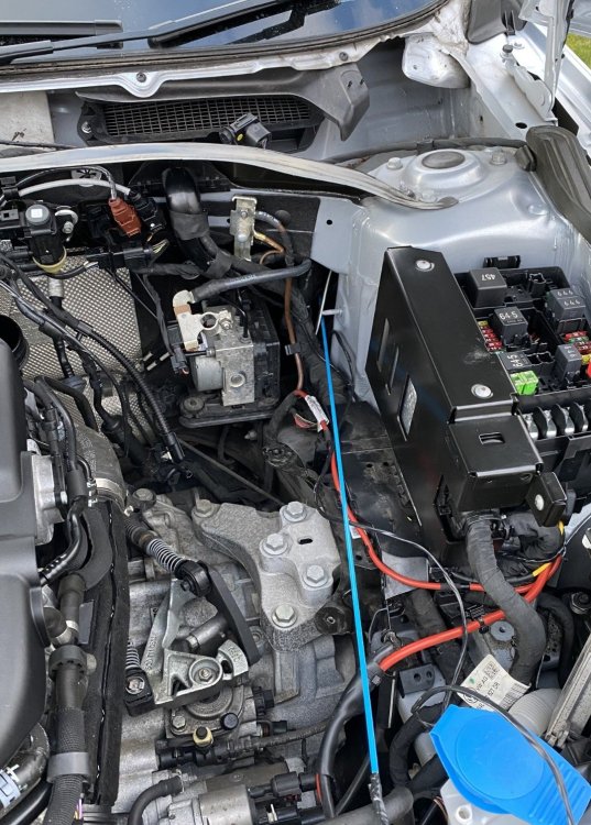

Some pics (not my car) below of the cable pass through.
Shows u how it looks like, from both sides.
Good luck with the install.
Thanks. Merry Xmas & a Happy New Year to u too.
Inside...
Engine bay side....

Cheked my BCM coding and i also had the two channels available that u posted on ur earlier posts, RB2 and LB39, probably going to use the LB39 just like u did with the same codings.
Check if the corresponding pin is present on the circuit board or connector A/B/C. Just because you can code it doesn't mean the pin is on the BCM circuit board
Ur NOT reading his or my posts properly at all !!!
I'm already reading it. But even you weren't entirely sure which pins the BCM actually has at first. Only after getting help did you use Leuchte8FL LB39, where that pin is located. If your BCM is different from the other user's, it could be different. There's a reason there are so many different BCM variants.
The conversion is very well done, no question.
Good pointing this out, i read the other posts regarding this aswell and im going in to this blindly by choice, i have not checked if the pins are even there but i will find that out soon 😅
My BCM unit is: 5Q0937084AN
Couldnt find any closeups of the pins but will post on here when i have the time to start working on the car and dismantle to see if pins are there or not.
Reason for going in blindly also is that im waiting on a quote for a VC on my car, if i get it done i will need to replace BCM anyways.
-S
That's why I wrote that you should carefully check whether the correct pins are present on the BCM board before you start tinkering.
But some people don't understand that

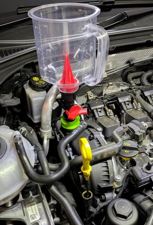

Did my interim 6-monthly service for Gandalf today.
But this time round I bought this gadget which made filling the engine with new oil so much easier and far more precise (measurement).
It holds up to 1.5L
Highly recommend it for those who perform their own oil changes.
Link to the product here.

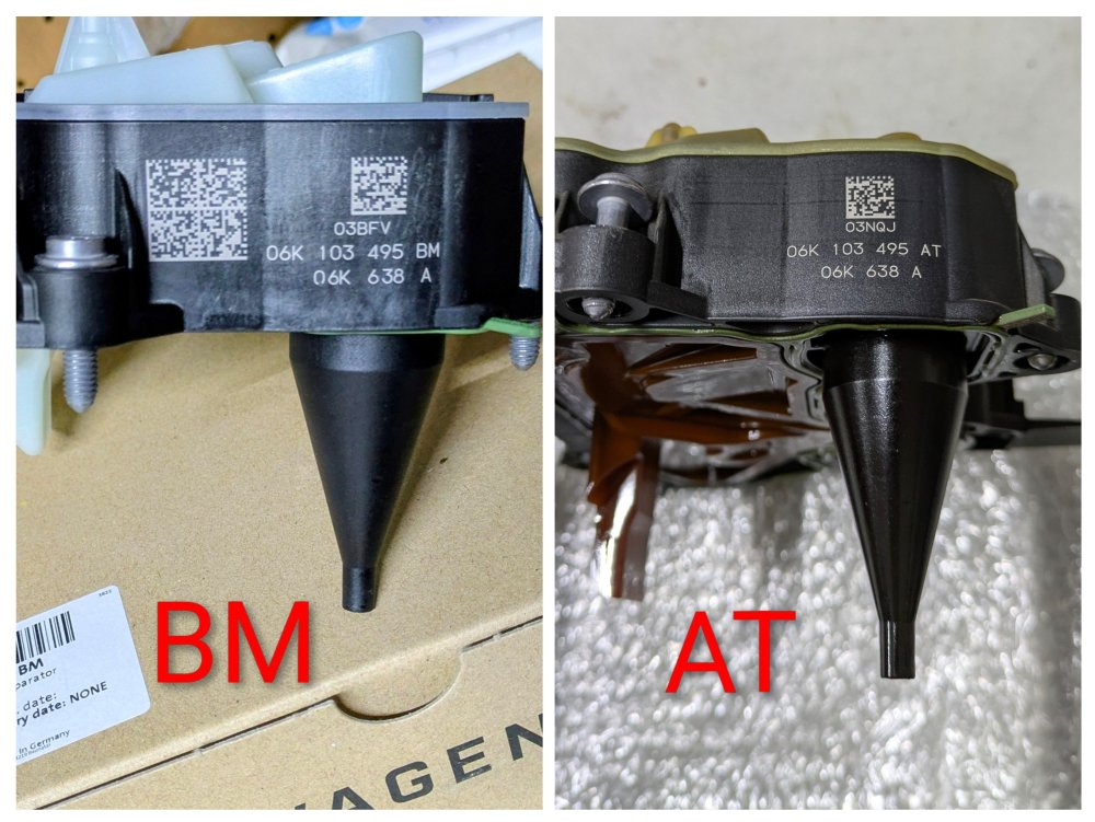

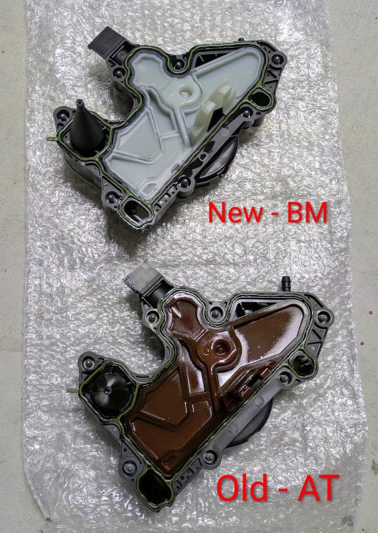

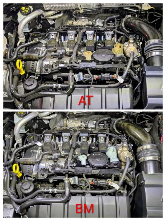

Thanks to some wise words from a smart friend, I changed Gandalf's PCV valve.
There wasn't any issues with Gandalf, rather I replaced the PCV valve was as a preventative measure given Gandalf is 8 plus yrs old, and the various modifications over the years.
I've heard the old AT version has been known to fail.
As with new refreshed parts, car feels a bit more smoother under load/boost now.
I previously thought it was a quirk of the Galano ECU/TCU tune, but the change of the PCV valve seems to have smoothed this out.
Most likely placebo, but this a new and better revision of the PCV valve. Less problematic based on my research recently and the few techs I've spoken to.
Old:- 06K 1034 95 AT
New:- 06K 103 495 BM
Removing the old and replacing with the new was fairly straightforward.
Hardest part for me was removing the original crimp band clamp, holding the rubber hose to the PCV valve. When fitting the new, I replaced it with an OE spring band clamp - N90686701.
