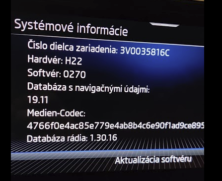

Just updated my Bolero MY21 (H22 0270) with new navigation database (yes, bolero MY21 has it).
Instructions EXACTLY as I've posted above:
1) Download zip.
2) Extract to NTFS flash drive
3) Insert flash drive and keep Bolero on for some time.
No need to click update or somehting similar! Just keep your head unit on!
I was driving around for 1h, using wireless carplay for music and navigation as usual. After 1h I still had 19.11 (factory). After 1h I've performed "hard reset" by holding "on" button on Bolero for 20 seconds. After that I saw 20.7.
(may be 20 minutes is enough, I don't now)
(I'm pretty sure that process took less than 1h, but version in system info updated only after bolero reboot)
That's it :)

Well mine has just updated. Following the advice from @batalabove (thanks!), I did a hard reset on my Columbus by holding down the power button and when it restarted the navigation version had gone from 19 11 to 20 10. The update files had been sitting on an NTFS formatted flash drive, plugged into the car, since last year but it's only now after the reboot that they appear to have been recognised.

no update for me though, still 'stuck' on 20.7 after ~45min drive with the stick plugged in, with or w/o reseting Columbus

Unfortunately did not work for my MY21 Superb :-( left it on for 2 hours with the USB-C port, maps on the FAT32 USB stick, hard reset after 2 hours but still the same version. I than tried to do the update through the service menu but no luck, showing this error

What hardware and software version do you have? Maybe it's differ from ours.
As I know for all Kodiaq\Karoq MY21:
H22 and SW 0270
H22 and SW 0270
Looks like same as yours
