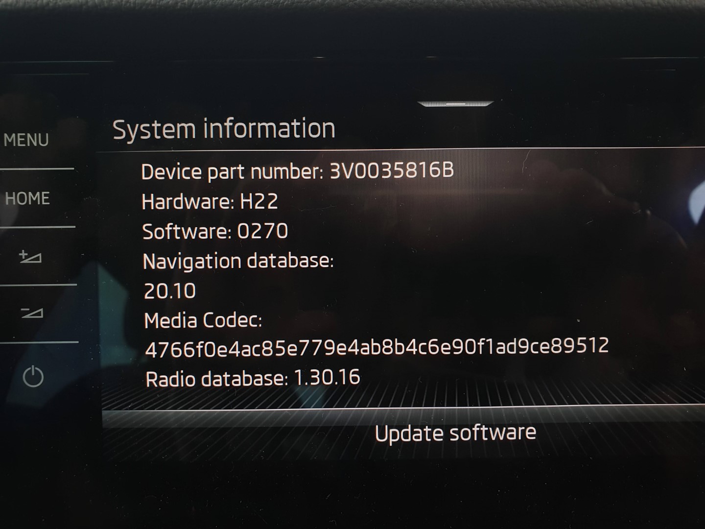

It stays at the 20.10 version.
Actually I don't know which version is available on the Skoda site, though.

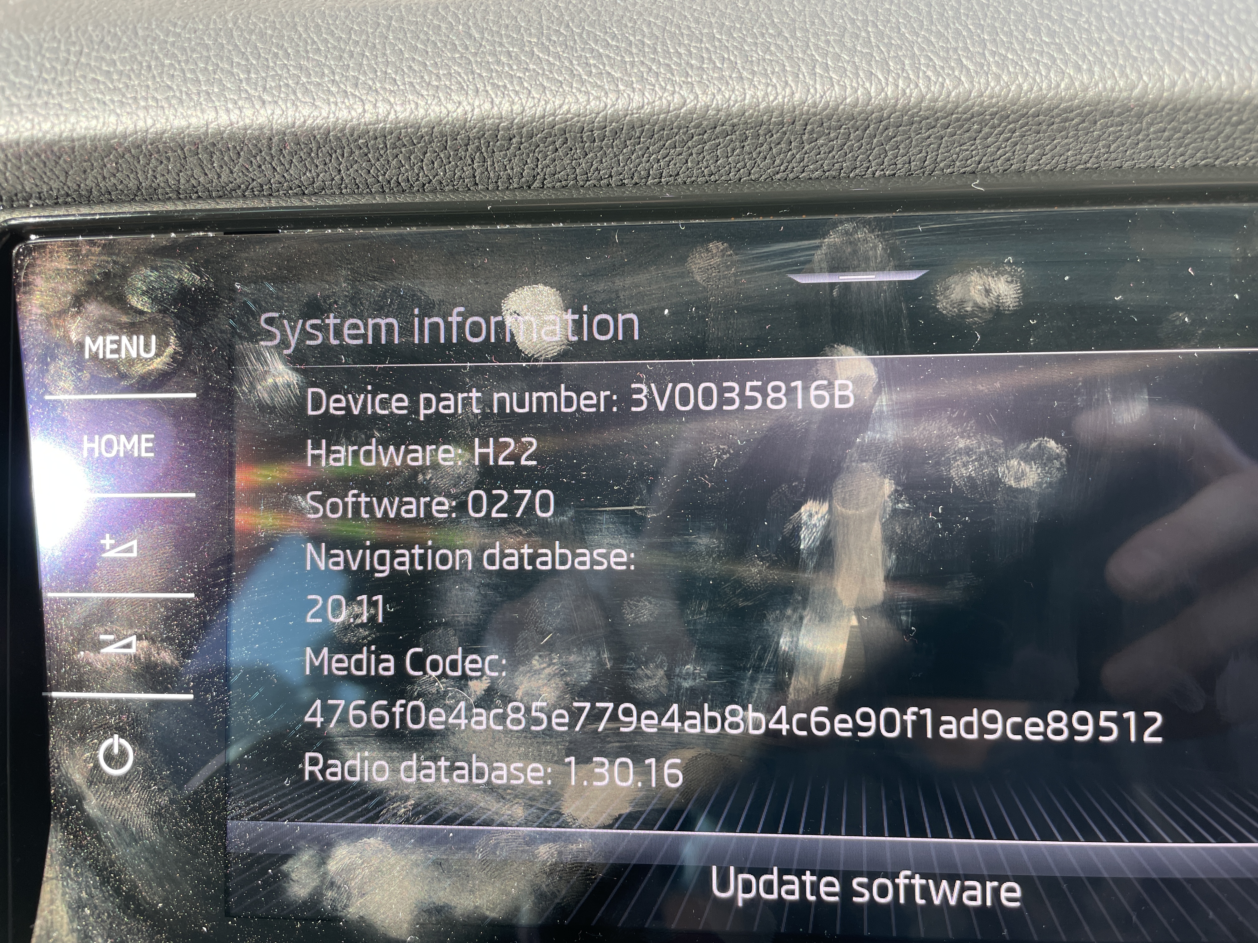

  • FInally     Just updated my Bolero MY21 (H22 0270) with new navigation database (yes, bolero MY21 has it).    Instructions EXACTLY as I've posted above:   1) Download zip
Maybe that's the problem :) I have 20.7 after updating with files from Skoda portal. Maybe files available for manual download are 1 step behind comparing to online update.

Perfect...would you mind to send a picture about your system information where we can see the Product number, HW, SW and Navigation DB version?
I will go back to my Skoda Dealer and escalate if that will be the same as mine, except the Navigation version.
ok I took this one to my Skoda Dealer...and he confirmed that USB-C update is turned off on MIB3 as everything is pulled from the internet...so you either have the eSIM package through Cubictelecom or you have a 4G hotspot in your car and get the head unit connected. He also confirmed that for Devices 3V0035816B the 20.11 navigation is the latest...for 3V0035816C which is for example mine, it`s the 19.11 the latest but nothing to worry about as when you have net connection, it always download the latest maps for your route.
The fact that the HW and the SW version is the same on all Device part numbers (B & C) does not mean they run the latest SW
