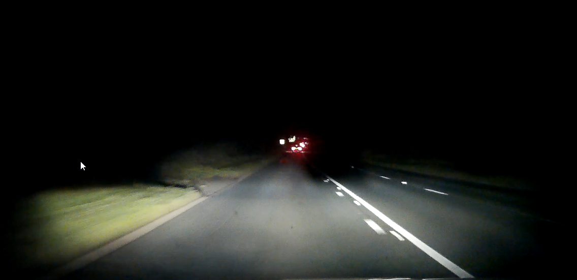

I’ve got them as an option on the SE L and I don’t think they work. I’ll get flashed by oncoming cars even when they’re not too far away and I noticed the blanking is offset when I’m following cars. I’ve attached a photo which shows the latter and have some video of being flashed.
for bonus points, they don’t always seem to step down when I pull the lever towards me.

Just had a chance to test the lights on a short (essential) journey which was around 5 miles on dual carriage way and 5 miles on a B road. At first, I thought they'd finally fixed the lights. It seemed to have a decent blanking arc on cars that I was following and I didn't get flashed. Granted, the lights seemed to have a fairly aggressive blanking which covered all of the other side of the road, regardless of traffic, but I could work with that.
However, on the way back, I took a B road and noticed that the lights on full beam didn't seem to show as far ahead as previously. Worse than that though, of the 2 cars I met on the road, I noticed that the blanking arc was off to the side of at least one of them which led to them flashing me. I've attached a still from the dashcam.
Overall, I'm not that impressed.

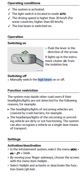

How do you turn on the automatic full beam on the Vrs please

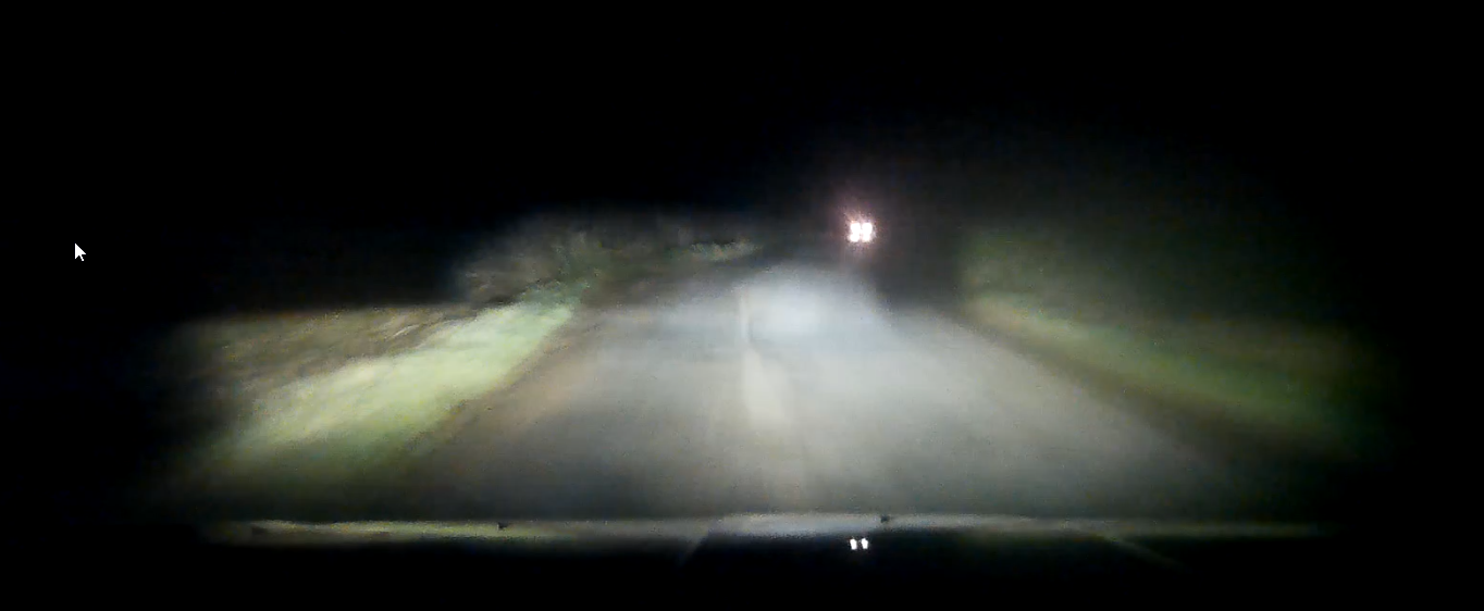

I noticed similar behaviour on mine and it turned out the headlights were not working correctly (and I eventually rejected the car).
The clip below shows a bit of a smaller country road when the dealer took it out for a night time drive.
Since rejecting the car, I bought a VW Tiguan which also has matrix LEDs. The VW ones are far better

Having used the matrix lights first time last night I am really having trouble understanding if the lights have dipped. My issue is that there is no visual indication on the dash other than the blue light  A (auto) symbol which doesn’t change colour so I don’t what mode they are in i.e dipped or heads. The only time blue A symbol changes to white is street lighting or under 30km. Am I missing something got flashed a few times in auto mode.
your thinking is correct. Blue icon means they are "operating", but should dip on to incoming traffic or if there is a vehicle infront.
Agree reading the forum about issues with lhd and rhd not sure and I have only driven at night once. Lights very impressive but there should be some indication between dipped and full even though they are automatic
