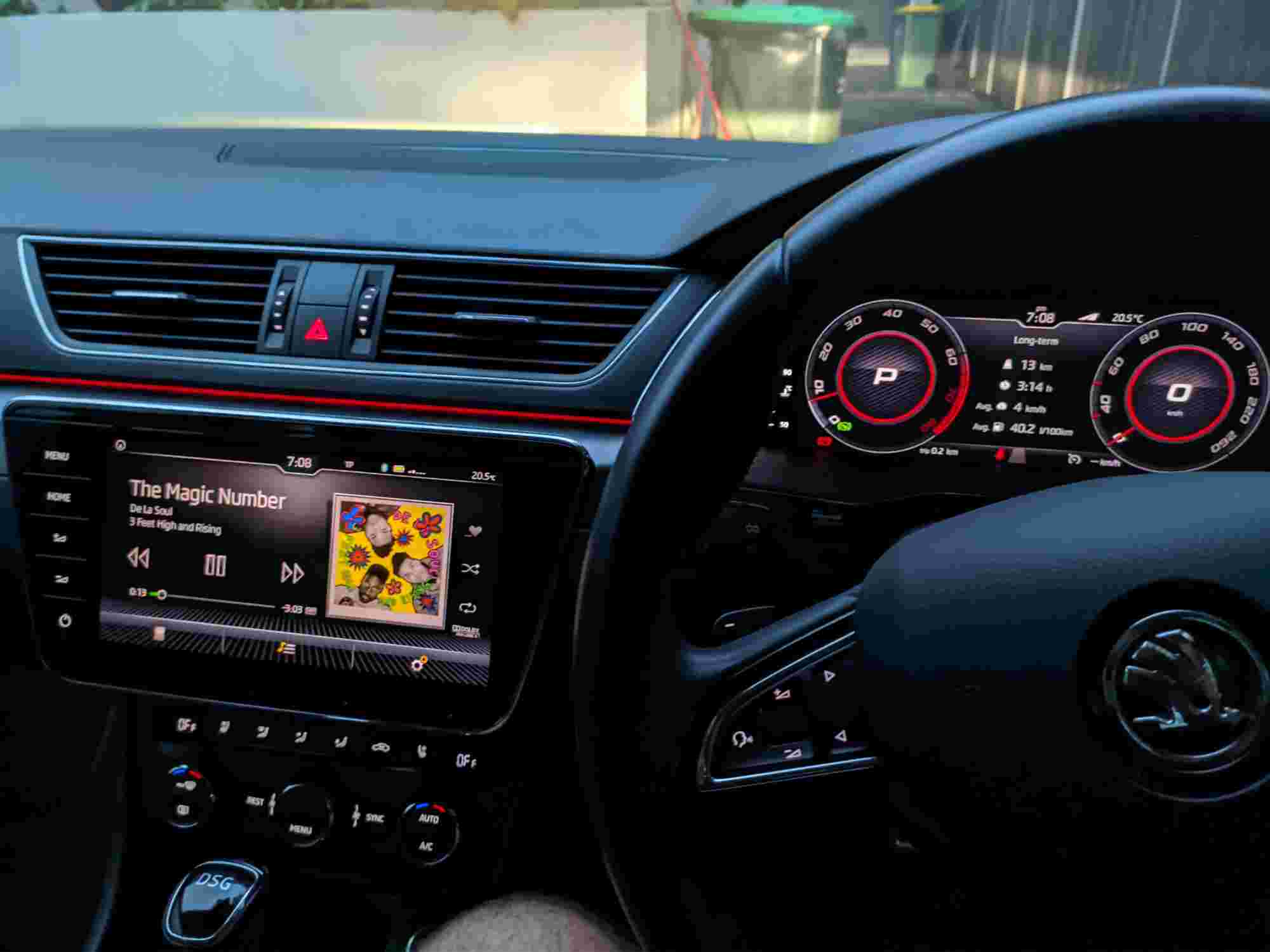

Ok managed to get my mib2.5, 9.2 screen and VC retrofitted. Pretty happy but a couple of questions for those that did theirs
1) i cannot see a setting on my infotainment unit where i can personalise the screens. I just have the defaults via the steering wheel. Is their some coding or adaption that needs to occur here to enable?
2) Is there meant to be such a large gap in the trim above the infotainment unit and the trim? Or do i need another part?

The unit is excellent quality and fits exactly. I could not see any difference in it and the original manual cluster in terms of quality that it replaced. I'm guessing these are OEM and that was the best price i could find.
