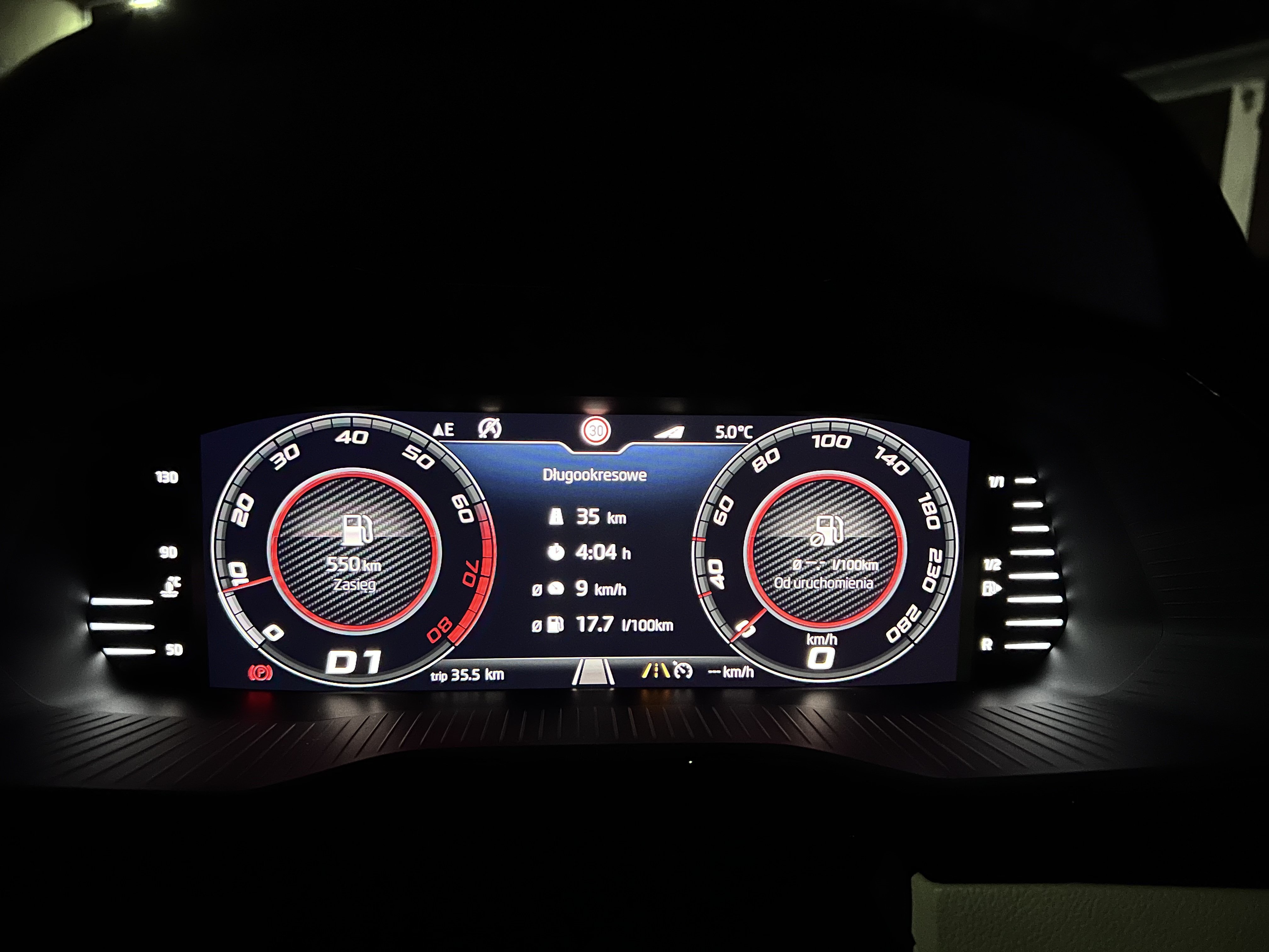

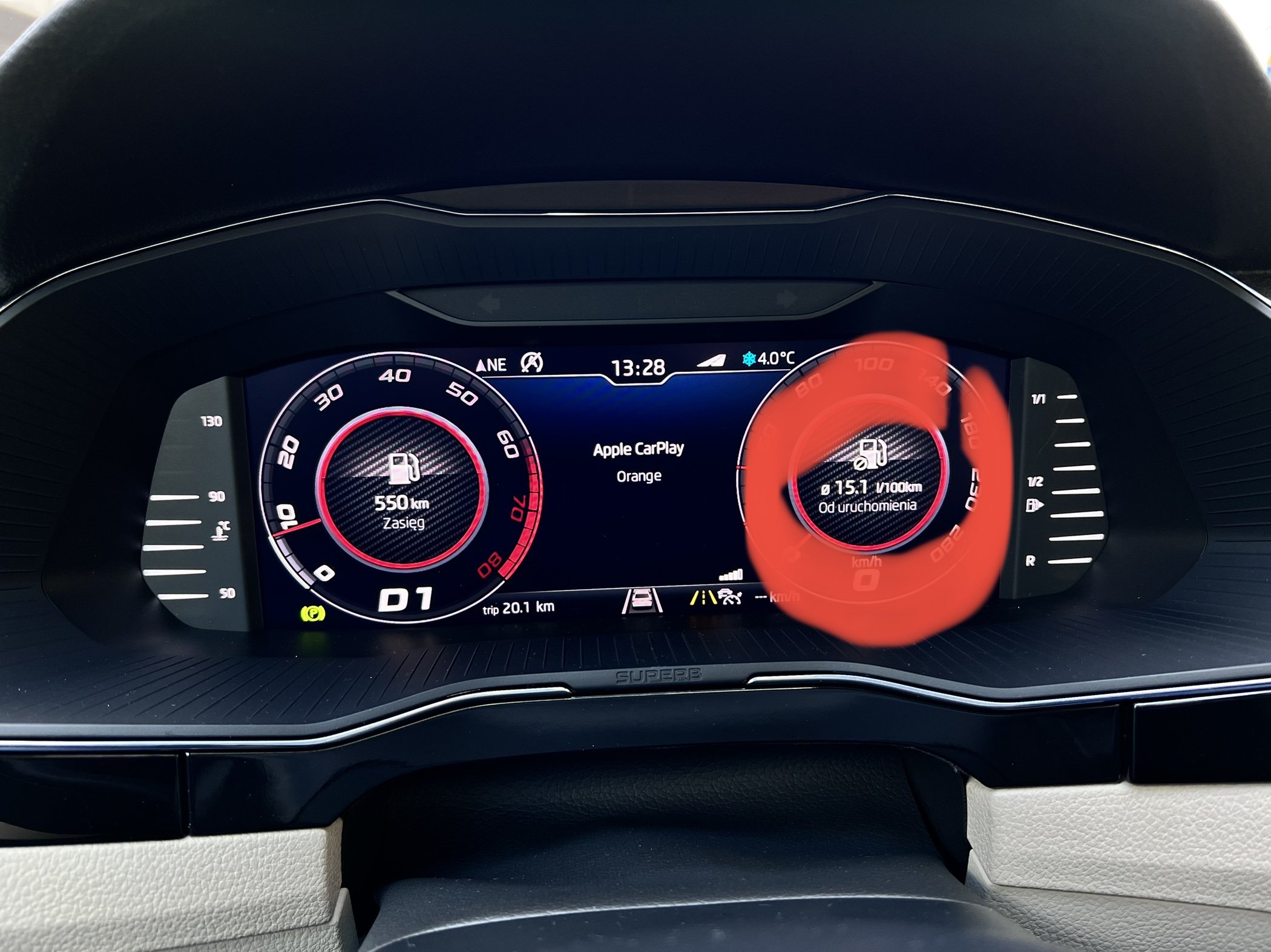

I have question about fuel consumption on VC. Do you know how to change from “since start” to “from refuel” or “long term”?
Did someone change button on wheels?
You can switch to show from refuel or long term if you set the display to driving details and push the right hand button.

I don’t if we tallying about same place. I attached photo to show you where I want to change to long term.
do you know what change buttons with “VIEW”. It’s only about label on switch or maybe new option? Now I can go to view with putting right scroll.
On the centre screen go to trip computer - overview, click the ‘ok’ scroll wheel till it’s on long term. That will change the small display also.
Driving data selection affects the larger dials as well, don't know if it 'remembers' the selection though.

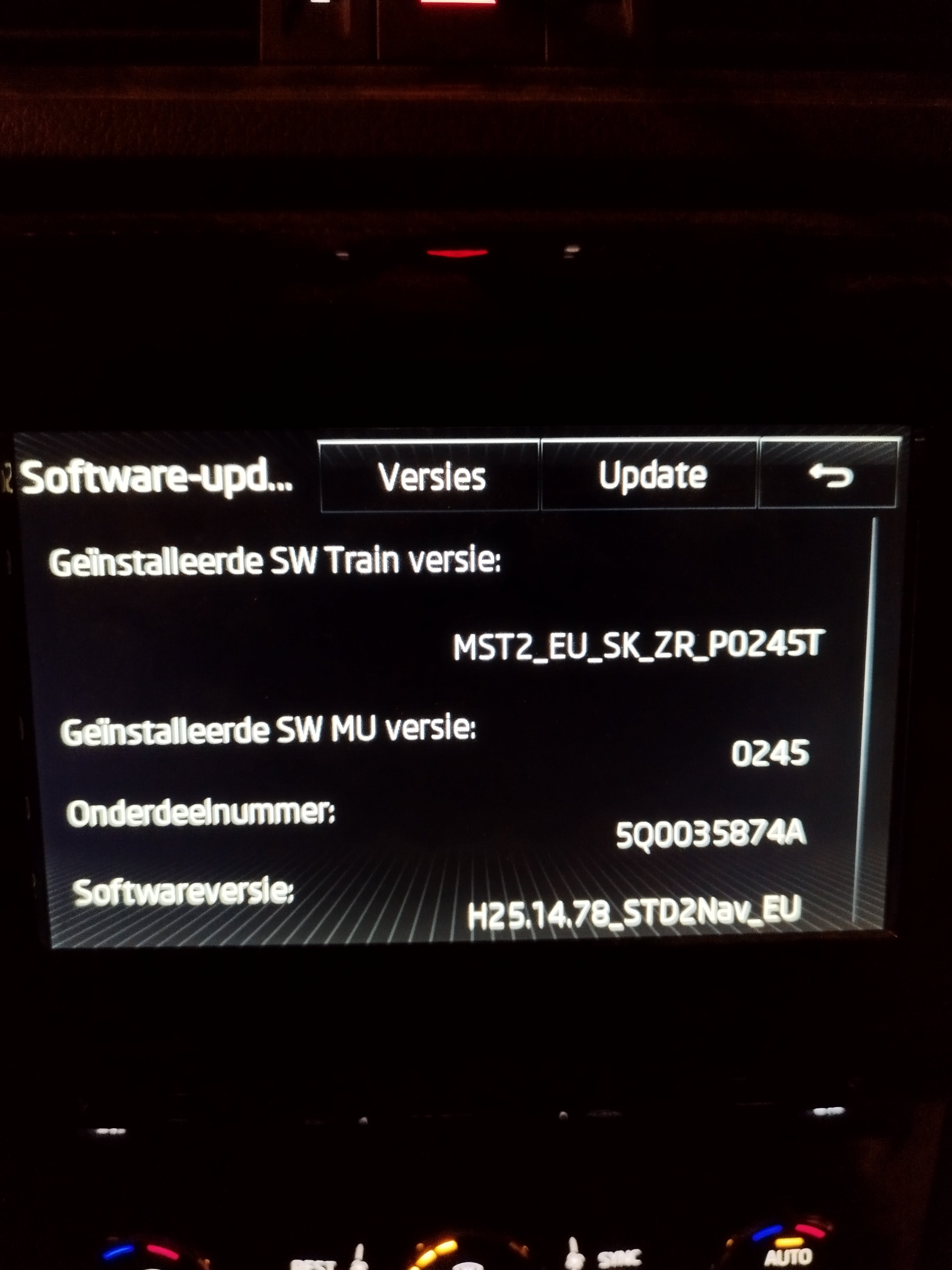

Software version >= 0478 + the vcds adaptions in this thread
Radio update to 0478 and the vcds adaption?
