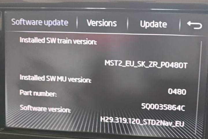

I completed by VC retrofit. Everything works pretty much except for virtual cockpit menu in selection - car so I am unable to configure VC from my MIB
display. I tried updating adaptations below and 2 of these do not show up in ODIS-E or S. I was able to activate other adaptations without any issues but these two are missing. Any one has any idea abt this issue?
Attaching picture of train version and part no.
channel IDE11524-ENG137043-Vehicle function list BAP 2nd generation: expansion-display_configuration_0x45
channel IDE11524-ENG137044-Vehicle function list BAP 2nd generation: expansion-display_configuration_0x45_msg_bus

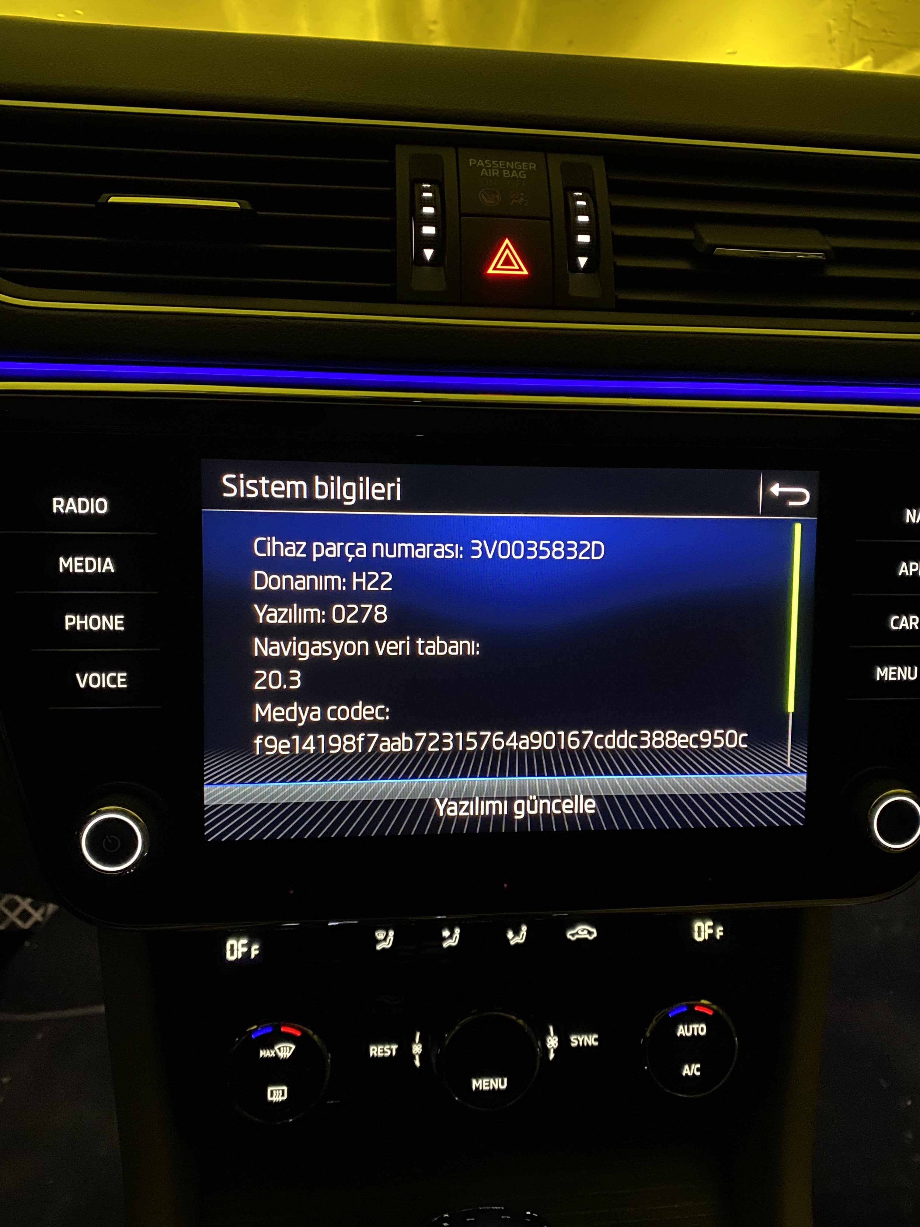

I'm owning Superb MY2016 with Columbus + HIGH2 (MIB2)
Have anyone succeed to retrofit 3VD920790A (3V0920790A) in MY 2016? Most of the Chinese shops are differentiating for a models up to 2019 to be sued part without A at the end , and afterwards to have one with A.
A local retrofit-er here mention that parts with A at the end are still using old security module and can be fitted in a model year before 2019. The difference according his words is extra menu with tachometer to A ending model.
Feeling a bit confused about which one is correct to obtain. non A models are significantly more expensive.

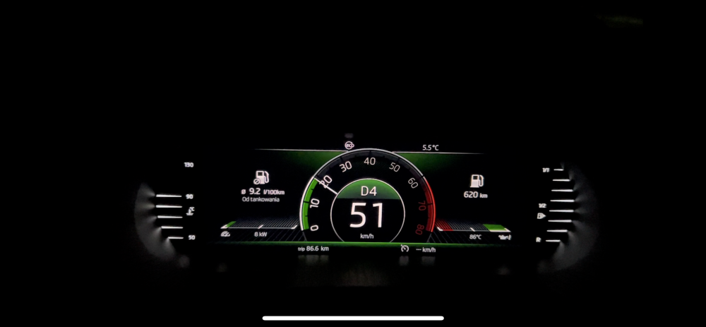

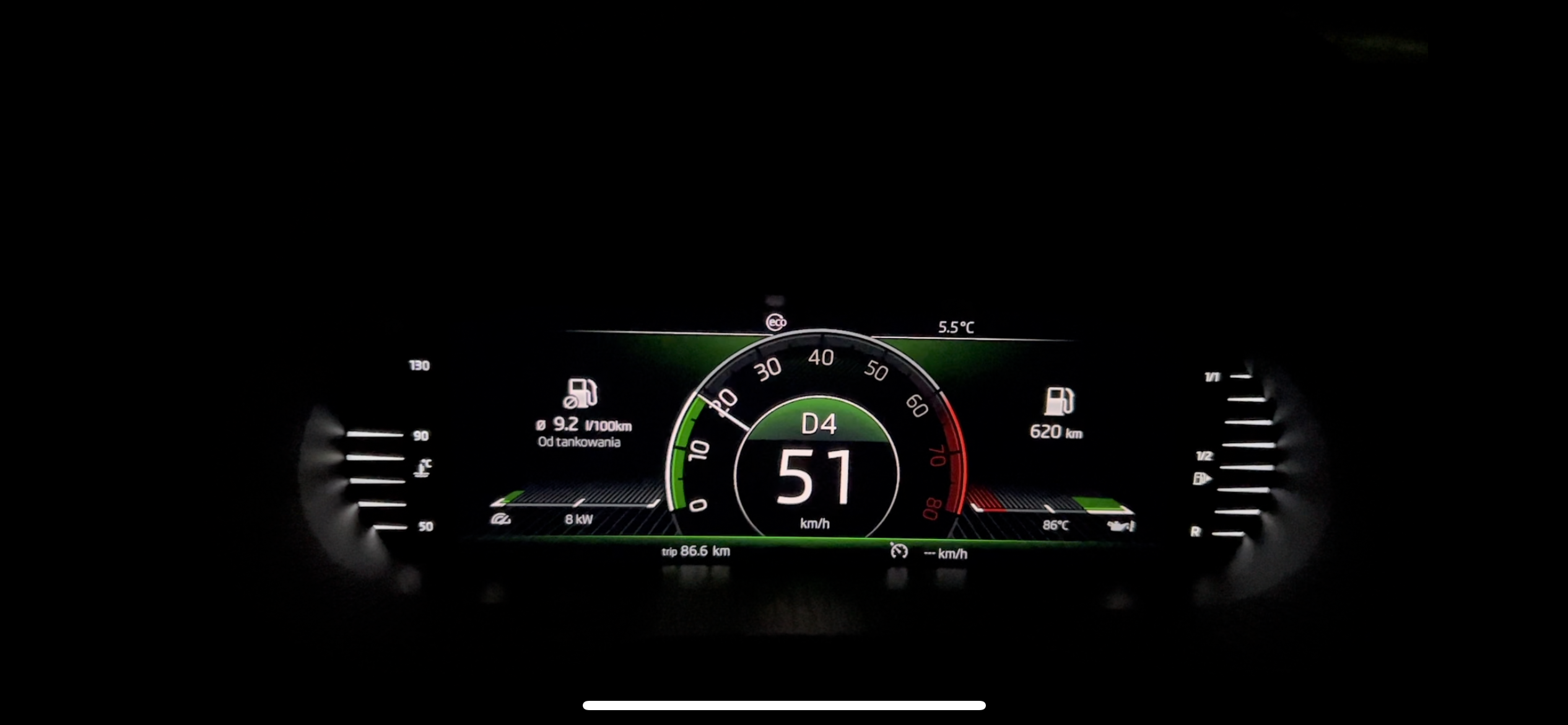

Hello, I saw this photo in internet. There is current and average consumption in the left side.
How can I do this in my car please?
Have this: Version: 9.2-inch display (a.k.a. MIB2.5). Superb 3, 2020 FL
Thank you.

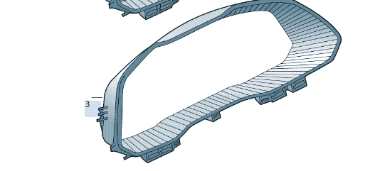

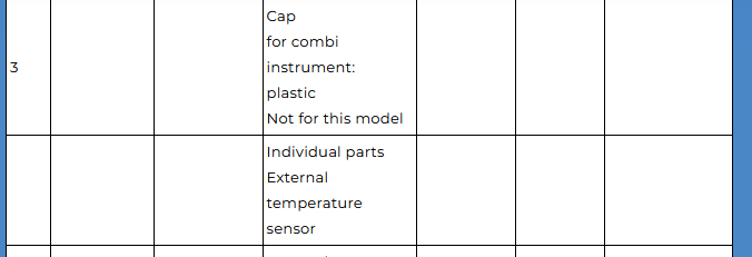

just wondering does anyone know the part number for this surround, going to fit a vc got most of the parts and the new module on the way but it didn't have this surround, cant get a part number for it ether
