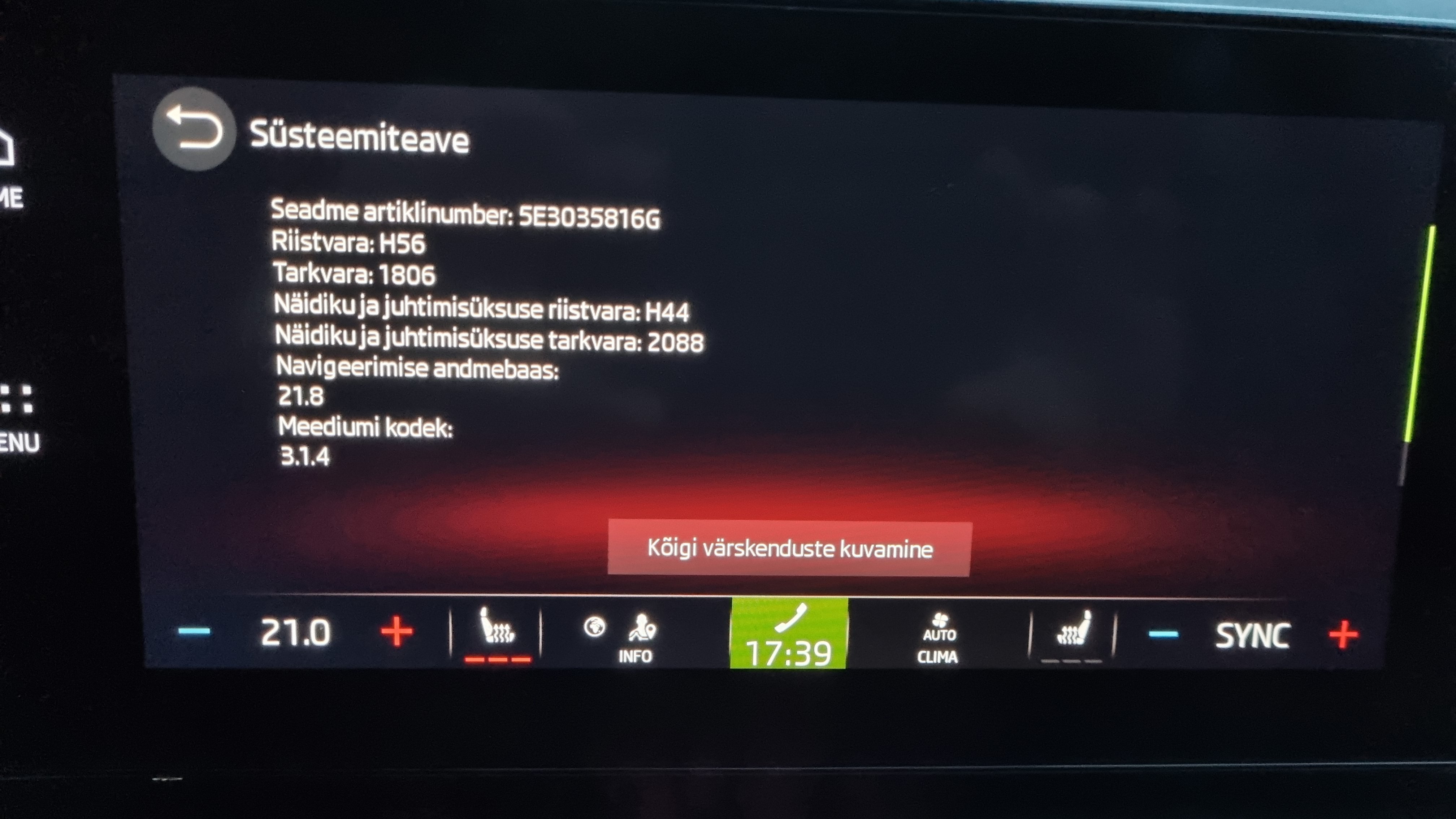

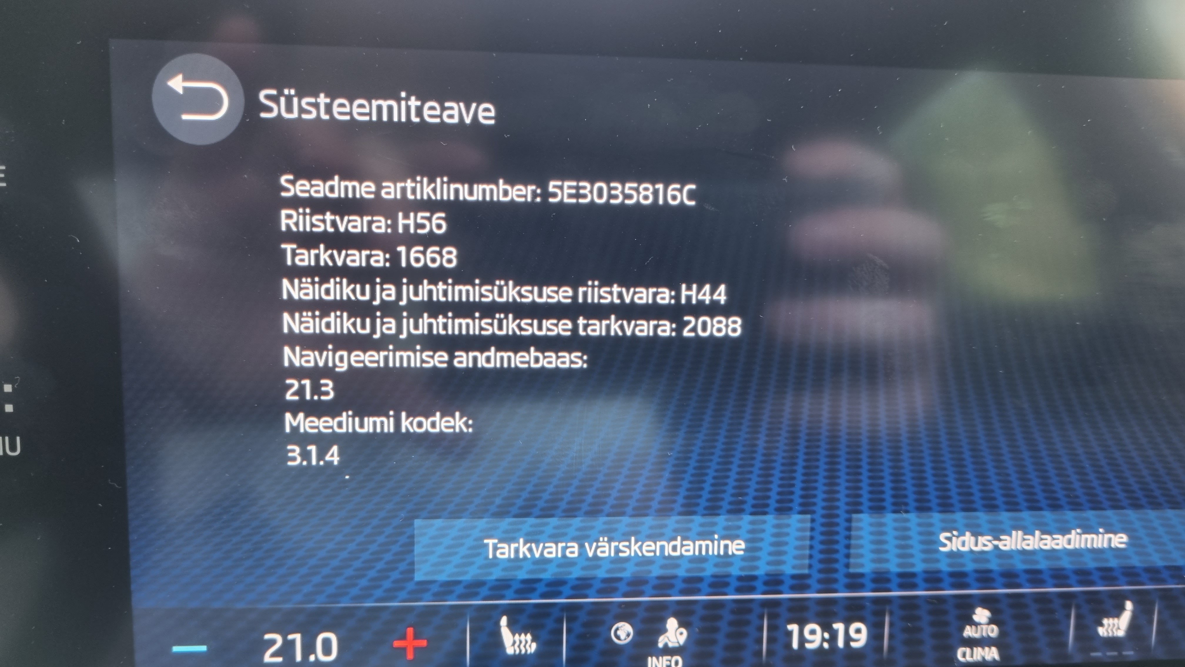

Hiya, so I was told it was an SOS unit replacement, oddly they needed both keys so they could recode them, which would seem to indicate more than just the SOS unit to me (happy to be corrected) but it is listed on the service paperwork as SOS unit replacement

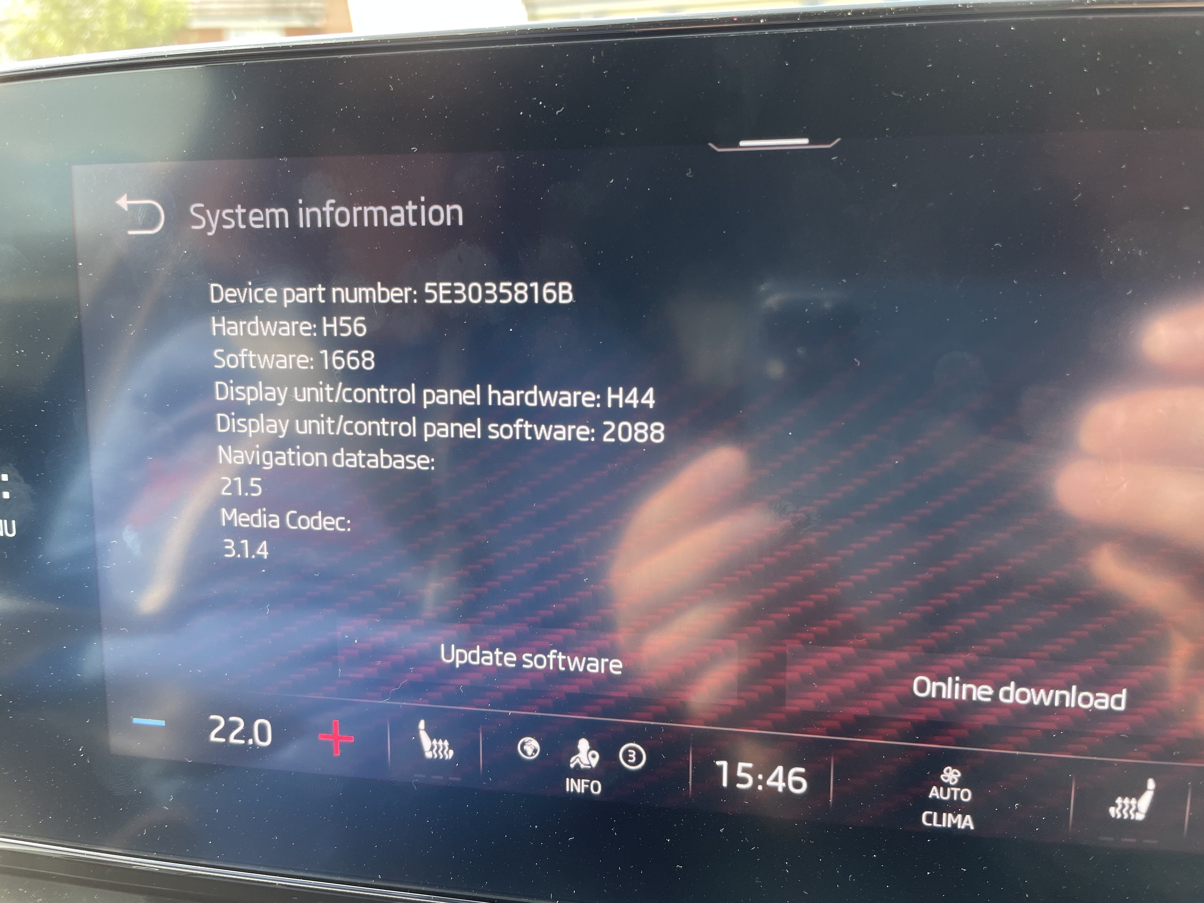

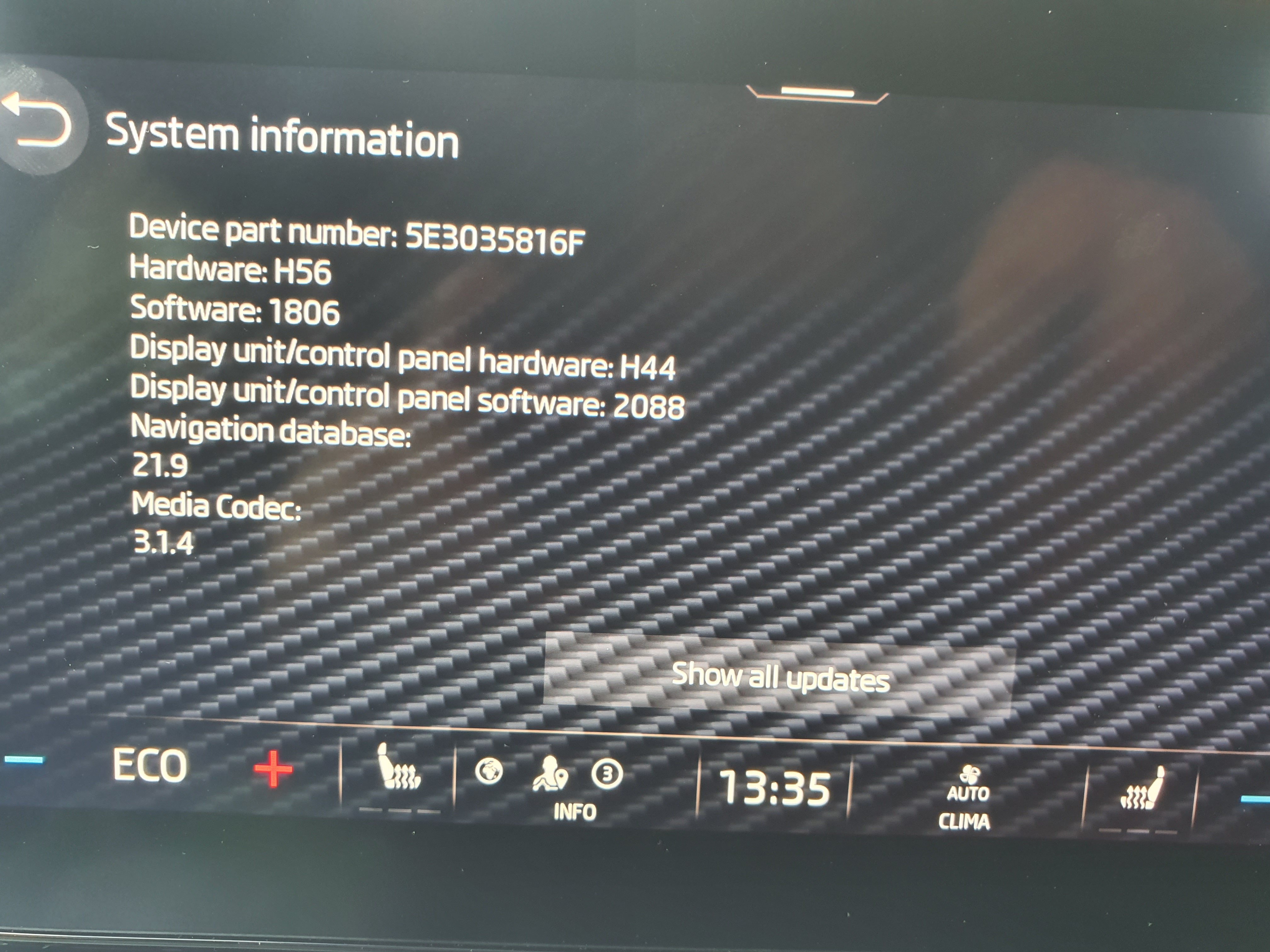

after:
Before:
Edited by VinzClortho

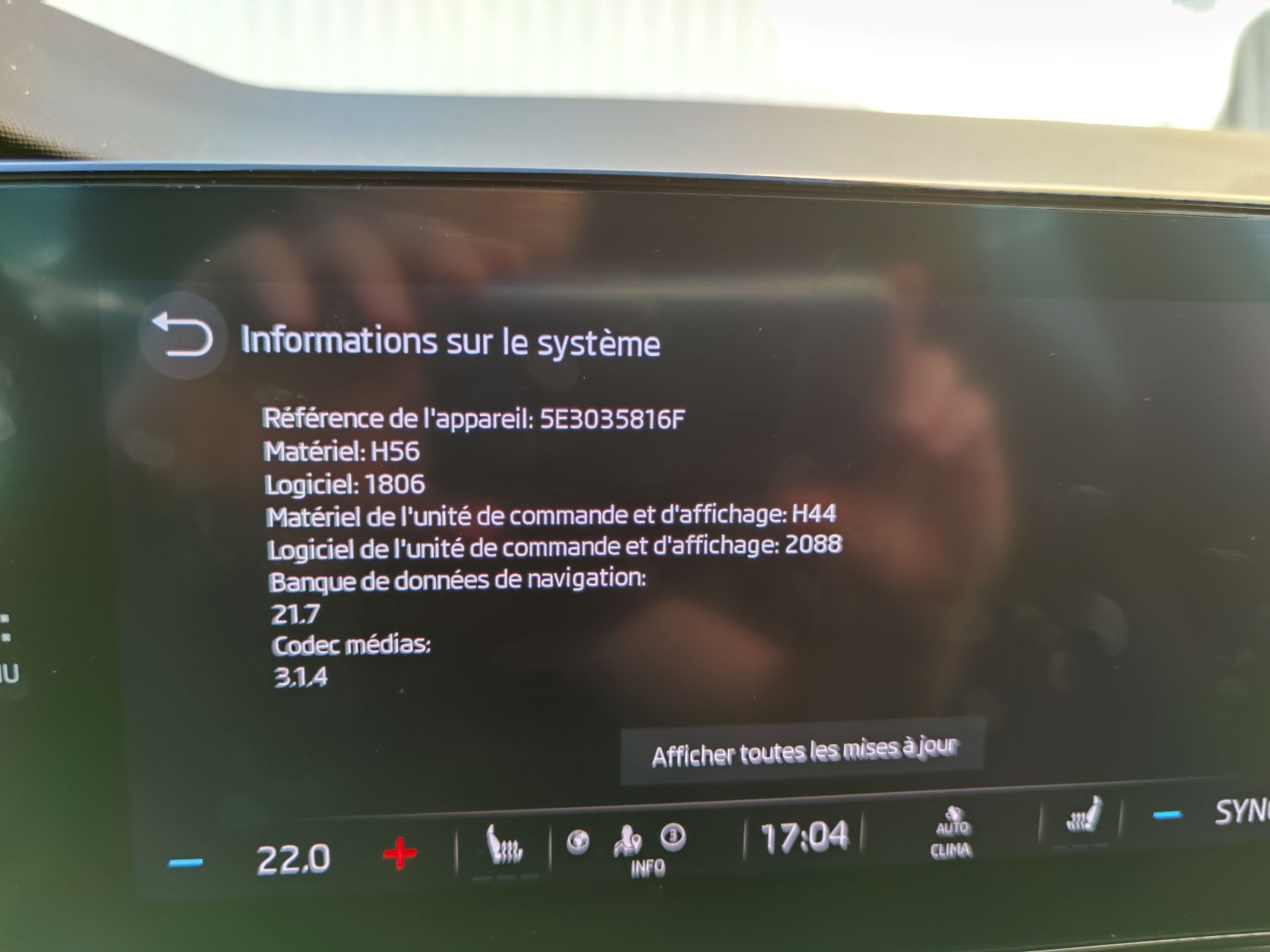

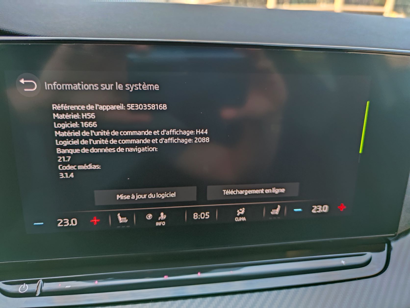

Sorry for being late with the replay, I bit off this weekend. Sure, I do have photos of the pre and post:
Pre:
Post:
And regarding the connection mode, not sure what it is about. For the wireless connection I did it off home, without using my WiFi network, and it worked well.
Thanks for those, it's very helpful.
Did you have your SOS module replaced by any chance?

Before:
After:

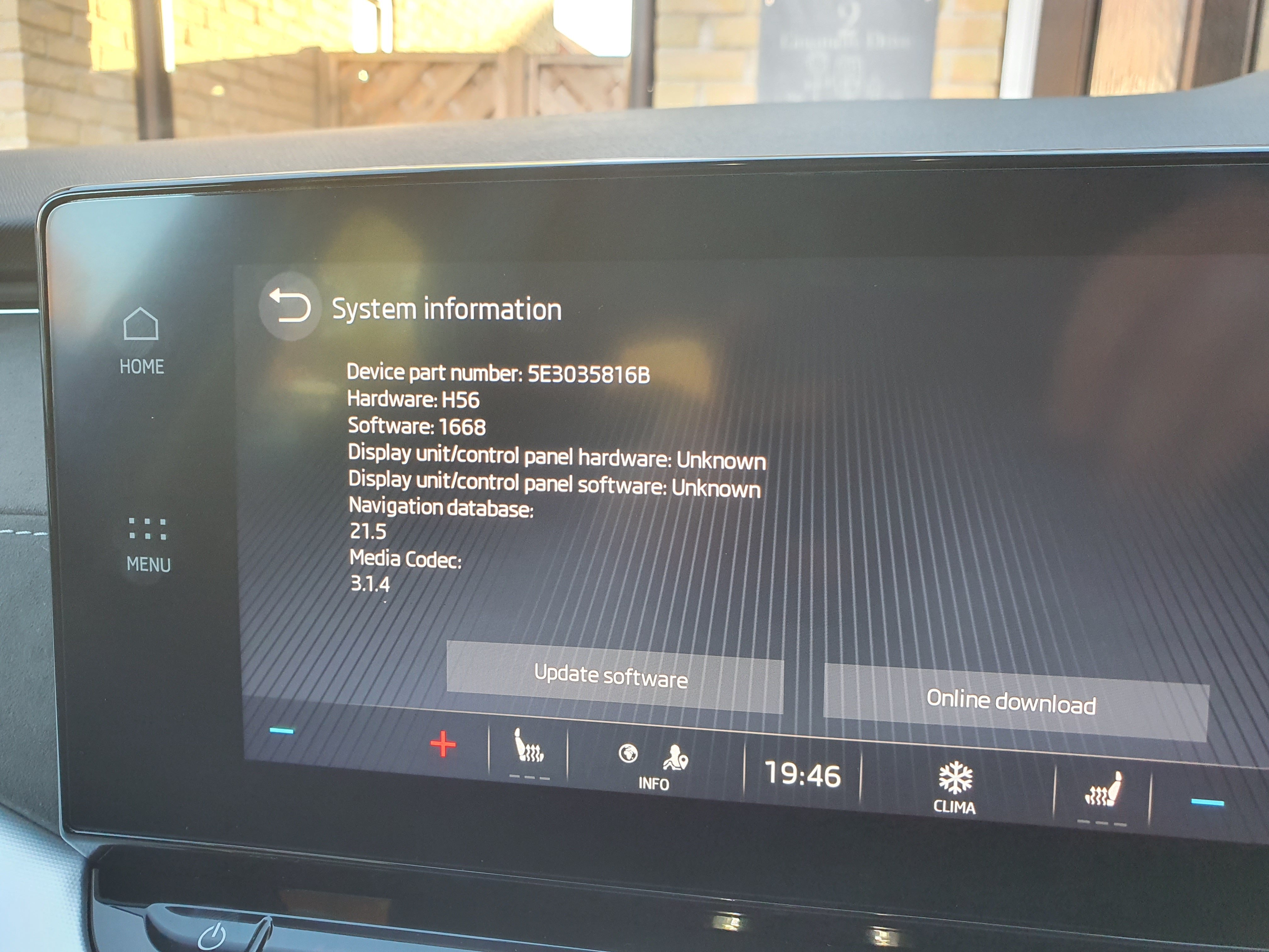

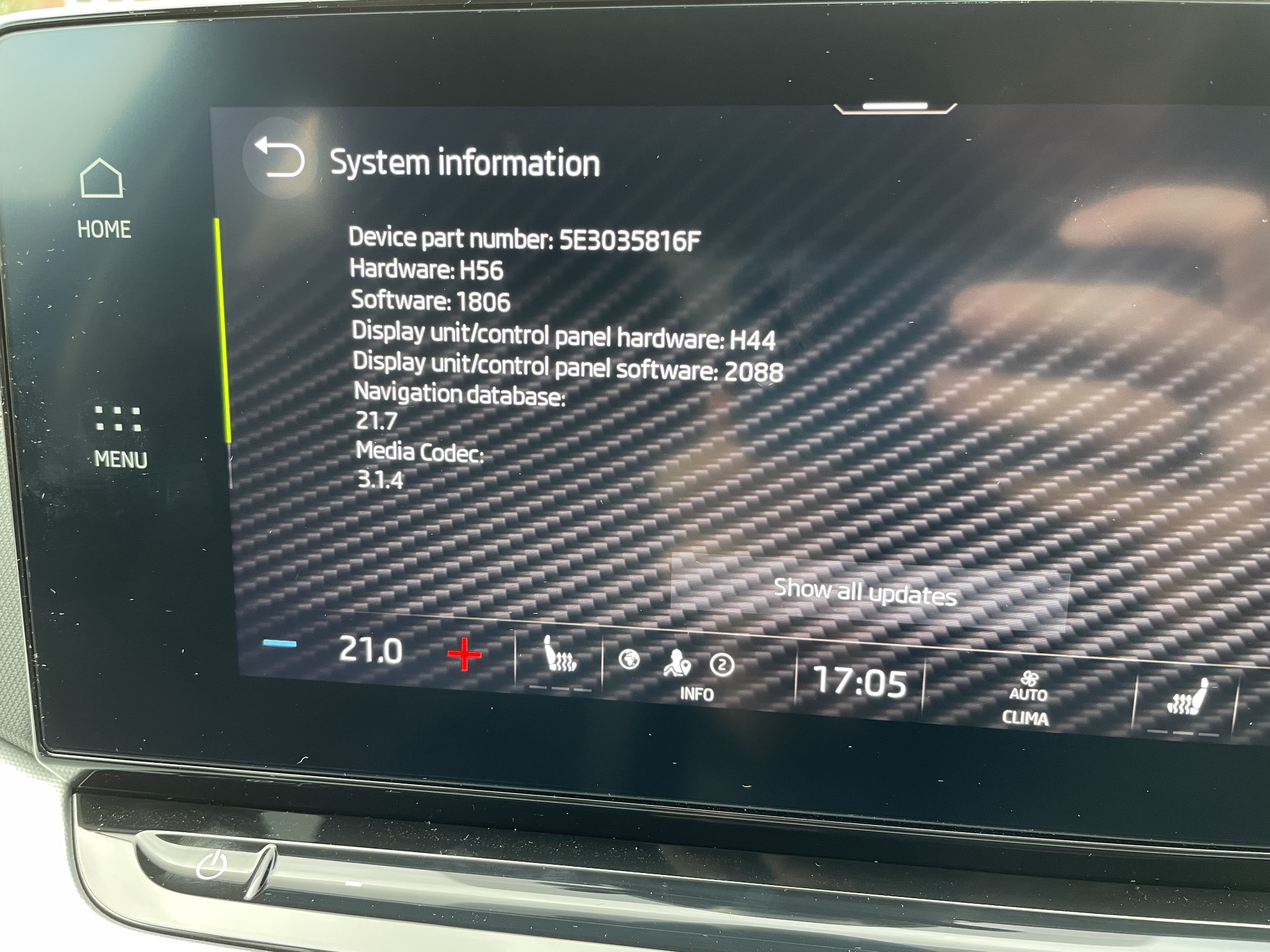

Finally had mine updated and Wireless Android Auto is now working! So much for the "It's not possible on your car as it's not a standard feature"
Before
After
