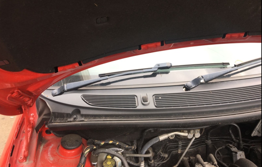

Also need to find name of cover that hides the hinge point of windscreen wipers…
Also pic attached.
Mine is exactly the same, has the white anti corrosion stuff on the battery and the scuff mark on the wiper.  Looking at used wiper arms on eBay they all seem to have the same marking so must be a common issue.
My matrix has that same corrosion on the wiper arms. I'd take the wipers off the car and either paint them, or get a nice set from a scrapyard.
My monte doesnt seem to have that wear on the wiper but they are pretty faded.

Ok cool thanks 🙏. I won’t sweat it as much then lol. Going to look at options, better half does vinyl sticky stuff through her business so might see if we can cobble together a solution. Also maybe I can paint it…hmmm🤔
@DieselMonte good point!  I need to find a scrap yard near me. That’d be handy for future thoughts and plans I’m sure😂

The bottom of the wiper arm is a common sight on cars, it probably does have a name (the rubber part of the wiper blades are called elements) but it's part of the arm as a whole so unless you're really into DIY you'd have to get a complete arm (new or used).  I expect you could do something to it and paint it all but I don't know what you'd use, I avoid paints and adhesives.
I do know applying paint to plastic, particularly if the plastic is scratched, isn't an easy thing to get a really good finish and paint on plastic will look different to paint on metal, then applying the very reflective top coat highlights any differences more.  A suggestion, as plastic doesn't rust why not leave it until you have more practice and able to do more research on how to get a better finish.

Just to clear up, that car never ever had a plastic dust/water cover on the end of its wiper arm, that small plastic bung to cover the nut is all that gets fitted to front wiper arms nowadays - well from VW Group anyway, so new/used arms it will need, I'd think getting a good job done on alloy that has powdered away like that, will be a bit tricky - even using many coats of satin finish Hammerite .
I expect you could wire brush the arm hinge end and give it a lick or two of paint but I'm not sure how good it'd look and how long it'd last and possibly unless you can blend in you might have to paint the rest of the arm and then the other arm to match.
Some people seem to have a knack of removing the arms but that might need a soak of GT85 or PlusGas (ordinary WD40 isn't as good at penetrating) and then you might need some sort of puller or less subtle tool.

the wipers can be sanded down and given as many treatments as you like, rust inhibitor, etch primers the best of paints, they go back to crap.
Yes they probably need frequent paint touch-up.  Usual thing of prevention is better than cure., either do the best that can be done or buy new and start from fresh.
It becomes a pre and post winter exercise if you want them looking nice.
