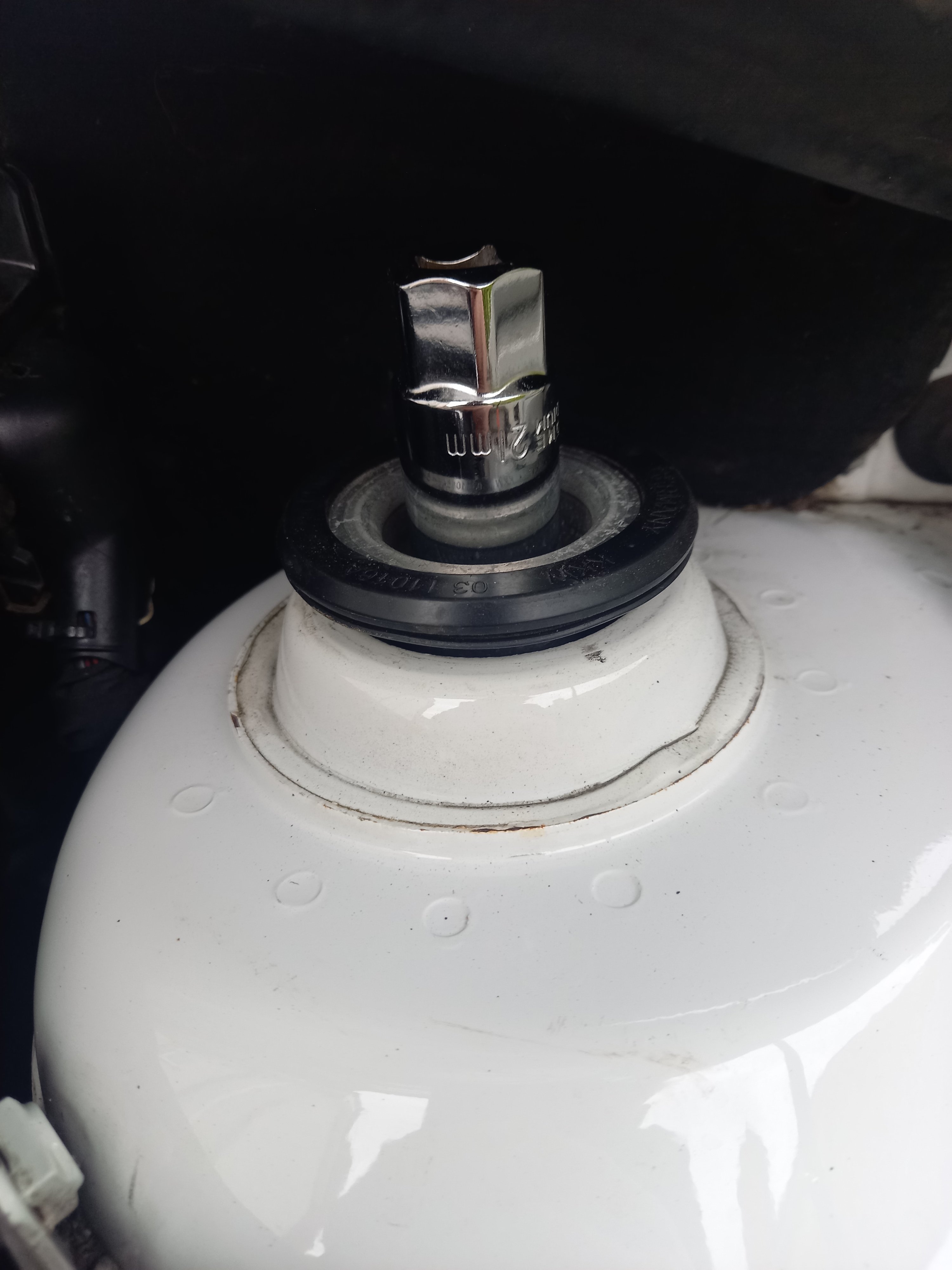

Also some camber should be possible if you loosen the 3 bolts that hold the top of the strut, there should be a degree of movement in and out.
Not all fabias use the three bolt top mounts. Top mounts on facelifted fabias (including vRS) Is not the three bolt design that the mk1 has, its one bolt with a cap on the top like so.
No adjustment there.20210916_181021.thumb.jpg.67c8ac57b0020c7f0b00e66ac9c22296.jpg
Pretty sure Powerflex and the likes offer bushes that can be adjusted to change camber and I know superpro do ones to change caster.
