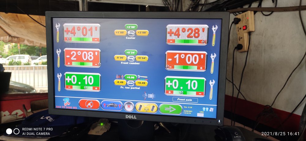

Alignment guy said my camber is out but there is no adjustment for camber. Attaching wheel alignment picture for better reference. Any one can give me any solution. Do I need to replace knuckle or steering rack?
There possibly is, what year is the car?
On early mk2s as well as mk1s, the subframe is held to the chassis via the 'consoles'. item 23 here: wishbone; wheel bearing housing; anti-roll bar; F ... - Fabia(FAB) [EUROPA 2008 year] (7zap.com)
These have holes with big clearances (+/-2.5mm in all directions from perfect centre) for the bolts that hold them to the chassis, so fine adjustments can be made.

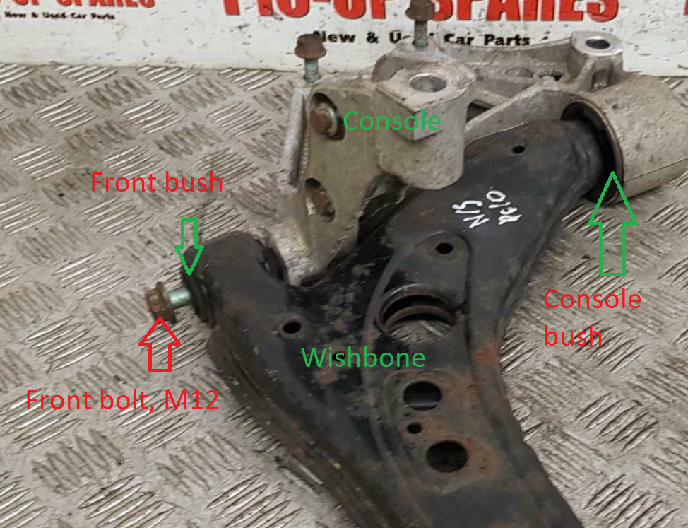

What do you mean by consoles?
Dont think theres any adjustment on later mk2s, aside from bushes with offset holes for the bolts.
The lighter coloured part is alloy and that's the part that was cracked where the bush was located, the other part iss pressed steel as i said the original bush is not solid and moves and splits after a few years (3 in my case) these were replaced along with the whole alloy mount and sorted the pulling left issue out, a garage friend has also mentioned that they have had issues with Lucas fitted calipers on the left side with sticky pistons that are effecting the car pulling it to the left, he told me that if you look at the left wheel does it look like more brake dust on the left wheel  than the right side, if so the caliper could be the issue and might need replacing or or servicing--new piston and seal kit, worth a look at it
