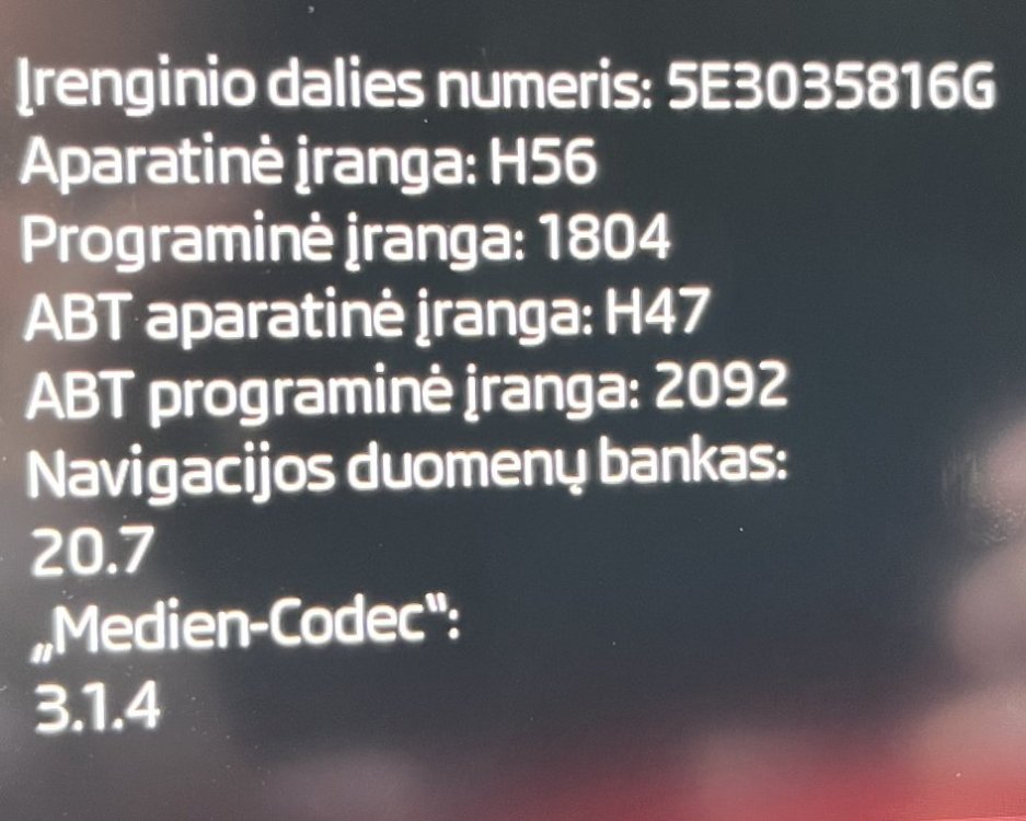

We are aware of the different software levels for the MIB3 (1788 / 1803 / 1804 / 1806 ) but installing any other software is not recommended by the factory for your particular vehicle and media unit updating to a version different than the current version installed may cause software incompatibility with the rest of the modules and the software levels installed in your vehicle.
Some of the vehicles may run on MIB 301 Unit with software level 1804 / 1806, but this does not mean these software levels would be any good for your vehicle configuration.
The next software that is compatible with your vehicle would be 5E3035816D 1888 and is planned for release by the factory in Quarter 2 year 2022.

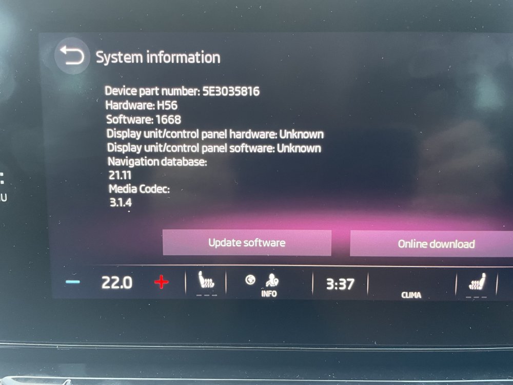

Mine was updated this week to supposedly  “the latest issue that doesn’t cause other issues “ so this screen shot would seem to indicate that all these screen shots are meaningless or we are all being fobbed off
We are not. Not all cars get the same updates. It depends on what components are build in the car. For some the latest is 1803, for some 1806 and for some 1810. My car for example was updated to the latest SW in mid December and I'm still on 1788. All updates for certain VIN are pushed from the factory. Once an updated is available, the garage sees that and they should call you to bring car in for the update.

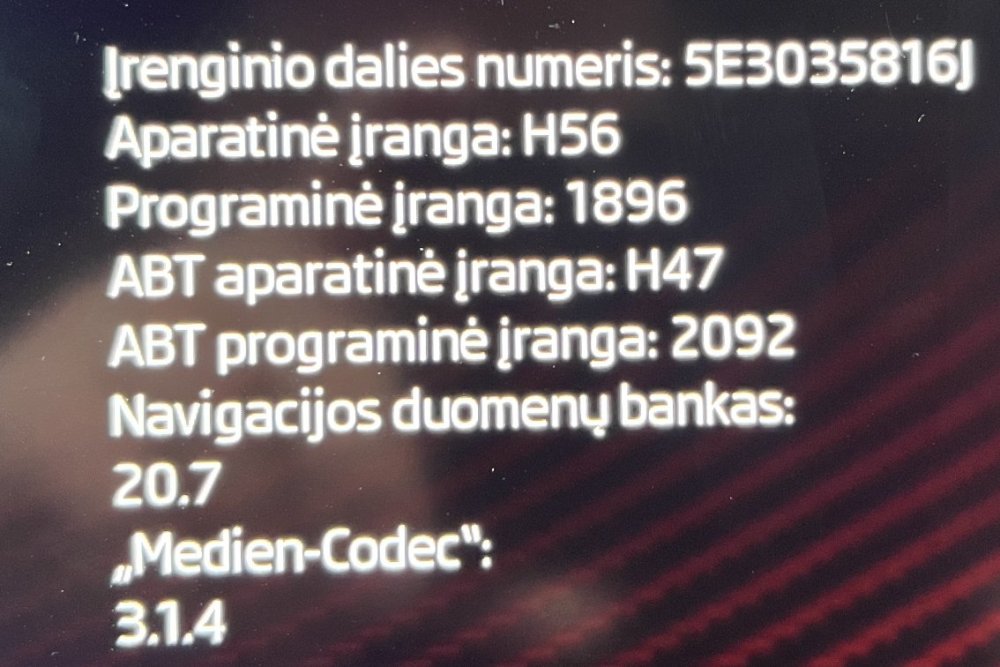

What I can tell you is that some of the newly delivered cars already have SW version 1889 (according to German forum).
Newest Skoda software with the new hardware is 1889. Mine has it. Older hardware is supposed to be receiving the big update sometime in March according to rumors, but nothing is confirmed.
Mine vRS, which i picked up this week, is also with that software and hardware. No issues so far (done about 1k km).
