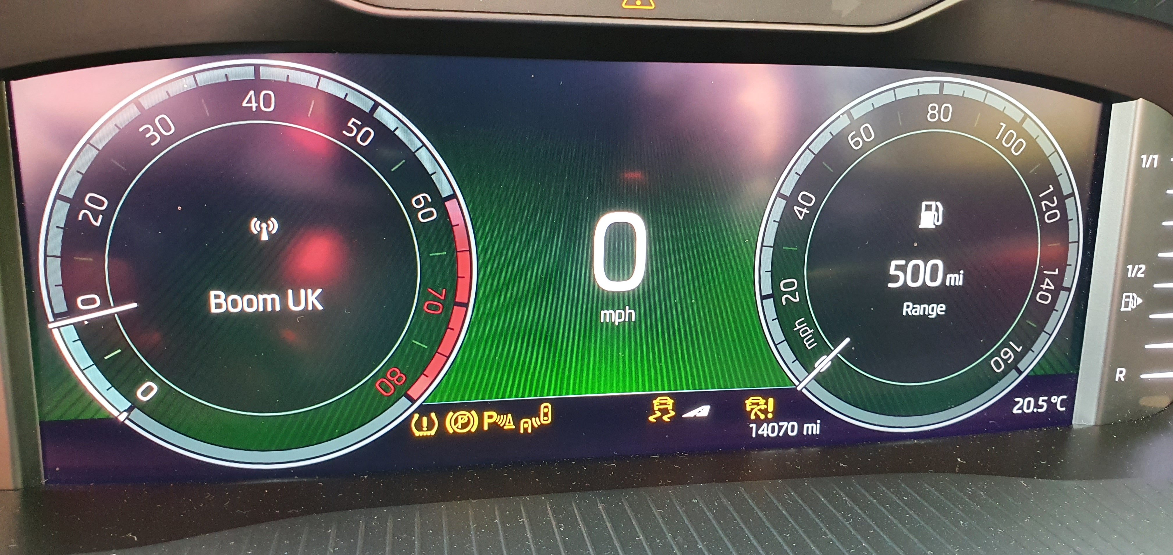

So hi all here I am again to update you software wise. It is now 1year and 3weeks since I picked up my VRS. 9 workshop visits all of which failed to deliver a full working car software. See all my previous posts. Having posted and followed all peoples postings and given my issues, with my engineering head on it was my conclusion that without a new head unit and so a faster processor it would never be right. So I gave up trying to argue and resided to the fact of living with the crappy software.
Then out of the blue a call from Skoda saying we have a fix... Mmm I said... Trust us they said. So dropped off at the dealers had coffee biscuits and a chat as I feel like I work there now! On my way in the courtesy car and await the call. Expected a come and pick up the next day.... But no wait.. 4 days later.. Hi its ready and all is good they say... Mmmm we will see I said.
Eat my words I must now do!
It's a miracle everything works as it should... Finally. What's the secret I ask. Oooh new head unit and processor they say. [see pic] loads up in 3seconds now and after 3 days trying to make it break I can't 😊 finally a working car. Only taken 12 months but.... Thankfully it ok now. So stick with it people keep giving Skoda hell and eventually it will be ok. 🤞👍

Yes new hardware. I marked the screen before it went in. And if you look at all my posts there are a lot going back 12 months. When my car arrived it had the latest software then. 9 times they attempted a fix before changing the process and screen

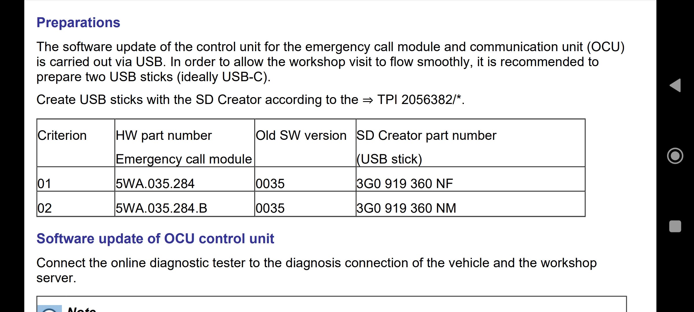

Did any of you guys have to pay for the Software upgrade? Garage have quoted me near £130 to sort the SOS module...
I don't suppose you have access to VCDS scanner?
There's a Service Campaign 91CL running until 31-12-2026
It applies if your hardware versions are as below (and SW 0035)
Screenshot_2022-09-21-12-56-53-287_com.google.android_apps.pdfviewer.thumb.jpg.2de46ed4994e03d7e453e37894ced2db.jpg

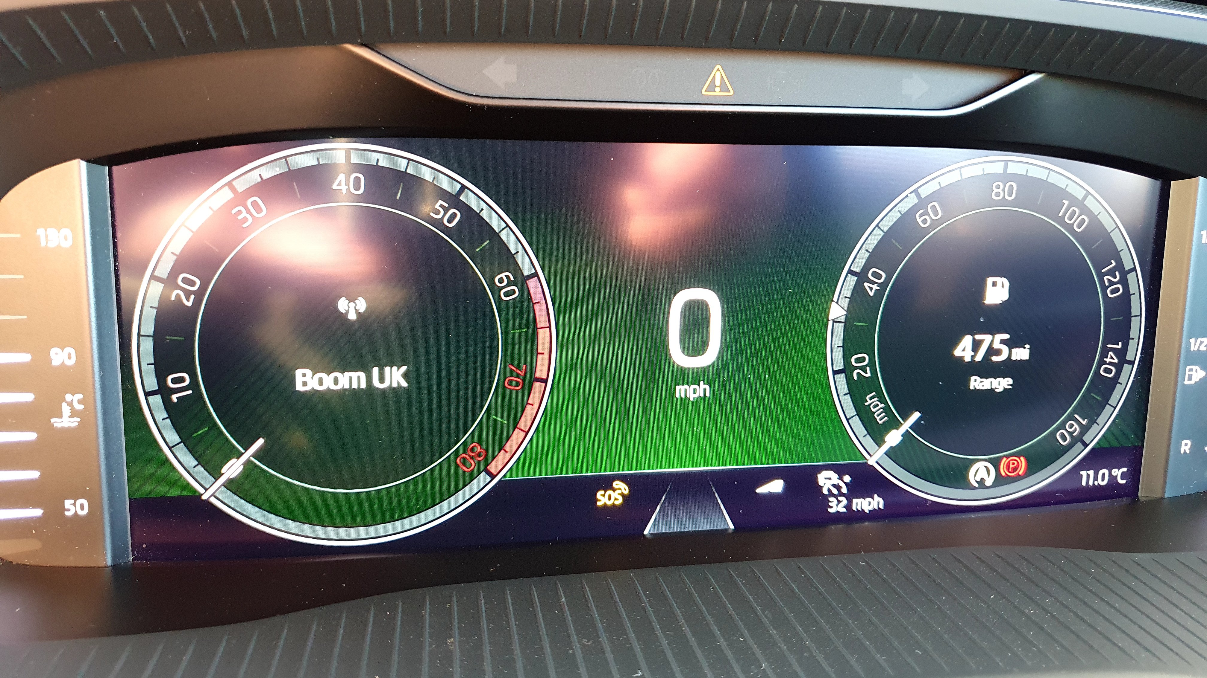

Well just back from dealer obviously now waiting for back order head/ocu unit to be fitted now running on software 1896....
Within 10mins of leaving dealer popping and sos-ing as before....
Yep, had my pop pop SOS last time I drove my car and I have the latest software, hadn't had it for a couple of months so its not completely fixed. Not sure if its because of one of the OTA updates or not, I hope it was a one off!
