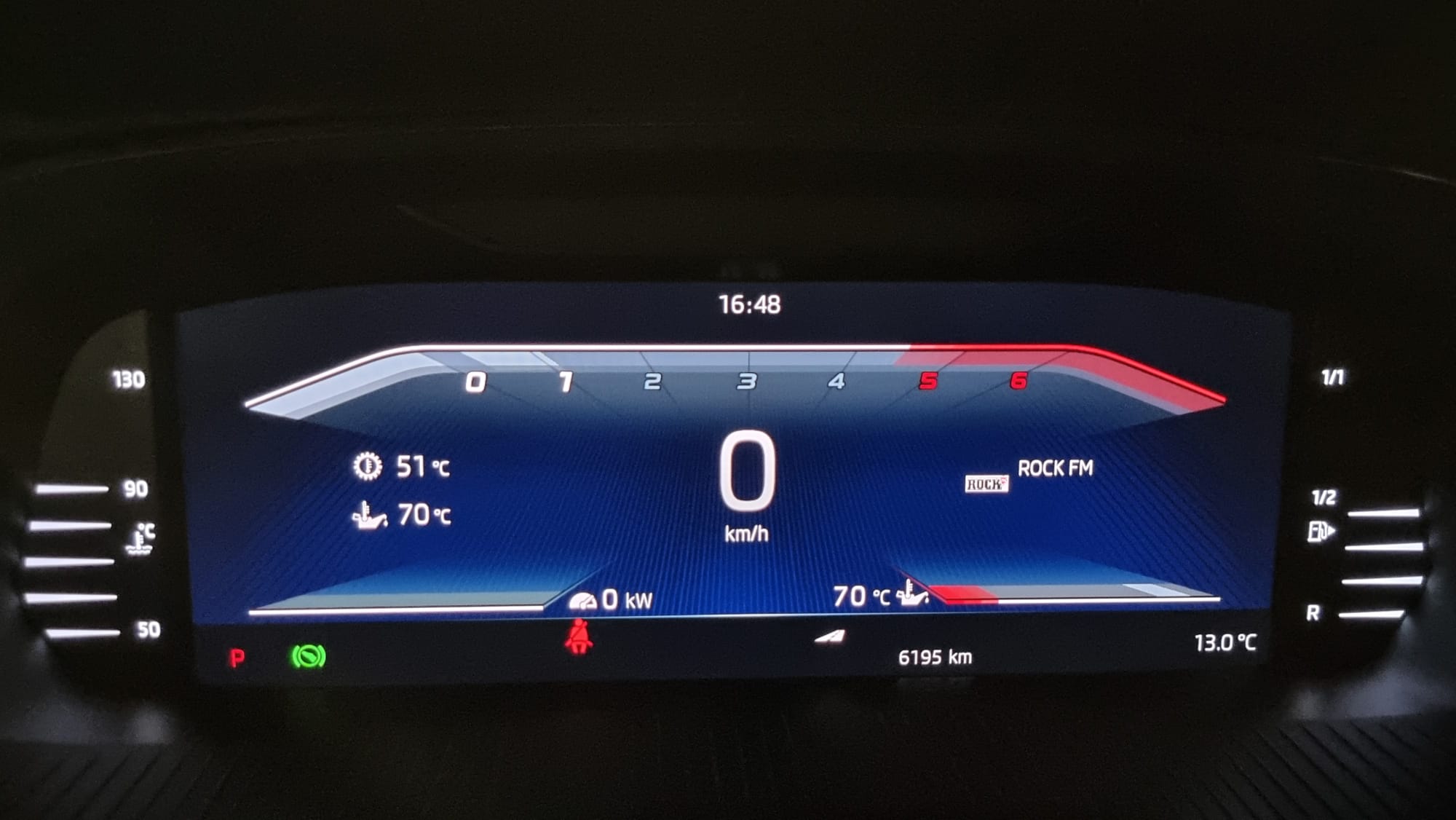

I tried to do the manual coding for the stuff that didn't work with OCAs. Both the g-meter and the Fan-level display were showing as "Active". Nevertheless, I set both to Inactive and then back to Active again, with no luck - neither works. @djmartzian: I also have Bolero - so that might explain the g-meter not showing...
I also activated the Turbo-pressure and the set of 3-parameters DSG-temp.&&oil-temp.&&water-temp. Both are shown, but the 2nd only shows 2 parameters instead of 3 - DGS and oil temperature (1st picture). As you can see that's a bit redundant - having the oil temp in two places on the same dashboard layout.

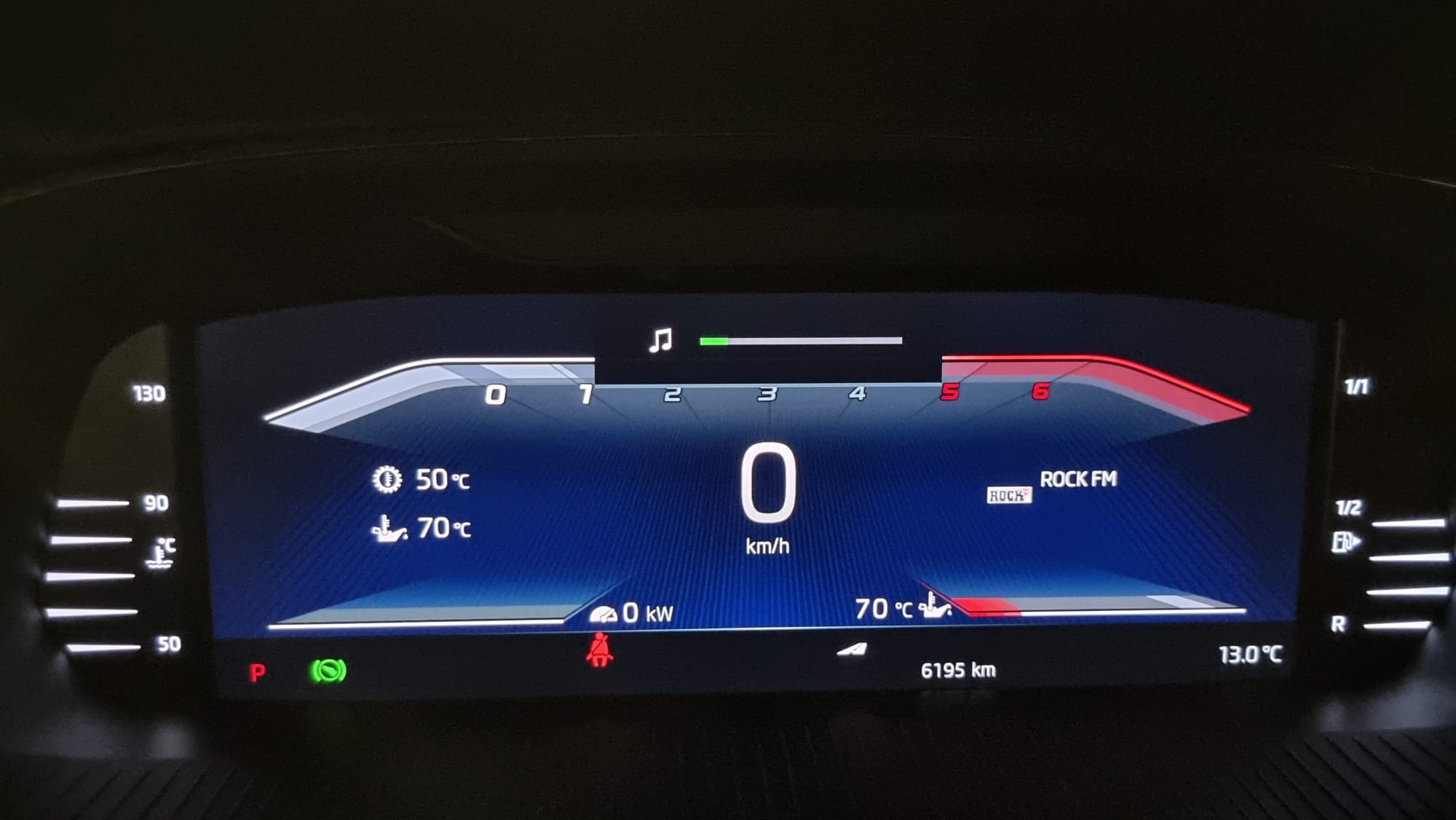

2nd picture is related to a question I have: after I activated the VRS layout, I noticed that when the sound volume is adjusted from the steering-wheel, the level-bar sits on top of the rev-meter as if it was not supposed to be there. So the question is: does it look the same for those with native VRS cockpit view?

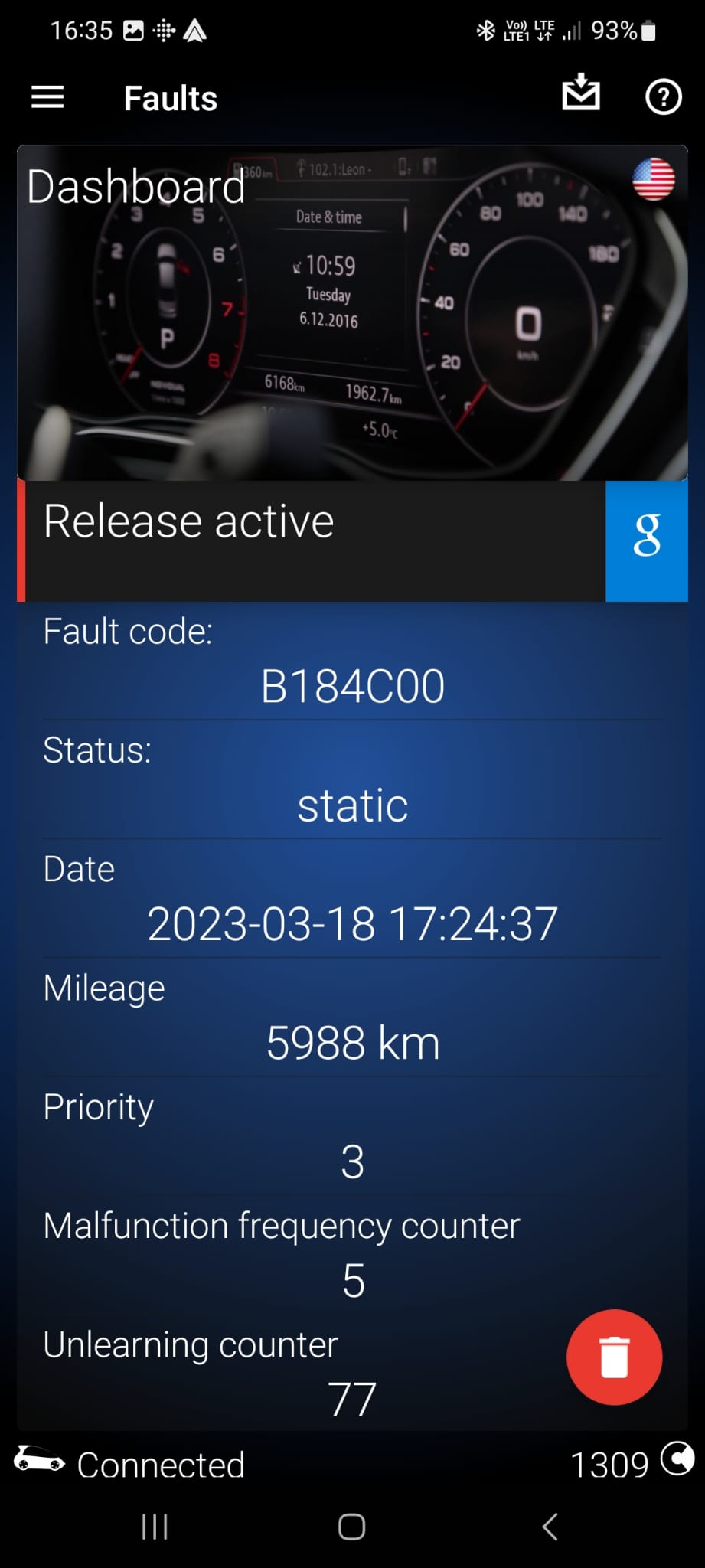

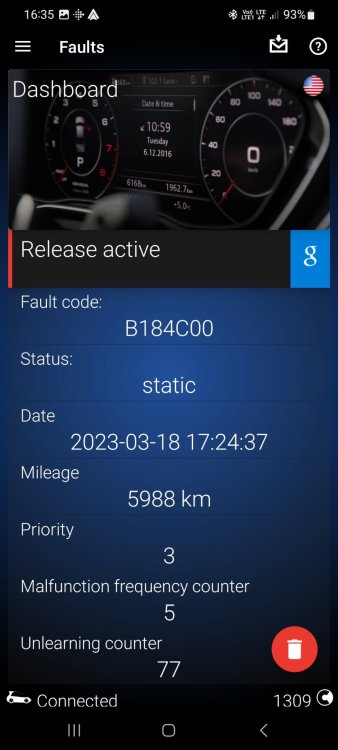

And finally, after the suggestion of @djmartzian I decided to rescan for errors (I only scanned before unlocking the SFD). I could't find any of the nasty B17D7F0 code he mentioned, and I was able to erase all fault codes, except 1: I have the B184C00 fault code showing as "static" on "Dashboard" and on "Central Electrics" units -see 3rd picture.
Should I worry about that? A quick search online showed that it might be normal as long as the SFD is unlocked...

you have to close the hood, start the engine, turn off the engine, ignition on - scan for errors again. now it won't show errors anymore
it won't show error till next time u make coding with hood open and scaning for error on that moment
Great, thanks for that tip! Indeed, I was doing the scan after I completed the coding. Did that after ignition-off and ignition back-on, but with the hood still open. I was too lazy to get out of the car and close it. (actually I had no idea that it would be the root of that error :blush )
