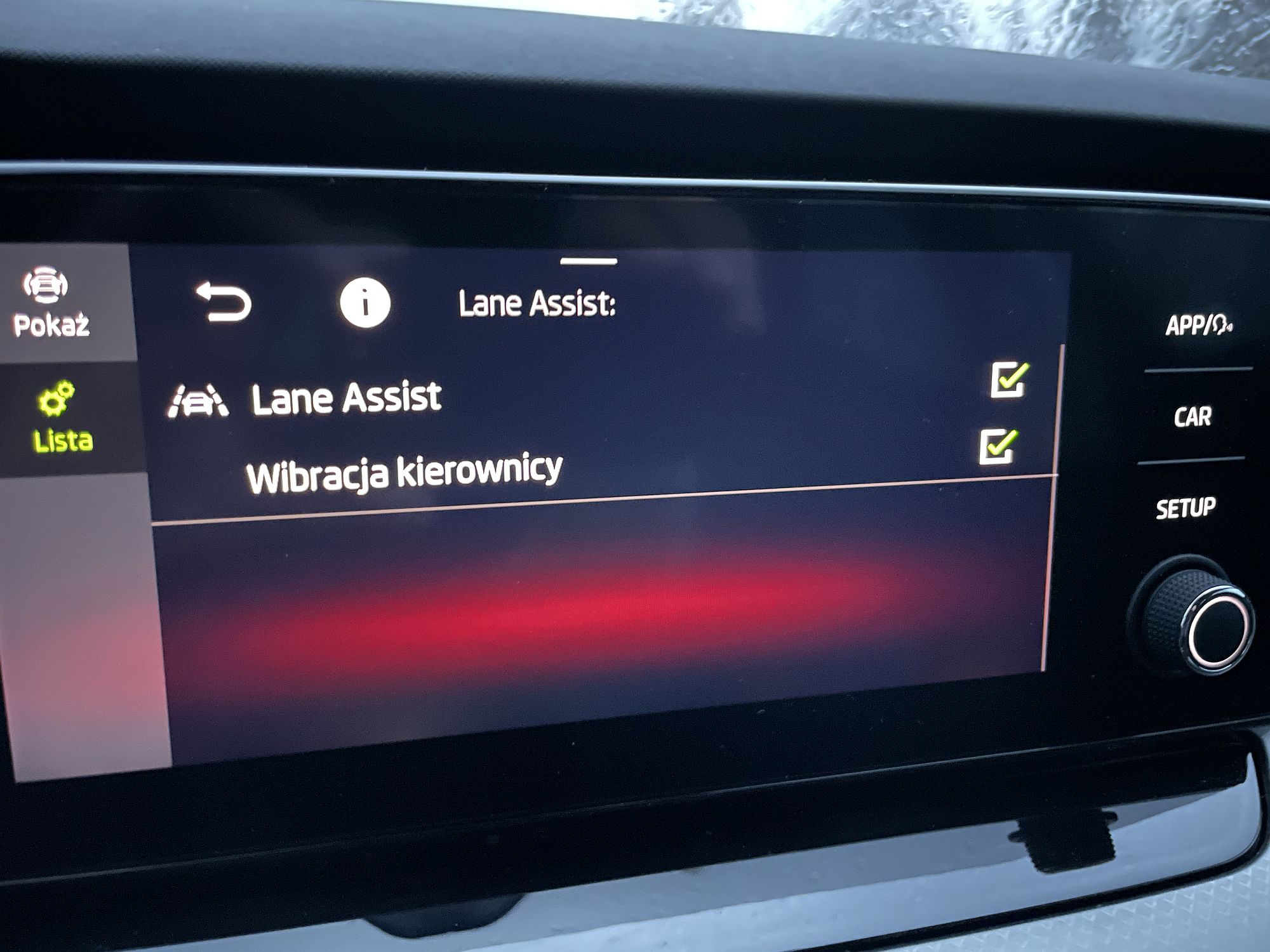

I have Octavia 4 Ambition with Swing Infotainment and no VC. And OBD11 ready to code :) I have two questions for You.
1) I turned on Adaptive Lane Assist (point of intervention - Early). But when I check option "Early (setting via menu)" I didn't get any new option in menu. Only possibility to turn on/off Lane Assist completely and turn on/off steering wheel vibrations.
I saw in some videos that in VW people gets possibility to turn on or off this Adaptive feature from menu.
Is it possibile to do this in Swing Infotainment?
2) Is anyone knows how to code Light Assist (automatic activation of high beam)? I tried turn on settings found on Scala forum, but it doesn't suite. I'm 100% sure that I can turn it on.
Thanks for any help!

On 20/04/2023 at 11:16, Ctflr said:
Are any credits required for changing the settings of the Lane Assist? Thank you!
No, You make it through "Long coding". So You need Premium account but no credits.
It's very easy to do, only change one thing. Go to A5 Driver Assistance and there find "Intervention moment" and change it from "Late" to "Early".
But! If You have steering wheel without hand detection, when You turn on Adaptive Lane Assist it will "scream" after 10-15 seconds "take over the steering!" even if You hold Your hands on wheel. You can move wheel a little and it disappears, but get back after next 15 seconds.
Unfortunately I have ordinary steering wheel and for now I don't want to change it, although this wheels aren't very exprensive if someone want to do it.

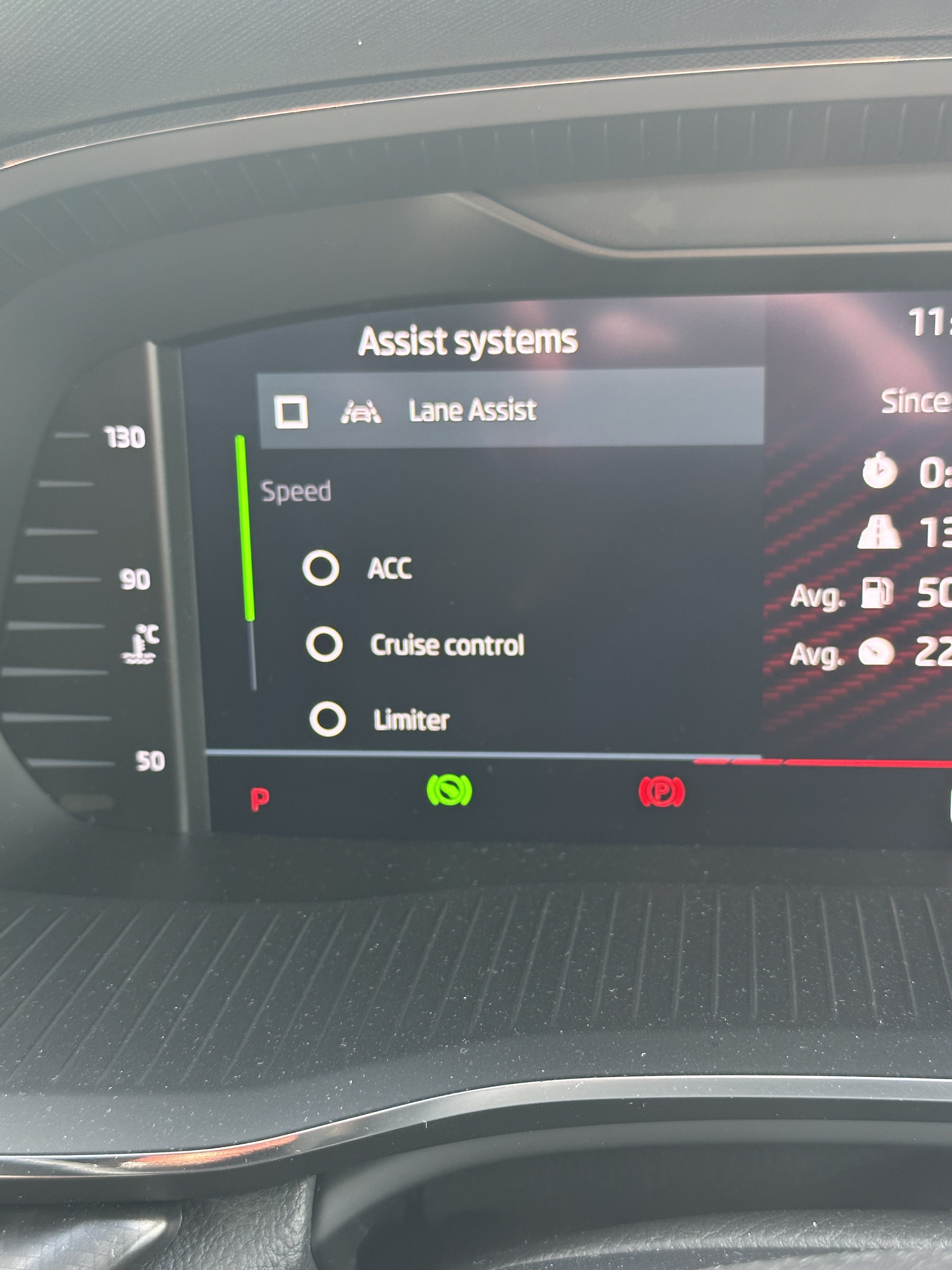

Thank a lot for the clarification! Yeah, I only want to change the memory of Lane assist to "last setting" so that I don't have to deactivate it each time I have ignition on.
Also, does anyone know if a change such as "EN- driver assistance (module A5) > long coding > Configuration for lane departure warning KI15 > change to "last setting"" has any impact on your warranty? Will you void your warranty if you make changes to this kind of stuff? Thank you!
Yes, this could be changed with no tokens too. And about warranty - I doubt if anybody in service checks this. If You don't mess with engine or gearbox - then nobody cares.

Any one know if you can code out the Adaptive Cruise control? And just add the normal cruise? Lane assist to be turned off  and as i have a hybrid to always start up in hybrid mode and not electric?
what do i need to do this or can anyone help In the Durham Newcastle area?
You can enable standard cruise and turn off lane assist using OBD eleven if your not sure on manual coding there is an option that does it for you it costs 100 credits for cruise ad 10 credits for lane assist memory

@Chrisg2021, Here is the coding if you would like to do it by yourself. Bear in mind that beside the dongle you will also need a Pro subscription.
Lane Assist to "Last setting"
Driver assistance (module A5) > long coding > Configuration for lane departure warning KI15 > change to "last setting"
Standard ACC
Control unit 13
Long coding
Cruise control mode
Set to: Activated
Cheers
