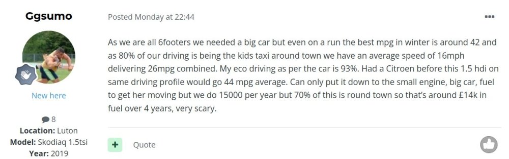

nearly 3 years 30000 miles and yep it’s Luton...
13 hours ago, Ggsumo said:
We do about 300 to 350 a week in Summer have never seen the long term out of the 20’s.
 250 miles for a week in winter is about right on average.
12 hours ago, Ggsumo said:
t’s purely to much time spent in town traffic on short journeys, she’s just a beast to get moving I think.
16 hours ago, Ggsumo said:
I had a Citroen Spacetourer before this it was a 1.5hdi and used to around 50mpg on the combined and over 40 around town which was pretty much on quoted numbers so forgive me if I expected to be a little closer to what was claimed in this one.

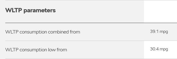

You've rightly acknowledged it's a beast to move  Sorry I didn't get what 1.5tsi Kodiaq model you have but it makes little difference anyway. These are the official figures for a 1.5 DSG SE-L ...
MPG is calculated in a controlled environment based on Mr Joe Average and is simply a means of comparing different cars on as much of a like-to-like basis as possible. Thru your own admission, you are not Mr Average. You're doing lots of short journeys in a loaded car. The official figure you should be looking at is around 30mpg, NOT the 39mpg.
I can't find the WLTP figures for that Citroen as they've stopped building it. It's been replaced by an EV and although I have no personal experience of EV whatsoever, I can assure you the published range will not be what you achieve in the real-world, moreover that will drop even further in the winter months. Petrol, Diesel, EV, hybrid PHEV whatever - they're all the same when it comes to published figures and economy.

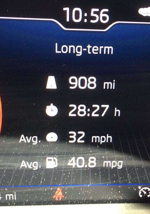

I've just been out on a steady run today for around 40miles. It's wet, no wind, the temp around 6C, just me and about 40kg in the boot, and from a cold start, the car returned 41mpg. If this were summer I'd expect to see high 40's from my 1.5 DSG with 20" rims.  I personally don't think that's great, it's certainly less than if I were driving our 1.5DSG Karoq and about 10mpg down on my previous 1.4tsi manual Octavia, but it's in line with WLTP expectations for my car. 'Horrific' is simply not a word I could ever use to describe it.
