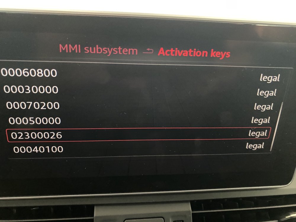

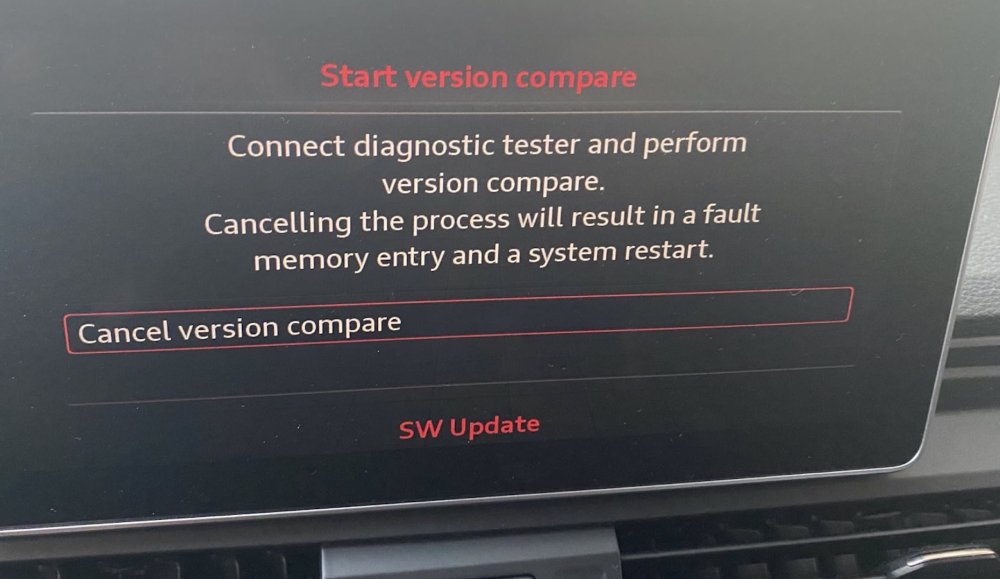

ok so I managed I believe to install the patcher using  the MIB 1.2 tool  (although I am stuck after 3 reboots of system) saying restore where the system report to connect a diagnostic tester. ) can you tell me if I succeeded or not this way? it took about 10 minutes.
Spoiler
Spoiler
the SD card has also the patch file for my car. xxxP5092 with MU 1329 in the appropriate folder.
how to invoke the Green menu to begin the procedure ? with the same keys NAV up and RADIO down, together ?
thanks
G
  Reveal hidden contents
thanks
G
/cdn-cgi/mirage/521ad746da4af8d96bc1b171cd6452efbd4d46c91be35aaf707853b2356a306d/1280/https://www.briskoda.net/forums/uploads/monthly_2023_01/1998508566_Screenshot2023-01-17at5_52_04PM.thumb.jpg.24bee7383f66f5e29ec9559a5f9b01df.jpg
Those are Audi key combinations that I pass on to get the green menu. After installation of mib tool the unit should just boot up as normal but then you have the SD card in it when you want to use it via the green menu. I'd post your question on that Github site for it.
Normally it installs. Checks whether it can be used with your firmware at the time of running it in the green menu. You then do a backup. It saves an area of code it's going to change in that backup. Then you do the addfec command and reboot for the FeCs to take hold. If you want to restore the code changed you restore. That's how it us to work.
I'd post that screen and questions on that Github board. It's Chillout and his mates that wrote that code.
Edited by Tell
Just cancel the version compare. Look on the MIB software and run then to clear the error this would have created
You will get possible SVM errors (software version management) atleast when you run it since it's picked up you have tinkered with it. SVM errors don't have to be cleared but there is an option within the software to do that. Causes a reboot or two.
I pass on whether Audi units screen what is being loaded into them and generate that screen. If successful you do the FeC adjustment. The reboot. Do that FeC screen to see whether it has taken it. If so you can then run the built in mib tool SVM clear option. That's what I did when I used it but I did have to have one of their enthusiasts to write me the module since they hadn't seen my firmware before. Not sure whether it's clever enough to do this bit itself now.
How to get at the Audi green menu is here
If mib tool went in correctly you should find mib tool installed as a program in there, see mib tool documention. It's run from there also mib tool enables the developers menu so you get SWDL etc on a long hold on menu in Seat and Skoda there will no doubt be a different combination of keys in an Audi.
Might be helpful or not:
https://www.car-auto-repair.com/audi-mmi-user-defined-update/
That shows elements of SWDL.... has it's uses to force updates or selective processes.

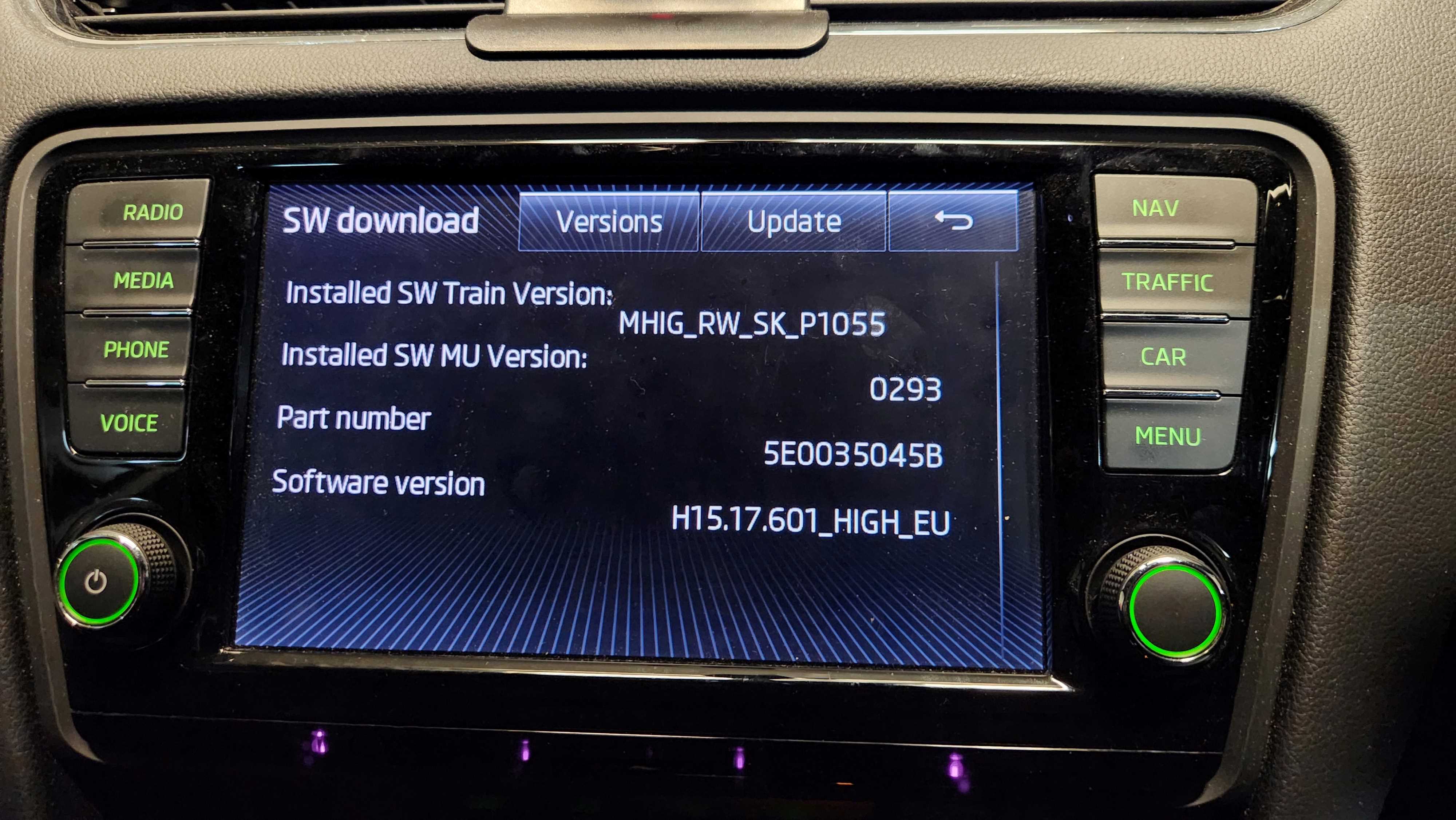

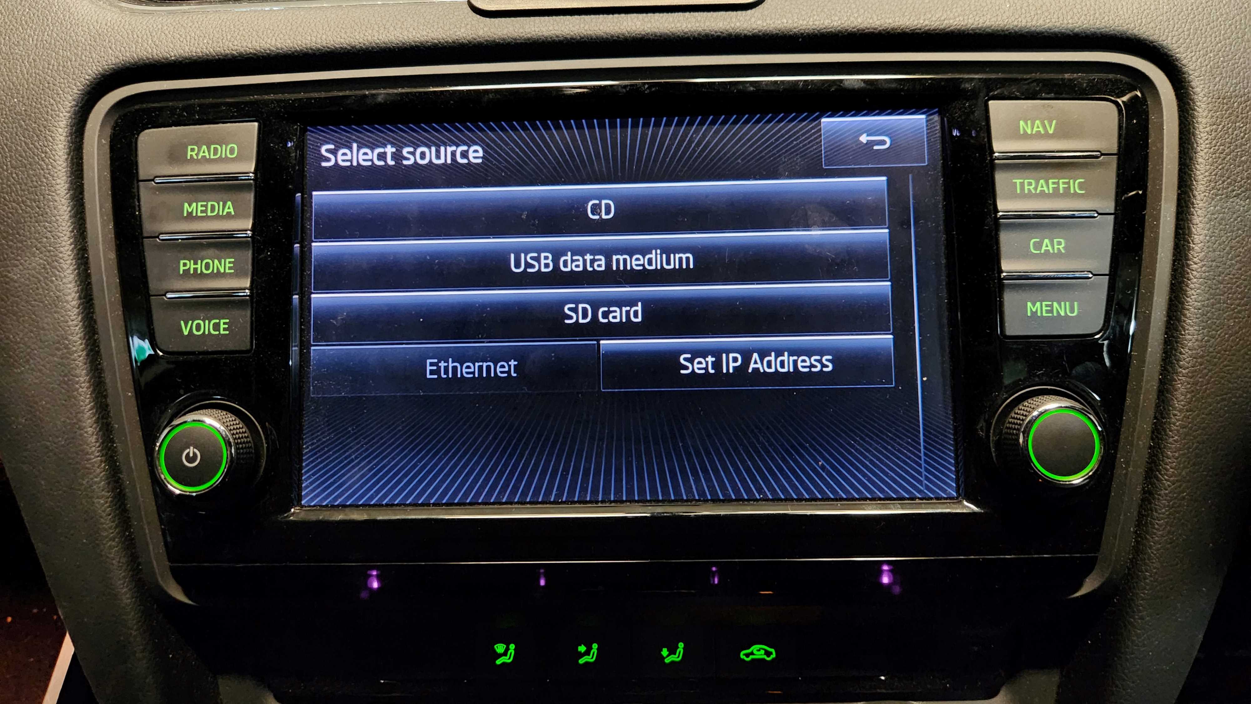

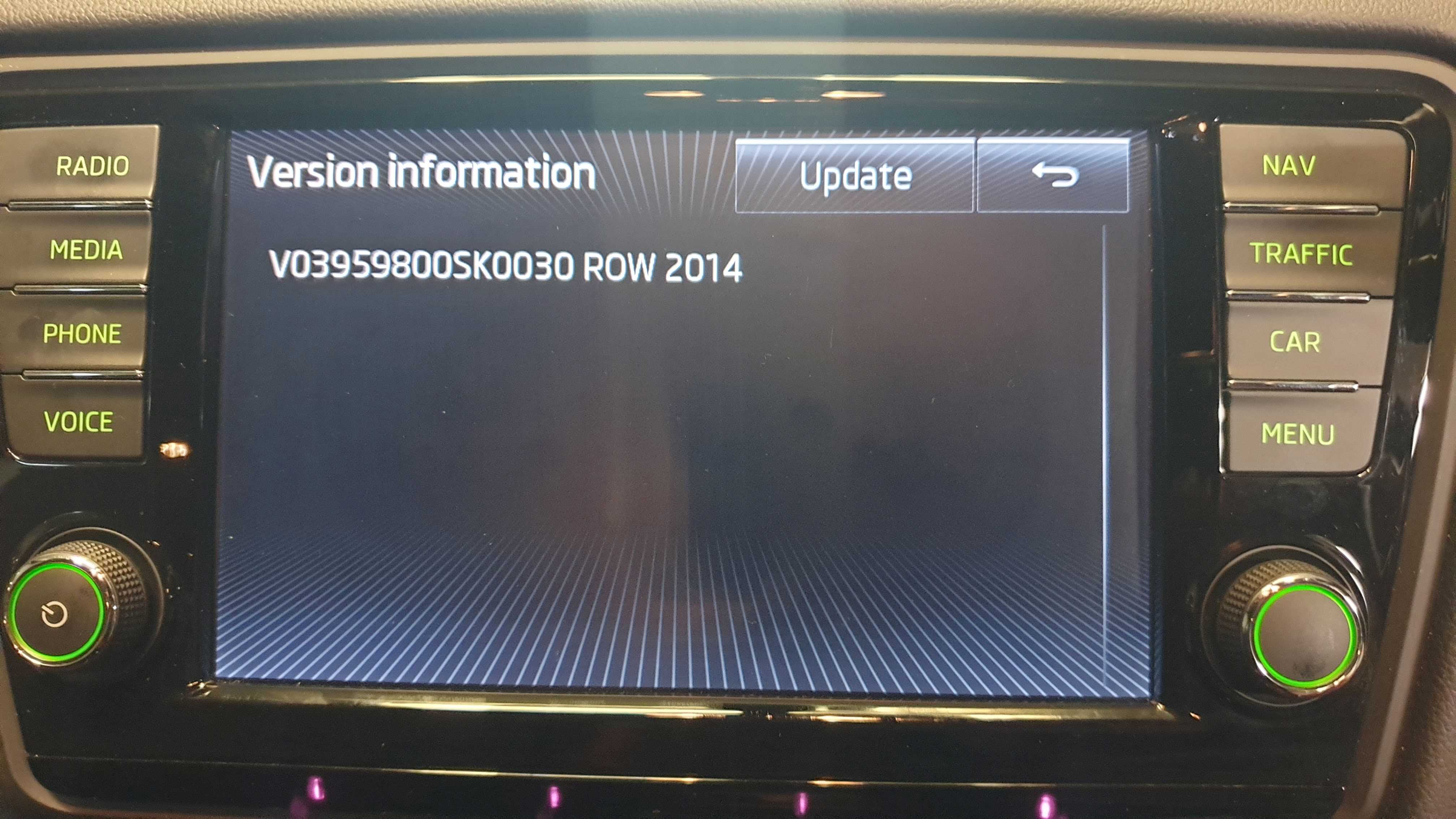

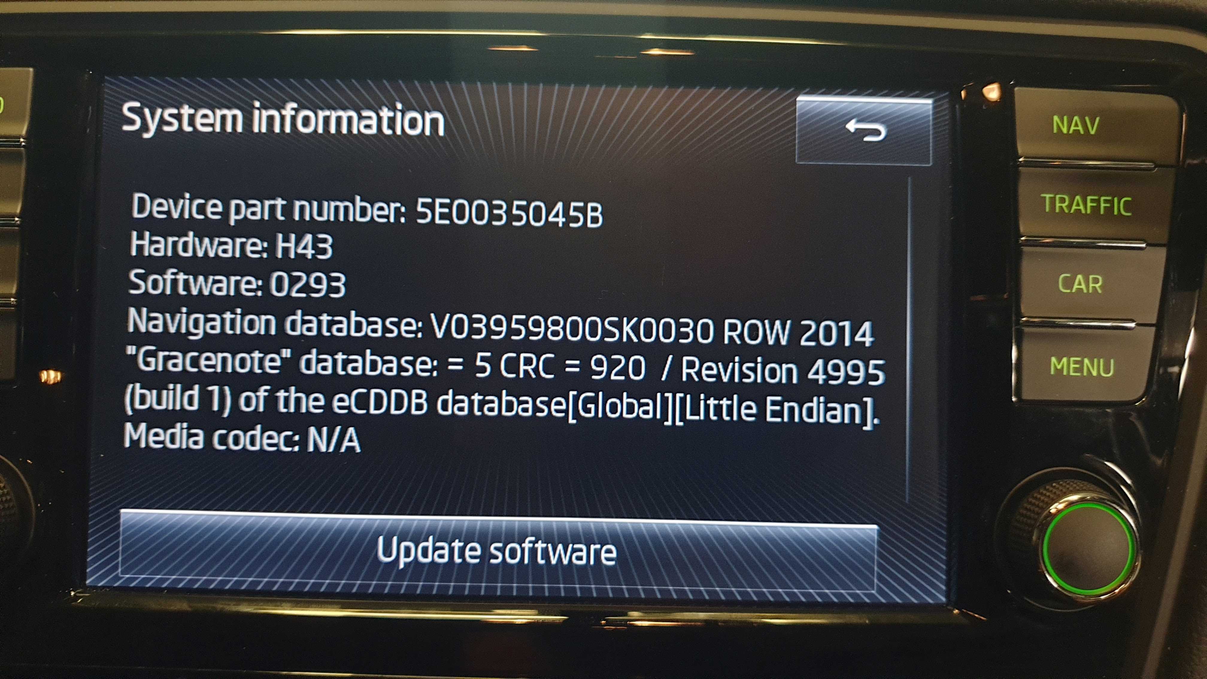

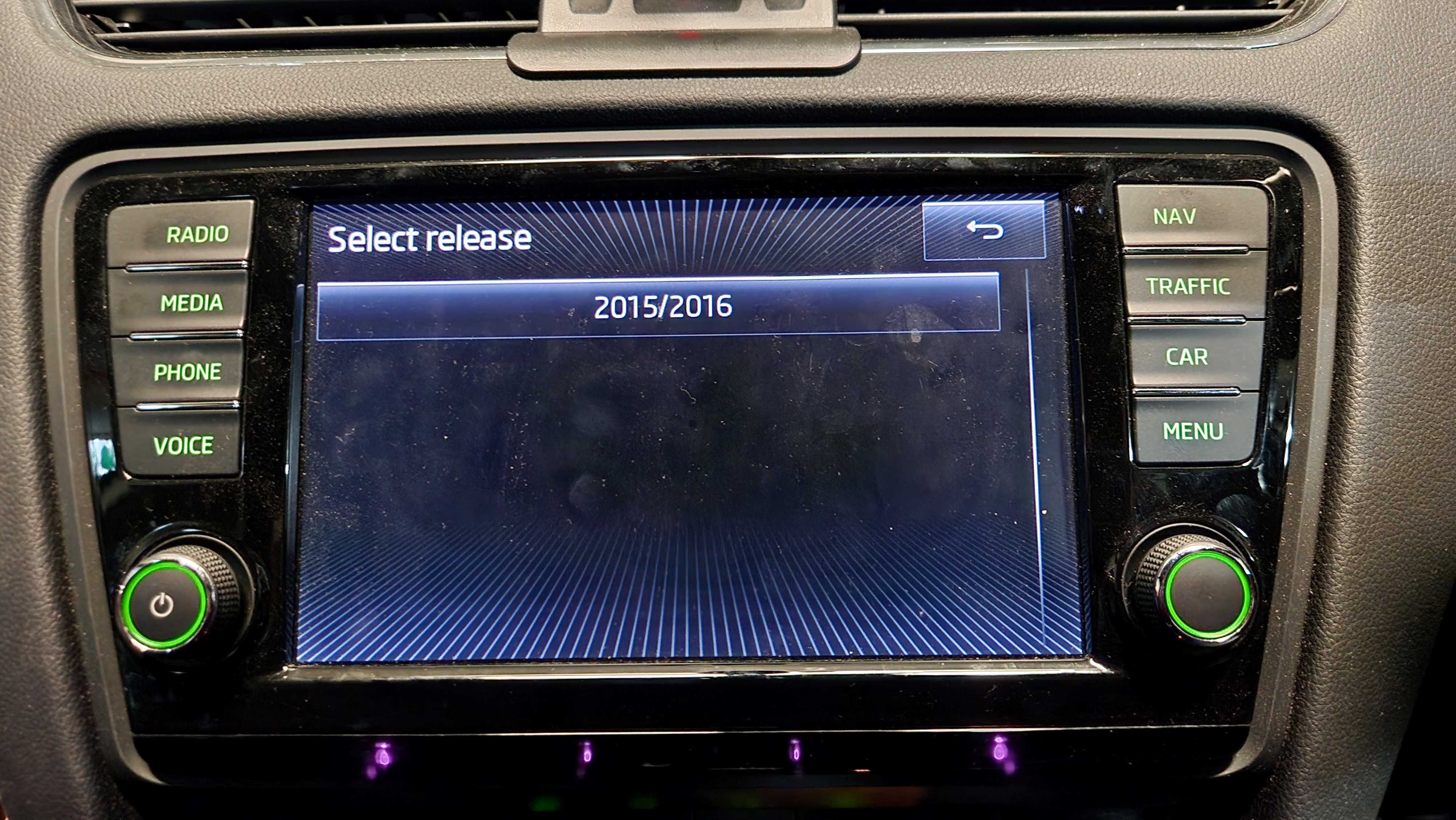

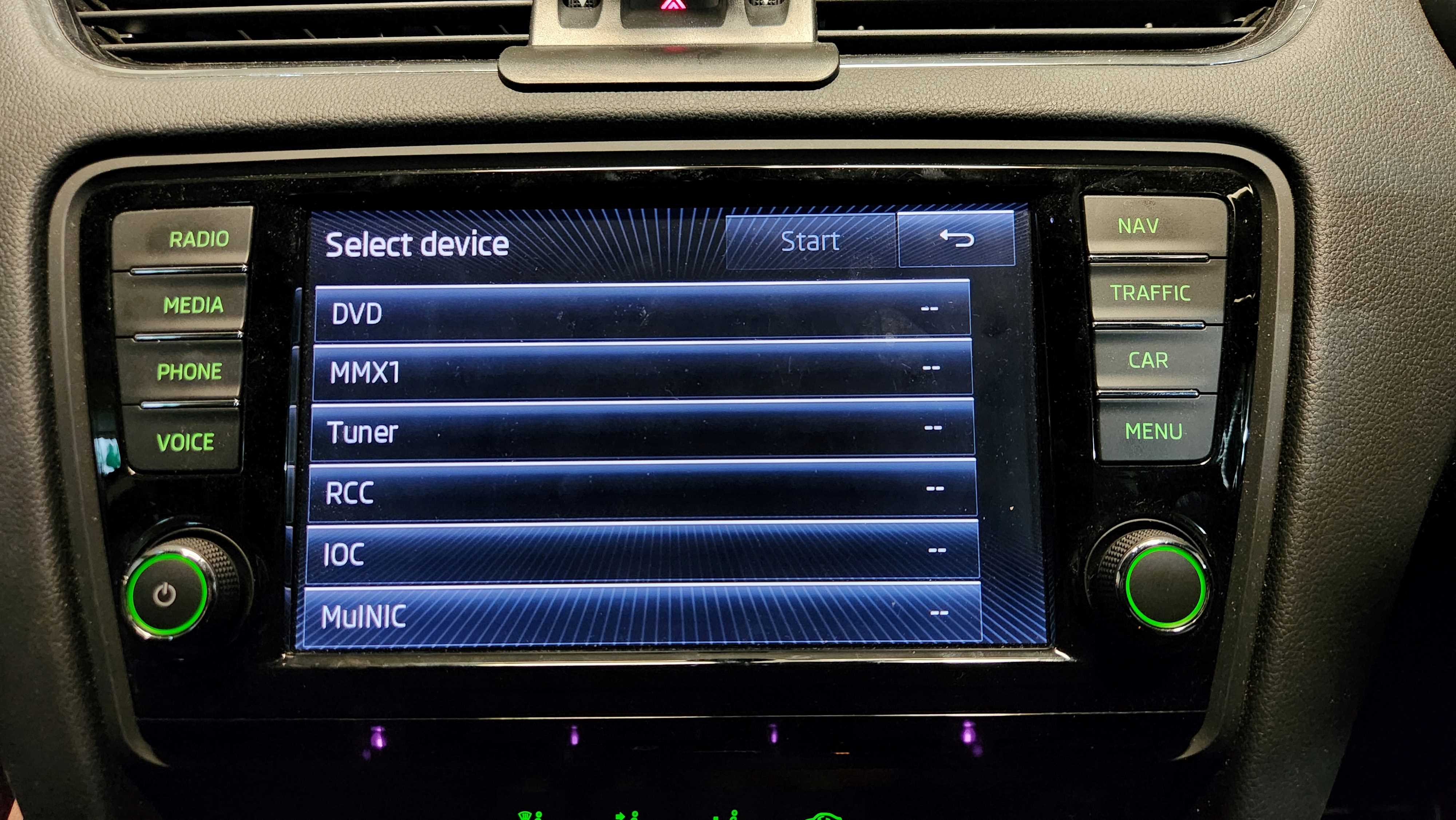

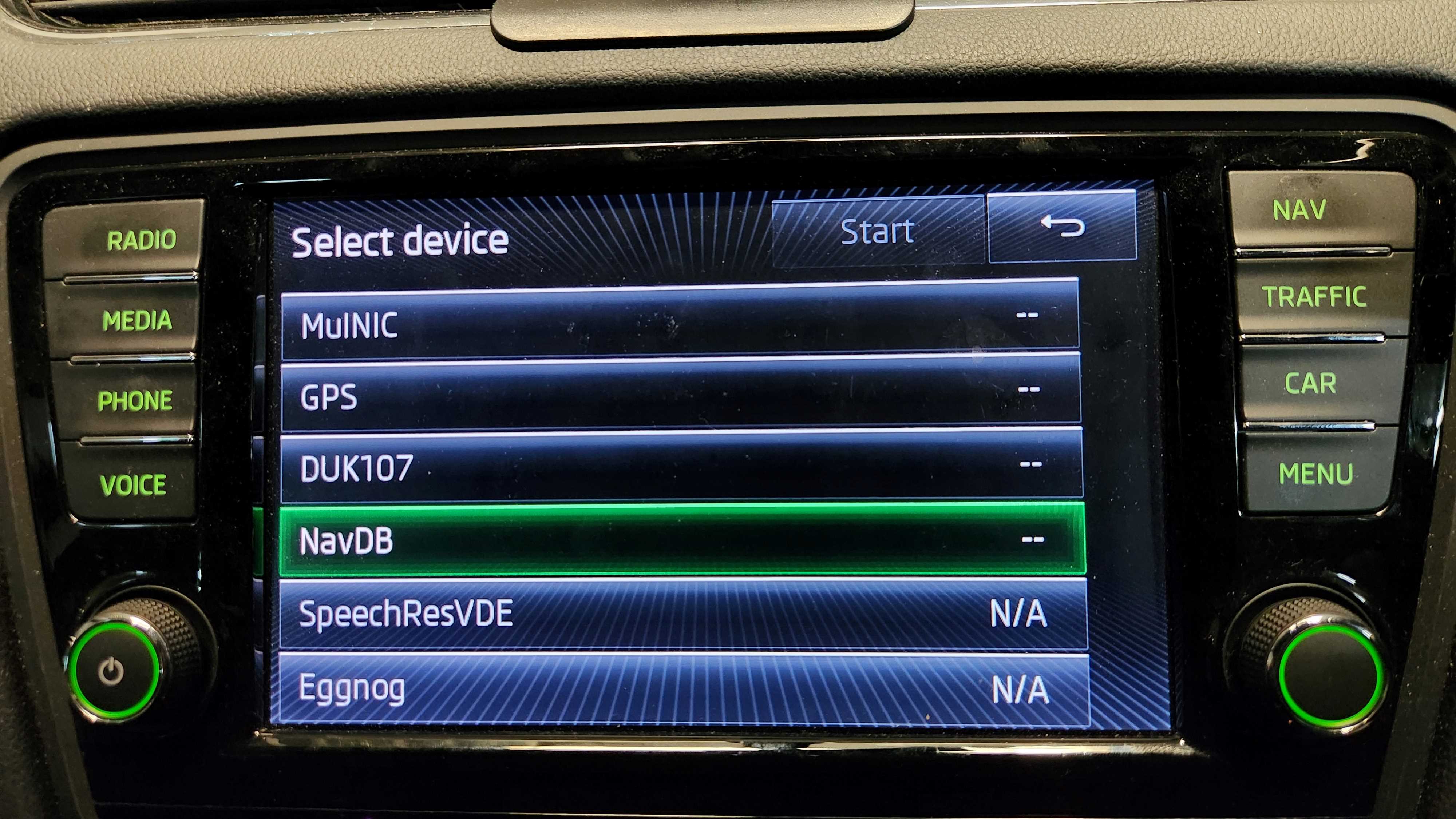

Hi,
Seeking some help with updating the map for a Skoda Octavia 2014.
Columbus Mib1 .
I've tried several of the map updates 2015 - 2022 with no joy. (Thought maybe i'm skipping  too many updates)
I'm thinking there is a mismatch of Partnumber in DBInfo.txt? (But i'm just guessing)
Any guidance would be most excellent!
Thanks
3 hours ago, lucid_al said:
Hi,
Columbus Mib1 .
Thanks

This is another mib1 high question being Australia you would need a RoW FeC in that unit if its like mib2 high. Now whether its a DIY task not sure. For mib2 high it is now although you might need some help even if you got a mib2 high.
The DIY experts hang out on this discussion thread. It's the one I was given to pass on to the Australian with the Mib2 high who had imported a Europe unit to Australia.
https://github.com/Mr-MIBonk/M.I.B._More-Incredible-Bash/discussions
The "more incredible bash" people are the enthusiasts that have written the code for mib2. They were writing code before it got to mib2. So someone will be able to direct you if you speak to the right person on that software thread although that's the support thread for the mib2 high toolbox as it's called. Chillout / Jilleb who were the original authors and did most of the tinkering to package the tools up.
Retrofitters take these tools and offer paid services although the tools are not for profit developed by hobbyists for hobbyists. You might find a retrofitter who is versed in this in Australia for a paid service or speak to one of those able guys.
Traditionally the units were put on workbench, a usb-wifi dongle was plugged in then laptop tools were used, "whatthefec" being one. Mib2 high tool box of the "Mr-MIBonk" variety are loaded into the green menu and bypass putting the unit on a bench, the dongle and the program like "whatthefec". It could be that a tool box was never written for the mib1 high and it's a case of using the old retrofitter / hobbyist methods of the workbench.
As I said to the other guy if you load maps into the unit where the navigation FeC is not of the life long one e.g.. Life long ones have a sufficiently high hex code that it allows the map to be imported. Wrong navigation FeC it won't work. You can only get back the maps if you have the map file for the unit that matches the FeC or any previous maps. So best not to toy with the unit if you haven't got the original year of release or any before.
Edited by Tell

Pretty sure it will since the matching access FeC is contained in the downloads for the maps. I did do a quick Google. Basically the FeCs were less common knowledge in the early days of mib than they are now. The menu key fumble should allow it to show enabled and available codes if you find the key combination.
Mr Mi Bonk  people... may be its Mibwiki goes under that name is administrator of the mibsolutions database. He'd know and Chillout who has been working with mib1 high then mib2 high units. It was Mibwiki that gave me the link to pass to the Australian guy who had issues with the addfec command in the mib2 toolbox. Was Chillouts code they used for that. Embodiment of the retrofitters work bench method. The other Ozzie for mib2 had used the package but that was setup for the the EU. Just need the FeC put in the control file and addfec button pressed in the tool. I'd hit a brick wall explaining.
I suspect yours will need the work bench method. But as I said before I arrived into this with mib2. Zero mib1 hands on knowledge. Reckon the user updates came with mib2 but the mib1 ones were via the SWDL command as you are showing but need the correct FeC in the unit. Seems to be a suggestion online that these FeCs carried over from mib1 to mib2 on code as well ?.
The Mr FixIt page gives an explainer but only really for mib2.
http://wiki.mr-fix.info/index.php?title=MIB2#MIB1_High
The toolbox substitutes MIB2_FEC_Generator.sh whilst the workbench method uses WhatTheFec.exe.
You might want to chase down Chillouts web pages that covered his work on mib1. The mib enthusiasts have a Telegram group where you could try for help.
6 hours ago, lucid_al said:
Columbus Mib1
by GUI and maps numbering looks like Mib2H
# 2015            P39
# 201?             P49
# 2018             P68
# 2018-2019    P71
# 2019             P76
# 2019-2020    P79
# 2022-2023   P101
# 2023            P313
The dash it's showing against navdb in the screen means nothing to update. It can't. Then the one below means it's on 30, offering 49 but can't do it since the FeC isn't allowable. You can force it but then will hang if it's like the mib2 high swdl. You play a game with the SWDL menu but then you are stuck if you haven't got the copy to put back in. Reckon it's at 30 so you need that as a fail safe.
