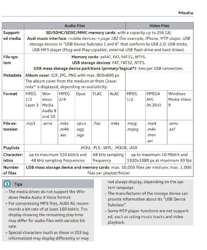

After looking at the manual the MMI will only read exfat via SD card & not USB. So above 32gb NTFS is indeed the go to format

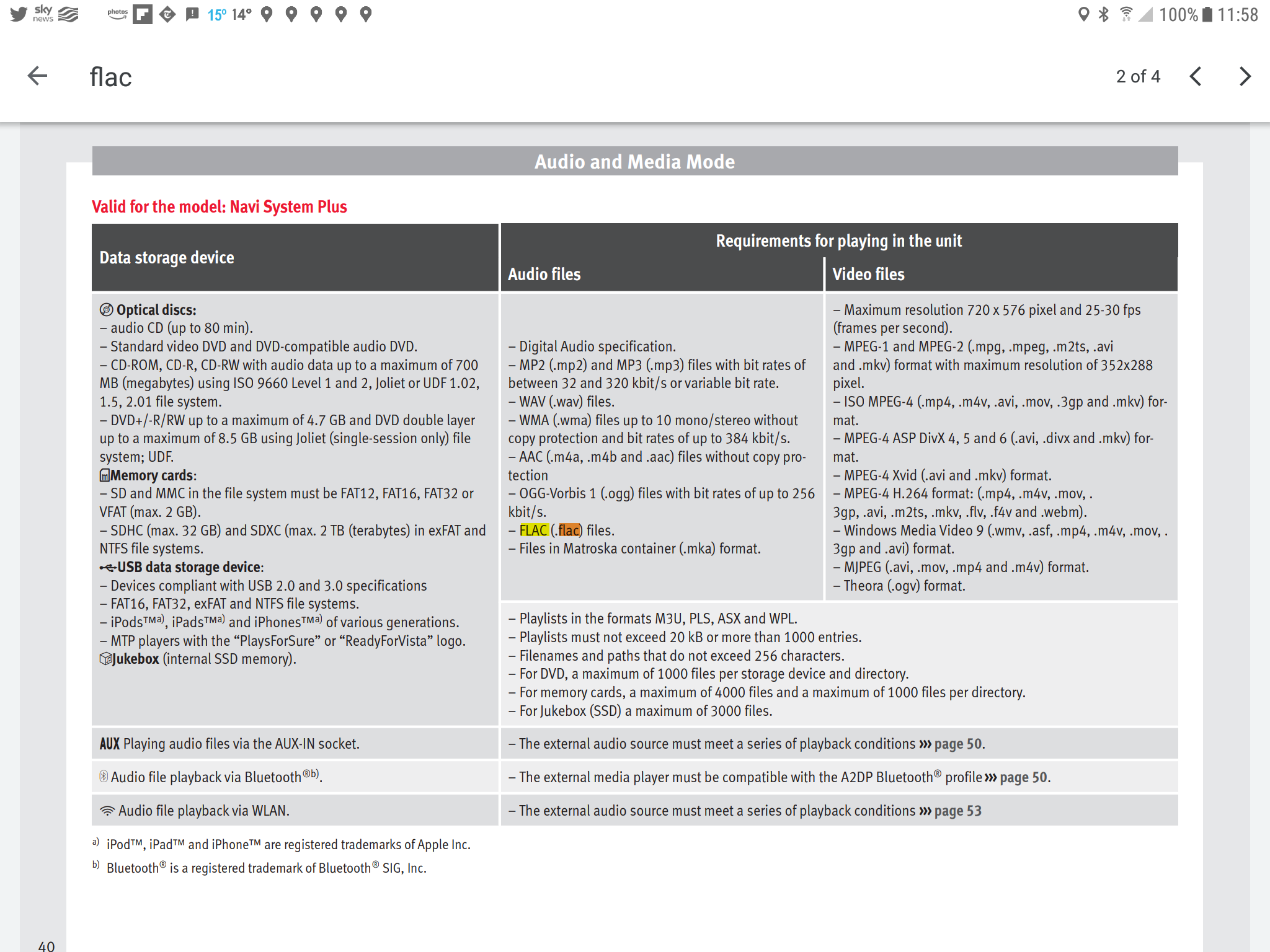

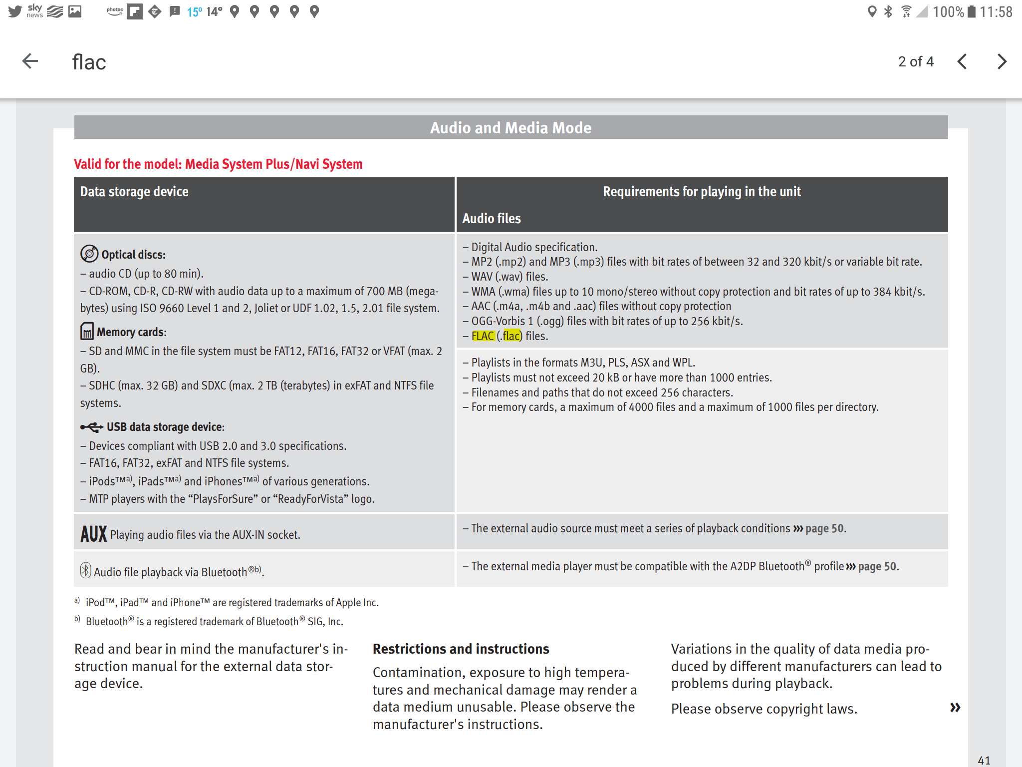

Interesting FLAC isn't on that list. Reckon that's an old page :). Newer firmware / hardware in Mib2 High's plays Flac. The image size of 800x800 doesn't tally with 512x512 standard as per Seat Mib2 and Mib3 spec.

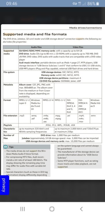

I've printed it out as my off pista update routes for the maps. I can see with more modern PCs cutting down on ports they may not have SD card slots so USB may have attractions to some for the update rather than using the VW instructions I posted up above which is the gold standard dealing with Mac's as well.
2020 version

2020 version
But it's not showing a WAV file thou 🙄. They will all be the same but varying quality of documentation. I reckon it won't resolve 800×800 cover art thou.
