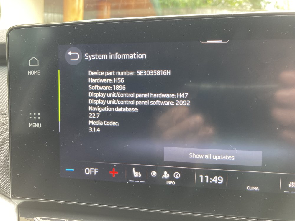

At long last... SW Version 1896
After almost a year of trying, Ive finally had the update to software version 1896 (from 1803) this is the large update that is supposed to fix all issues with ACC, headlights set to driving on the right etc.
Too early to tell what it's fixed but the headlight setting is now correctly set to driving on the left at least. I also had the ACC bug, and the sat nav not saving any settings bug. Time will tell if they have been resolved.

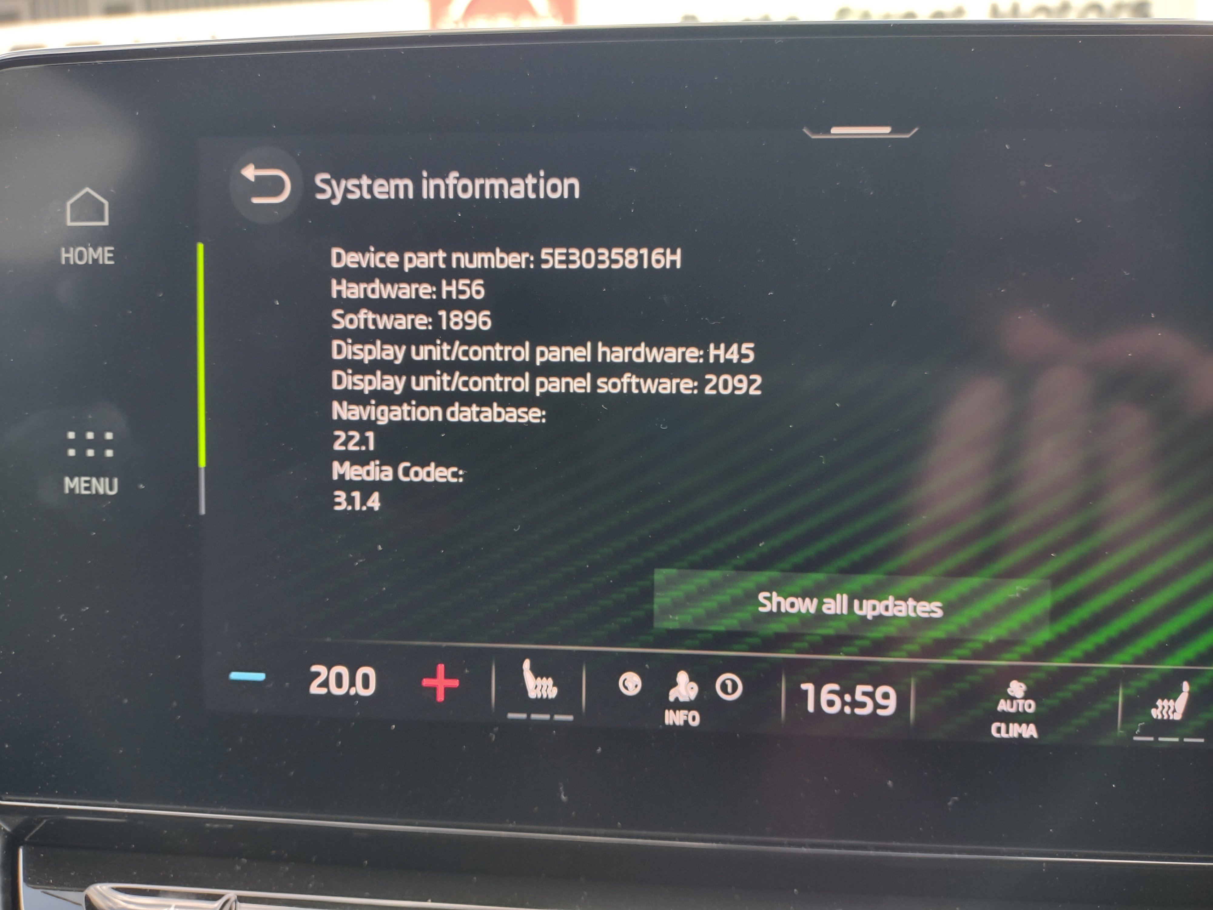

  • Had mine updated by dealer this week to 1896 as gave up waiting for an OTA update to be done. Was done without issues. Too soon to notice if it has fixed the ACC bug which was the main issue I was hav
  • Happy camper here now up to 1896. Great service from Bournemouth Hendy. Booked within 2 weeks and a few hours later call that various updates done for ACC thinking it’s in Europe and inability to save

That software update fixed my ACC issues, I got it a coupe of weeks ago, it seems to be a vast improvement. Does not fix Synch not remembering on climate, but in comparison that's a minor issue compared to those it fixed.

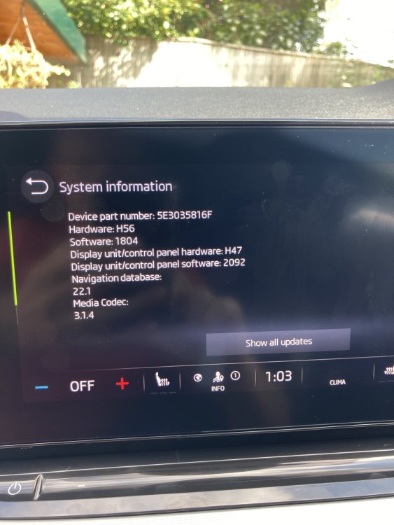

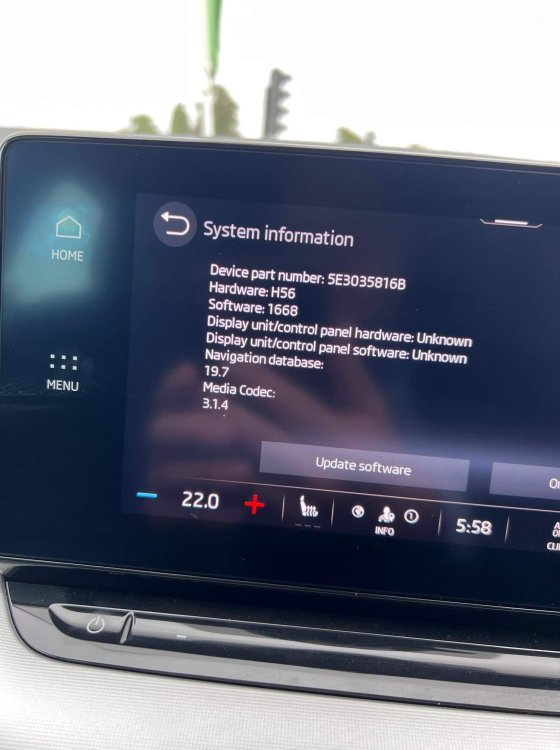

Does anyone know if it's possible to go from 1668 to 1896? I'm just curious if it's worth me calling the garage.
Thanks!
Yes, although for me that change happened in two stages - once when I'd pointed out to my local dealer several updates were due, and then six months later when the "travel assist not available - bong"  "feature" went from occasional annoyance to full on madness. Mine was delivered with 1664; went to 1668; then 1806; now at 1896.

So got mine back. So far it’s fixed everything apart from the climate sync. Seems to be a bit faster to respond to things. I have a ping drive tomorrow and I’ll test the travel assist out. Hopefully it’s fixed the kmph and not overtaking issues.
So I have 1886 from yesterday and I have to admit, that even that I did not have any issue before, now its seem much more smooth. Even reverse camera is like with better framerate and resolution. I did not have chance to dig deeper what else is new, but I am quite happy now. BUT - with this sw should cars go from production line from start... octavia would have much better reputation.
