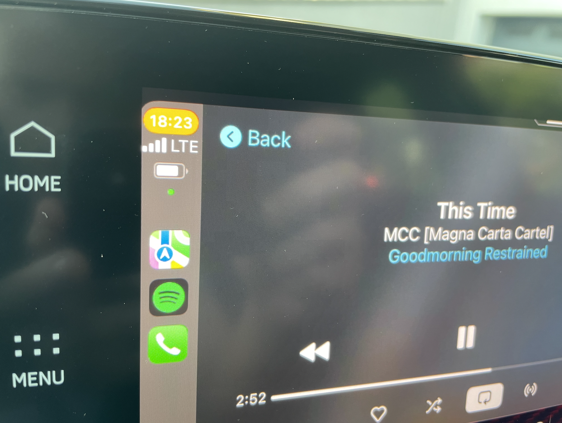

Did anyone notice that after update to 1896 there's a narrow black strip at the top of the screen while using CarPlay? I'm about 99% sure it wasn't there before that software update.
Just had mine updated today and I can't see this using Android Auto, the welcome message for it has changed though. The startup time seems improved too, I've not had chance to test anything else yet but no errors so far.
I have the exact same thing on apple carplay
