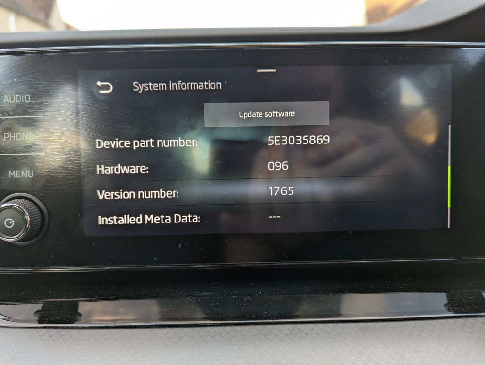

Hi all, just my Octavia SE First Edition a couple of weeks ago, love the car but a few niggles that I can fix I have (noisy boot! Jeez)
Anyway, one thing I noticed was the headlight alignment, the driver's side seems way higher than the passengers side, I was beginning to think the car had been in a bump but couldn't see any evidence. After reading this thread it seems that a software update will fix the issue for RHD cars? Is this true? If so surely to God this is a recall matter? You'd fail an MOT!?
Thanks
Thanks
It could be just as simple as incorrect alignment?
One and a half years later and it’s fixed. Don’t know if the ACC is fixed yet because that only happens randomly.
Thanks but I don't have this, think that's VRS/full led matrix models only
I've had a look, can't see where to adjust manually, does anyone know?
Another question, I have the swing head unit, can that be updated 1896 too?

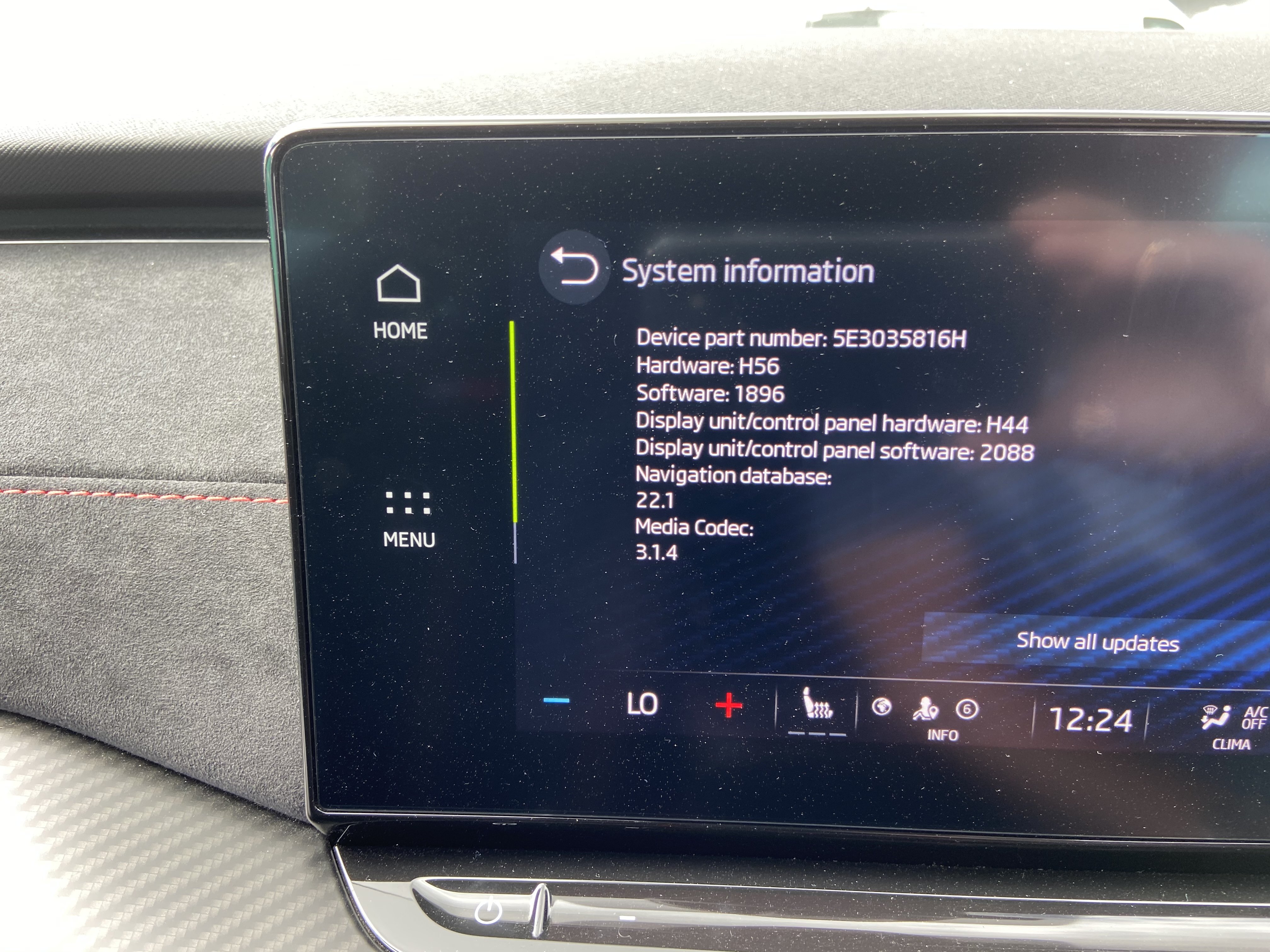

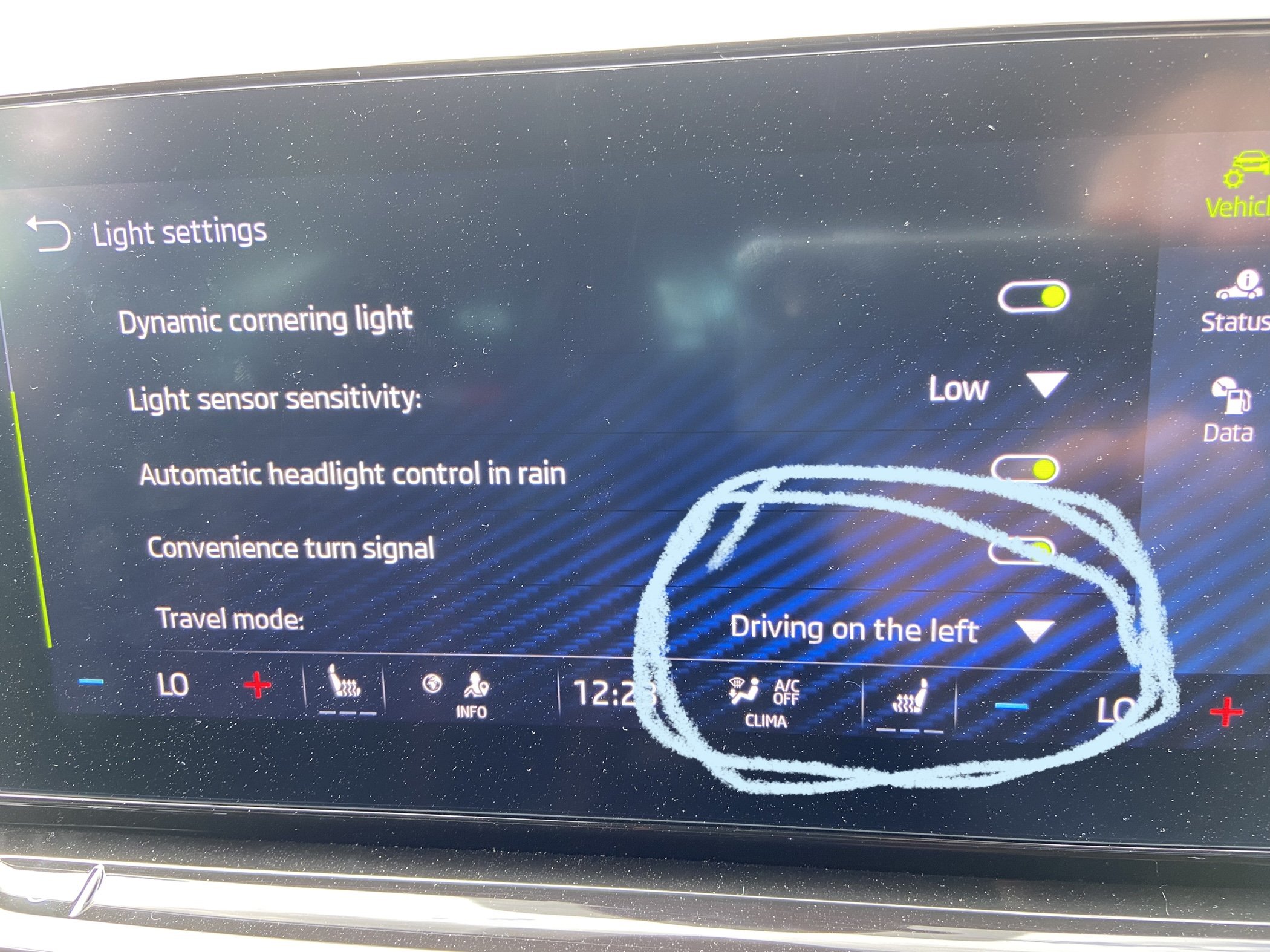

Hi, my Mk4 vRs had the 1896 software version installed on Monday. I had to be quite persistent to get the dealership to request it from Skoda UK.
Noticeable changes are:
SatNav now remembers previous destinations and my home address in 'Favourites'.
Different male voice for directions in the SatNav.
SatNav now remembers to show the current speed limit, were previously it lost the connection everytime the car was switched off.
Headlight setting can now be set to 'Driving on the left'.
'Android Auto' doesn't seem to disconnect as it did regularly.
I hope this is of help.
