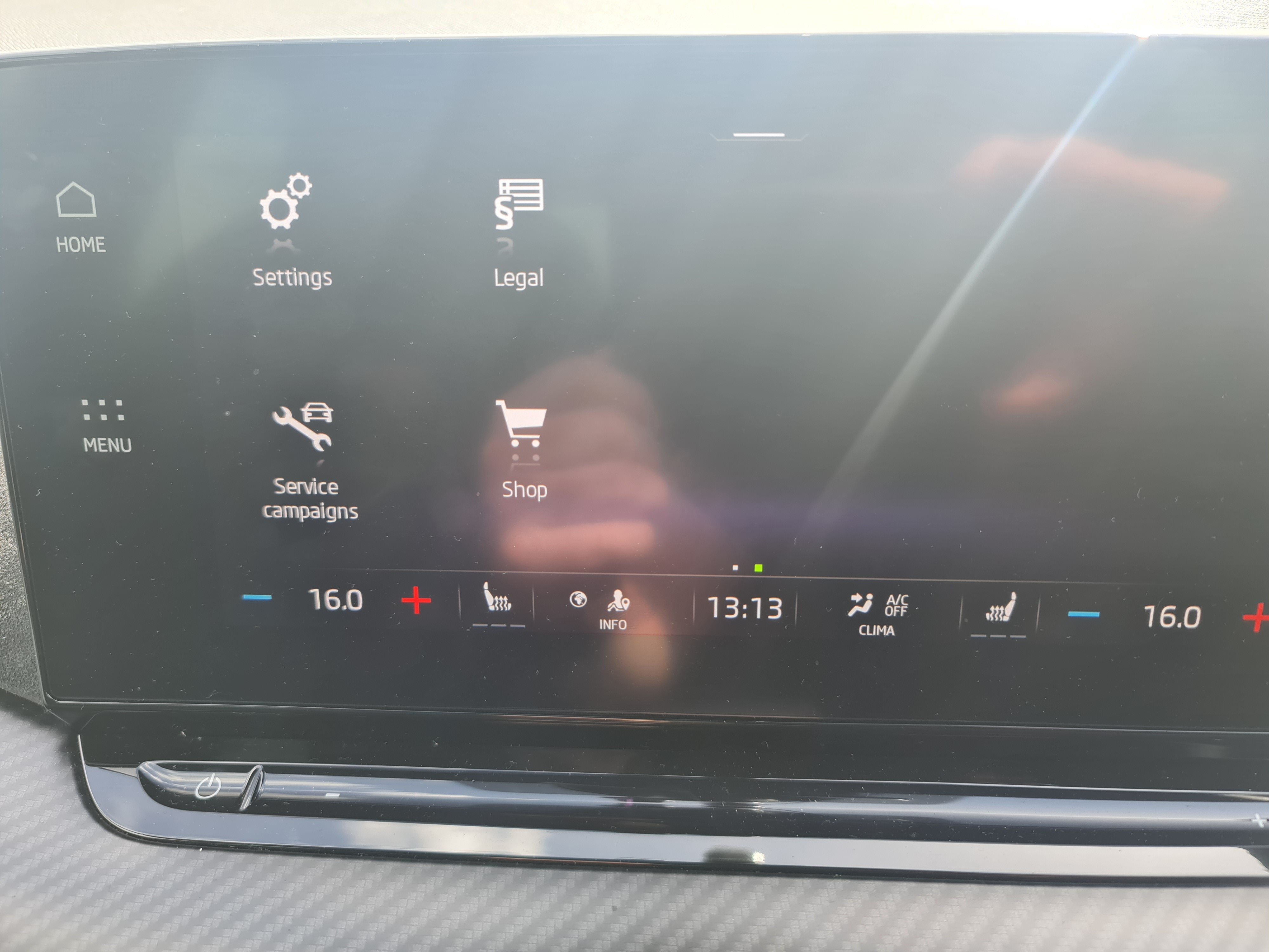

I got firmware updated to 1896 when dealer was doing the engine cover recall. Does seem a bit sharper and noticed the 'Service Campaigns' option. I can't recall seeing before on the main menu tiles as per attached pic
Edited by parsey83
I got also Service recall button update on 1803 FW..

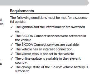

Paid Data subscription is only usable for additional services like internet radio, etc. eCall and OTA updates don't require any additional data subscription and are working out of the box. But some requirements need to be met (additional data plan is not on the list) in order to get the updates:

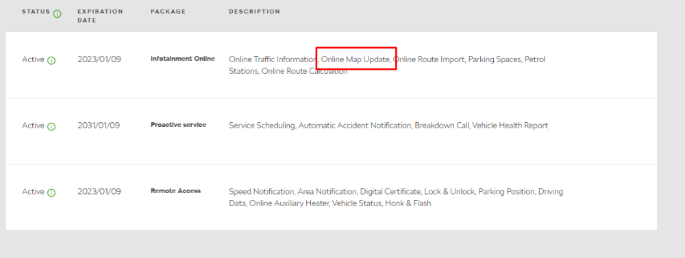

Except navigation database updates. For this you need Infotainment Online subscription.
what is the cost of the subscription?
88 EUR for both (in January). For Infotainment Online and Remote Access.

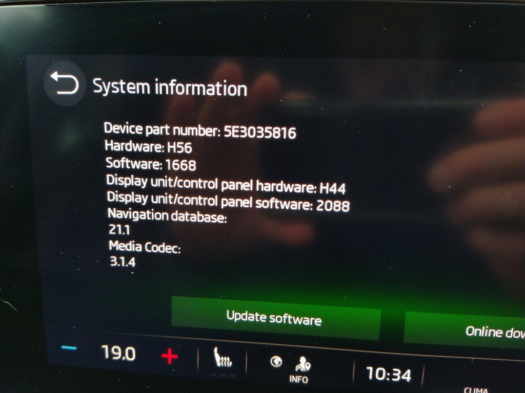

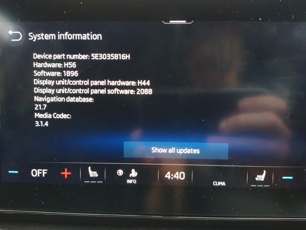

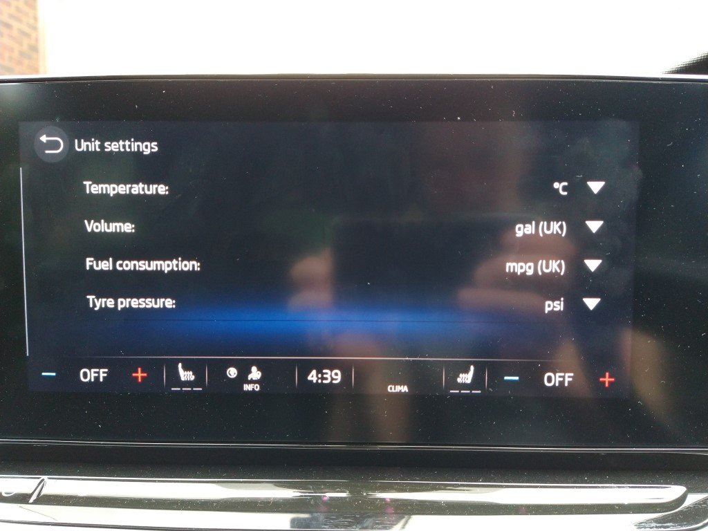

Hi all,
I got my car back today after it was updated by the garage from 1668 to 1896. There's a MASSIVE improvement in the software between these two versions including responsiveness of the UI, Android Auto directions show up in the virtual cockpit, larger font/buttons at the bottom of the screen and more.
The one remaining issue I have is that the satnav is stuck on KM and the speedo is stuck on MPH. Are other people able to switch their Units in the Menu->Settings->Units sub folder for "Distance" and "Speed"? Previously on version 1668 I was able to see distance and speed in the list of units, but changing them did nothing. Now on 1896 they have been removed entirely.
The garage has opened a case with Skoda UK as I want to make the satnav useful in the UK by switching distance to Miles and I need to switch to KMH when driving in Europe this summer.

Not sure if it helps, but, months ago I had my head unit changed by my dealer to fix the SOS and 'blank screen' issues which it did. They said at the time that would also allow my car to receive more updates as the older hardware would not be compatible with the later software. I think I went from an 'A' to a 'H' Device Part Number.
