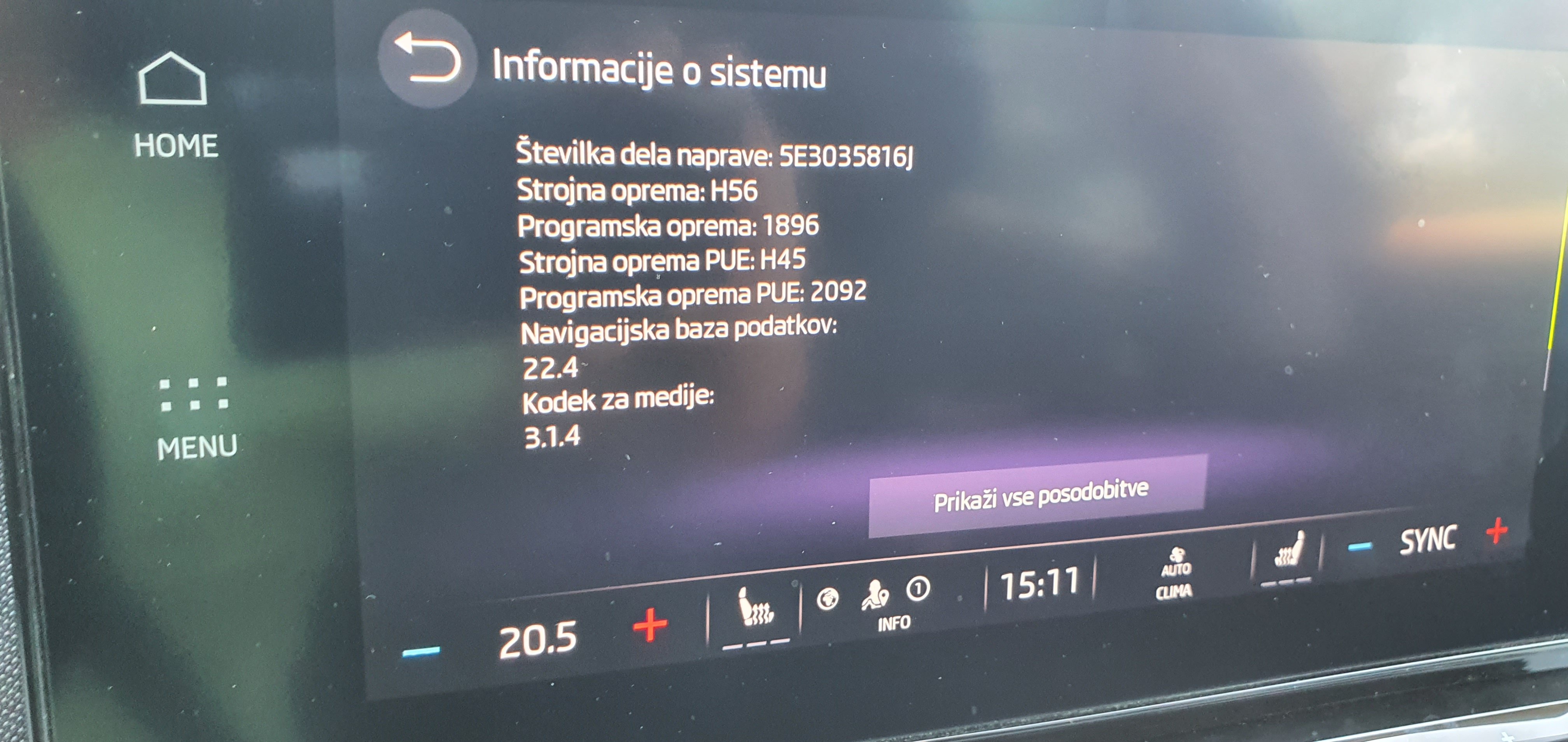

  • Had mine updated by dealer this week to 1896 as gave up waiting for an OTA update to be done. Was done without issues. Too soon to notice if it has fixed the ACC bug which was the main issue I was hav
  • Happy camper here now up to 1896. Great service from Bournemouth Hendy. Booked within 2 weeks and a few hours later call that various updates done for ACC thinking it’s in Europe and inability to save

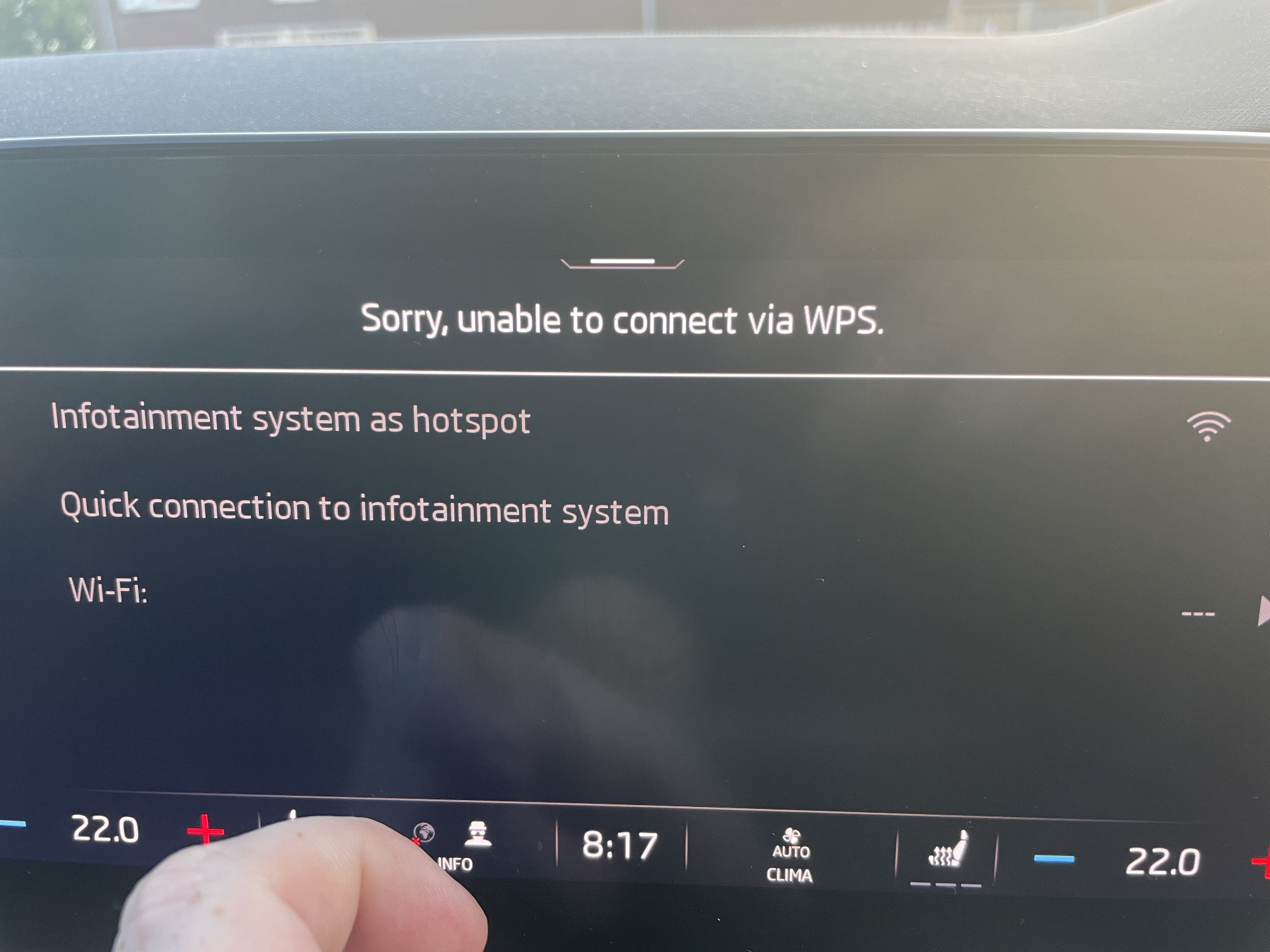

To add to this it also looks like my Wi-Fi potential isn’t working in the car (could be why CarPlay won’t work, but would it stop it working with a cable?). Can’t find the car as a hotspot and when I try quick connection it says “Sorry, unable to connect via WPS.” Also can’t find my phone’s hotspot on the car and can’t make myself the primary user as it just keeps saying please wait. 🤦‍♂️

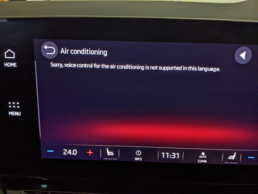

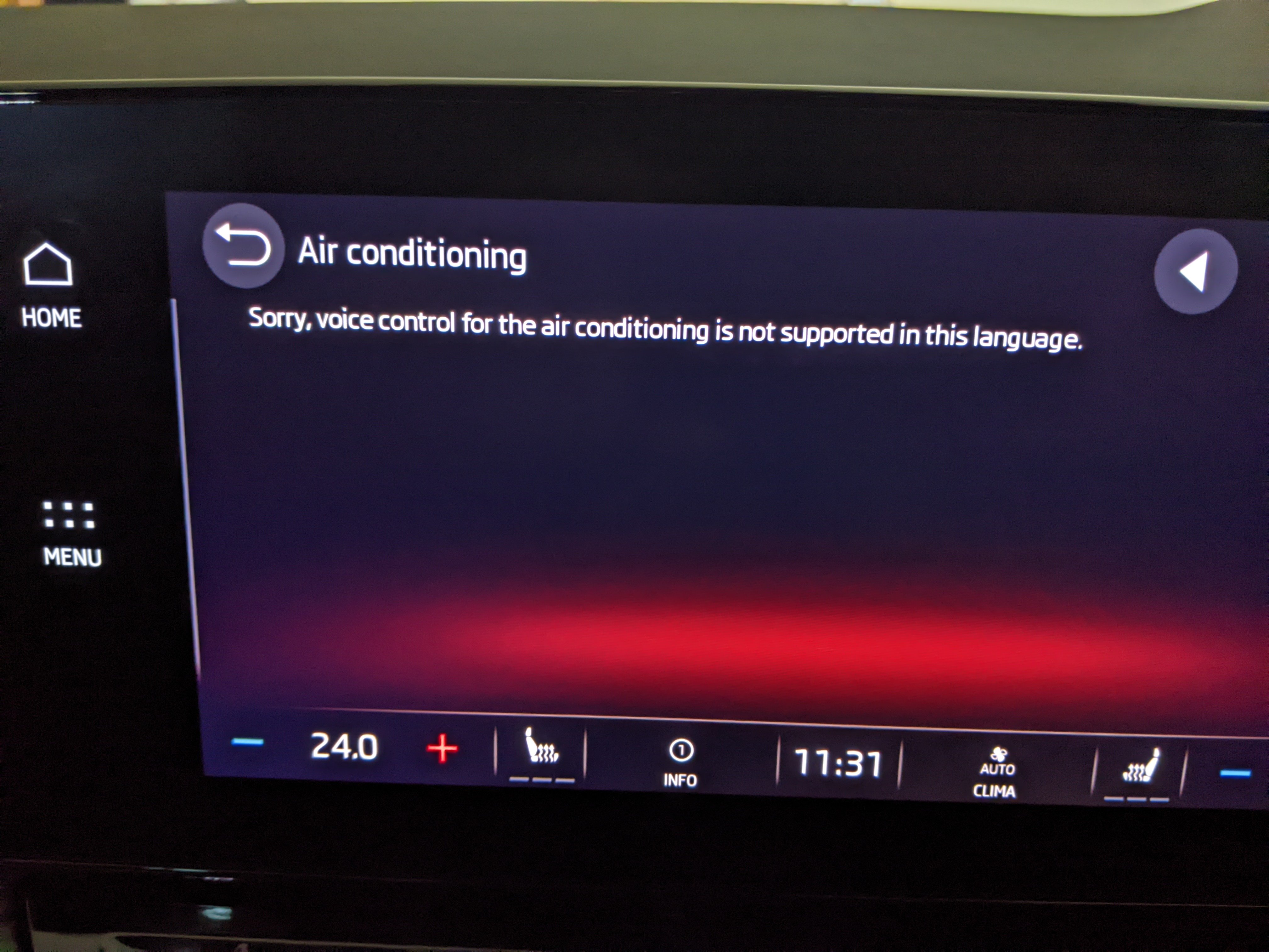

My car was recently upgraded from 1803 to 1896.
I just noticed that I can no longer control the aircon.
It used to be able to accept commands like "make me warmer" or "I feel cold" or "set temperature to 22 degrees".
Now it just says "My developers have not programmed that feature" or something like that.
I looked at the built-in manual and now it just says that the aircon cannot be controlled "in this language".
My language, of course, is English and it accepts all of the other English commands, such as "Missed calls".
Has anyone else noticed this?

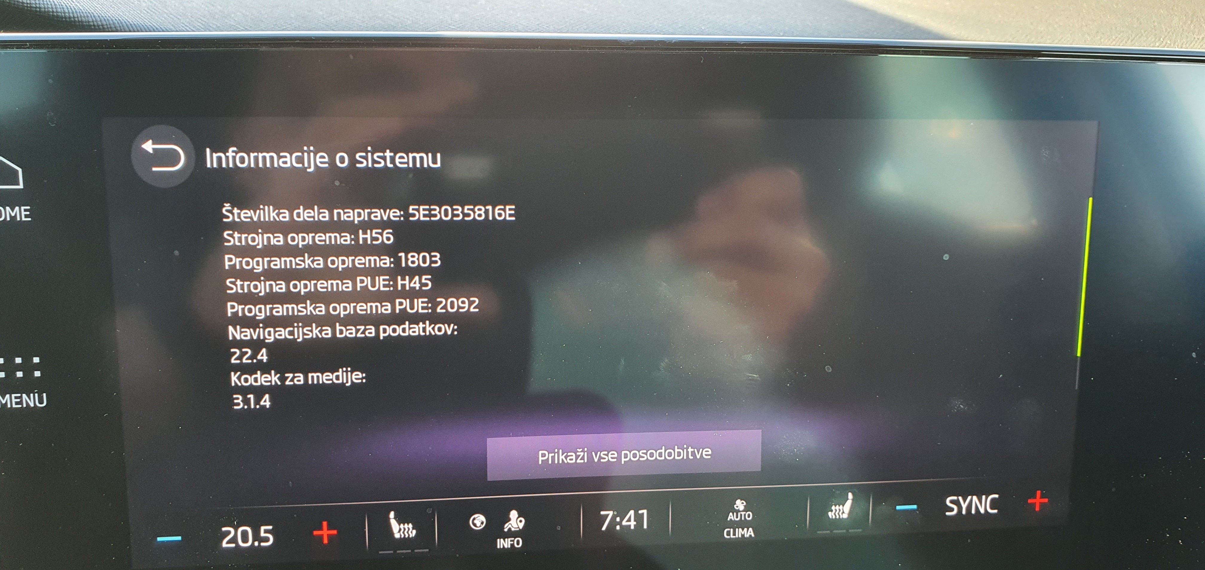

Regarding 1896.. much faster, better translations (Slovenian users), no more laggy touch response.. also back camera opened almost instant.. many impovements..
Before had 1803..

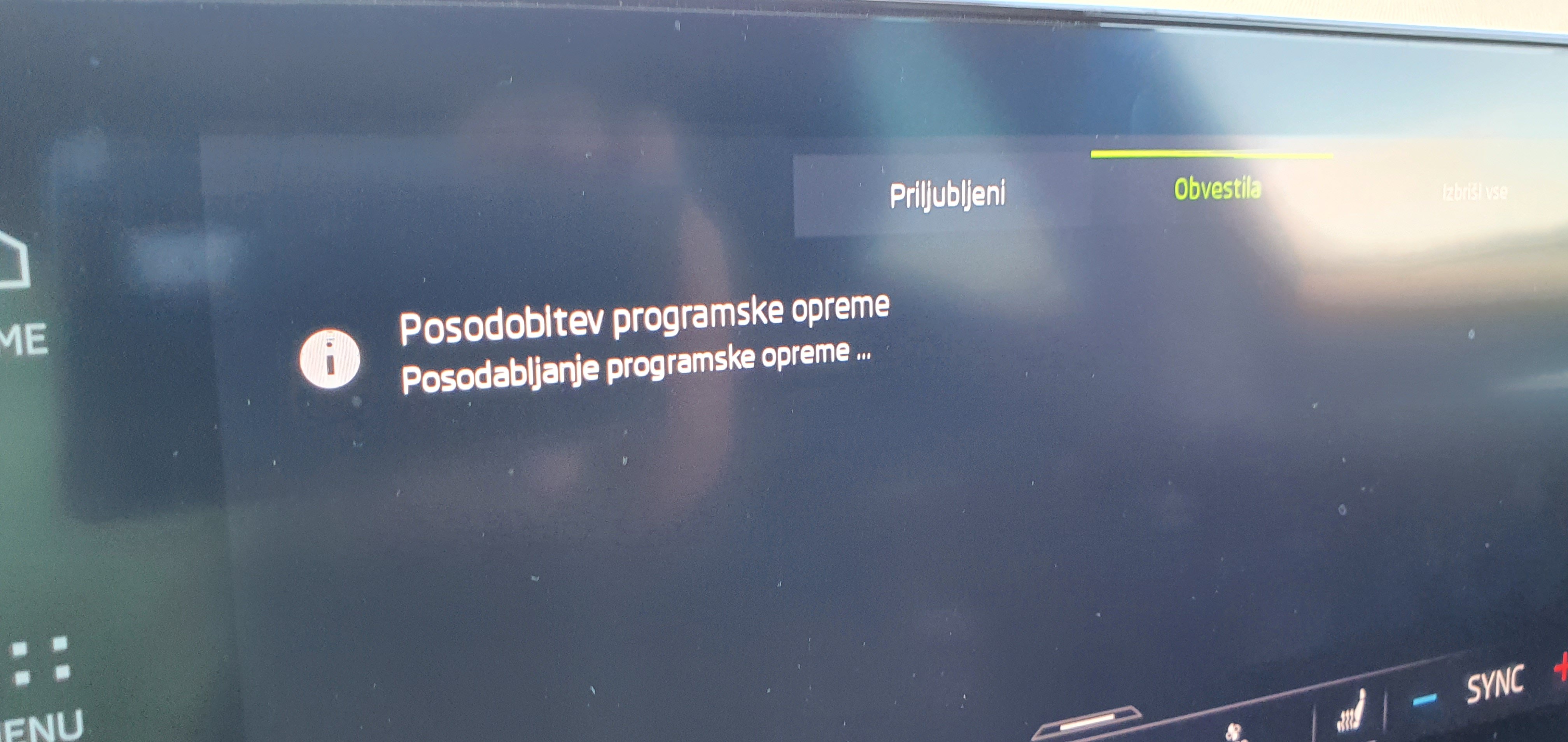

PS. After first car ignition (on 1896) there was also another software updates and installed successfully..

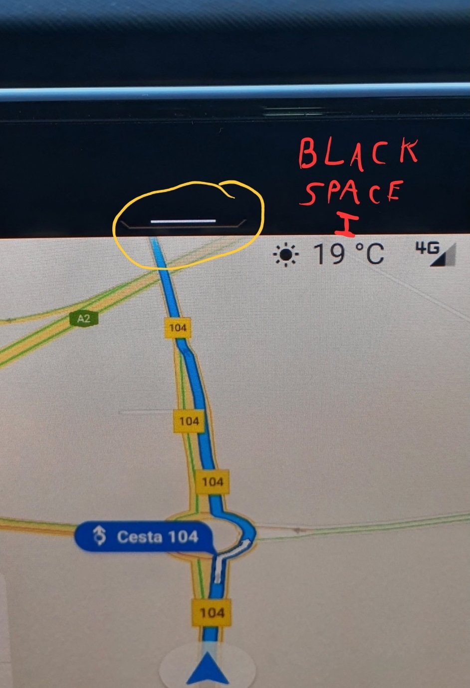

After 1896 there is black space not only for Apple but also for Android GUI..
The reason is new GUI behaive, which is now much faster (no more window/app switching as Android Auto is not top-most anymore - infortaiment is allways top-most)..

And in one way it has gone backwards since now voice control of the aircon has actually been removed.
