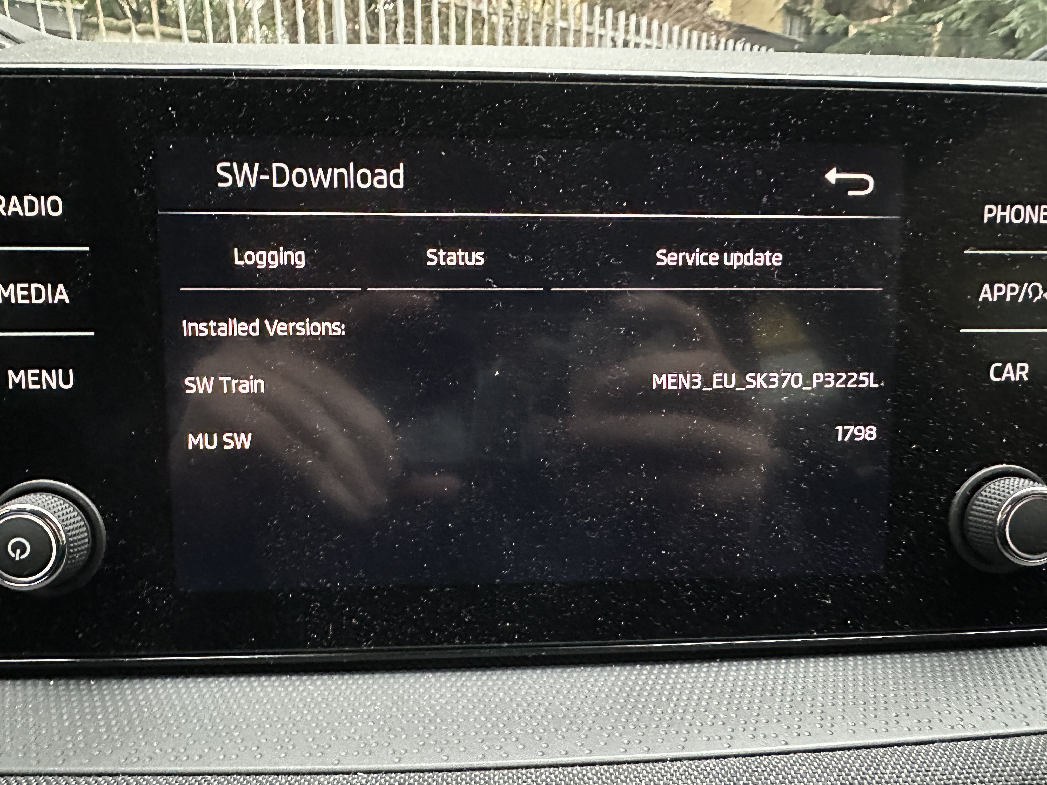

Hello everlybody!
i have a new Skoda Fabia IV seires with bolero, actually i’ve this version you che see in the picture below.
There is an update for this version?
thanks
yes, SW1800,

Thanks! Where i can download it?

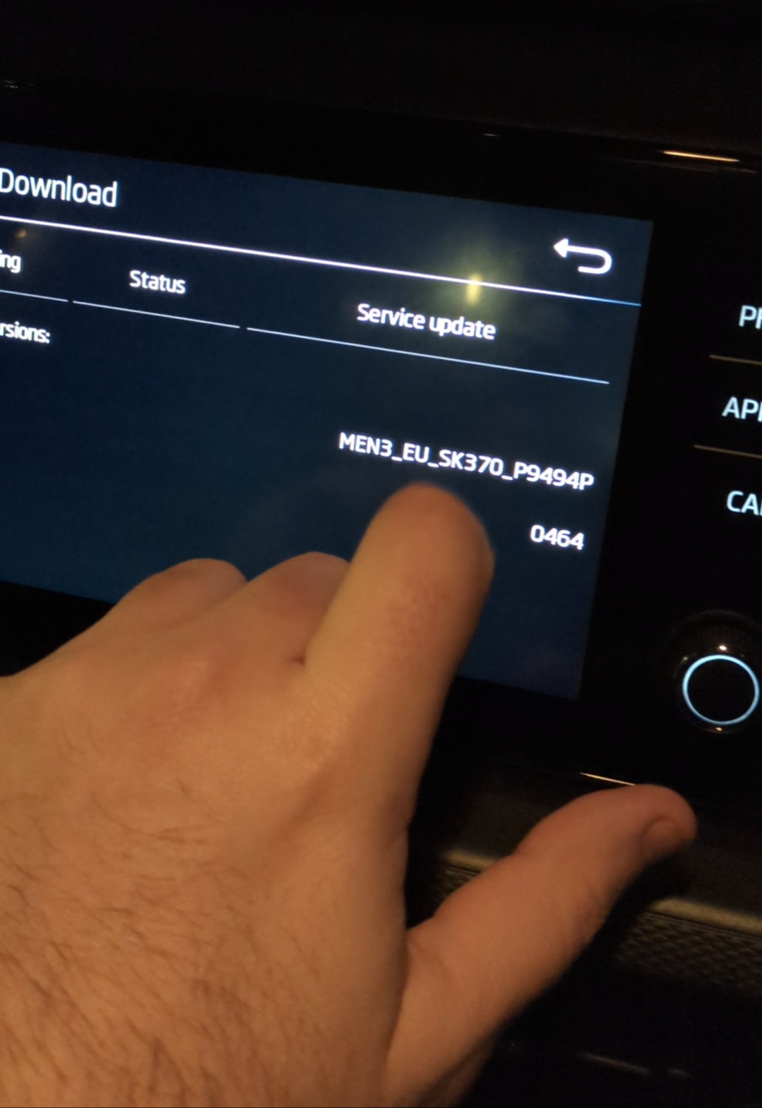

Hey there folks.
Just got my Kamiq last Saturday, I'm loving it coming from a low spec Dacia, however I'm having trouble connecting to AA using wireless with my pixel 7a, it always shows connection failed.
Was wondering if someone would be kind enough to tell me the order I need to update my bolero system on, and maybe provide the files? I've attached a screenshot, I believe I'm on 0464
Thanks very much
you need to update first to SW0469 and then to SW741 + Sw742

be carefull
charger conected, ingnition on
all 3 updates in a row
Noted! Thanks again! 🙂
One last question if you don't mind, what do you mean by charger?
Thank you very much. Tomorrow I will update and let you know if everything worked. Regards
battery charger connected on the car battery for voltage maintenance
