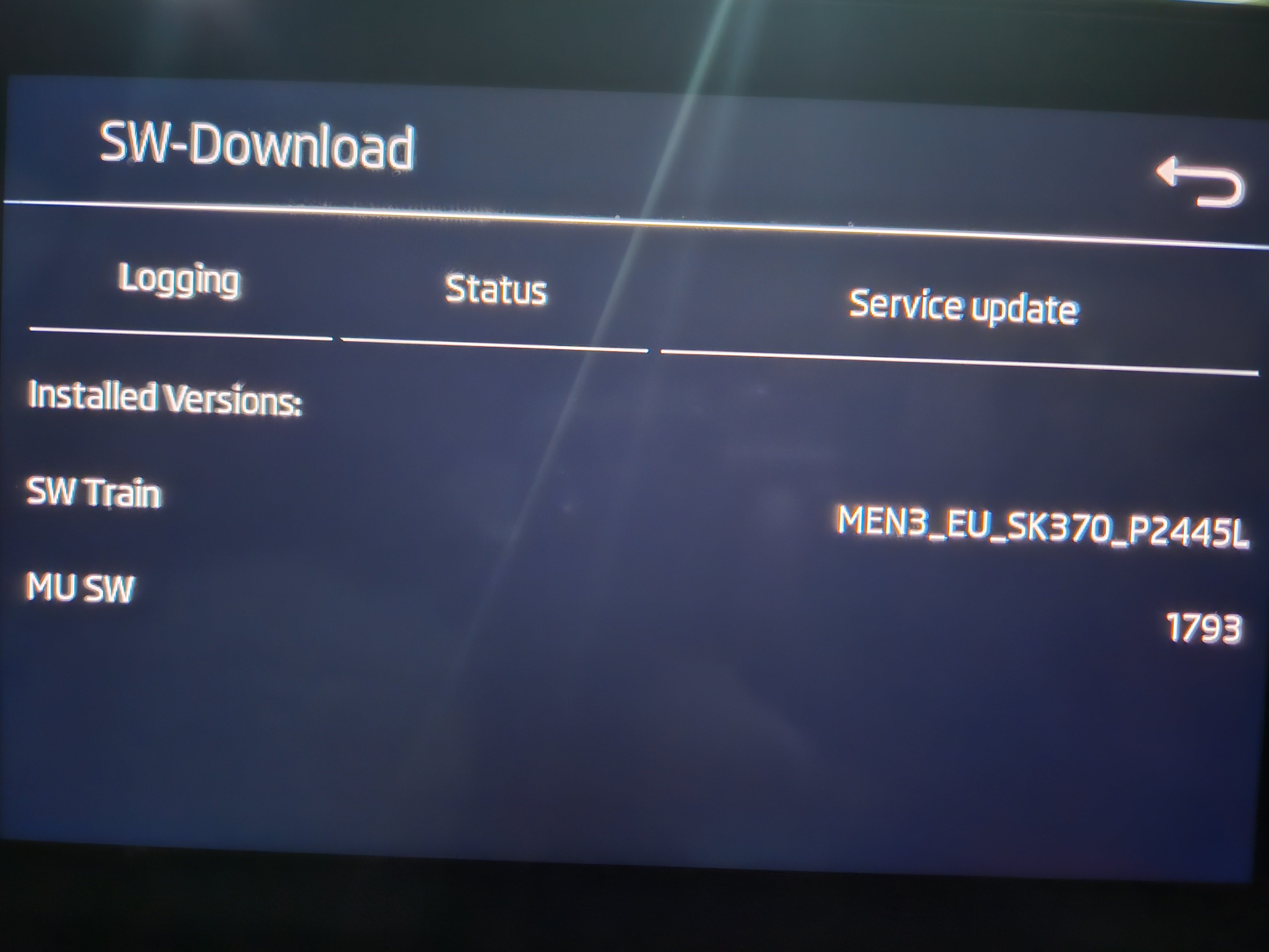

I have a skoda slavia 2023 model. I have issues connecting with s23 through android auto.
My current company installed version is 1793, which version should I update it to?

Update from 1793 to 1798 first. Then update to 1800 and everything will be okay. Android Auto will work with the S23 Ultra just fine with 1800.

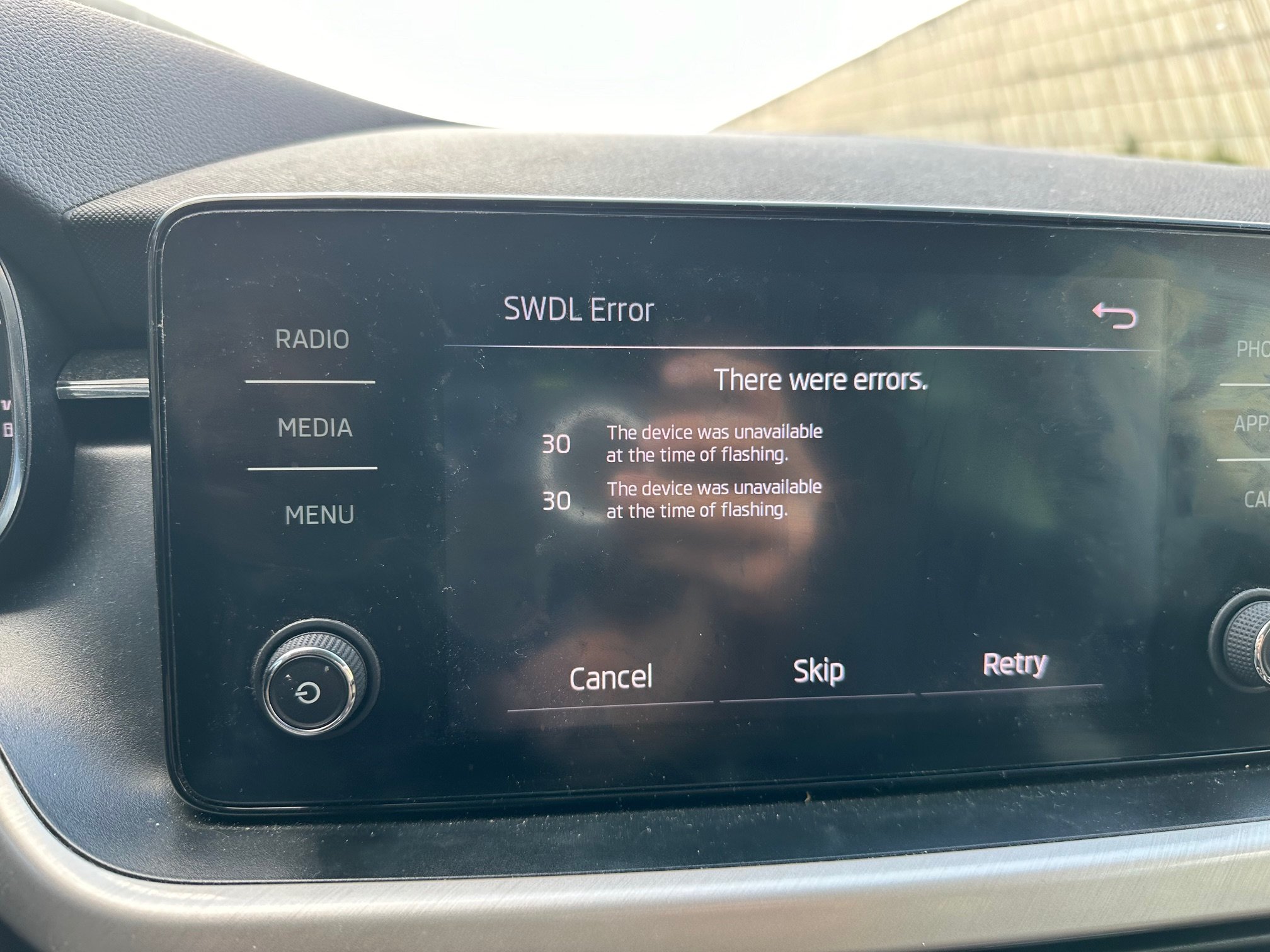

i tried to update my system from version 0741 to 0742 , but the car battery died during the update
now the system doesn't work good , with a lot of restart and i can start the update again as it always reboot
i also get the following (pic)  error displayed ( not all the time )
any suggestions how to upgrade to working system
thanks

the main issue , is that i can't start a new update , as it boot loop when i enter the update menu and choose the update ( it boot loop every few min regardless )
is there a way to force update , or update as BRIK device ?
i said it many times... KEEP ENGINE RUNING OR A CHARGER CONNECTED... but nobody listen....
you must try to flash with 0469 as it is a full flash. 0741 is a partial flash.
can you provide 0469 version files ?
BTW , 0741 was the version the official service center installed on my unit 1 year ago after service ( back them i wasn't aware of this wonderful forum )
if the dealer installed only 0741 , it was wrong and you should go back and see what they say.
  0741 must always be followed by 0742....

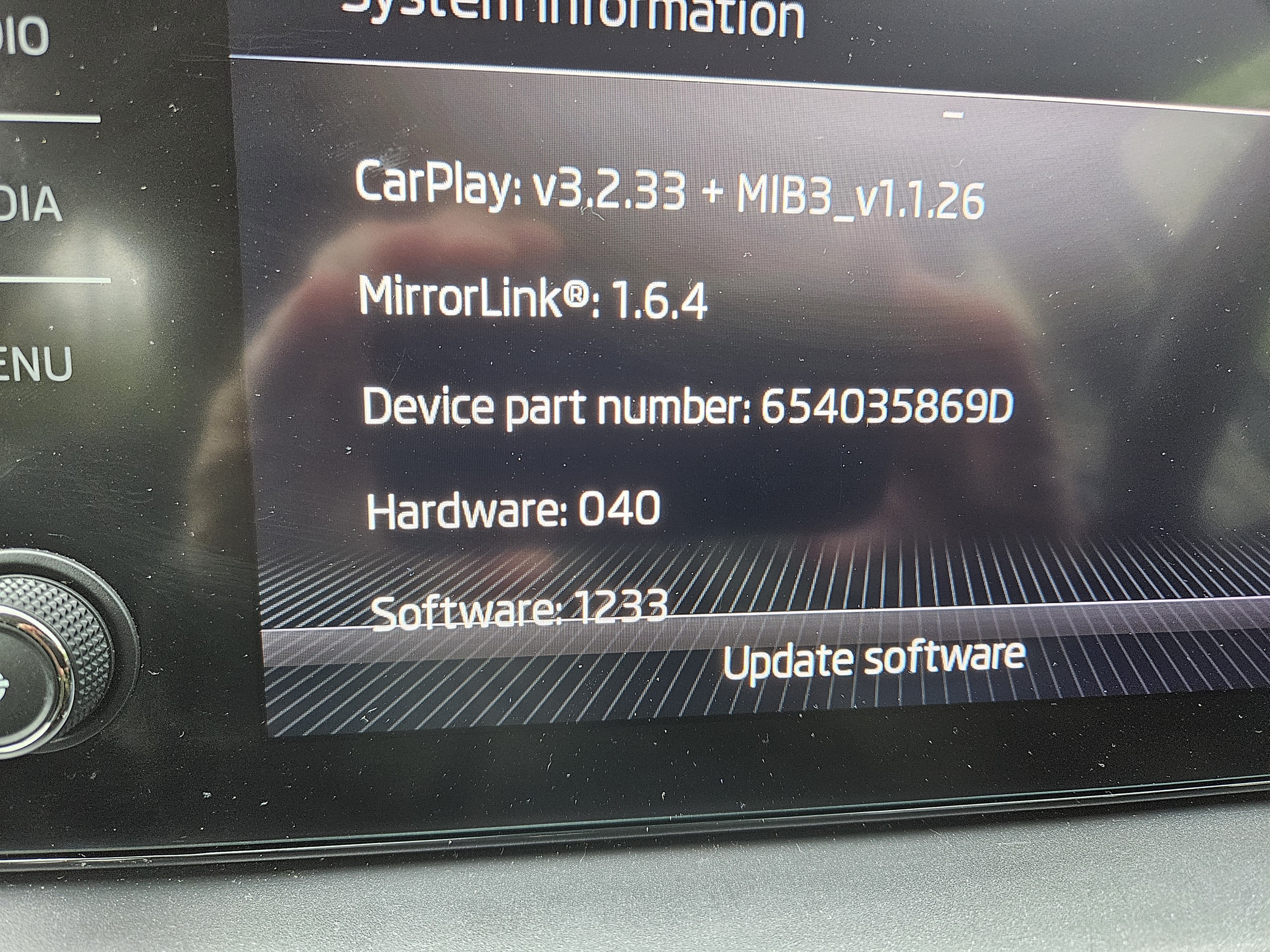

New Scala owner and not that switched on to software updating. I want to connect to Android auto but won't work. Reading on here looks like I need a software update? Can someone send me the specific steps to follow to undertake this process. Hopefully not too complicated! See pic for c
Spoiler
urrent version
what phone do you have?
why it does not work ?
Samsung S23 which is not included on Skoda's approved list of compatible phones but S23 + is. Seems bizarre !

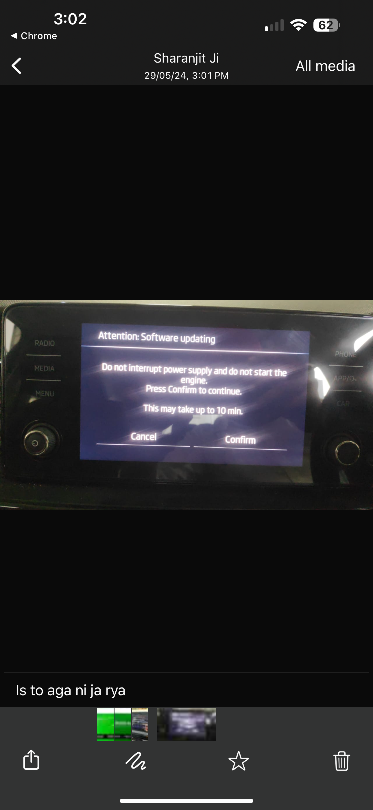

I am currently on 1790 version. But when I am trying to update to 1800 its stuck at confirmation screen. When I press confirm nothing happens. Do I need to update first to 1798 ?
