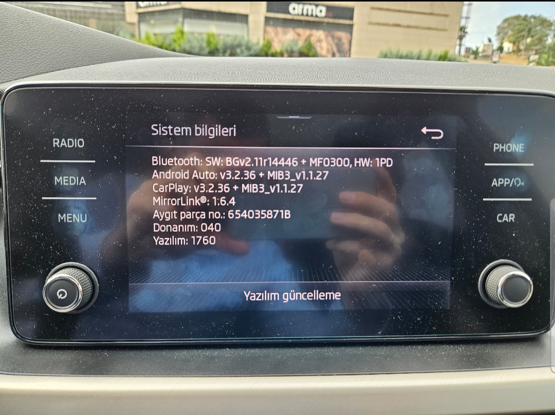

Are you süre about that because I have a same unit and my firmware version is 1760. I installed a 6 mounth ago.

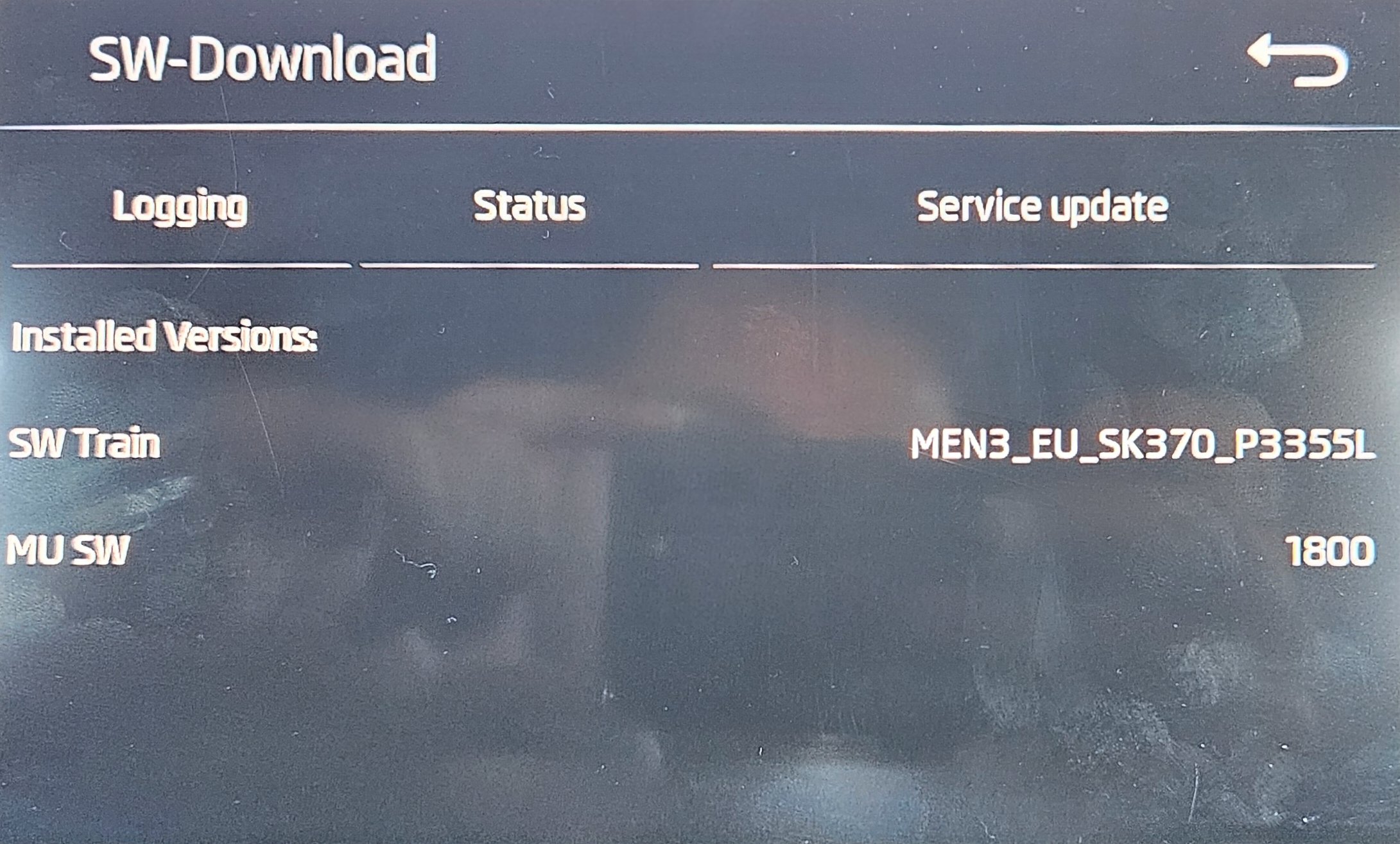

    I just updated to 1800, I have a Skoda Slavia in India with the Bolero system. I can confirm that the issue with S23 Ultra is finally resolved! Attaching images.

Old one was 469
First I installed 742 after than 1760.

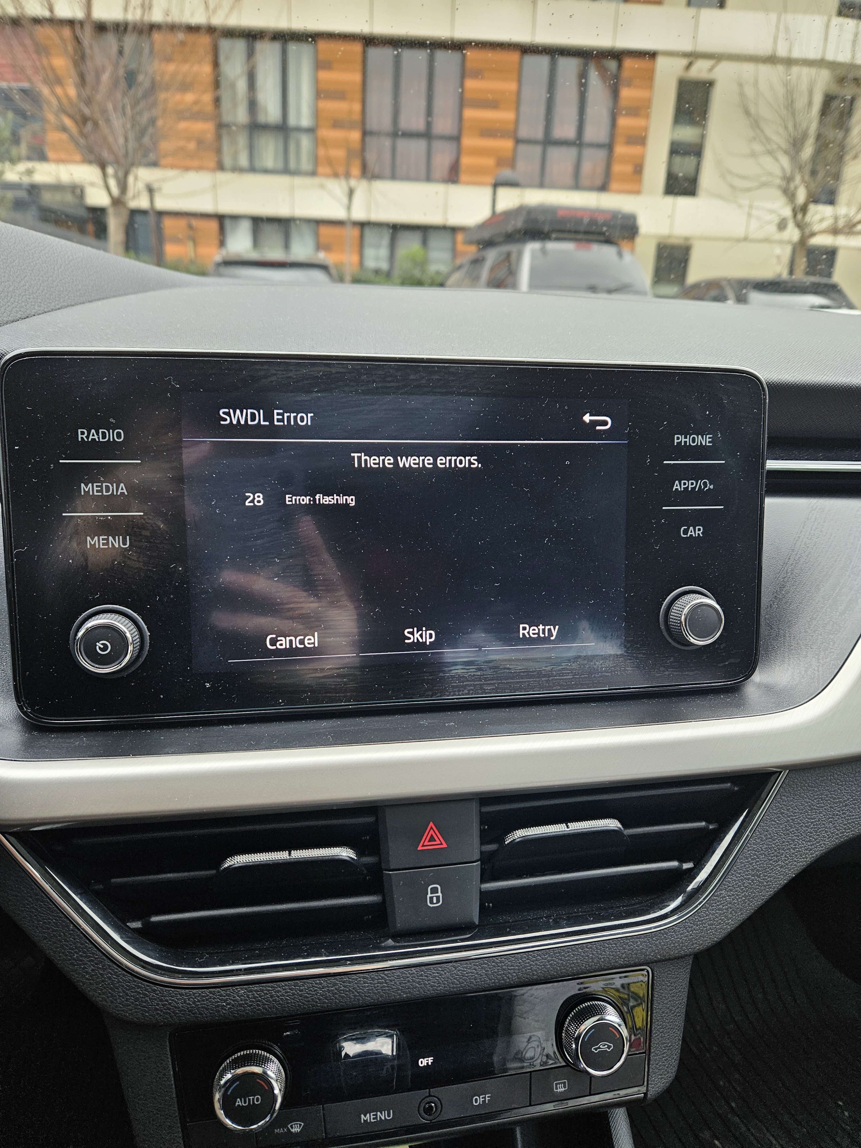

I try to install 1800 but there is some " 28 Flasshing Error " about tuner data files.

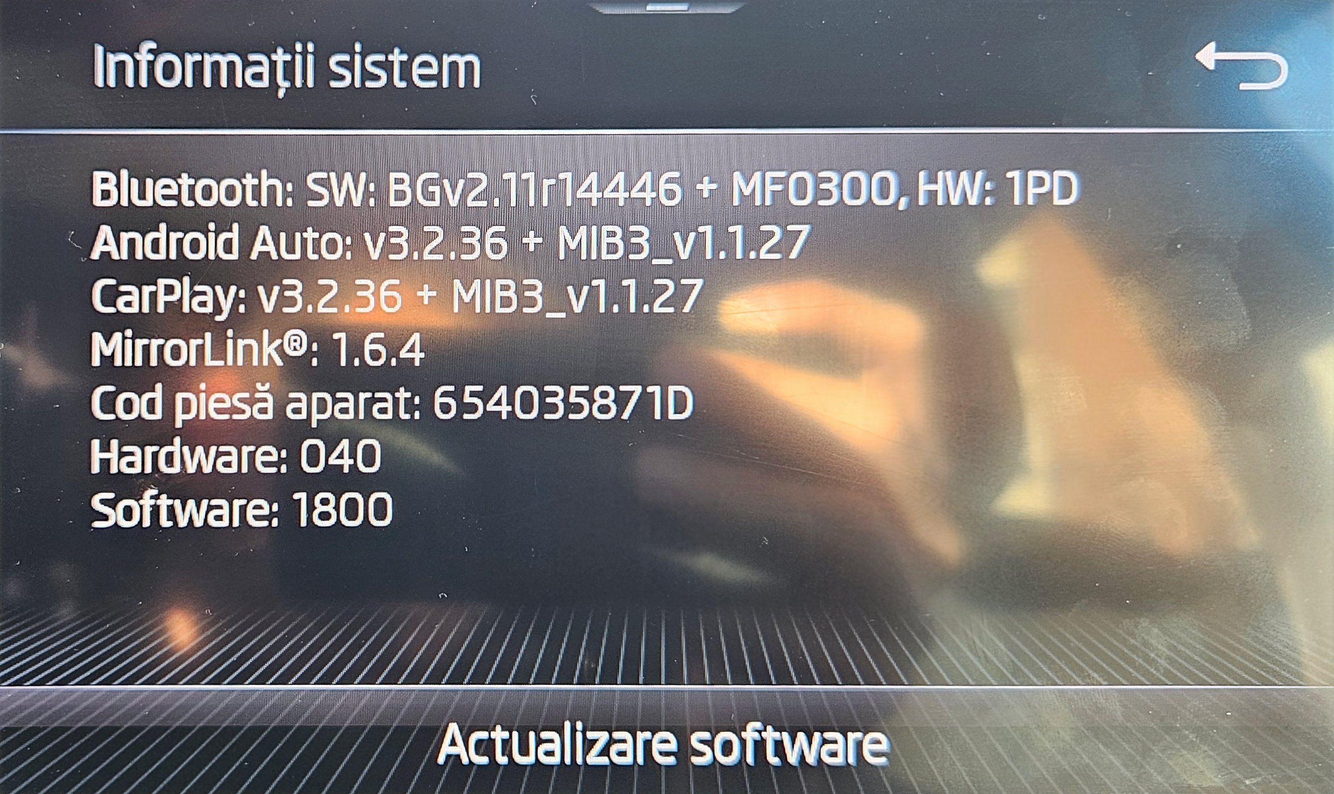

Hello! I have SW 1800 installed. Unfortunately the latest version available on my MIB is 742. I am trying to flash back the SW to version 469 or 741/742. The reason is that SKODA official service claims that the release of the Smartlink WLAN function cannot be applied to higher SW.
I want to note that the SW 1800 works without problems, except without WLAN
Software number: 654035871D before the update, the original designation was: 654035871B
Does anyone have a solution?
updated MIB requiers FOD activation for the WLAN and it is not available for 1800

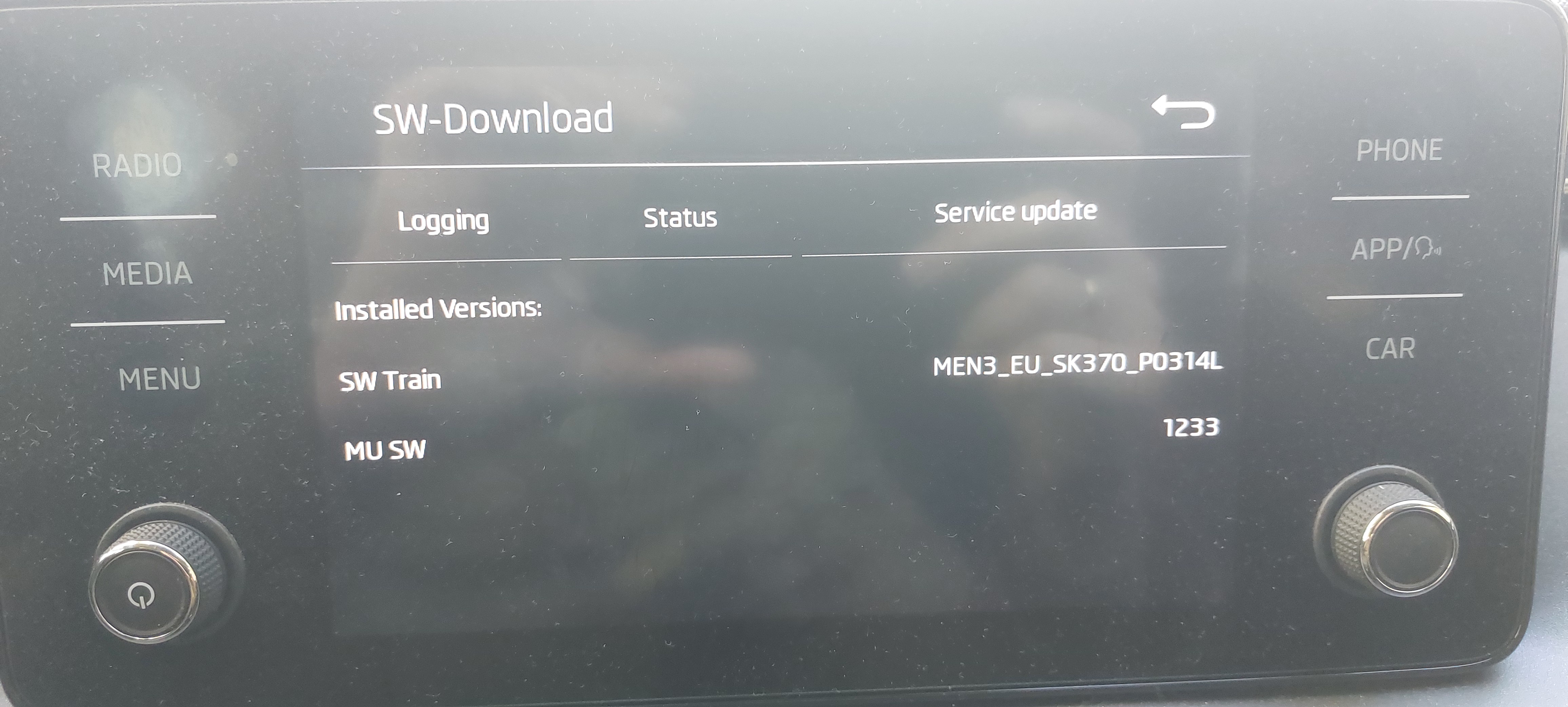

Hello, i am from Greece, and i have a Skoda Scala 1.0 TSi Ambition ( 04/2021 model ), with the Bolero MIB3 Head Unit ( no Virtual Cockpit )
The current Version installed is: SW Train: MEN3_EU_SK370_P0314L and MU SW: 1233.
Is there an update for my unit ?
I have found a version online ( MEN3_EU_SK370_P2345L ) but i am not sure if it correct for my model and region

what is your unit part number?
send me private message with your VIN
@Kaldio
you can update to sw 1800 , but i see you have SW092 in your OCU unit (emergency call unit) ant it will not go well with MIB SW1800. You should go to Skoda dealer to do the update the OCU to SW200
