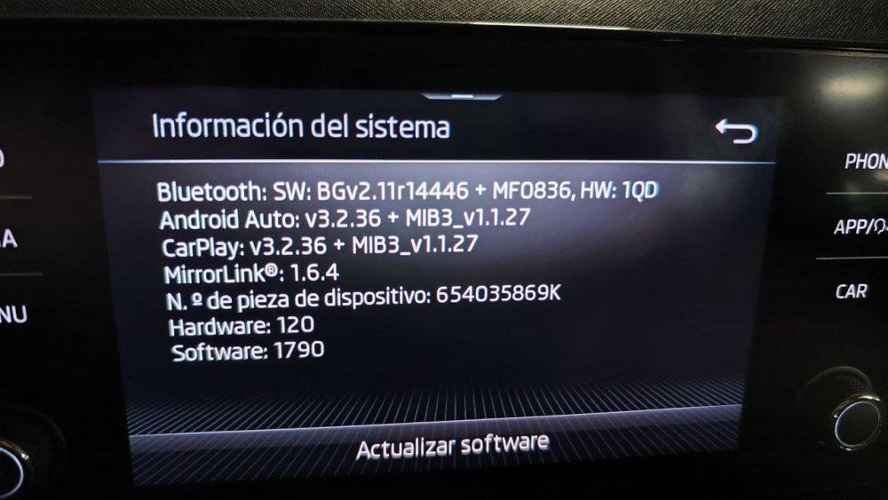

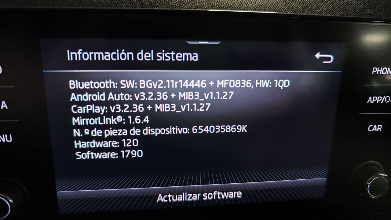

    I just updated to 1800, I have a Skoda Slavia in India with the Bolero system. I can confirm that the issue with S23 Ultra is finally resolved! Attaching images.

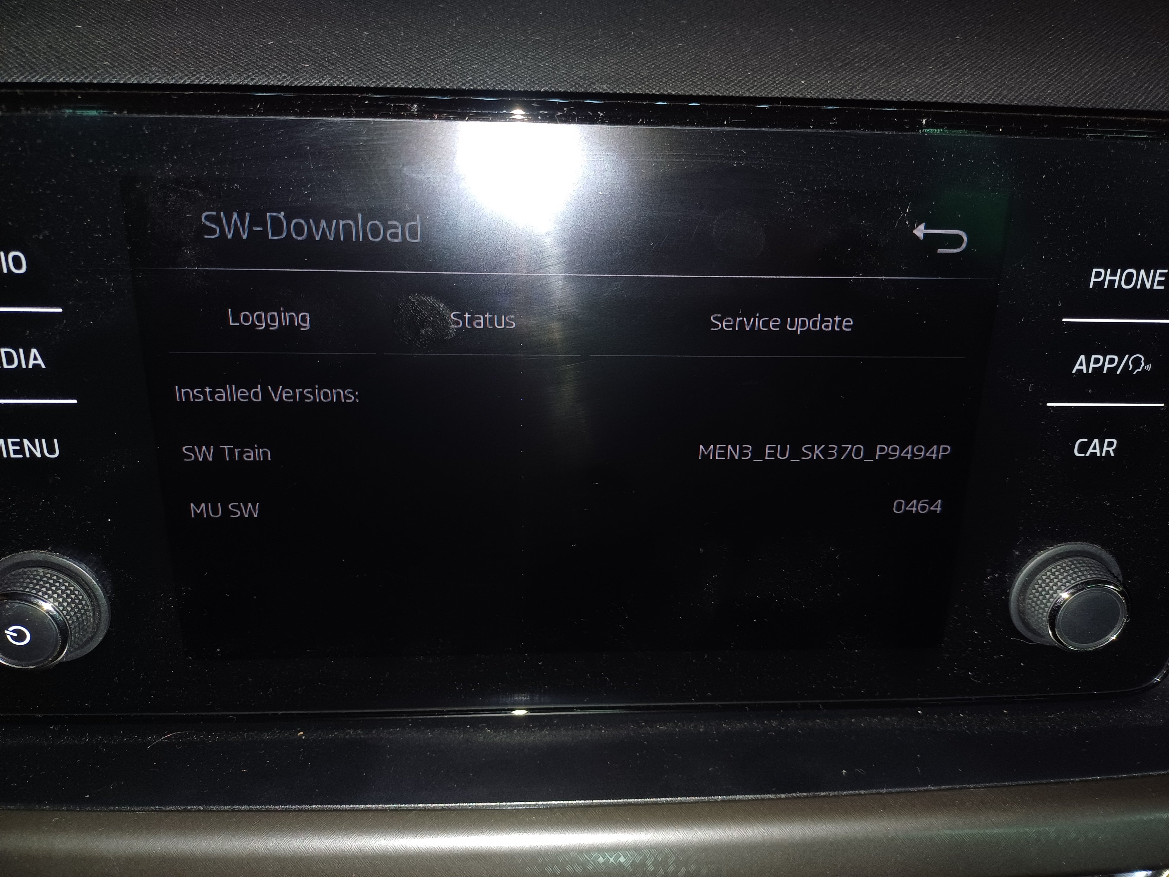

Hello. My 2019 Skoda Scala appears to have a version that is older than any mentioned so far in this thread.
SW Train: MEN3_EU_SK370_P9155P
MU SW: 0451
Does anyone know if it is possible to go from 0451 to 0464? My end goal would be to follow the path of 0464 => 0469 => 0741 => 1800. Is that a reasonable goal?
MU SW: 0451
Try 464. It's possible it will be ok. Is it something wrong with your system ? Maybe you don't need to do the update?

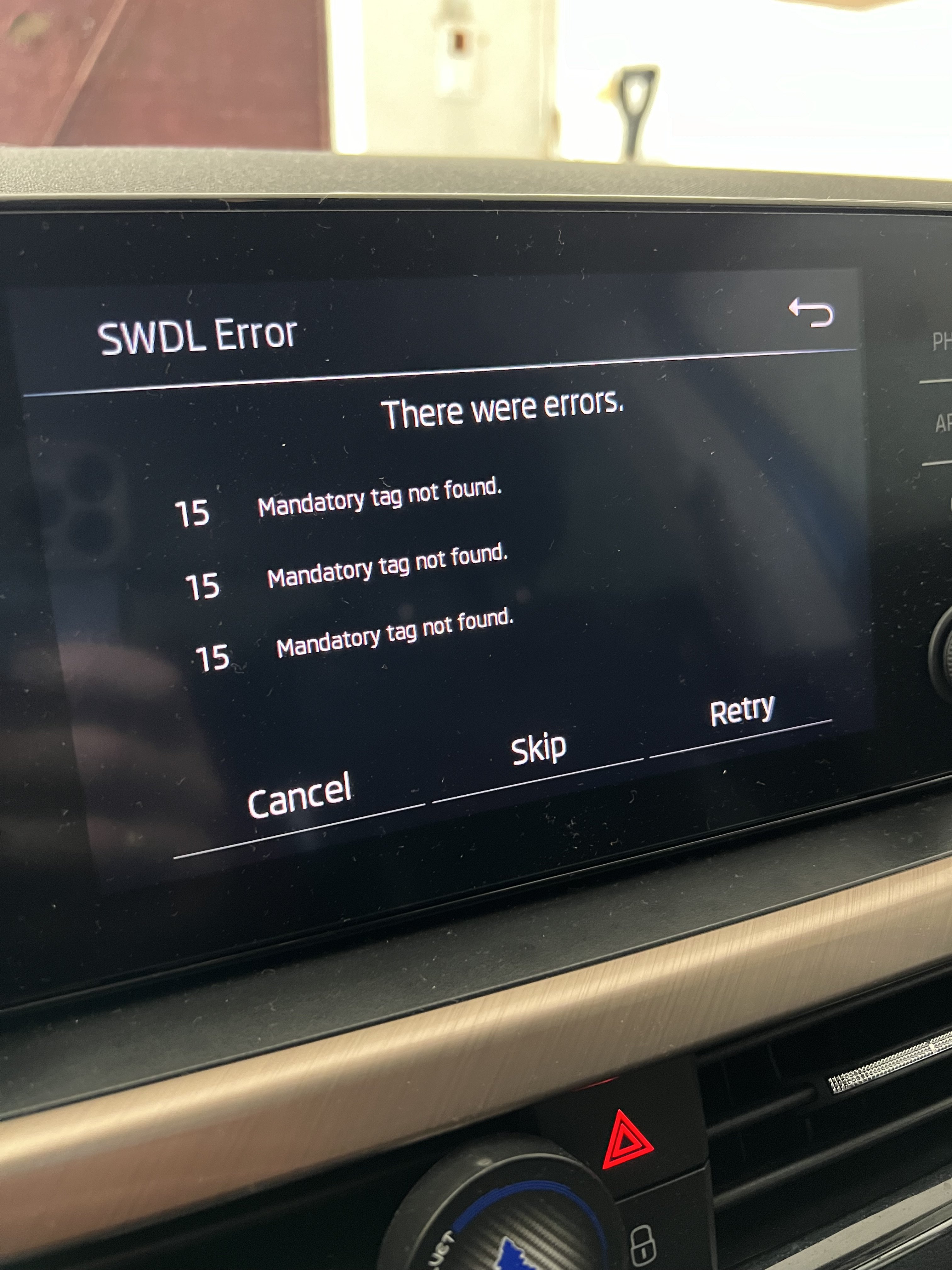

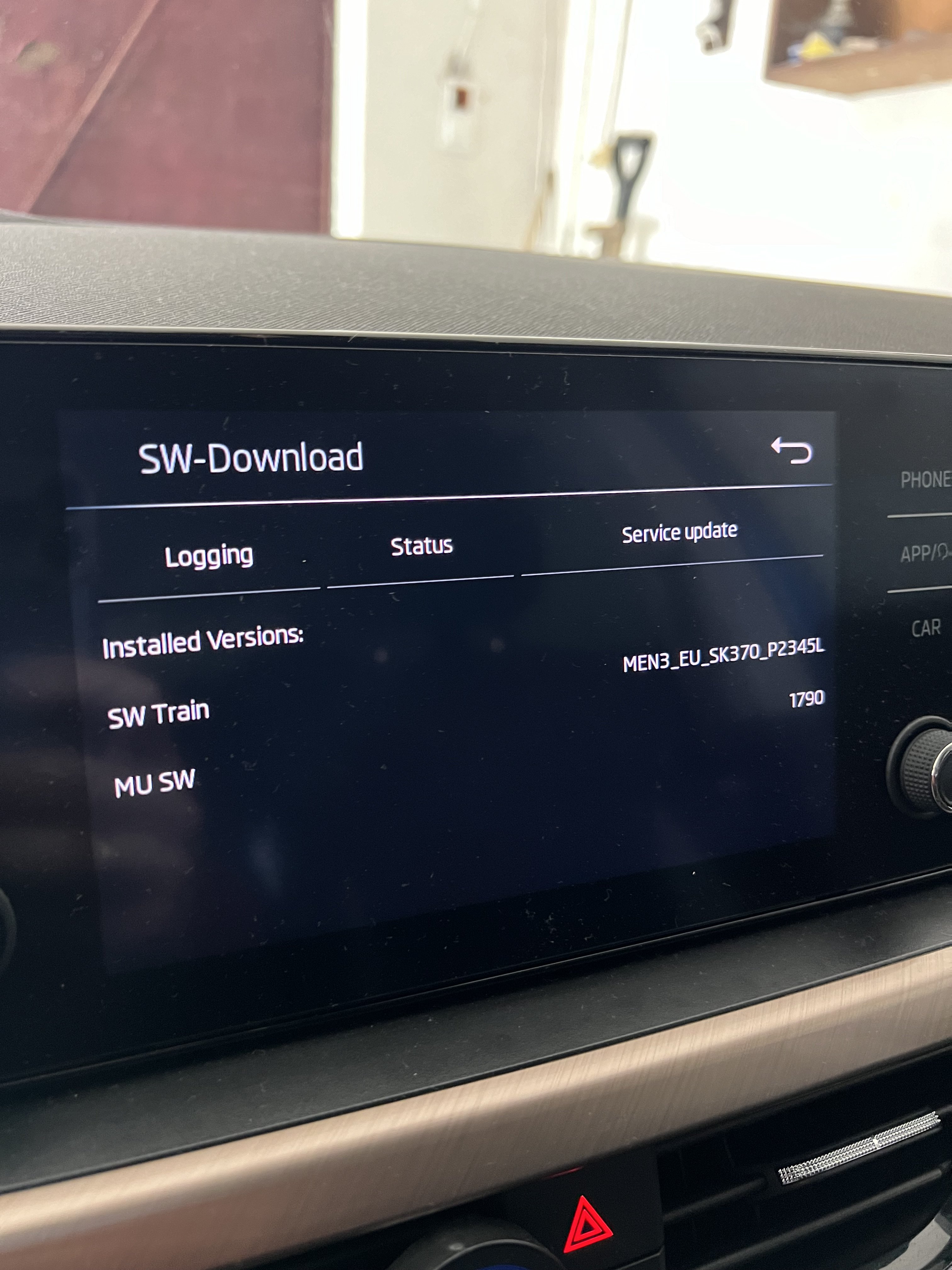

hello, I tried to update my system. I did two versions and the last one gave me an error. I tried to reinstall it but it didn't work and I canceled the installation. However, the version changed but unfortunately I have a problem with the sound, you can hear a slight noise in the background. When I want to upload another version that fixes this problem, instead of files, there is an error like in the picture.
Try to reset system, hold power/volume wheel, and try update again. Are you do it with all sugesstions ? Engine off, ignition on, charger at battery, native pendrive directly to usb port, firmware files unpacked correctly to storage ?
yes, I do everything properly. I have already done two updates and with the third one these errors popped up and now instead of files on the pendrive you see such errors. depending on the number of files you see so many duplicate errors.
you tried to update a SW that is not for your unit.
your 2019 Scala has maximum SW742
you were warned not to update to 17XX/1800 because there is no way to recover if something goes wrong
As I see adjorek had 1790 fw so he should update to 1800 with no errors.
But I updated to 1790 and errors popped up during this update.
Edited by adjorek
because 17xx is NOT for your unit.
You should have stopped at SW742
Edited by andreiro221
we've already established that. should i turn back time? i asked if there's any way to turn back/fix it.

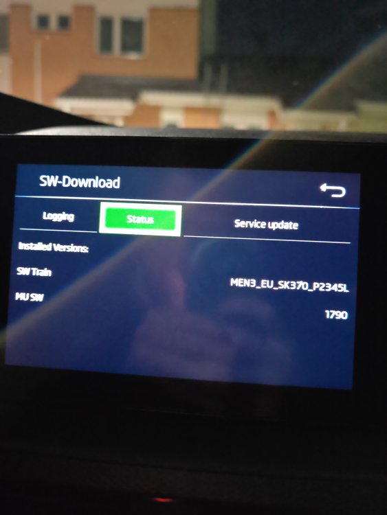

On 24/04/2023 at 21:55, tatutee said:
Hi,
I also have 1310 update. Where can i get the 1790 update?
Update successful, thanks! Will try AA now 🤞
