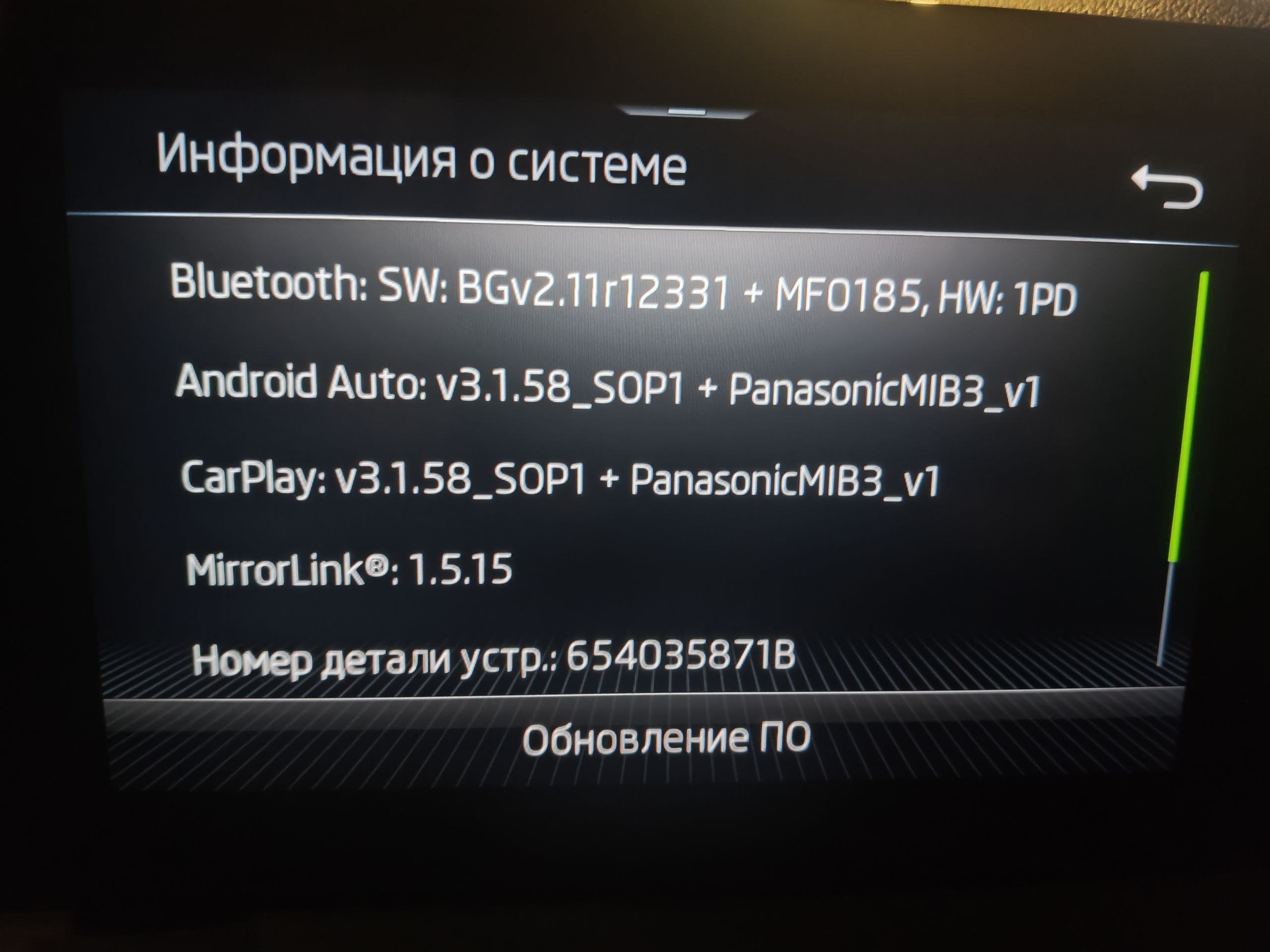

I have a skoda kamiq my 11/2019 with bolero sound system and SmartLink wired.
SW Train: MEN3_EU_SK370_P949P
MU SW: 464
TG#: 654035871B
HW: 040
SW: 0464
My first question is. Am I able to unlock SmartLink wireless with this hardware?
And if I am able to are there any Prerequisites i have to prepare to make this happen?
Thing is, I went to my skoda partner and they told me a lot that i dont buy yet. About I have to change the control-unit and that there is no software update for this bolero and my2019...
For any help I would be very graeful.

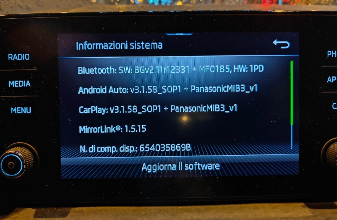

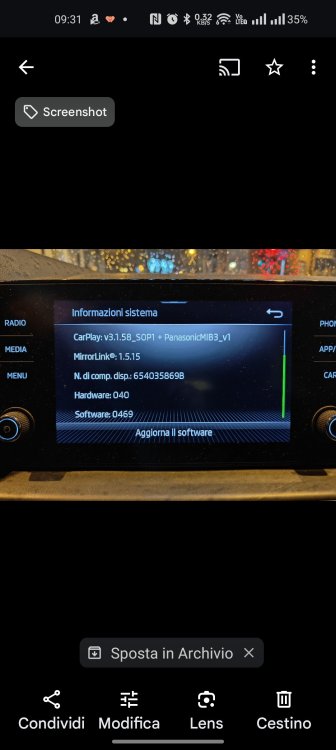

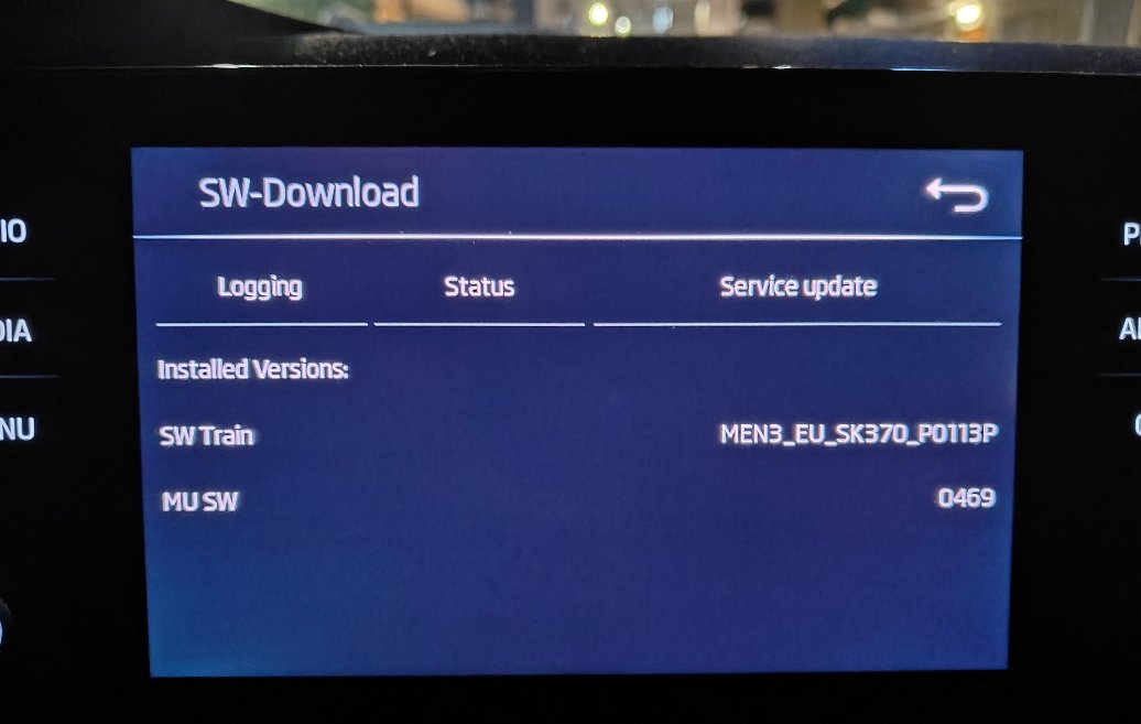

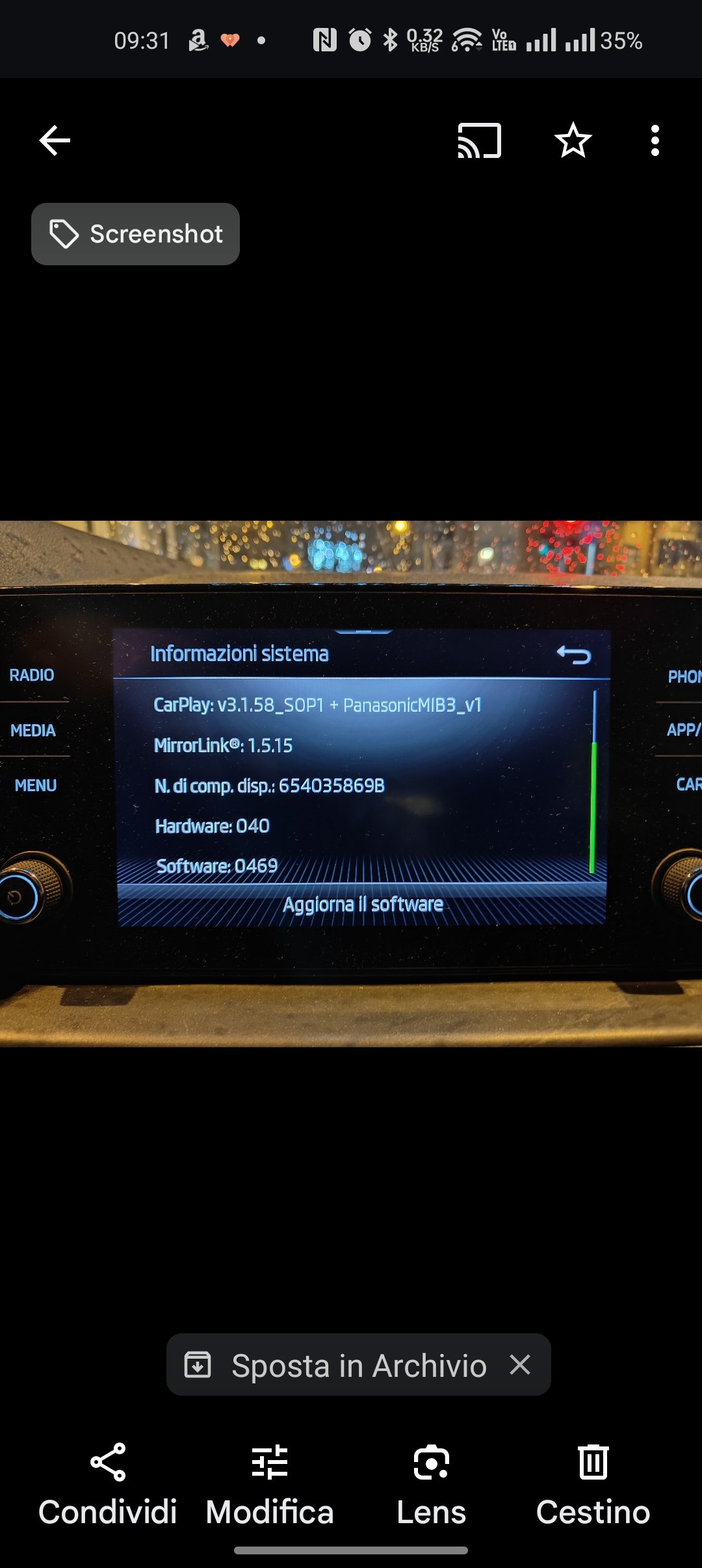

Buongiorno a tutti ho una Skoda scala del 2020, vorrei aggiornare il software del mio Bolero perché non riesco a collegare Android auto con il mio smartphone Android Oneplus 11 5g. Vi invio le foto del hardware e del software che monta la mia vettura. Non procedo subito con l'aggiornamento avente il nr. 1800 perché non ho ben capito se è compatibile

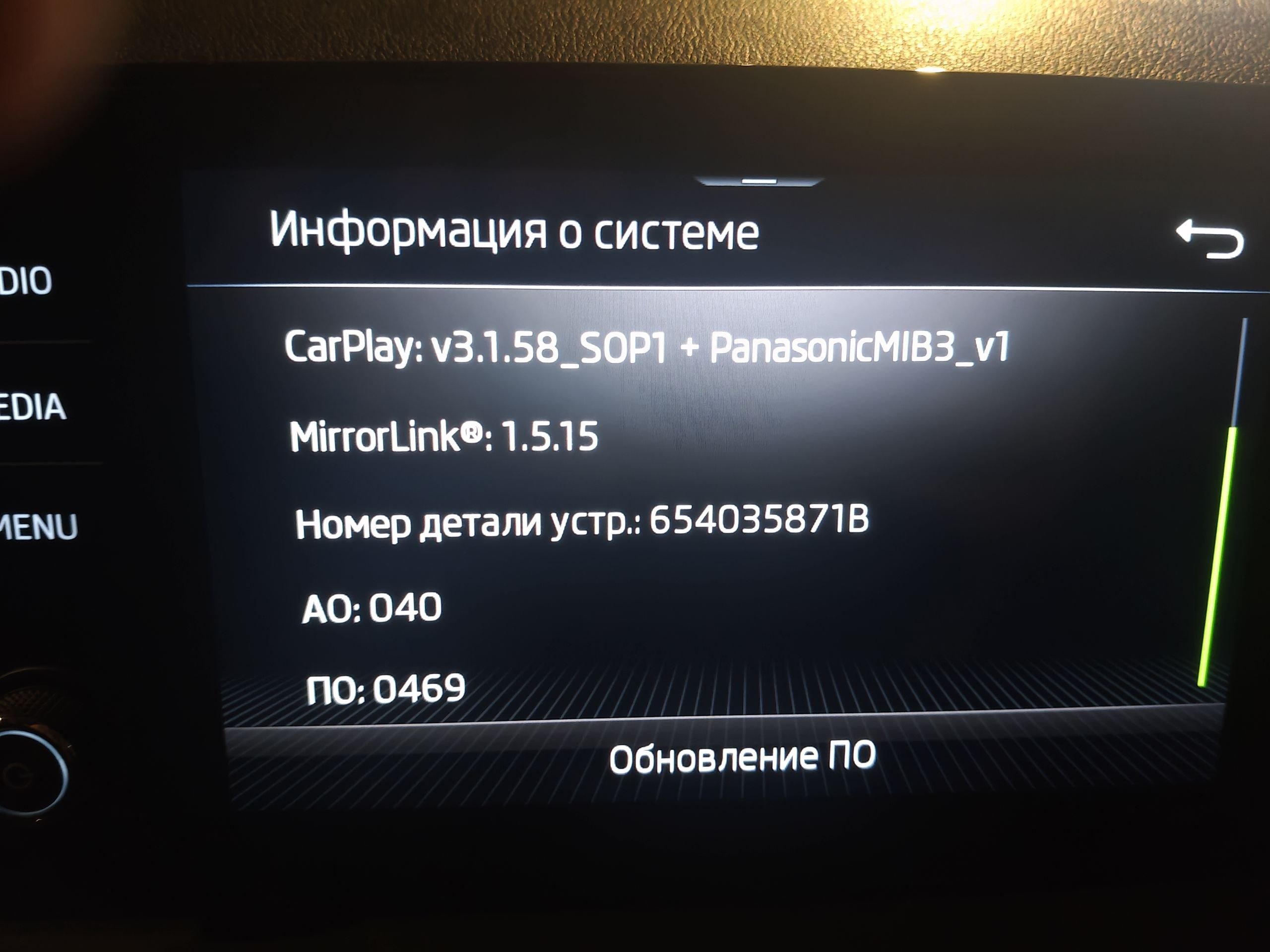

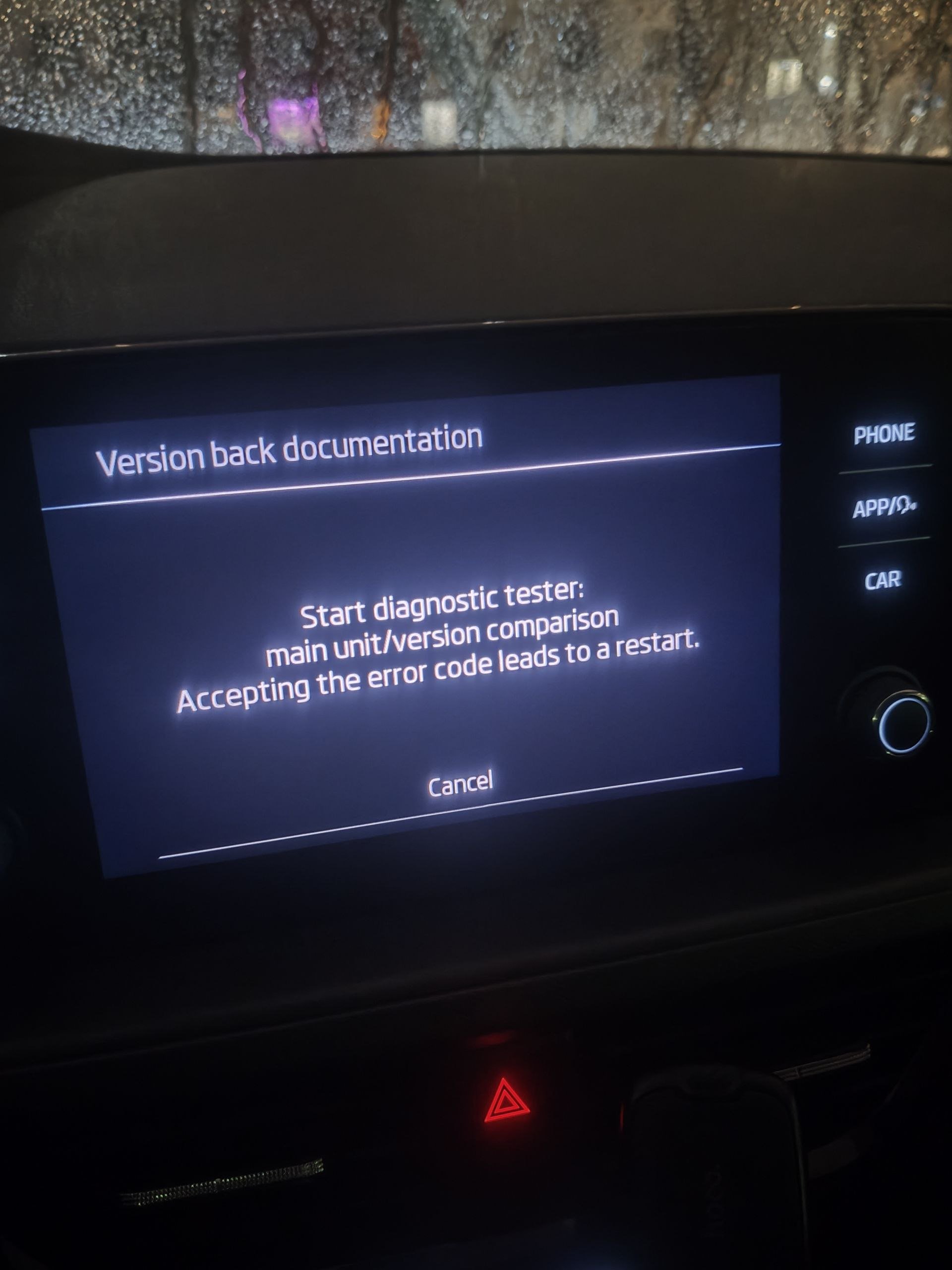

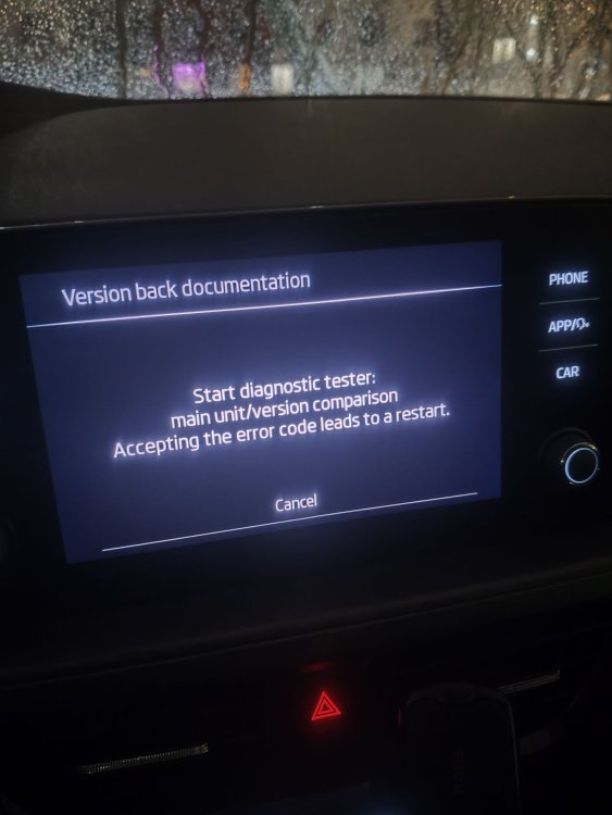

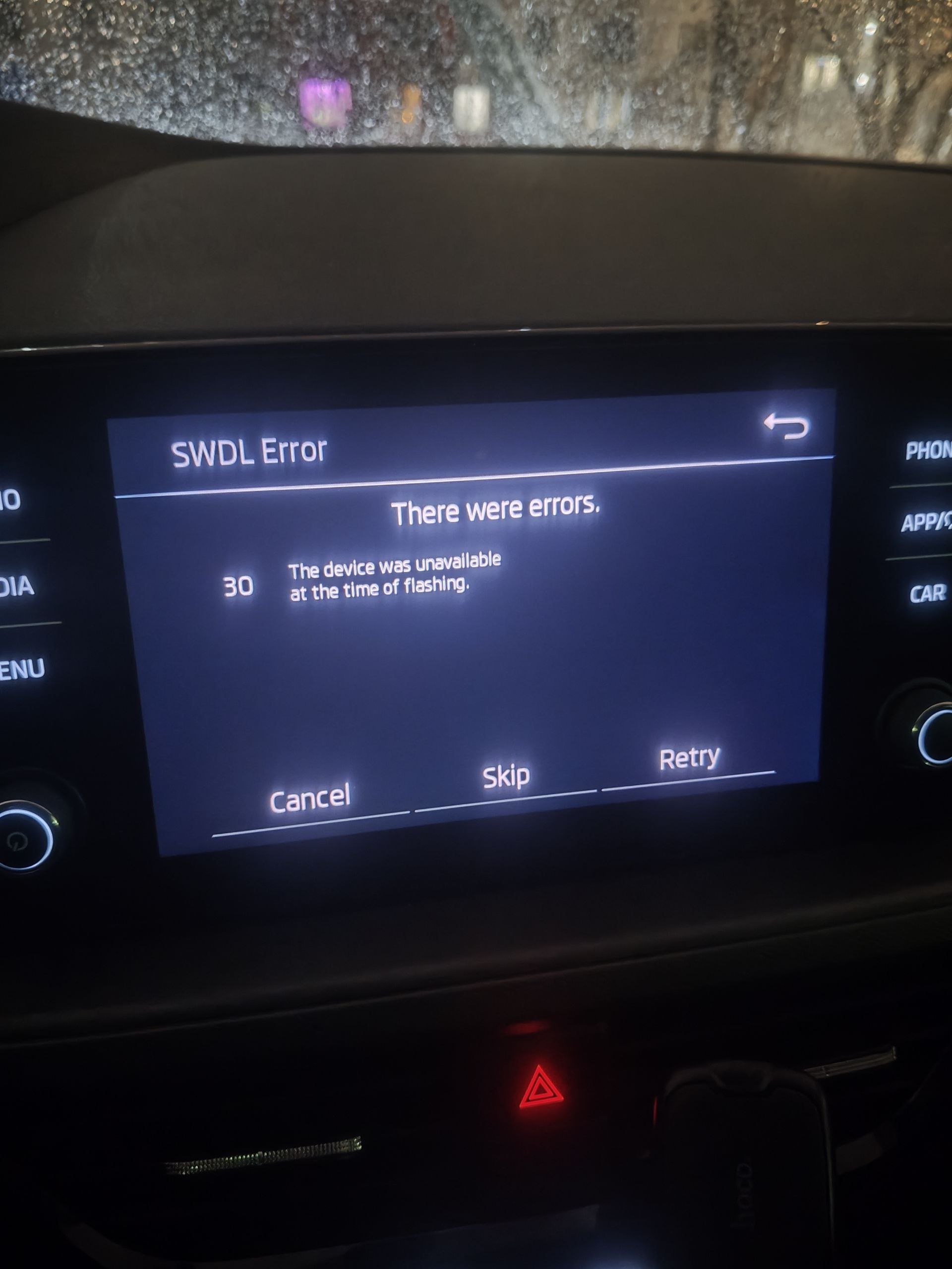

Hello everyone, maybe someone can help with MIB3, after updating from version 0469 to 0741, the system started to reboot constantly, the sound disappeared, bt and WiFi work, but I can't roll back or update to another version because the system reboots sometimes I have time to start reading the meta sometimes the reboot is already at the stage of selecting a folder on the USB, if you do not touch anything, then after a couple of reboots it starts the update which ends with SWDL error 30 when trying to repeat or skip the same thing if you press cancel or abort then the system reboots into a window where it requires confirmation of the update with diagnostic equipment if you confirm or in this window press cancel then the system reboots and the reboot cycles start over in the update logs at first there was an installation with OK statuses, then a big pile with NOK statuses, has anyone encountered something similar or at least suggests where to look for the error
741 is incomplete firmware. Right after the update to 741 you start update to SW742....

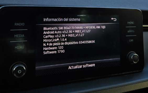

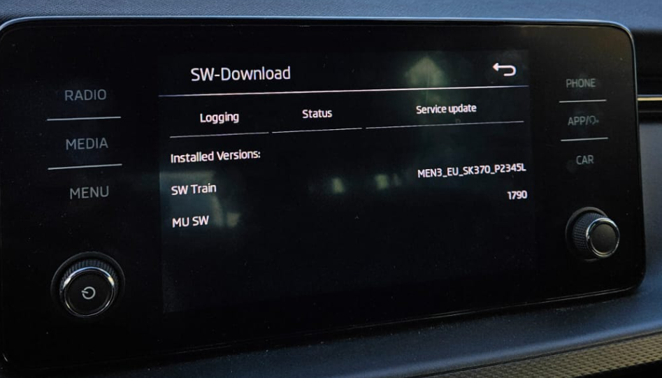

Hello, friend of mine have Scala 2019, and he have this firmware installed:
SW Train: MEN3_EU_SK370_P9305P
Software (or MU SW): 0463.
MIB helper is showing that latest firmware is MEN3_EU_SK370_P1185L (MU: 1760) but i saw on this forum that MEN3_EU_SK370_P2345L_1790 could be good too. Can you please help me and share correct one (might be on PW) @varooom? Thanks in advance
@andreiro221 can you help me please? I think i need  SW0469 -> then SW741 + SW742 and update to 1800 is off limits as it is 2019 version. May I ask you for firmware?
Hi, I have upload for you fw469 fw741 and fw742. Please be aware that all updates you will do on your own risk, even risk of brick unit. First question you need to ask yourself is: do I really need an update ?
Good luck.
