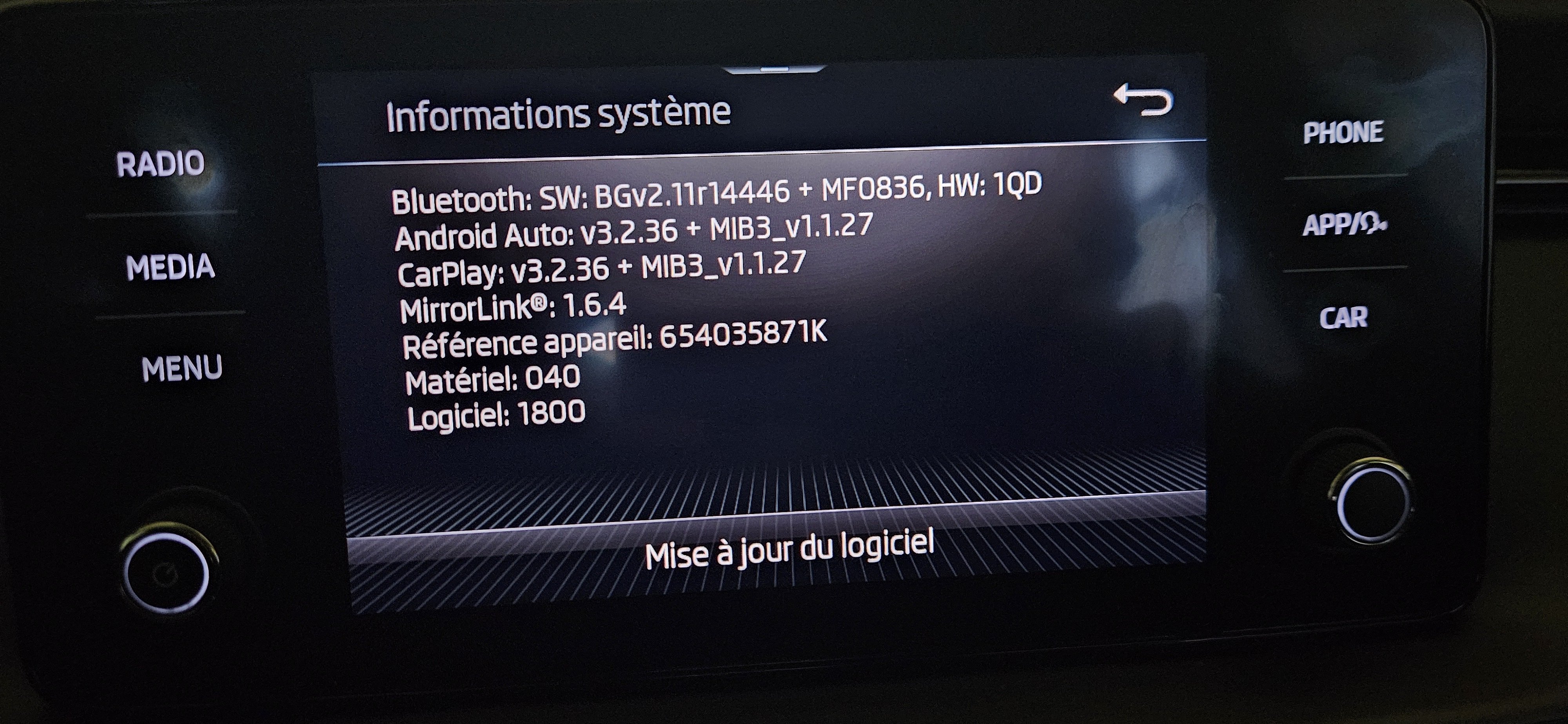

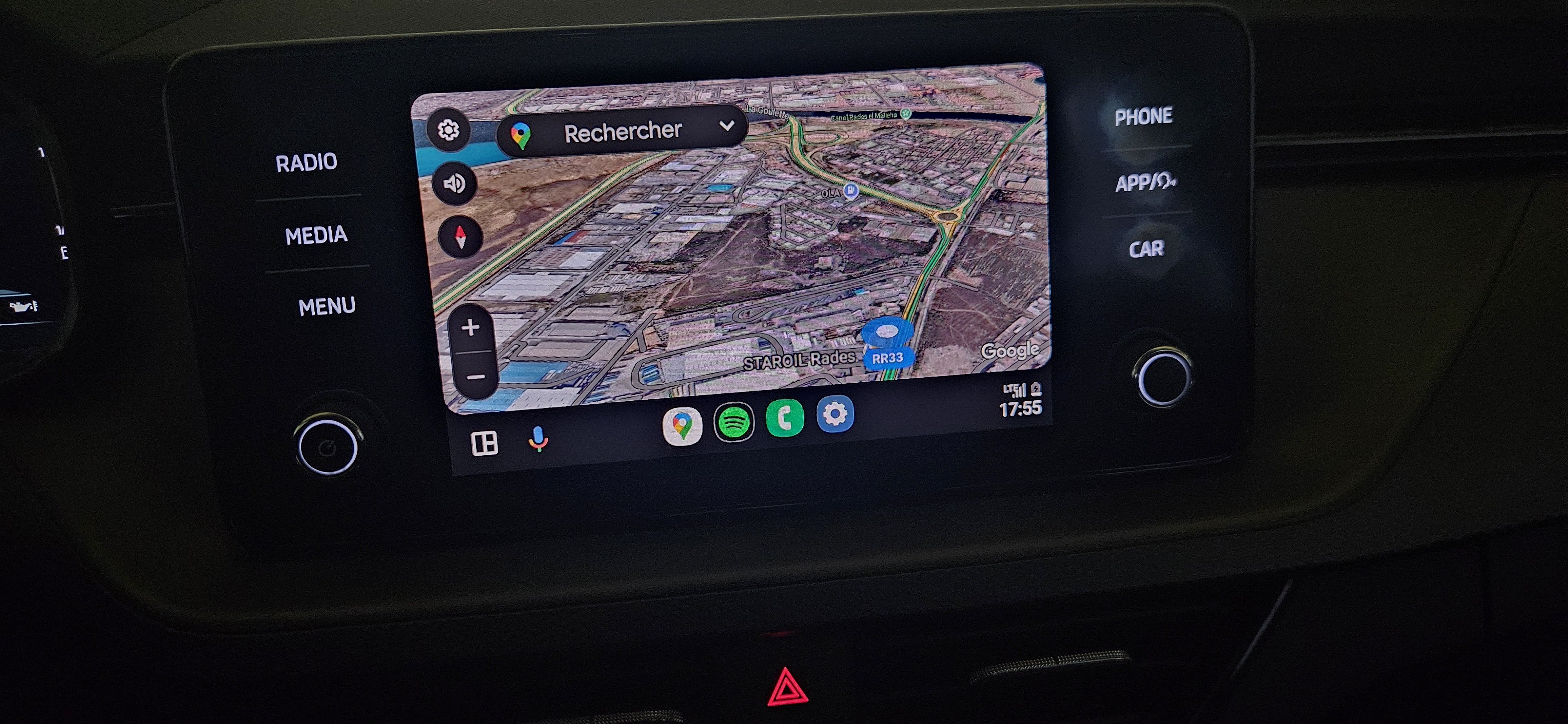

 i confirm l update 1780 to 1800 with succes without any problem  and i m Very happy android auto work with my samsung s23+ after 2 years i thank all membre to group20241011_175522.thumb.jpg.3ba7528feb109e0522718602d86769ec.jpg20241011_175540.thumb.jpg.a55ac2730985e57ebee99967fb895505.jpg
for to prepar usb it's necessary
1-format in exFAt
2- créat an folder and it must be named the name for update for exemple MEN3_EU_SK370_P3355L_1800
3- it must be extract the files to folder

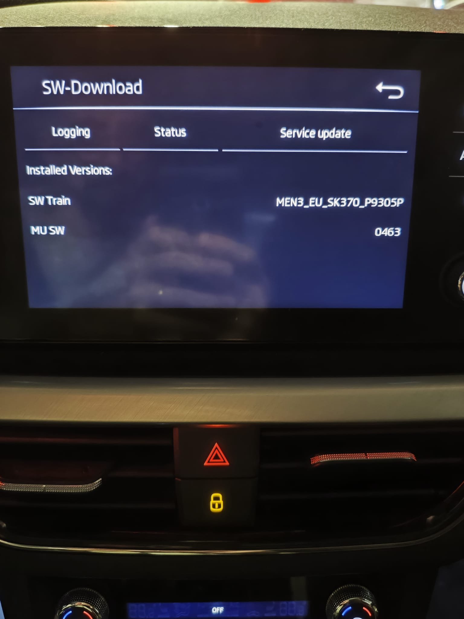

On 28/01/2024 at 18:37, DamirKo said:
In my case, I have just got a new Android phone, and AA auto simply doesn't work with it with MIB3 unit on SW 0463.  Worked with previous since 2020...
Due to some posts here and some other sites claiming updating to SW 1800 finaly fixed it for them, I was hoping to get this solved.
Otherwise, without AA this "Bolero" unit is no use to me, could have got a Swing or a Bluetooth adapter ;)

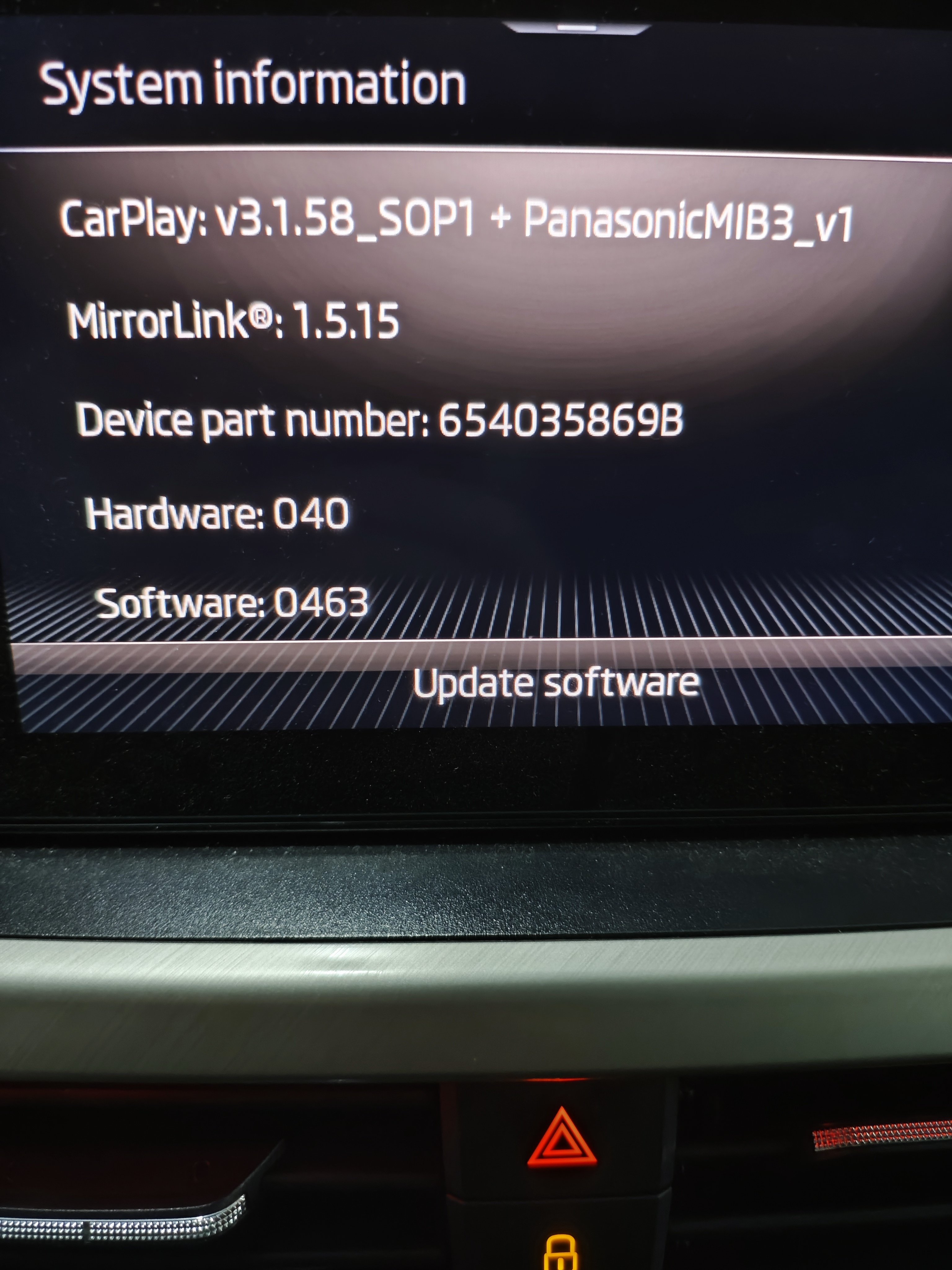

Hey @DamirKo
Did it go well for you? 463-->469-->741+742? (latest version allowed when coming from <469 afaiu)
I also got sw version 463 with 040 hardware version, trying to make sure I'm good to go.
Also, how much time does it approximatly take for an upgrade?
Did you leave the engine running or connected the battery to a charger?
Any other special instructions?
Thanks in advance

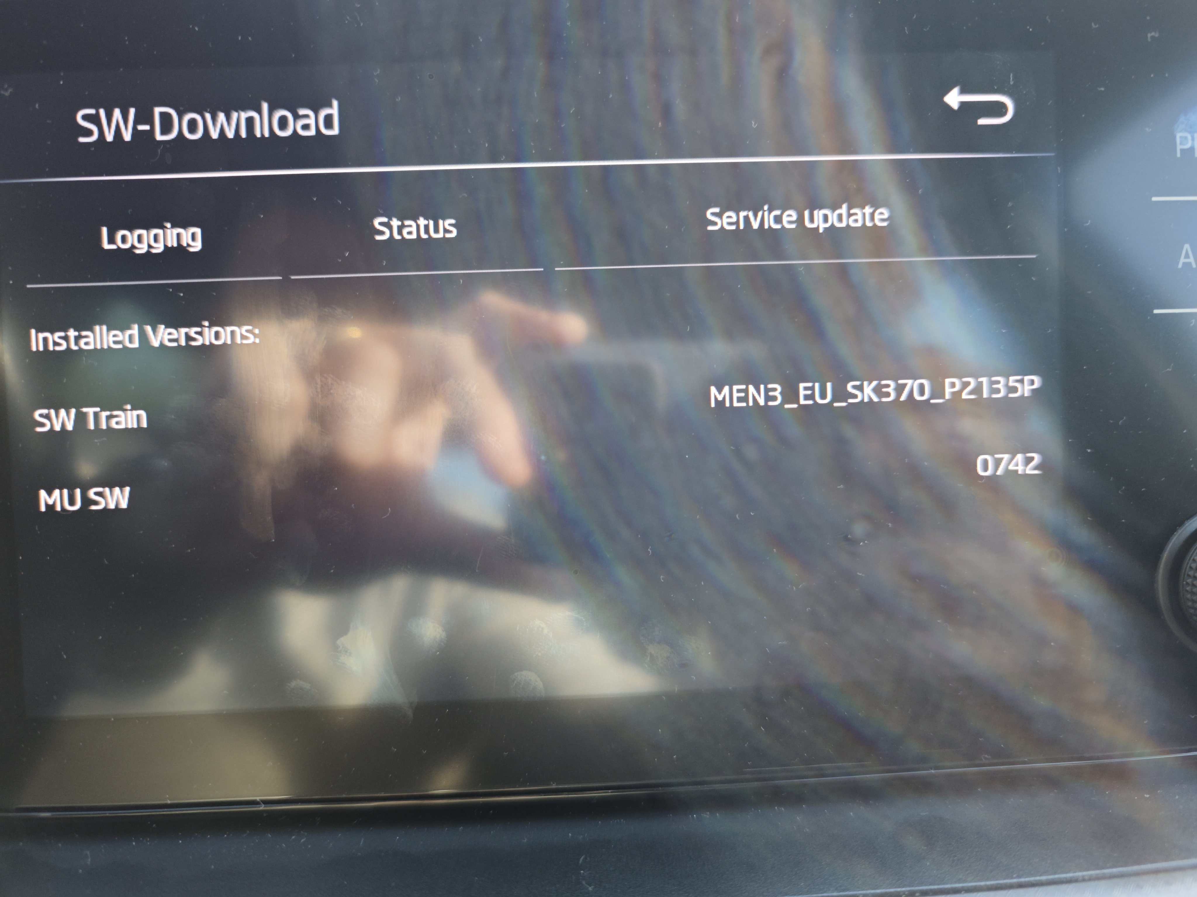

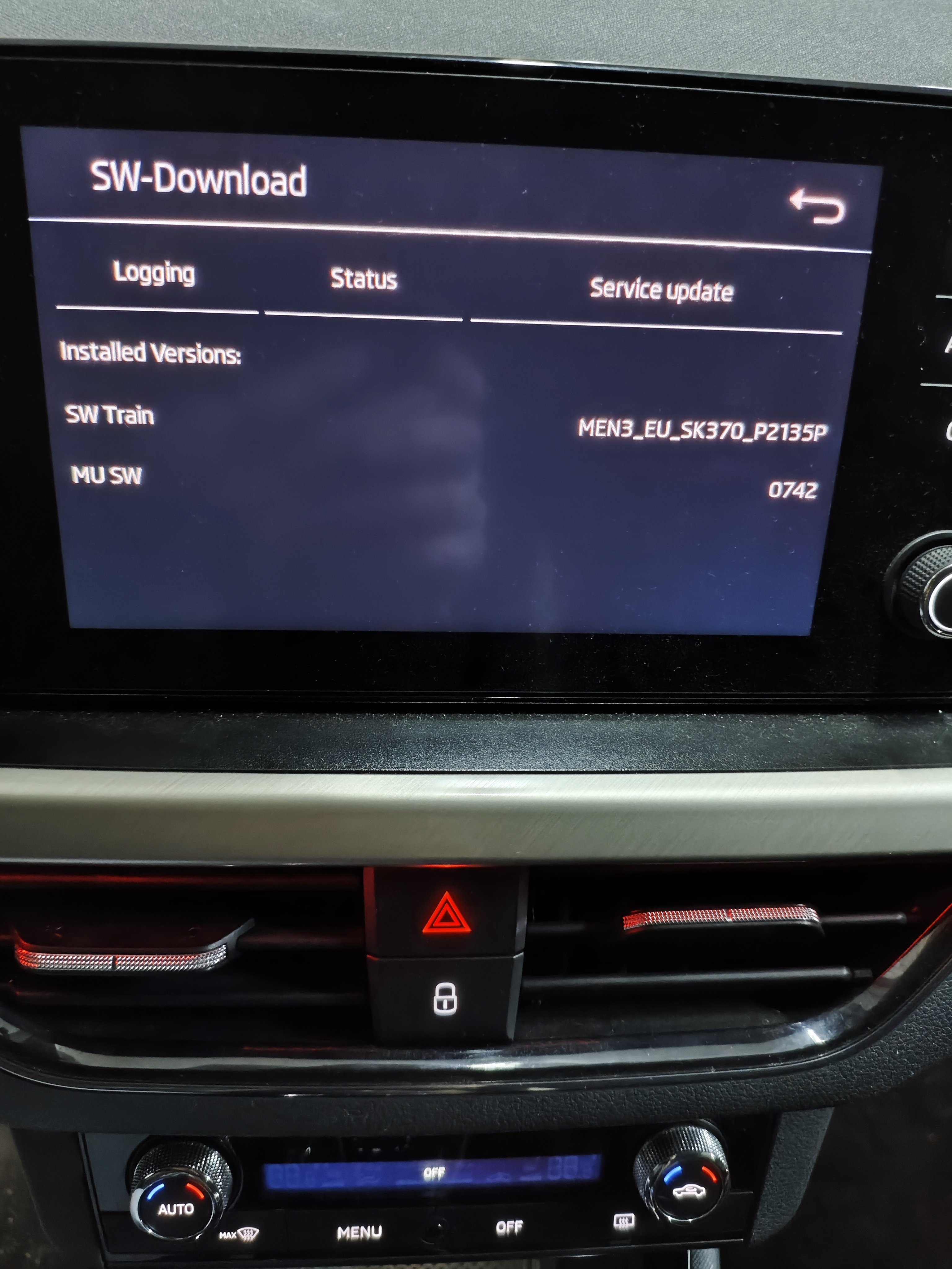

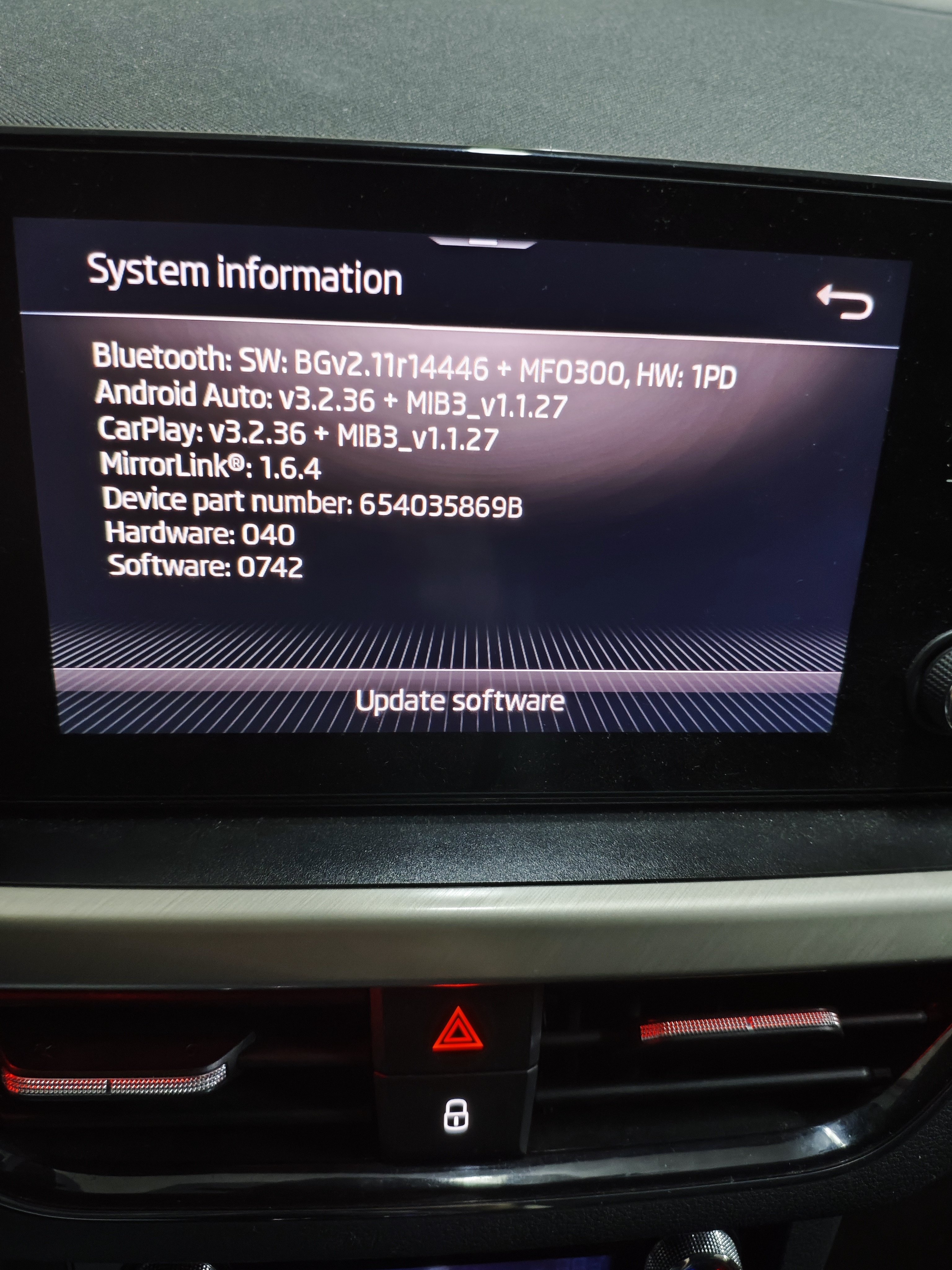

I have successfully updated my version to 742, but the AA connectivity issue still persists.
Does anyone know whether I can safely continue upgrade to following versions?
I started with sw463 and hw40.
Attaching the current state of the system
Thanks

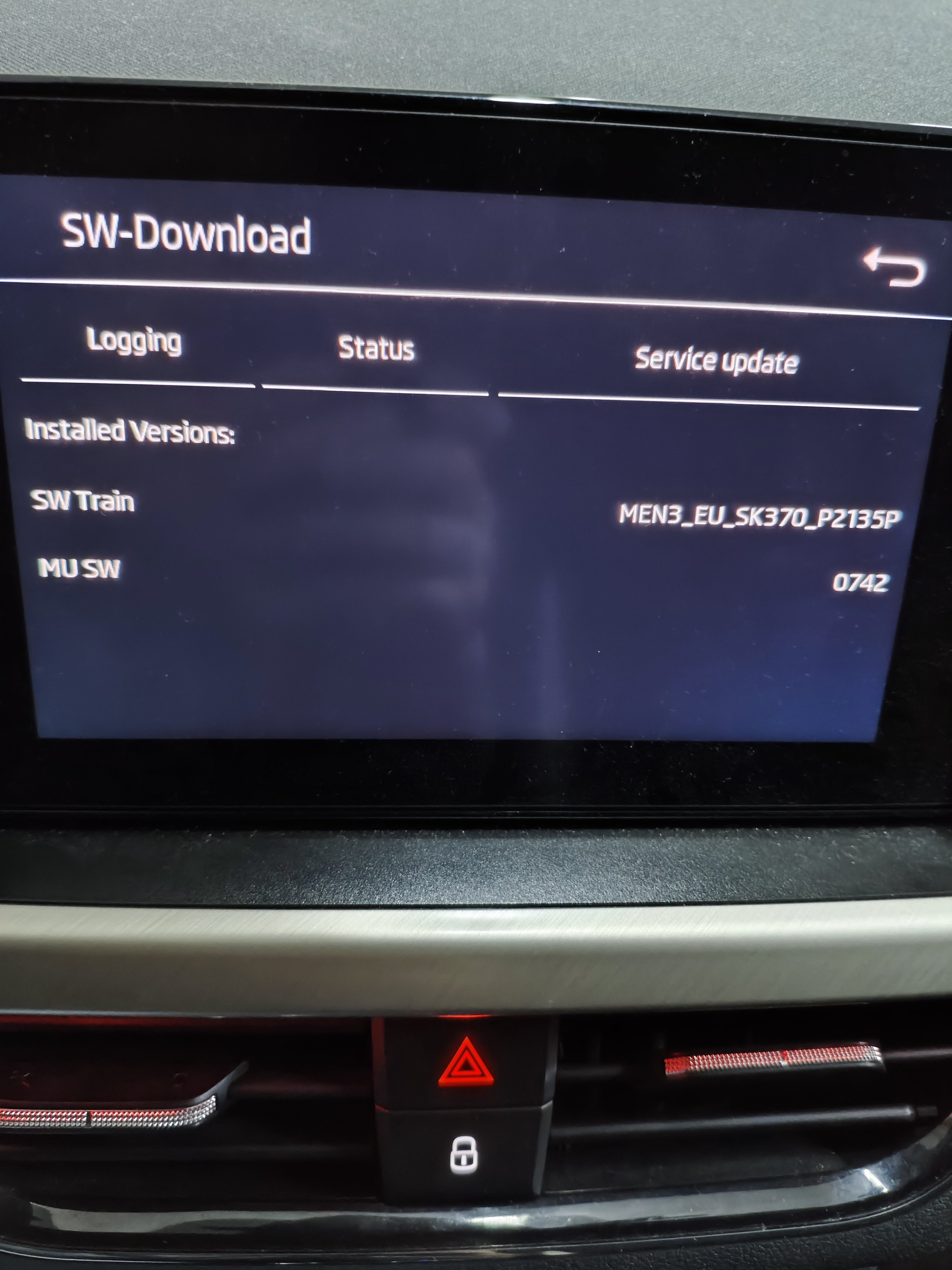

Hi guys
I have a 2020 Scala with Bolero updated to MEN3_EU_SK370_P2135P 0742.
Android Auto was working with my old phone but it's not working with my new Xiaomi 14 on Android 14.
I'm afraid to be stuck at 0742, can I upgrade to a newer version ? Do I have a chance to make it works or will I have to buy a wireless AA module ?
Thanks

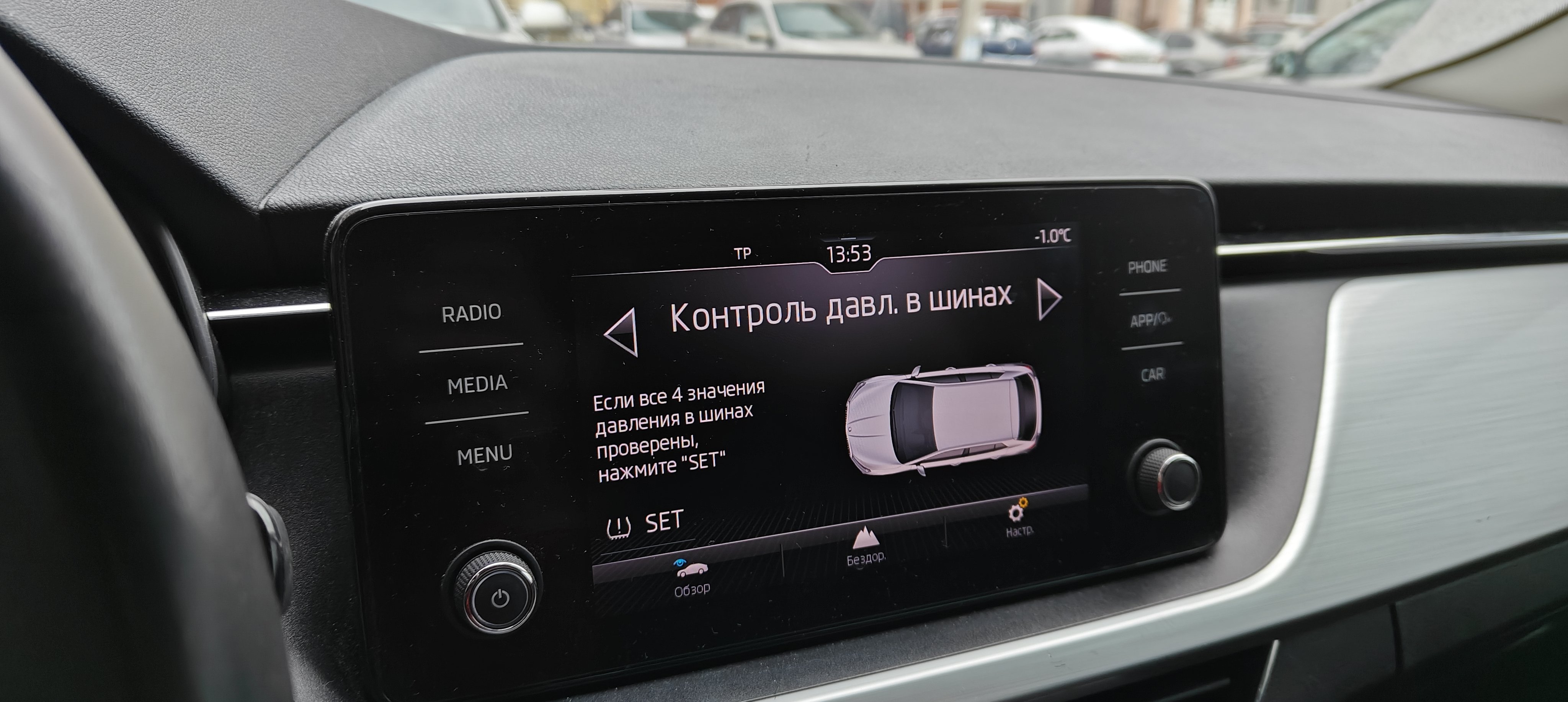

Hello, does TPMS work for everyone on firmware 1800? I have a menu displayed as in the screenshot. When the pressure drops, it is not displayed in the menu

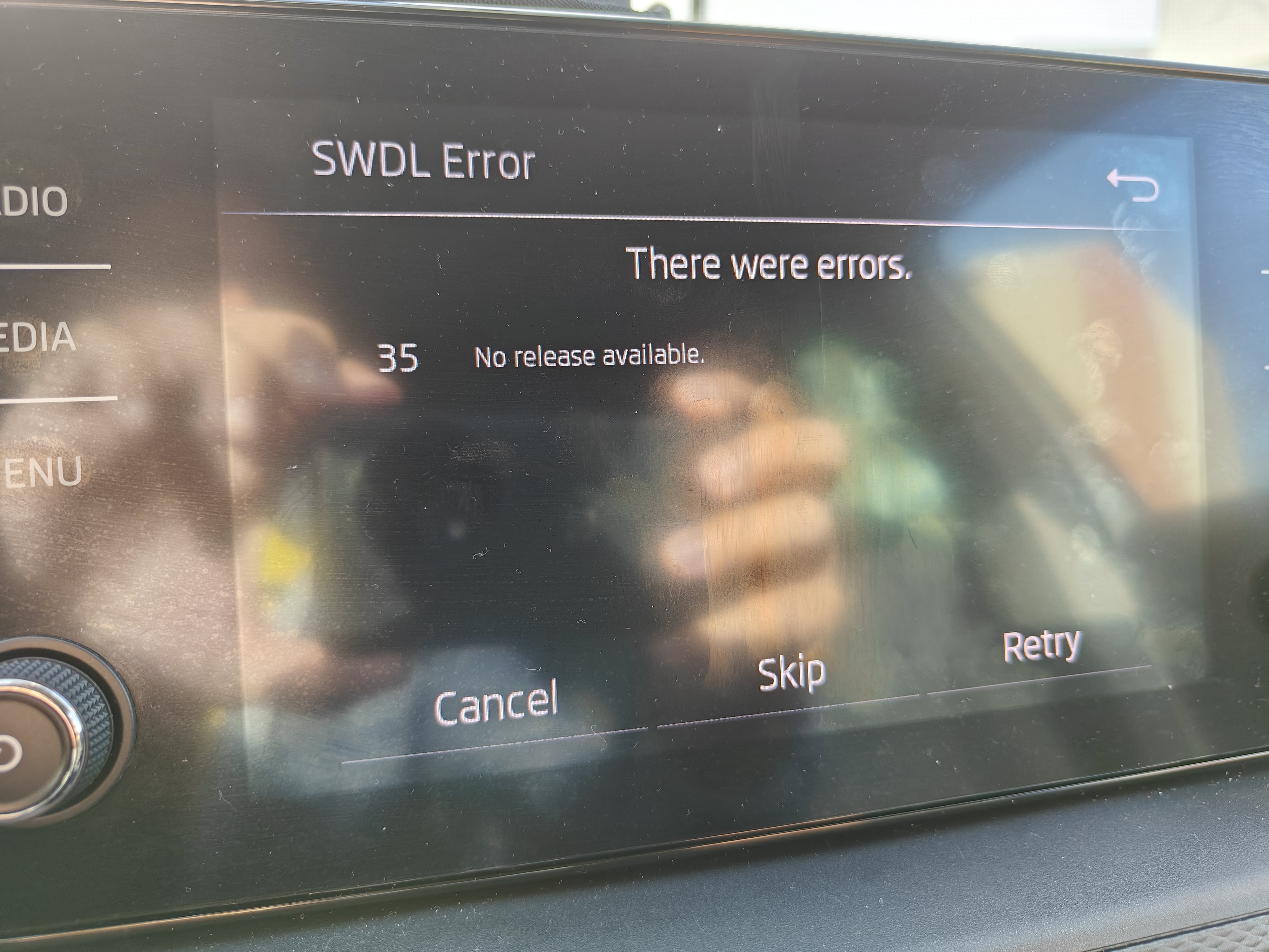

I had software MEN3_EU_SK370_P2345L_1790. I managed to update to MEN3_EU_SK370_P3225L_1798, but when I tried to update to MEN3_EU_SK370_P3355L_1800, I got the error "35 No release available."
I would like to know what I should do to get the update to 1800

I updated it to 1798 because I got this error (I tried at the beginning straight to 1800), so I tried upgrading steeply to see if it resolved the problem.
I got the two files (1798 & 1800) from the link found on this topic (https://disk.yandex.ru/d/1V1uBTc8ssc3zA). I'm unsure if the "1800" file was downloaded with an error or when I unzipped them, but I tried with a file from (https://mibsolution.one/) this morning, and it worked.
Thanks anyway for taking the time to reply and for giving the link.
For information, this upgrade (to the 1800 version) fixes my AA connection with my One Plus 11 5G EU.
Thank you to all who were involved in this topic 👌👍
