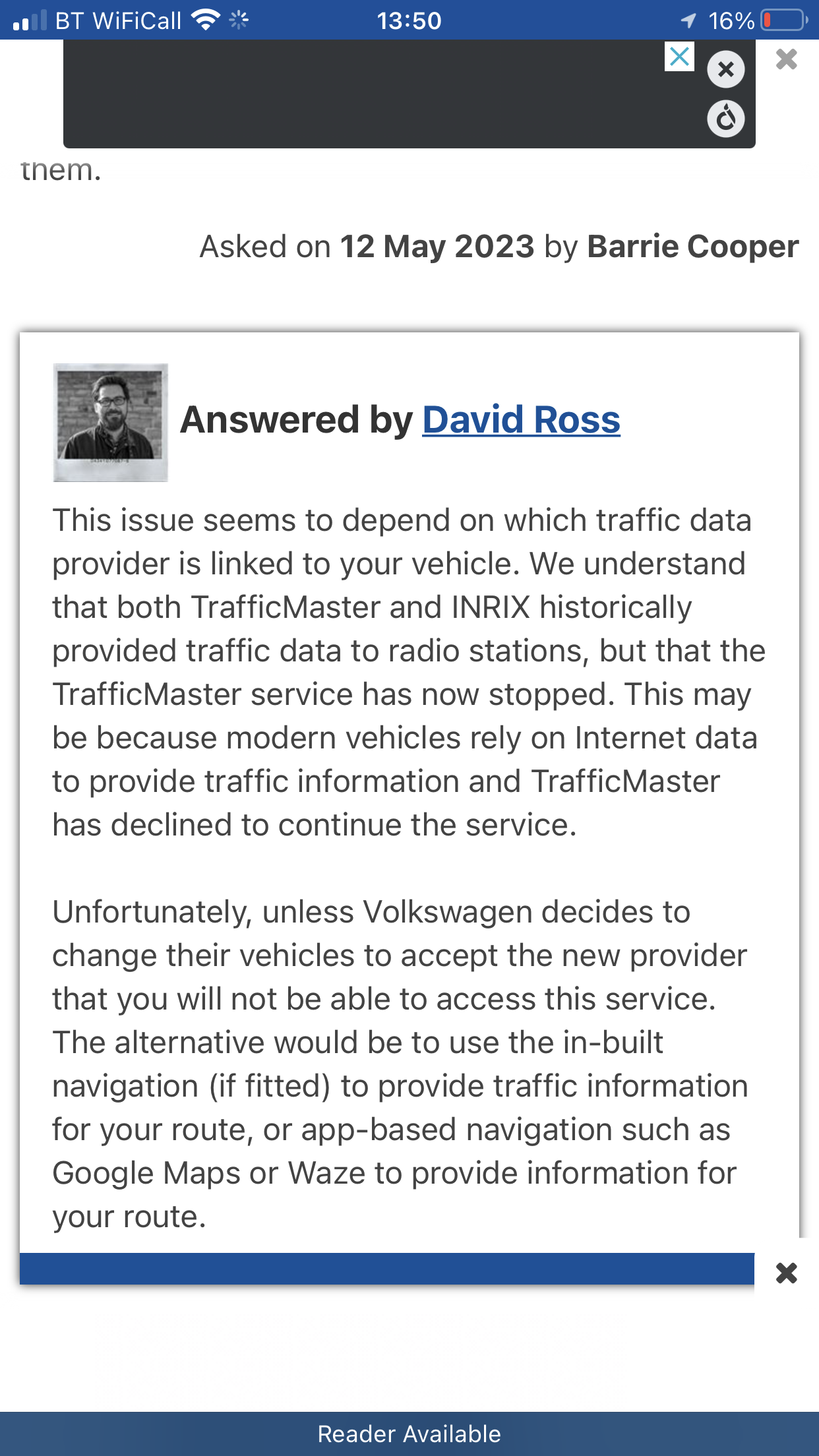

Honest John’s response
Err isn’t the point that we CANT use the inbuilt sat nav because of this specific issue (or rather we can but won’t be able to route around hold ups)?  This that answer has fallen short of the mark
He did an internet search of the boards and gave a garbage answer 😂. Telegraph is like that now.
