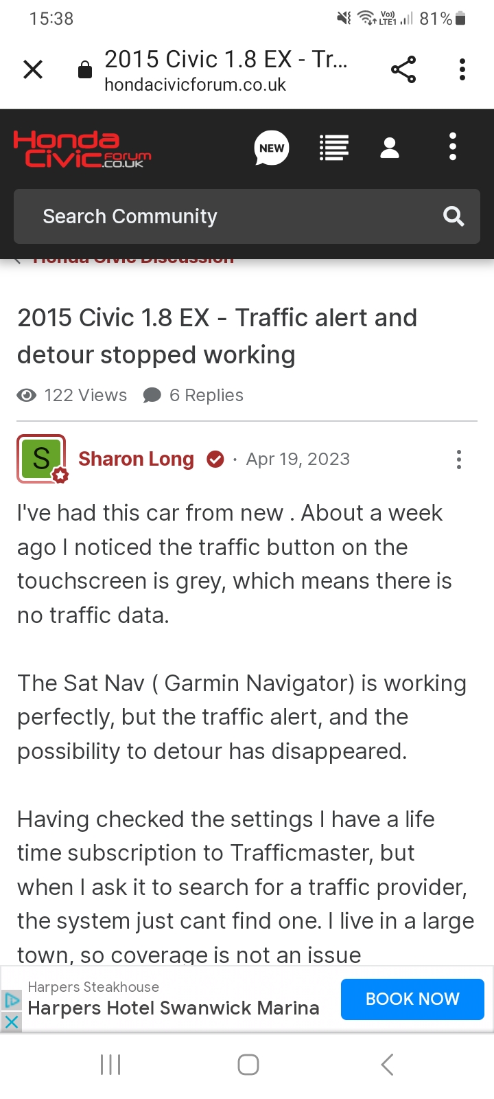

For info....... Honda drivers also reporting no RDS TMC FM issues in the past week.......

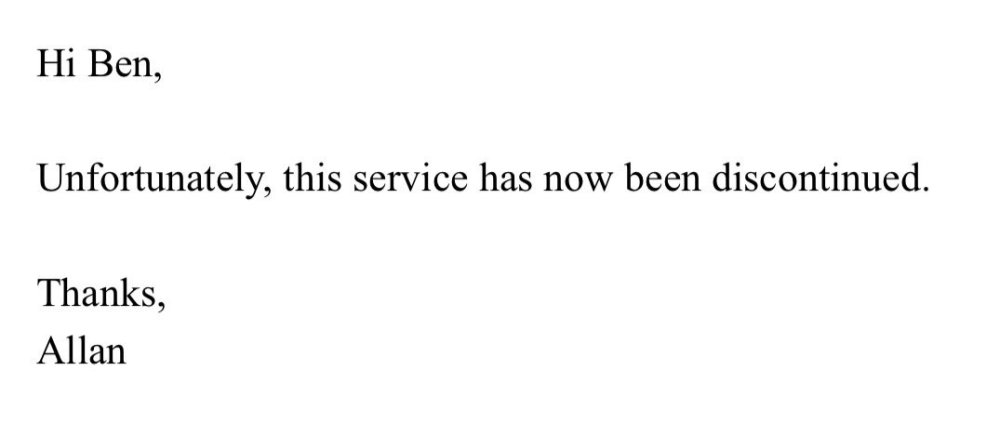

I’ve emailed the supplier of Trafficmaster, see what they say
Same here - I'm also waiting for a reply. I can also confirm for clarification purposes, which I also posted in a different thread, after digging out my 15 yr old portable Tomtom and its optional plug in TMC antenna for testing purposes that the RDS-TMC service is still up and running and working perfectly albeit not for us VW Group users. I only hope that it's not a deliberate cancellation of the service by VW in favour of the new ( online ) Connected Services that are deployed in the newer model cars or possibly an individual cancellation of my TMC licence because my vehicle's media system has passed its 5 year support date.
