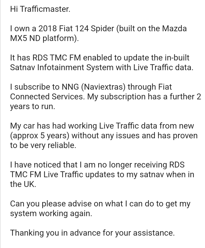

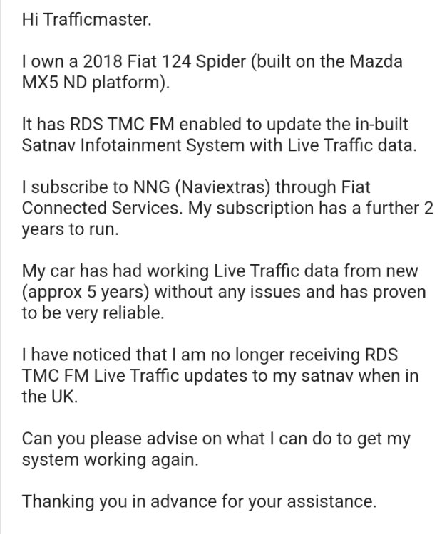

Update from Arthur124 (Fiat 124 owner).
This is a much bigger issue affecting more than just Skoda/VAG vehicles.
Many car owners (from many different car models and manufacturers) subscribe to their respective "Connected Services" supplier in order to either hotspot their phone and/or enable RDS TMC FM Live Data through the inbuilt radio/satnav system (without the need for a mobile phone).
I have emailed Trafficmaster and been allocated a case number.
I will update you as soon as I receive a response.
This is a transcript of my email......
I have a 2019 Karoq and TMC stopped working about 2 weeks ago. My sister in law has a VW Golf of a similar age and it is not working on that car either. Neither of us subscribe to on-line services. My wife has a stand alone Mio Sat Nav and TMC is working fine on this.
Clearly the issue appears to be with VW group vehicles (possibly others) and TMC still appears to be broadcast.
My car is due for MOT/Service at my local dealership on Wednesday so I will raise this on the basis that it is not an issue only relating to my vehicle and whether they can shed any light on when/how this will be rectified, suggesting they clarify via Skoda centrally. I will post again if I get anywhere.

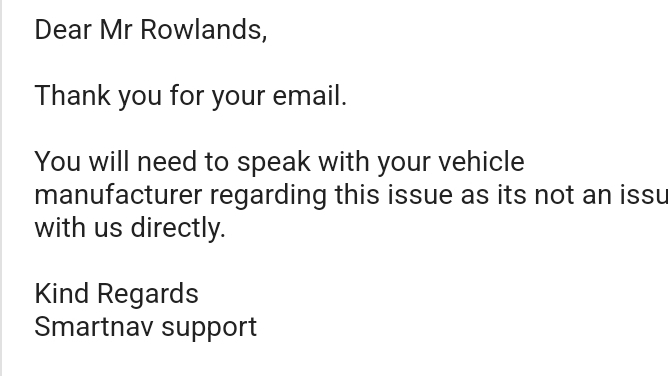

Update.......
And this is the response I received from Traffimaster/teletracnavman
Update: took my vehicle to a main dealer this morning. They verified the problem in my own vehicle and also another vehicle on the lot. Quickly checked to see if any error codes in the system, and there was nothing. Software up to date so nothing to do there (thanks to a forum member for helping me perform the update myself). They agreed it was pointless taking my car in for any deeper diagnostics as it was obviously nothing to do with the vehicle or even Skoda specifically, since the traffic data is supplied by a third party. They recommended I go back to Skoda UK to explain the issue and hopefully they will escalate it with the supplier. I have emailed them and now awaiting a response...
I would encourage others to pester Skoda about this too, whether it be main dealers or Skoda UK. The more people raising it, the greater the chance they will do something about it. If we don't get anywhere, then I think we will be looking to get media involved as someone else on here suggested,
9 minutes ago, Arthur124 said:
Update.......
Doesn't surprise me, from their point of view we are not direct customers. Better to escalate through Skoda, as described above.
