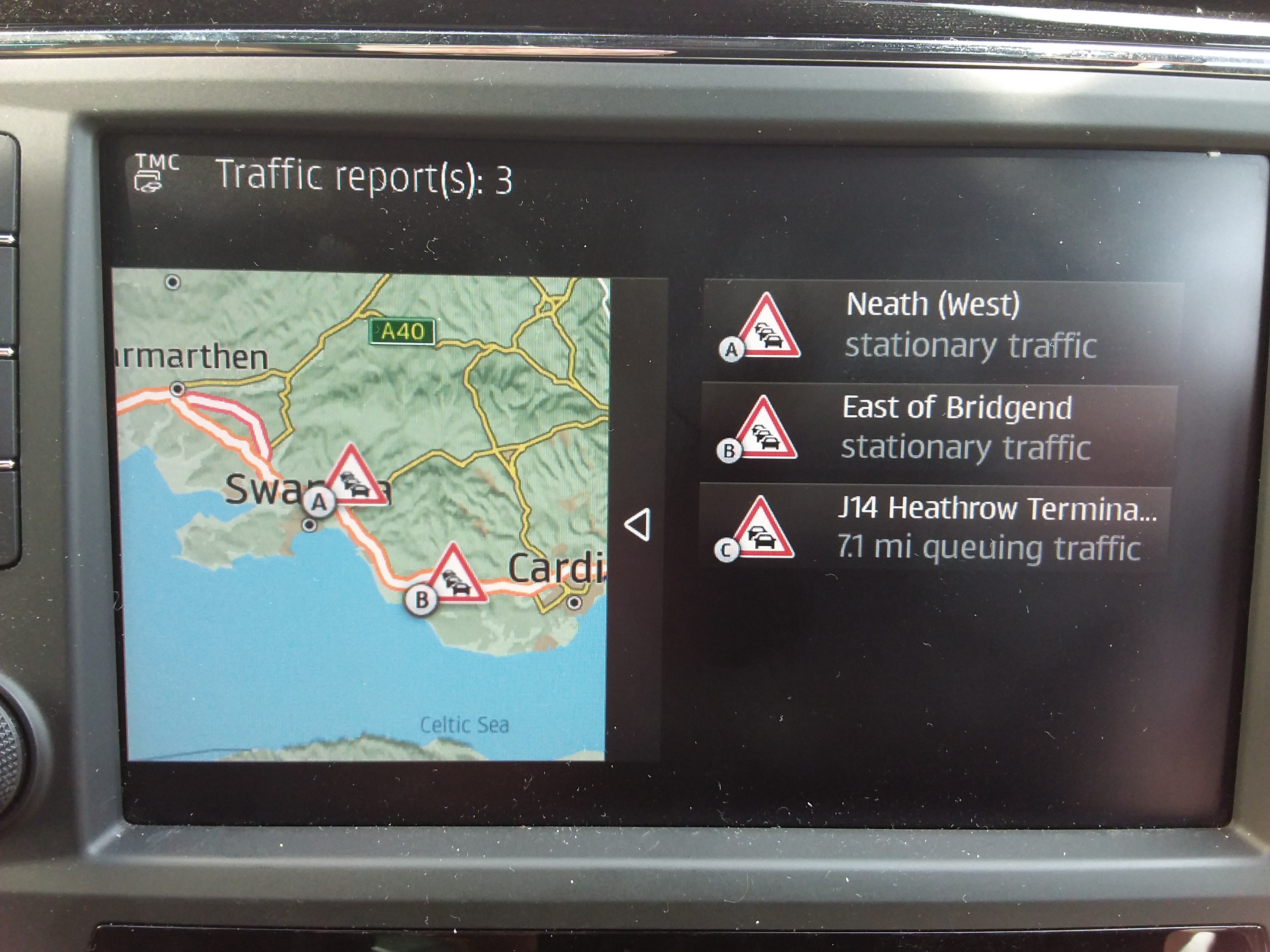

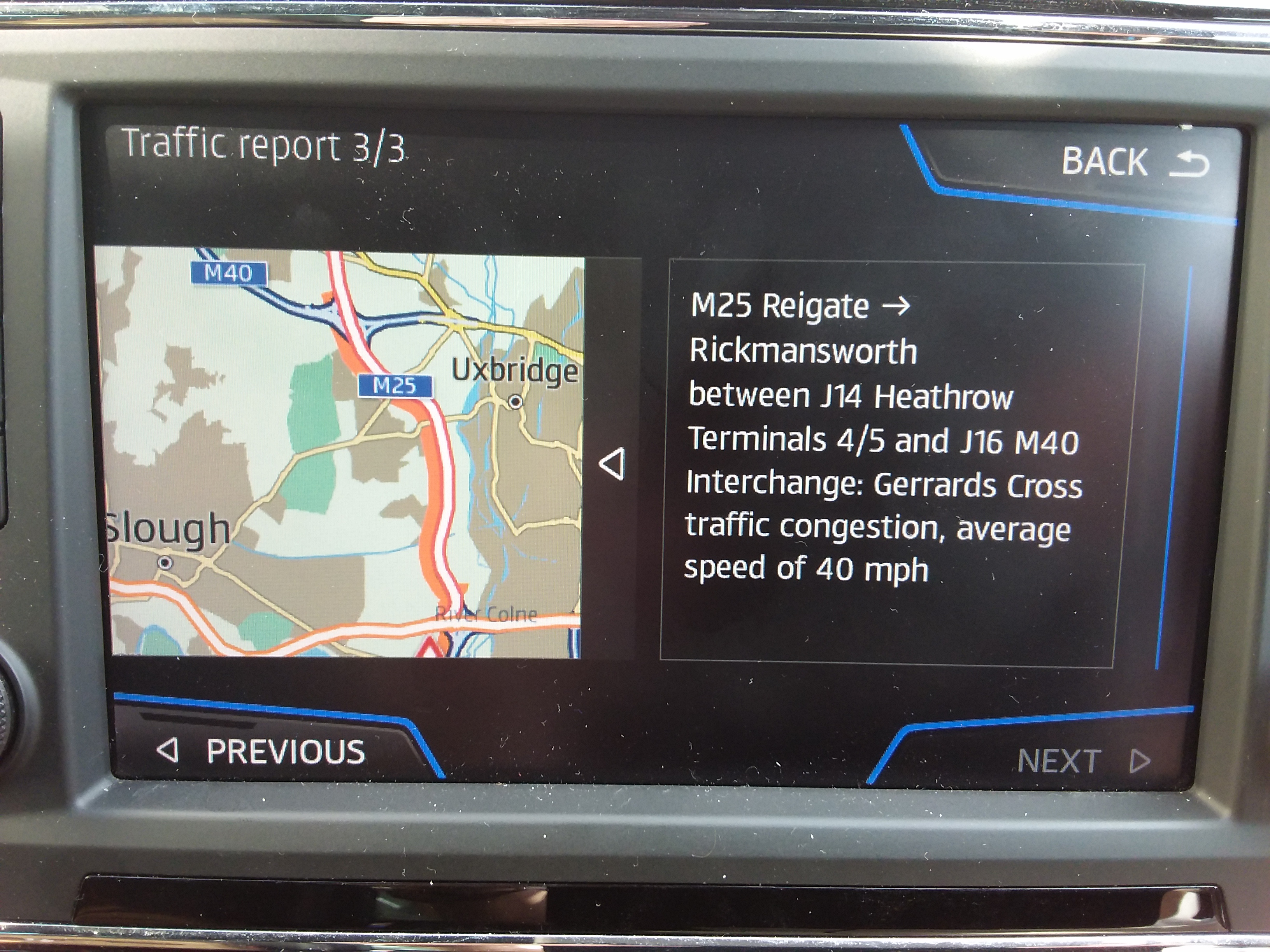

@pcbbcWell done that is indeed the solution on a mib2 hìgh.
Reboot of the infotainment unit.... The long hold on the on / off.
No cross in TMC... looking good.

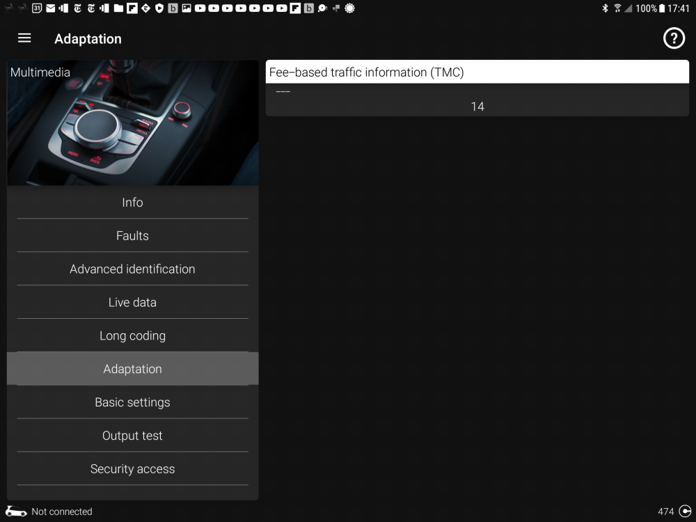

For others it was done with the Obdeleven with the Pro license. Works with a dongle white on an Android or the Next Gen black one Android or iPhone with the Pro licenses. People will be able to do this with VCDS. You have to feed that field in the 5f module, reboot the unit and Bobs your Uncle.

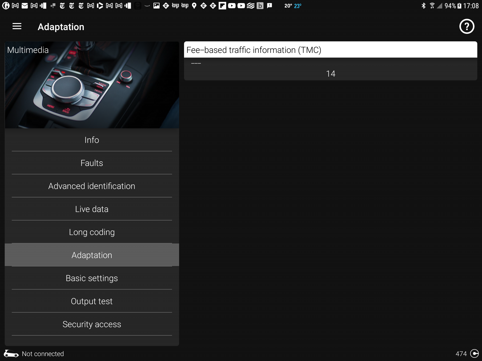

    I’m just letting any VW owners that may be lurking here know that I successfully reactivated the TMC on my mib 2 high using 32782 in the 5F module using OBD11 pro.

Mib2 high which is called the Columbus in Skoda name is easy enough. Just that coding change to bump it onto the other UK TMC provider as @pcbbcworked out from looking at the map file code. See above. Need to do the coding, cost about £130 if you have not got Obdeleven already, pass on VCDS costs or find someone to do it.

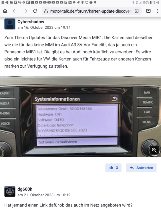

Does it not also affect pre 2015 MIB1 units as these also rely on Trafficmaster TMC for traffic data?

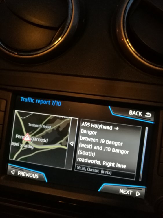

I reckon you could run with a two card set up (if you have two cards), where you can make the choice on the day by slipping in the map you want to use. Bigade1 to confirm. The software mod must craft the unit to use the alternative TMC with the old maps but would happily just run in navigation only without TMC with the latest TomTom maps. Thus if you were on a long run with traffic you would use the old maps but it would not take advantage of new roads or if you were on a cross country trip without traffic you'd use the new maps. You'd make the choice yourself on the day. Least how I think it would work.
We only use the car with the mib2 standard as a run around in Wales but if heading to England (or Cardiff) you'd slip the one with TMC capability in it so you'd get the motorway delays. The user saved destinations / last destinations and user POIs are stored within the unit so switching maps is just changing the map cartography not user saved data on those.
