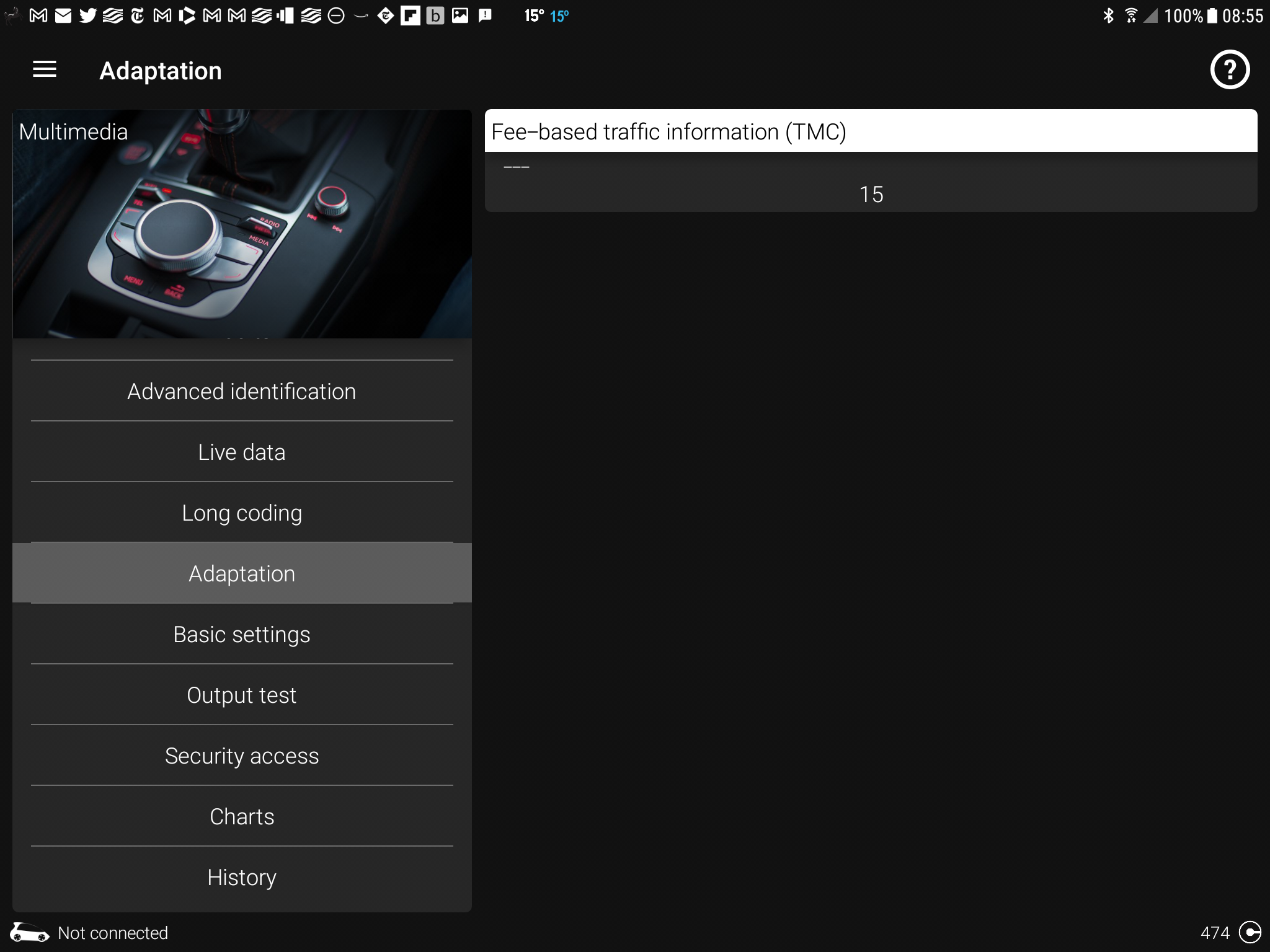

For mib2 high it may come down to finding the correct value to stick in Obdeleven. My current screen unchanged:
I did manage to loose a post just then 🤔.
Recreating what I said. That 15 I believe is the TMC Provider Sets if the post below is correct.
https://www.golfmk7.com/forums/index.php?threads/enabling-tmc-in-the-uk-is-it-possible.386243/page-2
May be 1021 or 21 are good ones to try. You save and reboot the unit to get it to take.

If 32782 is the solution then for Obdeleven it's a question of getting it in. Don's end post has the 15 in it.

As for the mib2 high, the current setting of 15 wasn't doing too much as I posted up above so may be I'll try 32782 later... if it will take it. Guess it will knock out foreign services if you take it abroad. 15 was a set that matched those and the UK TMC free service.
For MIB2 High…
Replace 15 with 14
Replace 32783 with 32782
Yes, you will lose some services abroad when in Finland or Hungary. Of course you can code back to your original value if you ever visit there.

I've yet to see where 32783 goes in on Obdeleven.
May be 14 is sufficient as the tmc provider set as far as Obdeleven ?.
Nowhere.  The values are all the same setting for IDE501111.  Different MIB2 units are coded differently with different settings…
32783 is online traffic permitted + Trafficmaster RDS TMC
32782 is online traffic permitted + ITIS/INRIX RDS TMC
15 is NO online traffic, Trafficmaster RDS TMC
14 is NO online traffic, ITIS/INRIX RDS TMC
So for MIB2 High you will need to code either 32782 (if your current setting is 32783) OR code 14 (if your current setting is 15).

It's going to be 14 then I'll test later. Seats never got online traffic on the mib2 high.
