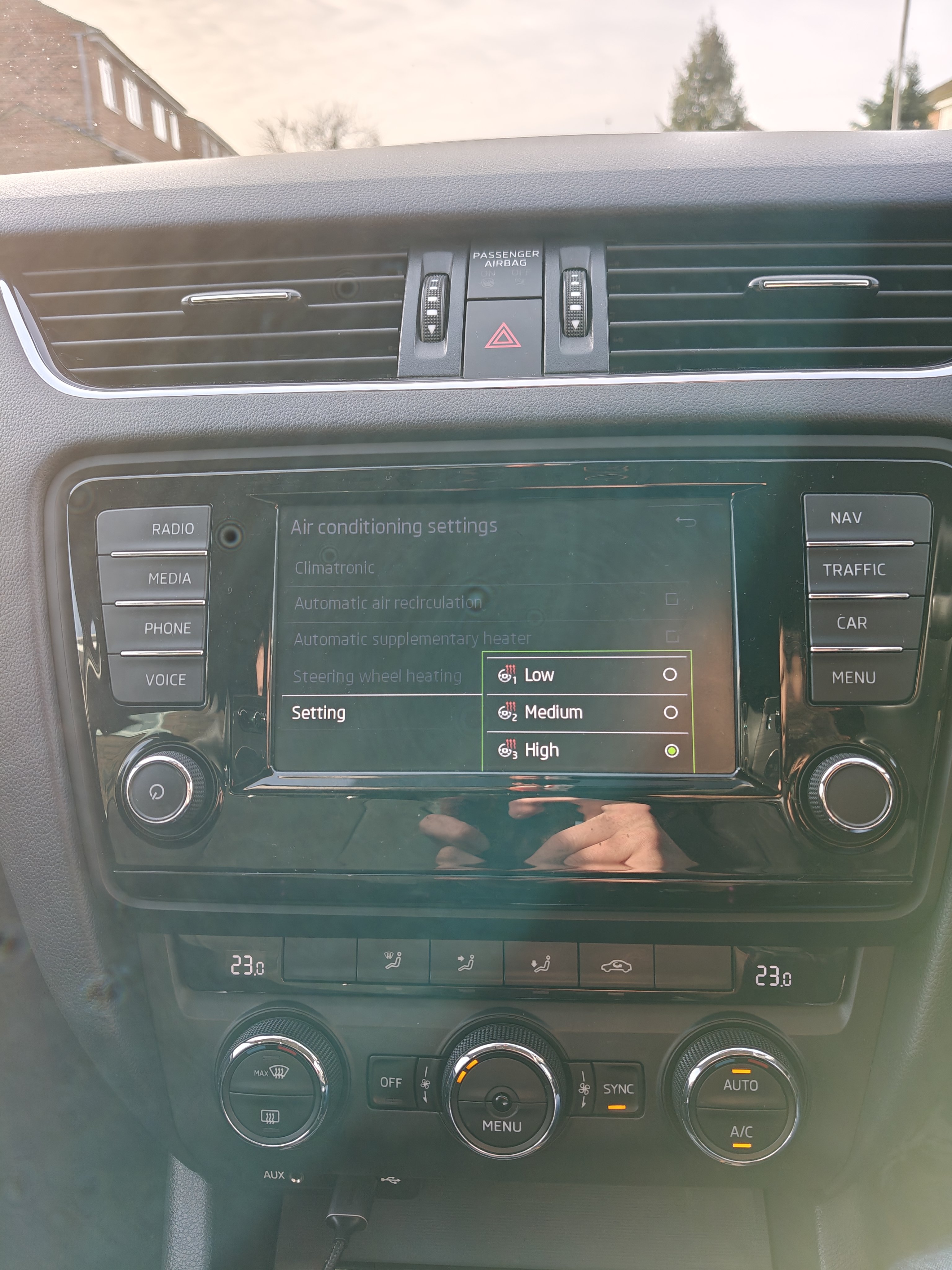

Hello all,
The modification is done, the HSW is installed and working. I am really happy with the result. It took me some time to complete the job, mainly due to lack of time and ordering the wrong clock spring initially.
What happened in my case is that I tried to save some money by going for an older clock spring model 5Q0953549D although my Skoda Octavia MK3 had ordinally 5Q0 953 569 A, which according so some posts here would require a 5Q0 953 569 B to power the HSW. It turns out that the mounting points of the clock springs are different and the 5Q0953549D did not fit the steering rack at all. I ended up buying the 5Q0 953 569 B used from another Skoda and it all worked like a dream. I had already prepared all cabling using an alternative to the Kuafec cable loom (see below) which made the rest of the job rather easy. Please note, that the cable is plug and play, however it is a bit short, and I had to extend the 12V and ground wires with app. 40 cm to easily reach the connector of the clock spring. After installing the clock spring and HSW and coding, I had an error message that the cruise control is not working but this error disappeared after few hours. Interestingly, the coding that I thought to have made, was lost afterwards as well. Anyway, I coded again as described in this topic and voilà, the button for the HSW appeared 😊
Last thing, I was never sure if this modification will work if one has no heated seats, but it does.
Here is a list of the parts with prices:
5Q0 953 569 B                 clock spring - £95
3V0880201 AA                Airbag - £110
5E0419091CFCWE        HSW - £92
 Slip Ring Adapter Cable - £15
Good luck!

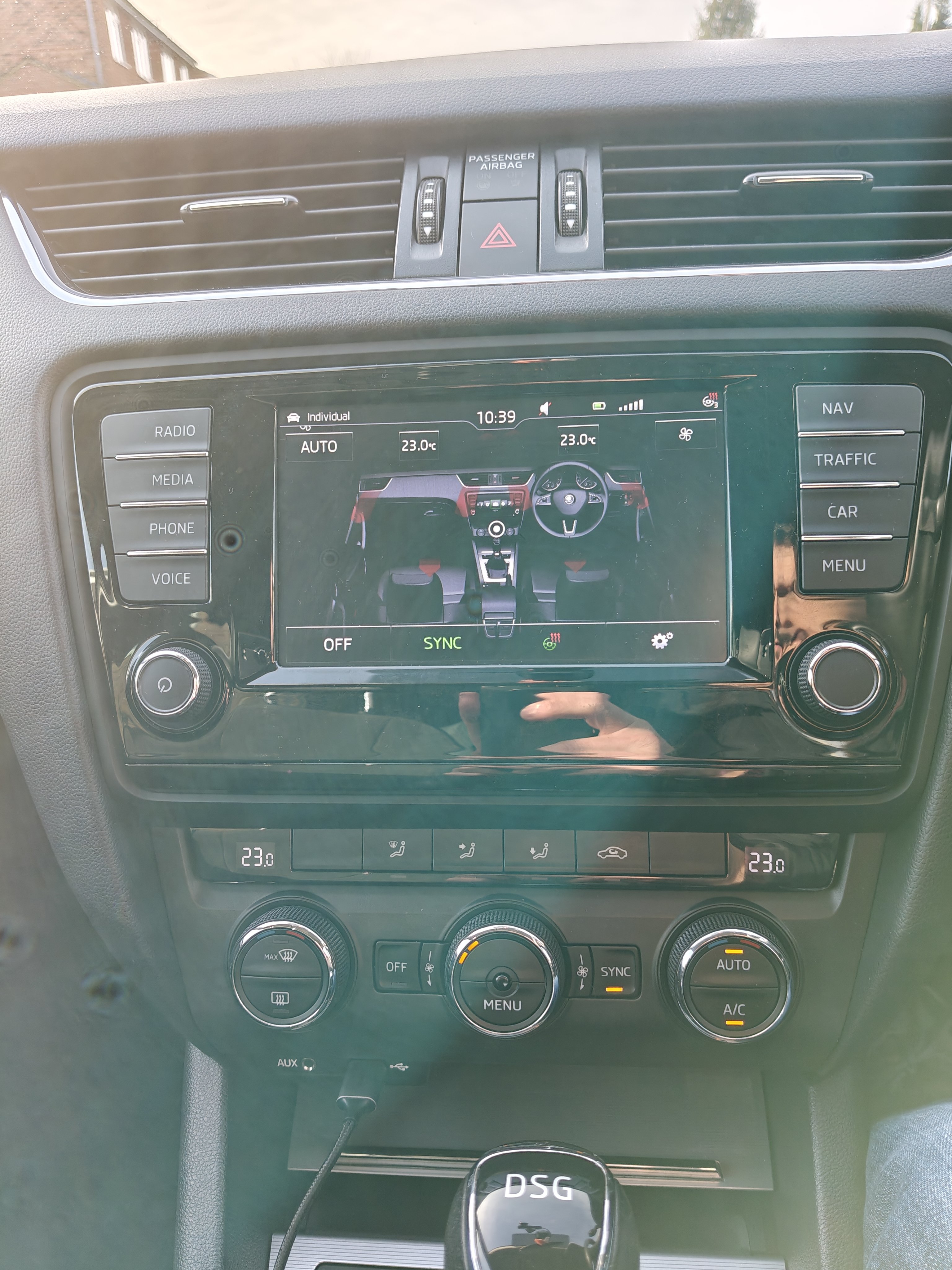

Hi,
I’ve started the heated steering wheel retrofit (Octavia 3 FL 2018) following the procedure @Purpletom described at the beginning of this thread and I’m now at the final stage where I’m stuck.
What has been done so far:
  • Replaced the steering wheel with a heated version
  • Replaced the clock spring from 549 F → 549 D
  • Added power supply
  • Hardware should be complete and correctly connected
Coding performed in: 08 – HVAC
  • Byte 11 – bit 2 and 3 (active, active)
  • Byte 13 – bit 2 and 3 (outside temp)
  • Byte 14 – bit 6 and 7 (LRH gen2 mod)
After coding, the heated steering wheel button appears in the infotainment menu, but it cannot be activated.
According to several comments in this thread, it might be necessary to:
  • “remove the coding then recode” – but it’s not clear in which module and how exactly,
  • or perform a CAN Gateway reset – but I’m not sure about the correct procedure.
I believe the hardware and basic coding are correct and that I’m missing just one final initialization/reset step.
Any guidance would be greatly appreciated.
