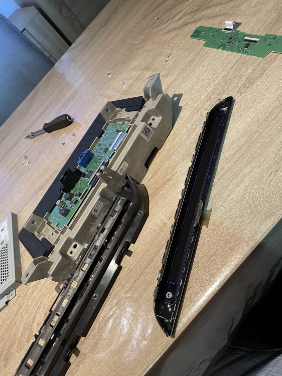

  • Hello, after reading this thread, I decided to share the information I’ve gathered so far. I started experiencing the same symptoms as others described here: randomly increasing volume, key press sou
  • LivornoBart
    LivornoBart
    Hello, I made a solution for this kind of issue and also made a short movie how to fix touch panel under the black panel which is under the display if you have problems with self clicking or volume go
  • mertpolat
    mertpolat
    @omeromeryigit Thanks for the information you shared. I followed the steps in the post one by one, and in the end my volume increasing issue was fixed. I solved the problem by cleaning the unit that

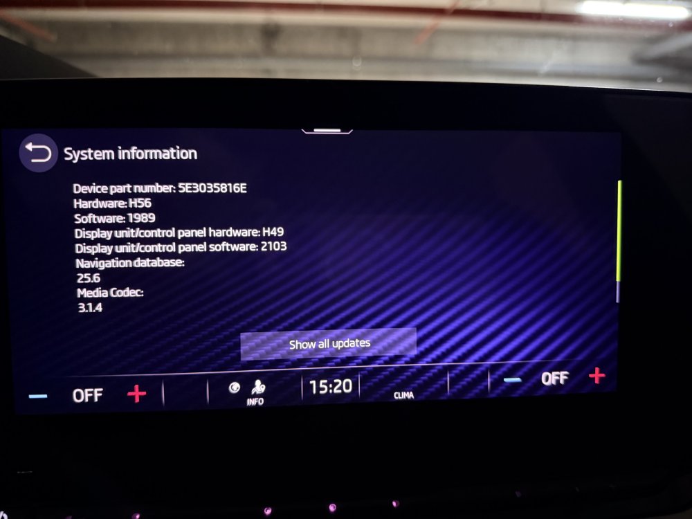

I am having the same problem on my Octavia (2022). The last post on this issue was quite a while ago - has anyone got any more solutions? I updated the software when prompted to a few days ago, and almost immediately the volume began rapidly rising by itself. It happens with both streaming radio and podcasts, and appears completely random, although usually occurs every few seconds or always within a minute. It's incredibly distracting, so I have to turn the system off.

Thanks, Dandebo! I look forward to hearing about the results of their investigation! 😁 Has your dealership said anything about the possibility that a software update caused the fault?
Hey,
So the car went in, they had it for 3 full days. Lots of talking to Skoda technical?
Basically they have reset the MIB, updated the software again. And then went through a heap of configuration changes related to how the MIB interfaces with the volume controls.
Now its a case of wait and see if it faults again.

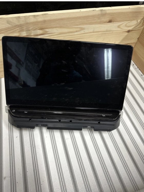

My Octavia MKiv also just started doing the same, and it's definitely the volume slider under the screen. Crazy frustrating, and hoping it is a software issue.
I'd be happy to just disable the slider since I find it pretty useless anyway. Anyone know how that could be done?
