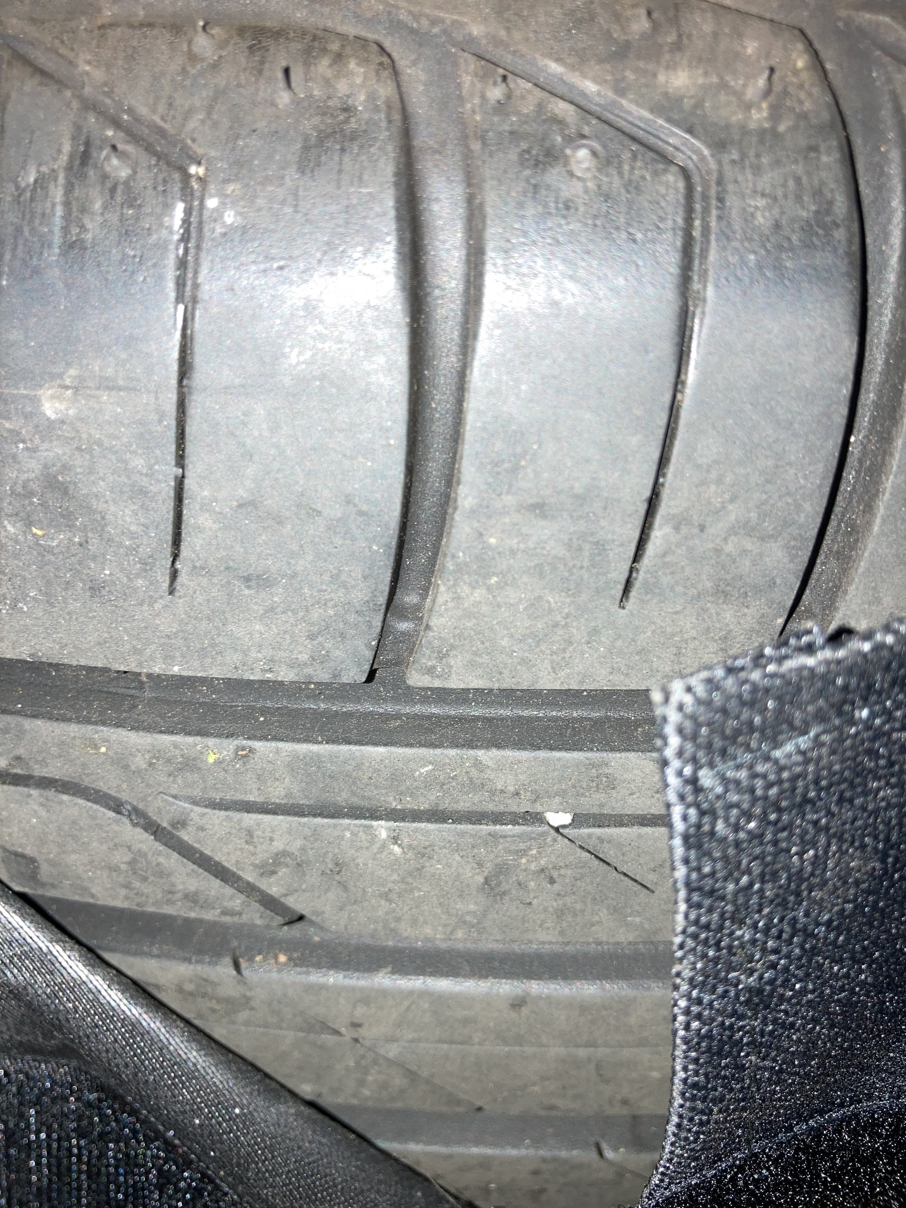

Car is just 4 years old and very low mileage, so I was a bit surprised that the tyres were in poor condition. After a closer inspection today the only cracks I can see are as in the picture. The Tyres are the standard 17" Turanzas with a date code of 36 19 so were new as the car was being built. Just wondering if the tyres are faulty as they surely ought to last longer than this. Generally in the past I was under the impression that you should get 7 years out of a tyre unless of course they had worn down to the legal limit. The car has only been driven on tarmac roads but the state of the tyres looks like that have been offroad!20231208_112244.thumb.jpg.b990e9cfd7aab0f18210d342e531bc1e.jpg
How low is the mileage and what are the tread depths?
Turanza's are horrible tyres - rock hard, yet don't last long.   Had them on our Ateca and even with rotating them they only lasted 18K miles (car mainly used for a steady 30 mile commute).
Replaced them with Micheln Cross Climate - more comfortable, obviously better in slippery conditions, and just changed them again after another 40K miles (so they lasted twice as long), and probably could have got away with only doing the fronts, the rears still had 4mm.
Having said all that, if you're otherwise happy with the tyres then those cracks don't look serious - if they were dangerous the car would have failed.

The following criteria should be used when assessing a cut in a tyre:
  • any ply or cord that can be seen without touching the tyre - fail
  • if by folding back rubber or opening a cut with a blunt instrument, so as not to cause further damage, exposed ply or cord can be seen irrespective of the size of the cut - fail
  • if a cut which is more than 25mm or 10% of the section width whichever is the greater, is opened with a blunt instrument and cords can be felt but not seen - fail
Before failing a cut, you must make sure it’s the cords that you can feel not a foreign object. If you’re not sure, then you should pass and advise.

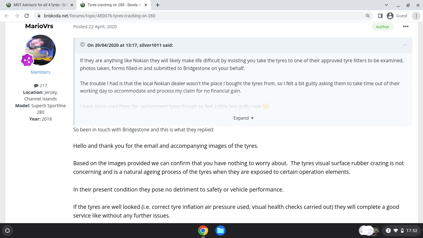

Got a reply back by return..............
First of all, I am really sorry to hear that you are experiencing issues with Bridgestone Tyres.
Please be advised your tyres are covered under warranty for manufacturing defects in case the production date of the tyres is no older than 5 years prior to today's date. Bridgestone follows the he British Tyre Manufacturers' Association (BTMA) consumer complaints process. This can be found on the following web link:

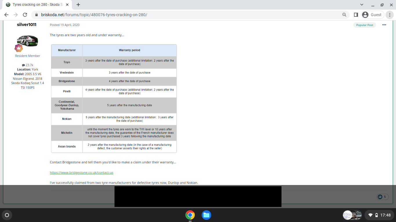

https://btmauk.com/consumer-complaints-about-tyres/
The process involves visiting a local tyre dealer who will manage your complaint for you. You will be asked to complete a Standard Application Form (SAF), which a copy can be found on the web link above. Once completed, the tyre dealer will contact Bridgestone and a FOC collection will be organised. Bridgestone will then inspect the tyre at their Technical Laboratory and will either issue a credit note in the form of cash (ref: based on remaining tread depth) or issue a reject letter explaining the reason for rejection. This process takes approximately 14 days.
Any questions, please contact our technical team on [email protected] (01926 488 579, 01926 488 580) - please use this email address if you would like to send photos for visual examination.

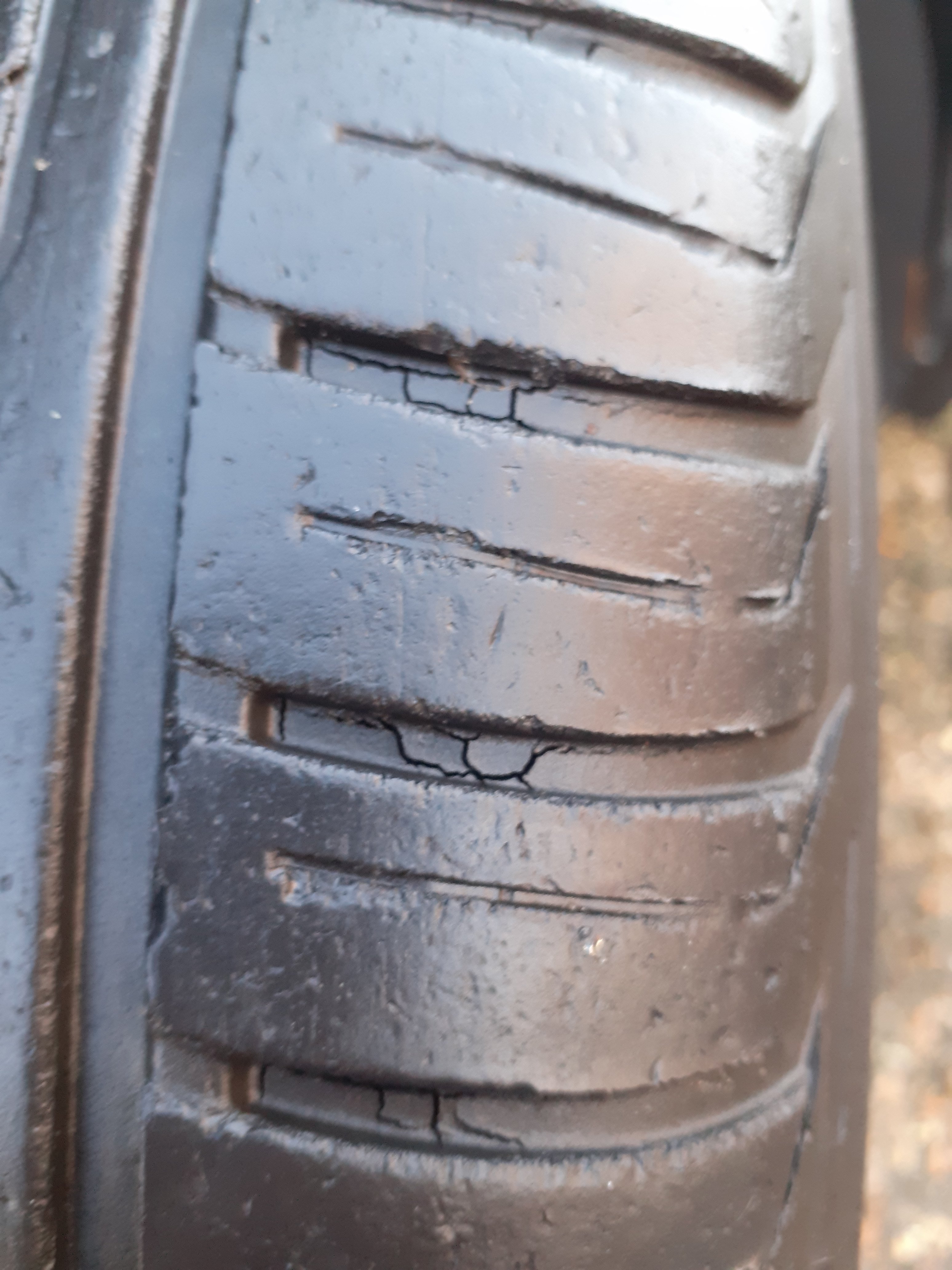

It might be an idea for any other member who have Turanza tyres to check for similar cracks. If under 5 years old, they are covered by warranty!
@Smokeyjoe So it involves you buying a set of their tyres, there will not be a credit note for Michelins if you fit will there?
Have you yet been to an Authorised Bridgestone Tyre Fitting centre and had the tyres sent off and then confirmed as a manufacturing fault on your under 5 year old tyres?
They will be covered by Warranty if they are a Manufacturing fault.    As many know they do what is required and are told they are not.
Sometimes the likes of Mytyres when you complain just send out a set of tyres from whichever manufacturer after you complain and send pictures and just to save hassle..
Maybe Bridgestone will just take the easy way and make your day.
http://briskoda.net/forums/topic/480076-tyres-cracking-on-280

Interestingly, I had Bridgestone tyres on previous car, got cracking. But we left tyres on all year.  My car, where I switch to winter tyres (and the summer tyres just sit in garage through cold weather) are now in sixth year, not slightest bit of cracking.  Personally I think the Eco part of the compound  to save fuel is to hard and gets brittle and hairline cracks form if you use them in the cold. Over time the flexing of the tyre as it touches the road and flattens out widens the surface cracks.
The question is does that make it a manufacturing fault, or the user choosing to use them at temperatures below what they were intended for.  You can read all sorts of waffle about UV creating cracks (but doesn't seem to affect summer tyres when sun is strong, if not used in winter, so is clearly garbage).
It's clear to me the low rolling resistance (eco) compound part of modern summer tyres (which didn't used to be there) is the problem, it is simply not flexible enough to be used on cold days and cracks if choose to move the car when it's cold.
Its basic physics, rubber like materials are hard and crack when cold, softer and grippy when warm, and gooey if too warm. Increasing the long life and grippy characteristics is going to narrow the ideal operating temperature range.  Not a problem because they also sell all season and winter tyres which are optimised for those, except of course most Brits try and use the summer version whatever the weather.
