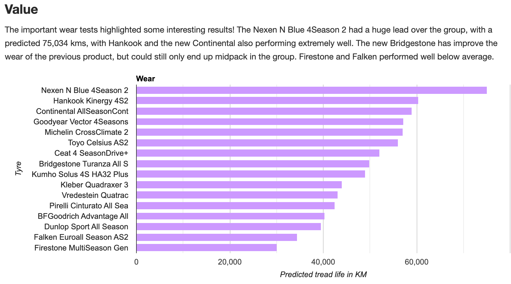

I'd be interested to know how the Goodyear stacks up against the Michelin regarding longevity.

I'd be surprised if you got anywhere near 55k with either of those.  Although not fully winter rated they are still softer than a typical touring tyre so will wear a bit quicker. Mine (cross climates) have done a good few thousand and i've not been disappointed.  Though they do wear faster in summer.

For anyone interested in detailed tyre analysis, I came across this guy who claims to be a tyre designer for the last 5 years. His reviews and analysis seem to be the most unbiased I've seen and reveals the compromises tyre manufacturers face when designing a tyre. I.e. there is no perfect tyre...
https://tiredriver.com/goodyear-vector-4seasons-gen-3-review/
https://tiredriver.com/michelin-crossclimate-2-review/
https://tiredriver.com/continental-allseasoncontact-2-review/
https://tiredriver.com/improving-dry-performance-all-season-tires/
https://tiredriver.com/comparisons-reviews/
