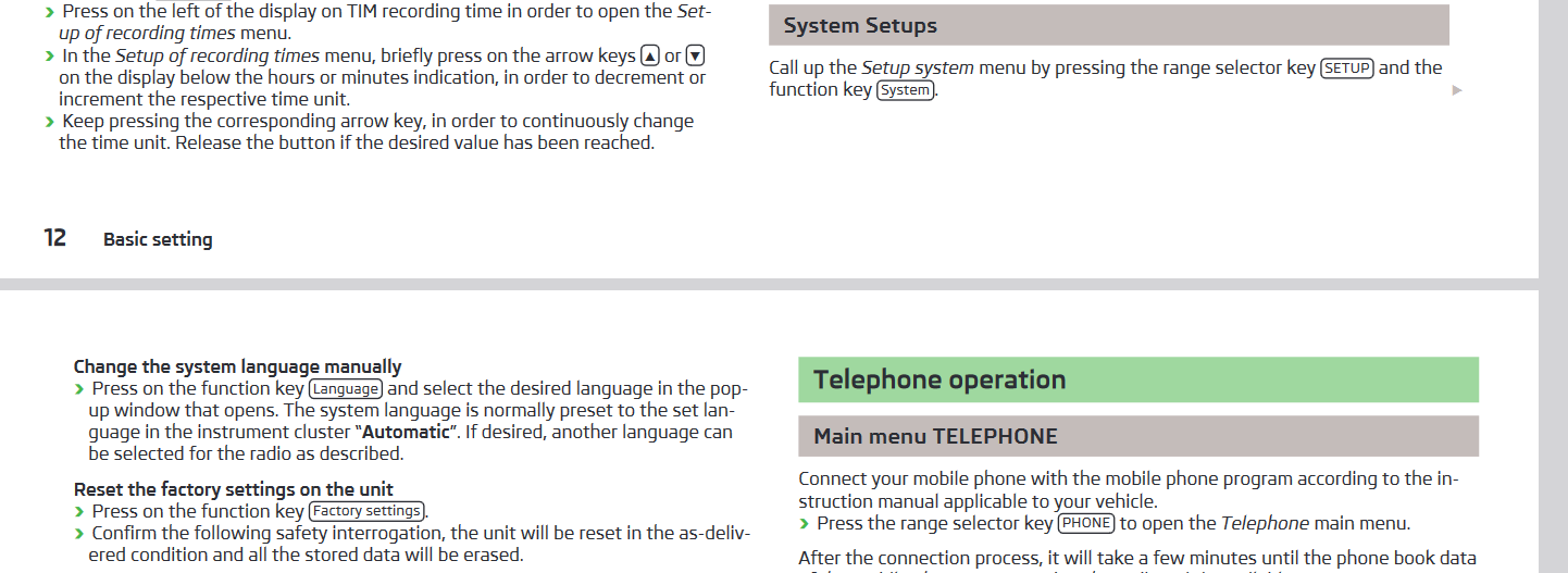

It is possible that the removal and replacement of the battery corrupted something in the Radio system.
The design intention according to the instruction book is that if the ignition is turned off, you get the message and the radio shuts down.
But you should then be able to turn the radio back on for 1 hr intervals.
I read in one of your replies that someone suggested doing a Factory reset? That "may" be the solution but make sure you have any codes that may be needed and remove any media that may be attached. You will also have to retune and pair phone again.
https://ownersmanuals.blob.core.windows.net/ownersmanuals/en/Octavia_1Z/11-2012/OwnersManual.pdf
Screenshot2024-02-24at17-07-25Bolero_CarRadio_pdf.png.6a19c695d46d19285053178ee45f28d2.pngScreenshot2024-02-24at17-06-50Bolero_CarRadio_pdf.thumb.png.902f494070dc190d5de0c3575334854d.png

Reset it to factory settings from the settings screen, should clear any corrupt memory that may be behind all this.
Also .....
A hard reset is usually by pressing and holding the on/off button for at least 10 seconds, then the unit should switch off as in properly power down. Then press power button again for a clean power up.

Hard reset is a term for a forced total power down. It is involed by keeping the power button pressed and power is shut off after 7 or 8 seconds as you have experienced. So you did a hard reset.
Next thing to try is to do a factory reset. Follow the instructions in the Bolero settings menu. This clears everything in the Bolero and should be as it left the factory.
