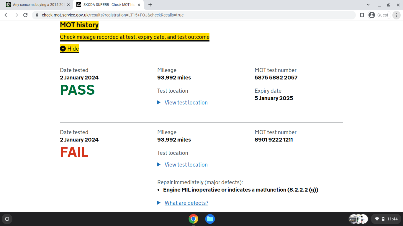

This is really helpful thank you. I noticed that MOT fail in January over the engine MIL. Not sure what to make of that. Aside from that, the MOT is pretty clean. In any case, I'll probably book a ClickMechanic inspection before pulling the trigger.
Mine had a failure for inoperative rear fog lights which was odd as they've never been used. Turned out he didn't know how to switch them on.

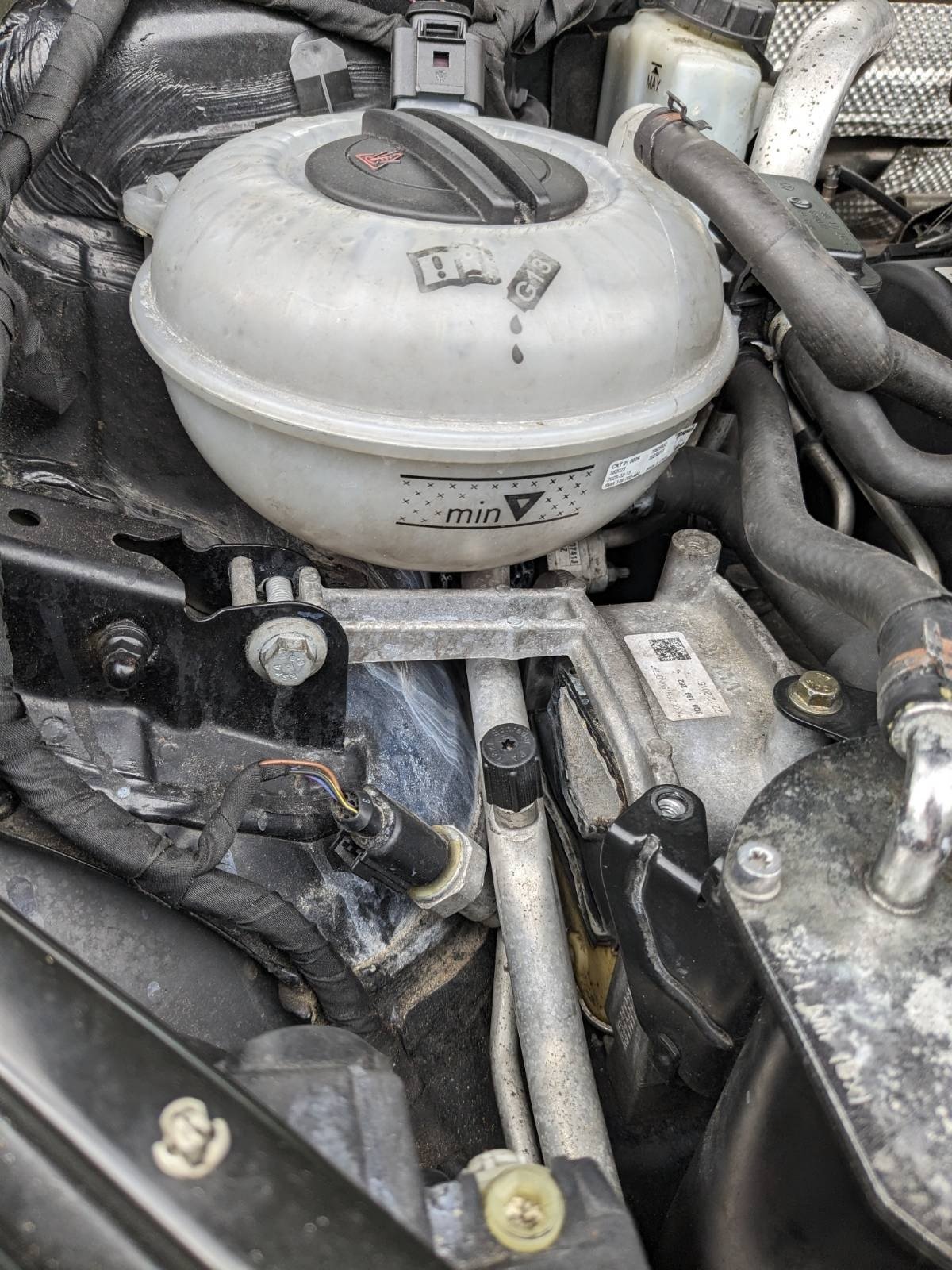

Unfortunately, I got in the car this morning just to park it somewhere else and was greeted by a "Check coolant" warning. I popped open the bonnet and found this...
I had arranged a pre-purchase inspection with a third party mechanic who noted an insecure coolant pipe. The dealer then sent it to a garage to sort this. They also replaced the cam belt and water pump after securing the coolant pipe. Clearly something has gone awry.
If I were in the UK, I'd send the car back to the dealer or garage to sort it. But now I'm not sure what to do besides find a local Italian garage and convince the dealer or garage in the UK to pay the euros for the work. Can't imagine that will be simple to convince them to do now that I'm in a foreign country and won't be back in the UK for about a month.
Is there anything I can try to do myself to solve this? Seems a nasty leak and I'm not experienced with this kind of thing.
If there is no sign of leakage from your recent trip to Italy, it may be the case that when the belt & pump were replaced the coolant system wasn't refilled correctly. It requires the use of a VCDS or similar to ensure all the air is allowed to be purged from the system.
When I had my belt & pump done for the first time the garage didn't do it properly and I had the low coolant messages pop up periodically for about 2 weeks after. I topped up the reservoir each time and after a couple of weeks it stabilised.
I'll pray it's just an issue of not being refilled correctly. The light blue streaks under the coolant bottle look suspicious don't you think? I didn't check that area before my trip so no idea how long that has been there.
I guess I'll re-fill it and then check for signs of leakage.
